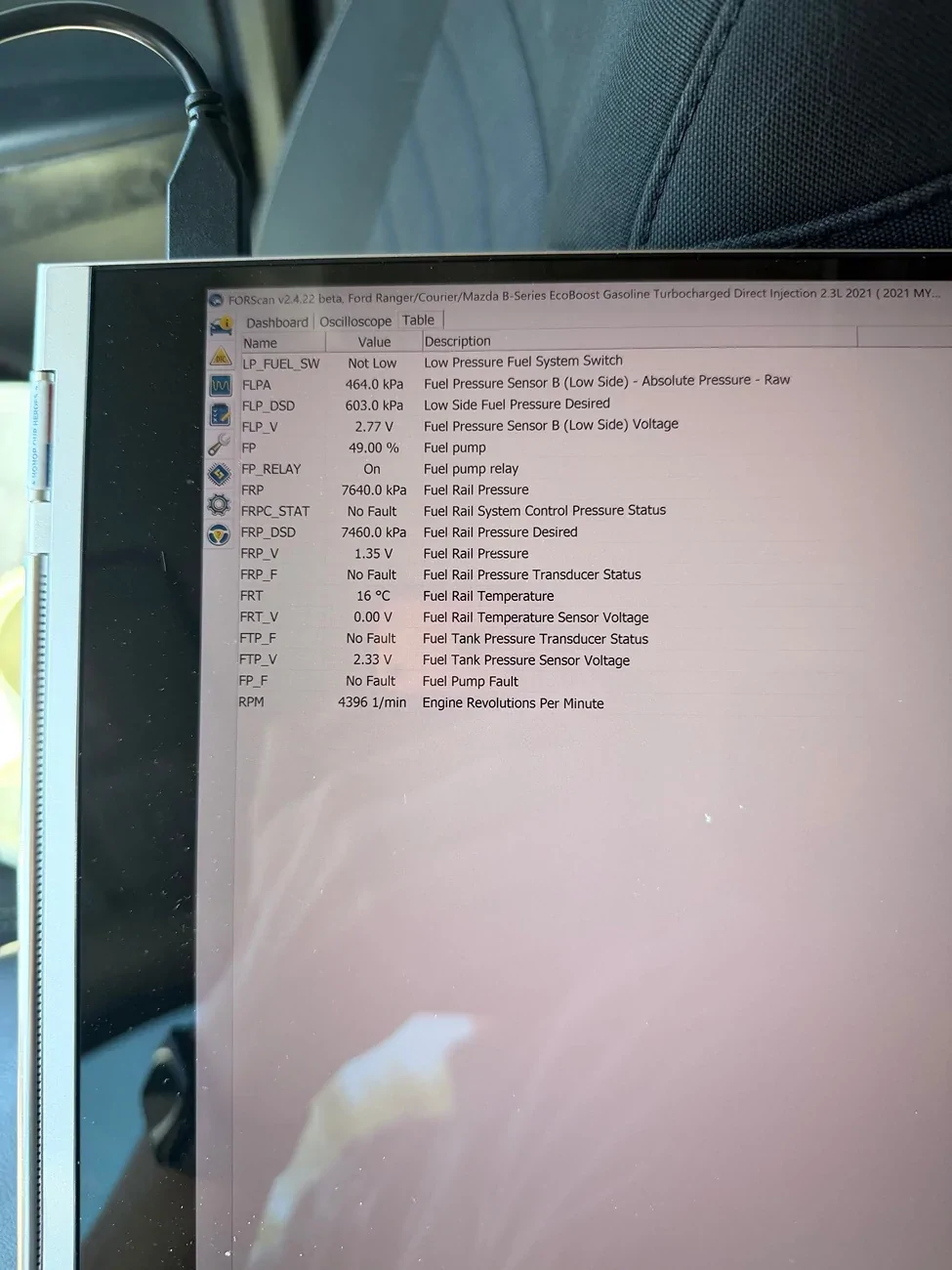

I was only able to find the FLP_DSD (desired) PID in the Forscan software. Idk why I can't find the actual? I have the latest version of Forscan according to their update. V2.3.71 which was released 2026-05-08 🤔
Is there a way for me to load that PID into the software? I couldn't find it for the life of me.
FLPA is the PID for the low pressure fuel pump pressure sensor.

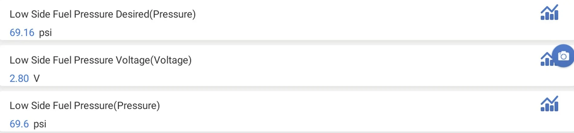

This is from my Topdon Scanner
I am thinking that the pump is dropping pressure under a load, be it weak pump or dirty power or ground - yes low fuel level (consistent) will kill a pump - fuel provides a cooling effect on the pump.

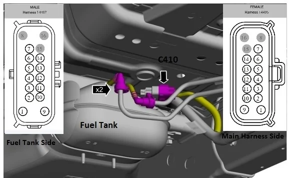

Before dropping the tank - check C410 and C408 for moisture / corrosion on the associated pins from the posted wiring diagram above
C410 - Pins 1-2 and 9
C408 - Pins 11 -12 and 16
Also check the Fuel Pump Module Connector - its just above the spare tire and G403 for security, G403 we never locked in an actual location - but if you get your hand on the pump module connector and follow the ground wire to the frame - it will be very close to the module - this is G403

Your posted PIDs look normal - we need to see it when its in fault mode for a better diagnostic.

You couldn't see the FLPA PID with Forscan? It shows up in the Forscan screenshot in post #18 above.
