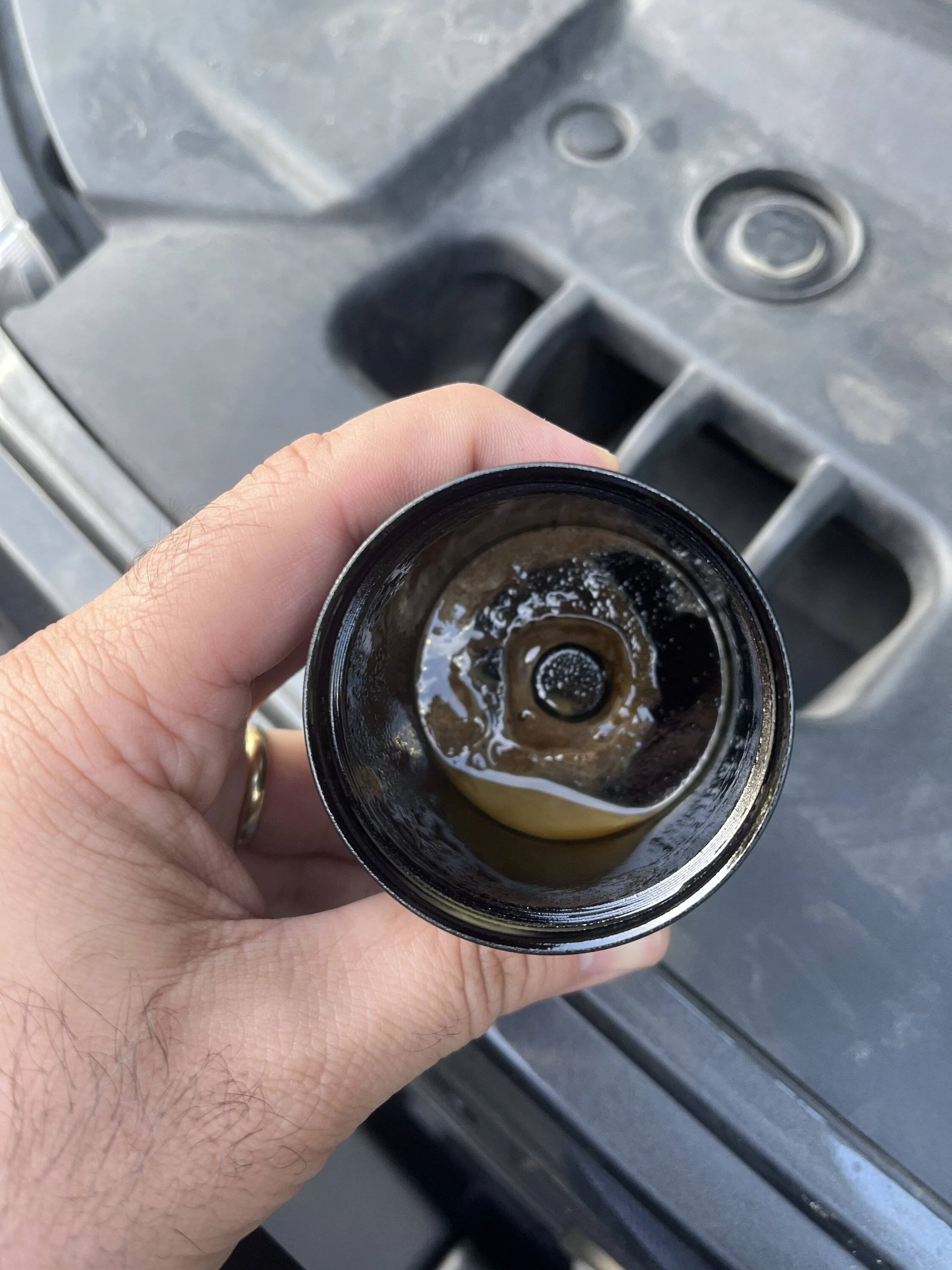

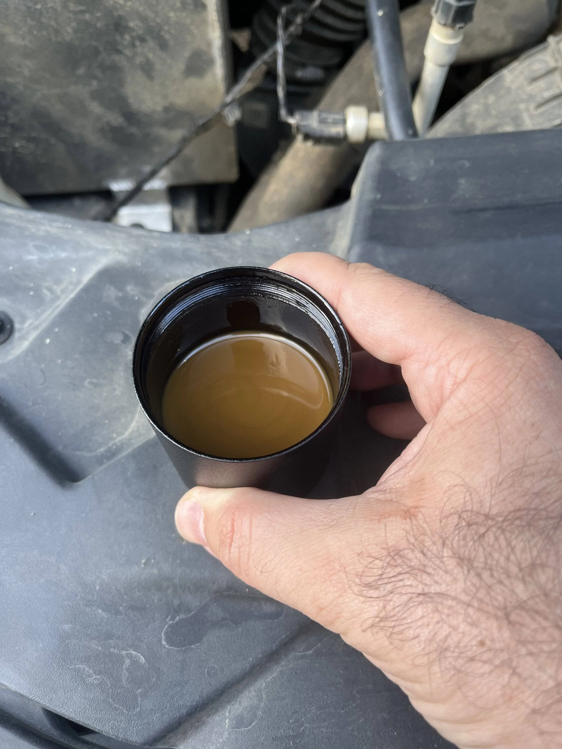

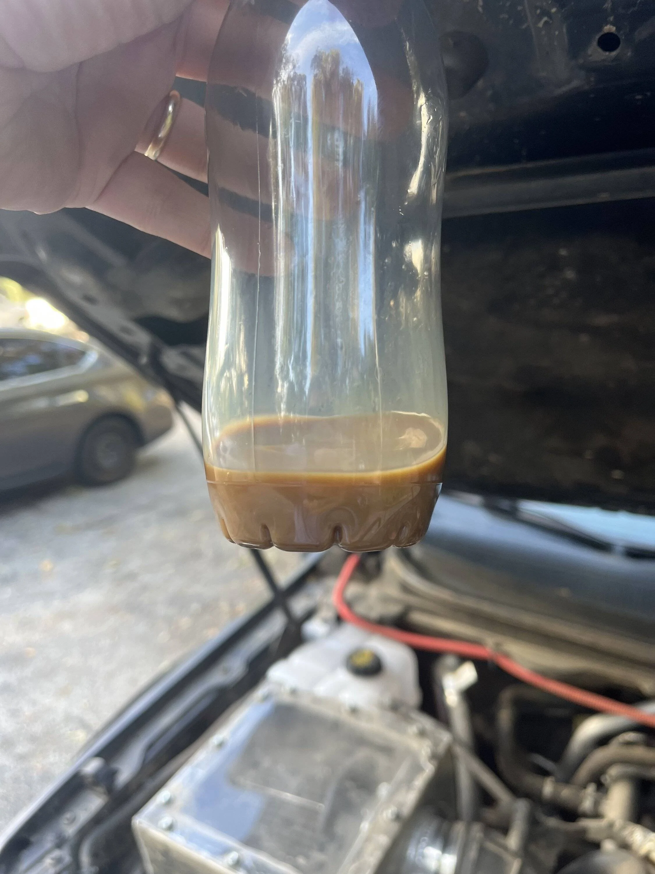

I recently experienced the smell of oil in my AC, so I pulled my oil catch-can and checked my oil. I will edit this post with pictures from the catch-can, but it appears to indicate moisture in the crankcase. A friend suggested I may have a vacuum leak somewhere. I have about 114k miles on my 2019. My last oil change was 4000 miles ago with no issue and almost nothing in the catch can.
If it matters, in that 4000 miles I did spend a week in the Smokeys at highish RPMs (all on road) in cold weather (20s-40s).
Is there a common place one of our motors will develop a vacuum leak over time?

Condensation in a catch can and crank case is normal. It is much more prevalent when the weather is cold. It is not unusual for me to find a 1/4" of ice in the bottom of my catch can in the winter.
A vacuum leak would not impact the amount of moisture in your catch can or crank case.
The smell of oil coming in via the AC would more likely indicate an oil leaking past a gasket.

You have no problem my man!!! That would be called a cold weather catch.....lol.
Mine looks like that all winter long.....then very clear and golden in the summer...worry not.

And that looks pretty normal for a catch can IMO.
