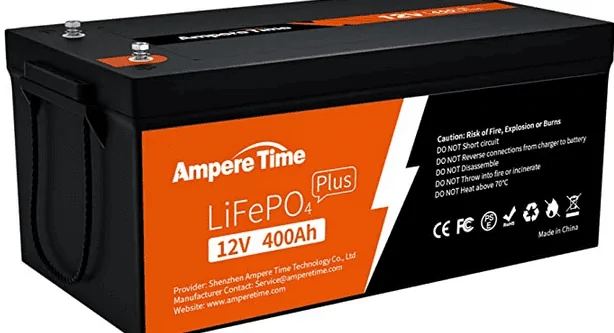

1200W microwave radiance translates to about 1320W draw, more or less, which is 110 Amps from your power source. We have a bank of four Battleborn 100Ah LiFePO4 feeding a Victron 3000w charger/inverter and that setup works just fine as long as it is just the microwave, but if we also try to run the AC (another 1200W) then that's too much draw for the batteries and we throw an undervoltage error. There are newer design LiFePO4 batteries out there (Ampere time is getting good reviews) that can handle that amount of draw from one battery (for example I have room for two of their 400ah):
Anyway, yes, it can be done fairly easily, but can get pricey to have something that really works. Our rooftop 400W of MPPT solar keeps the battery bank charged up enough for several minutes per day of microwave activity during the longer days.
You could probably make it work with a somewhat smaller inverter, like the Victron 2000W, but in order to satisfy the current draw you'll need something like the above battery or a bank of smaller ones).

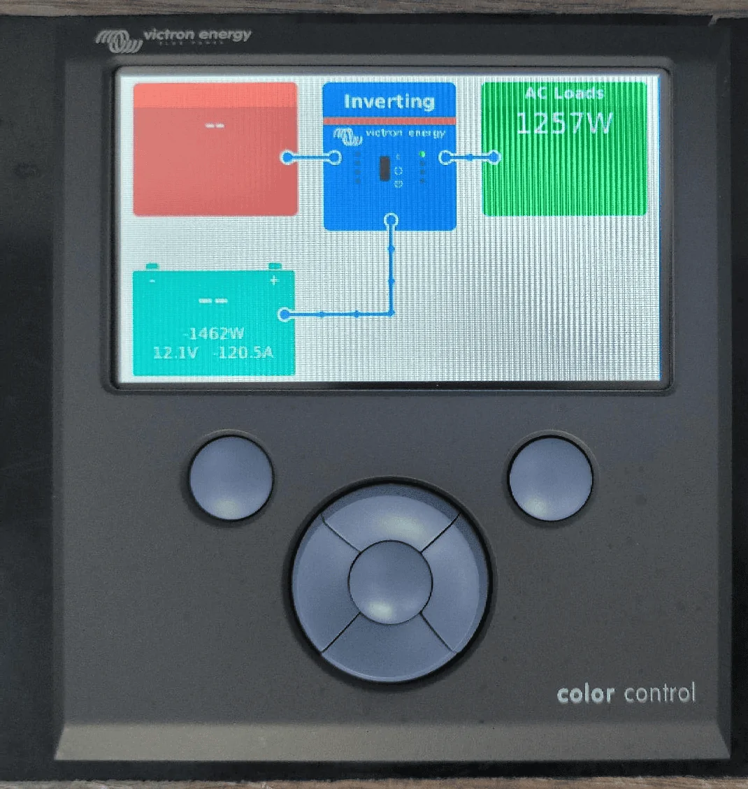

So I remembered this thread while heating something up just now and took the following snapshot of the inverter monitor.
As you can see, the battery bank is getting hit for 1462W, but the microwave is only pulling 1257W, so in this snapshot of efficiency we get (1462-1257)/1462=14.02% inversion cost. One other interesting thing is that my battery voltage without load was around 13.2V and it dropped to 12.1V under load. Thus my current debate about chucking the 1 year old Battleborn 100Ah bank for two of the AmpereTime 400Ah. I would add only 30lbs to the trailer, but pick up another 400Ah of power and likely be able to "use" more of the capacity of the battery before tripping low voltage.
Anyway, net-net, we should probably amend the earlier math to bake in a 14-15% loss rather than the previously assumed 10%.
