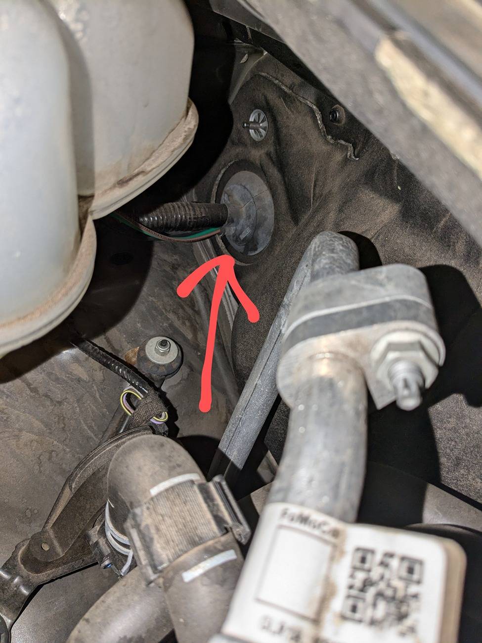

There is an easier place to do this on the passenger side, behind and up from the glove box. You can see it from the engine bay, behind the coolant reservoir. The big rubber grommet has a small pull out tab on the lower half that you can remove to open up a small access hole in the grommet. Put some kind of quick connection on the wire from your solar panel (which I assume has a built in charge controller, right?) and you are good to go.
Here you can see my lightbar wiring going through this grommet.

Thanks, that looks like a great option. I will take a look at the grommet you are referencing. The charger I bought is: ZOUPW 30W 12V Solar Charger and does have an AGM compatible controller on it. It comes with a cable to attach to the battery terminals, so if I can thread it through, it will be a no brainer.
