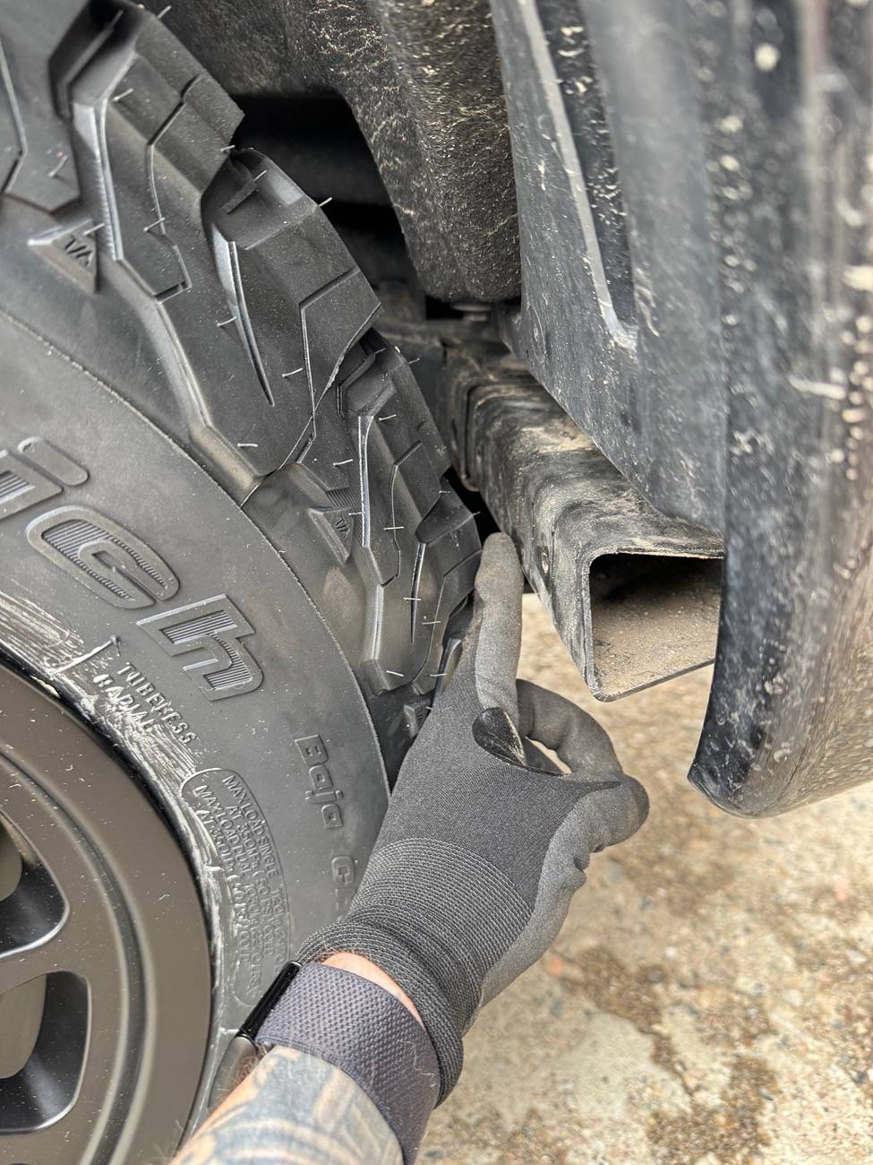

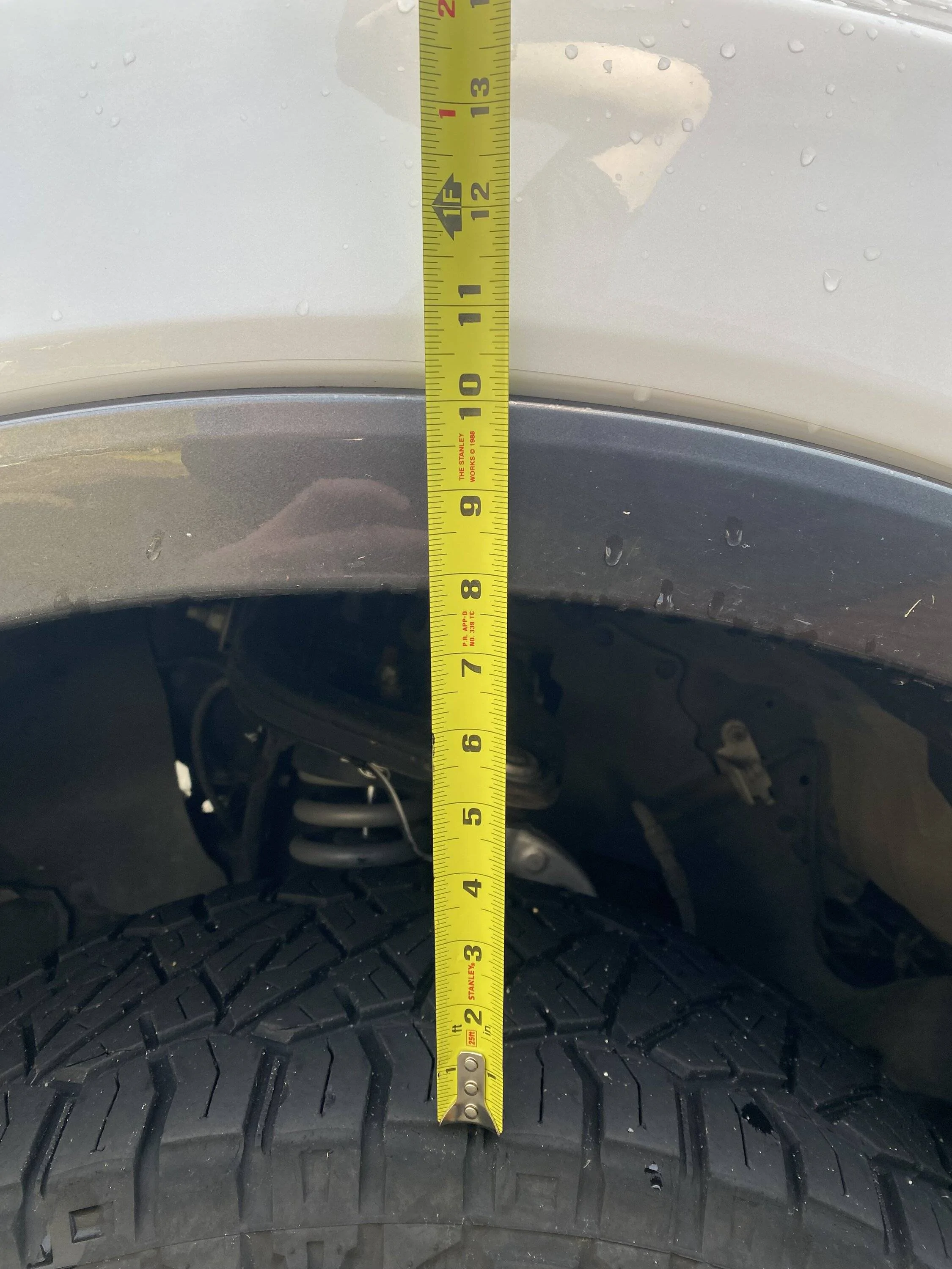

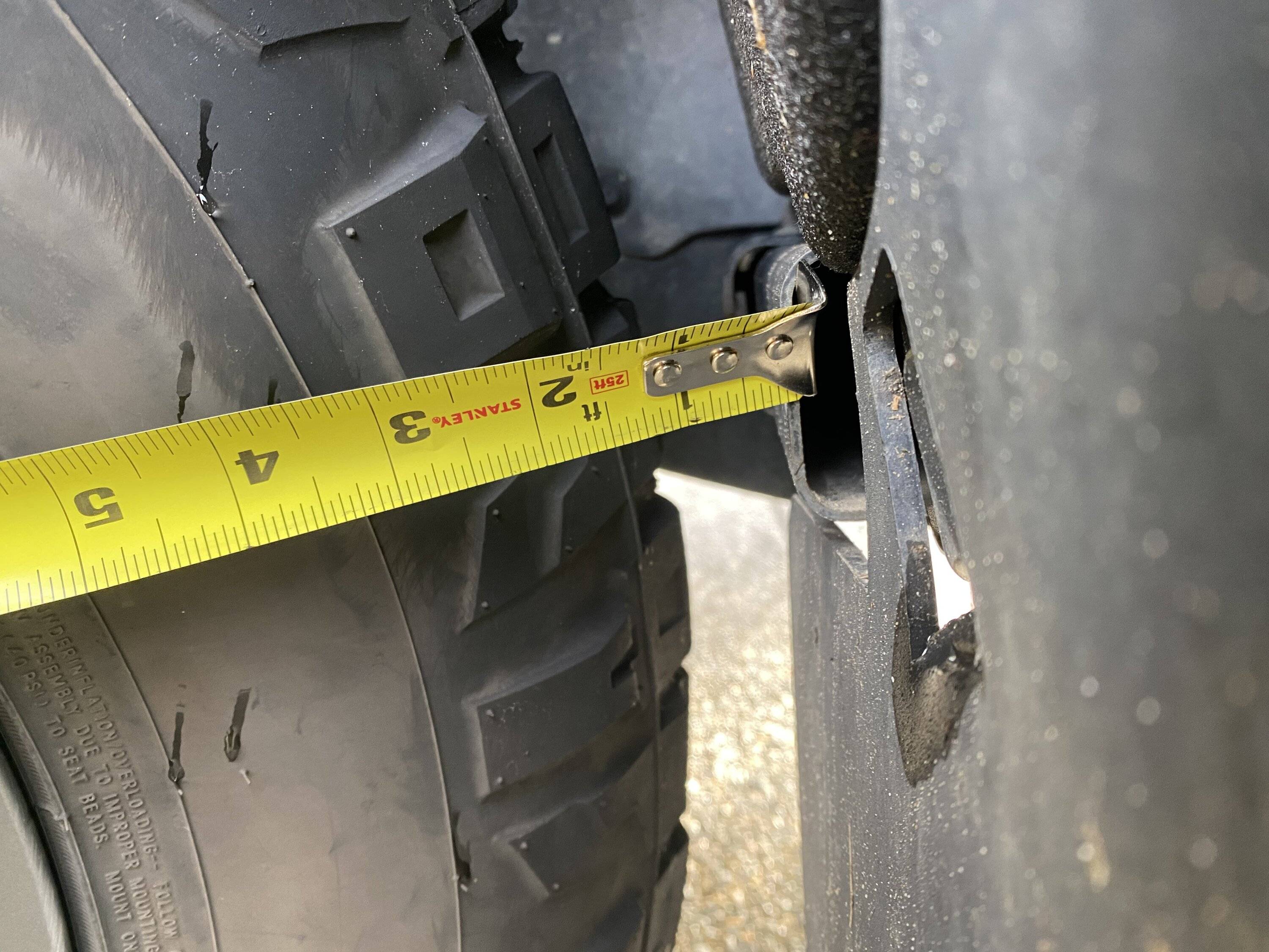

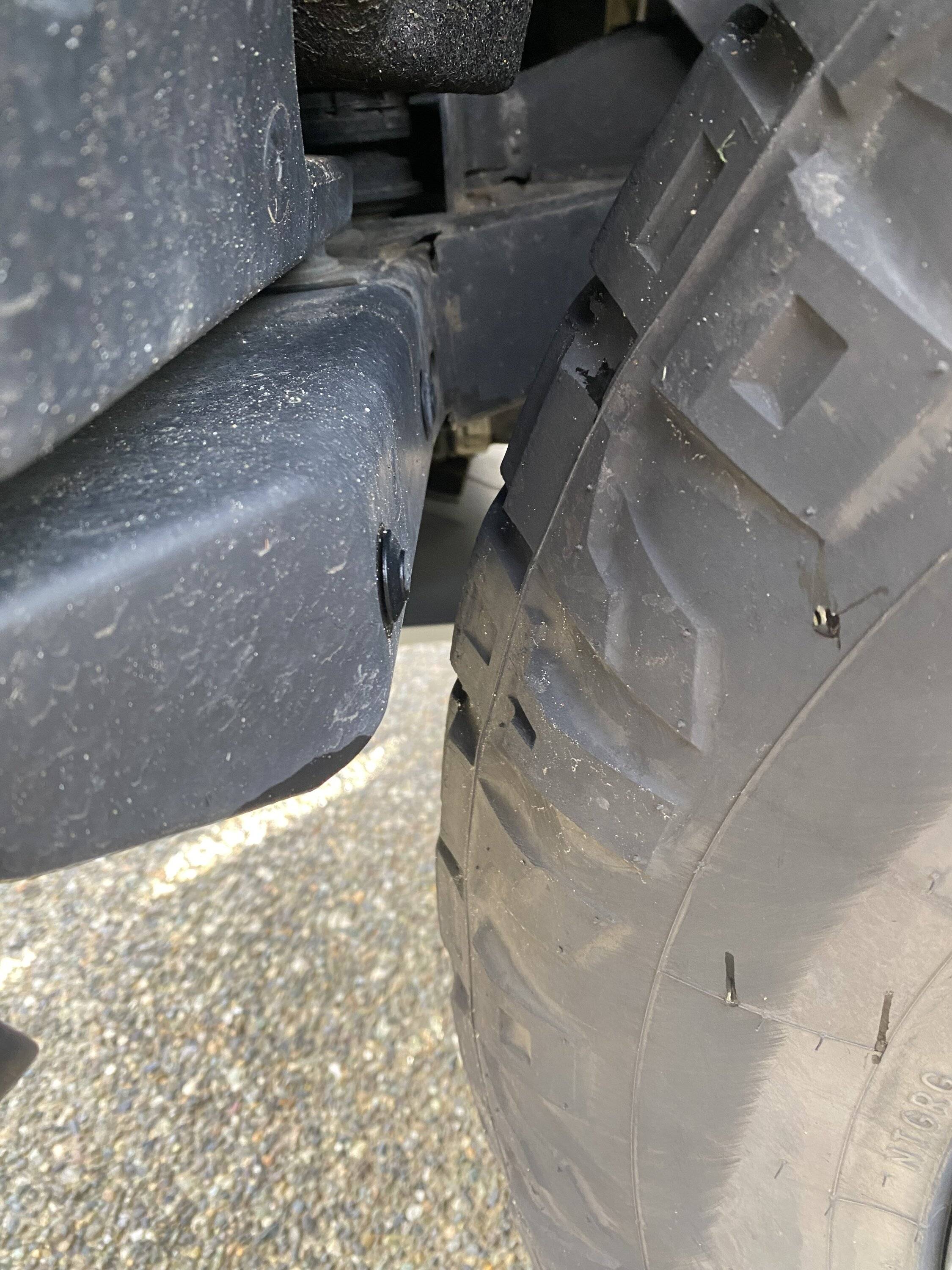

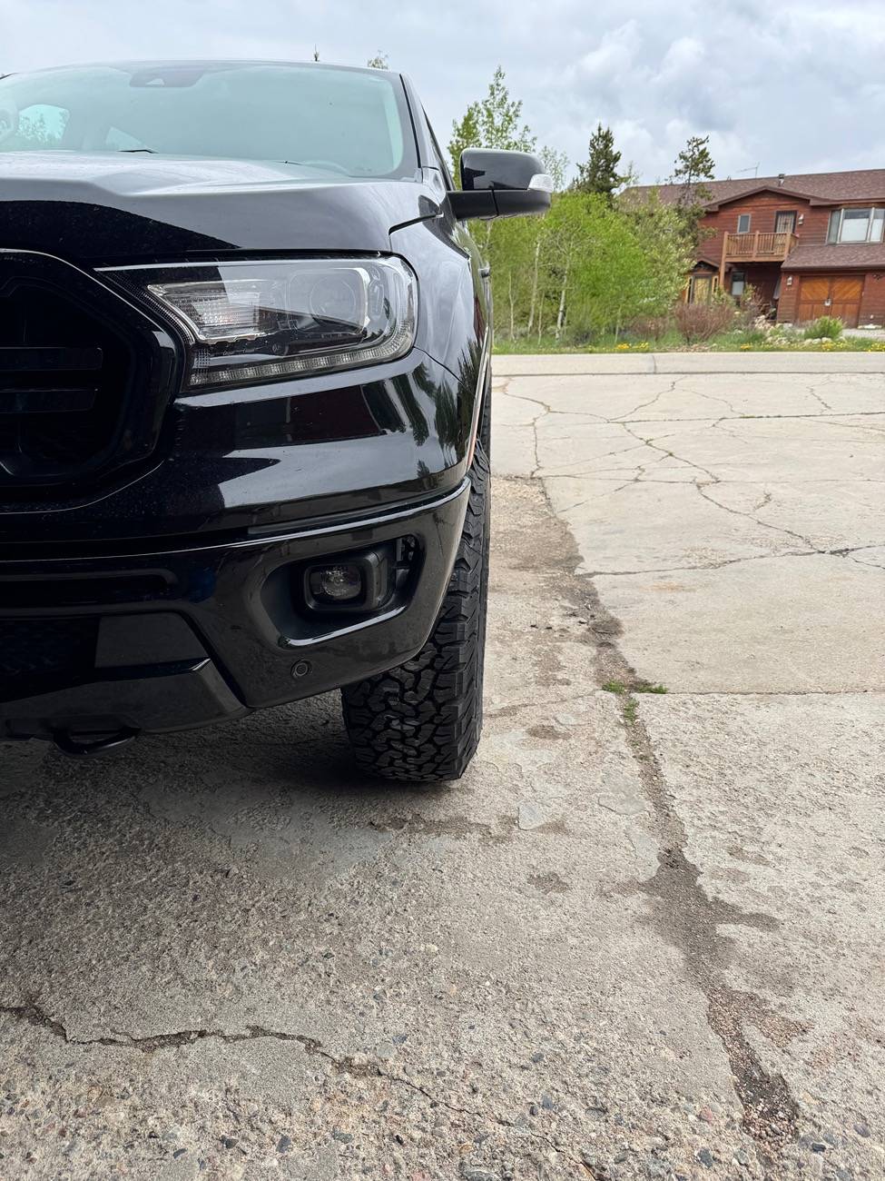

Reviving this thread.
I just installed a set of method mr 703’s with a set of BFG KO2s.
Specs:
17x8.5 +35
LT 265/70/17 load range C.
I’m on stock FX4 suspension, and had a little rub in reverse only on the drivers side. I ended up loosening the crash bars and nudging them forward - that solved the rub. Eventually I’ll get the fox 2.0s so hopefully that will give me a bit more clearance with the bars.

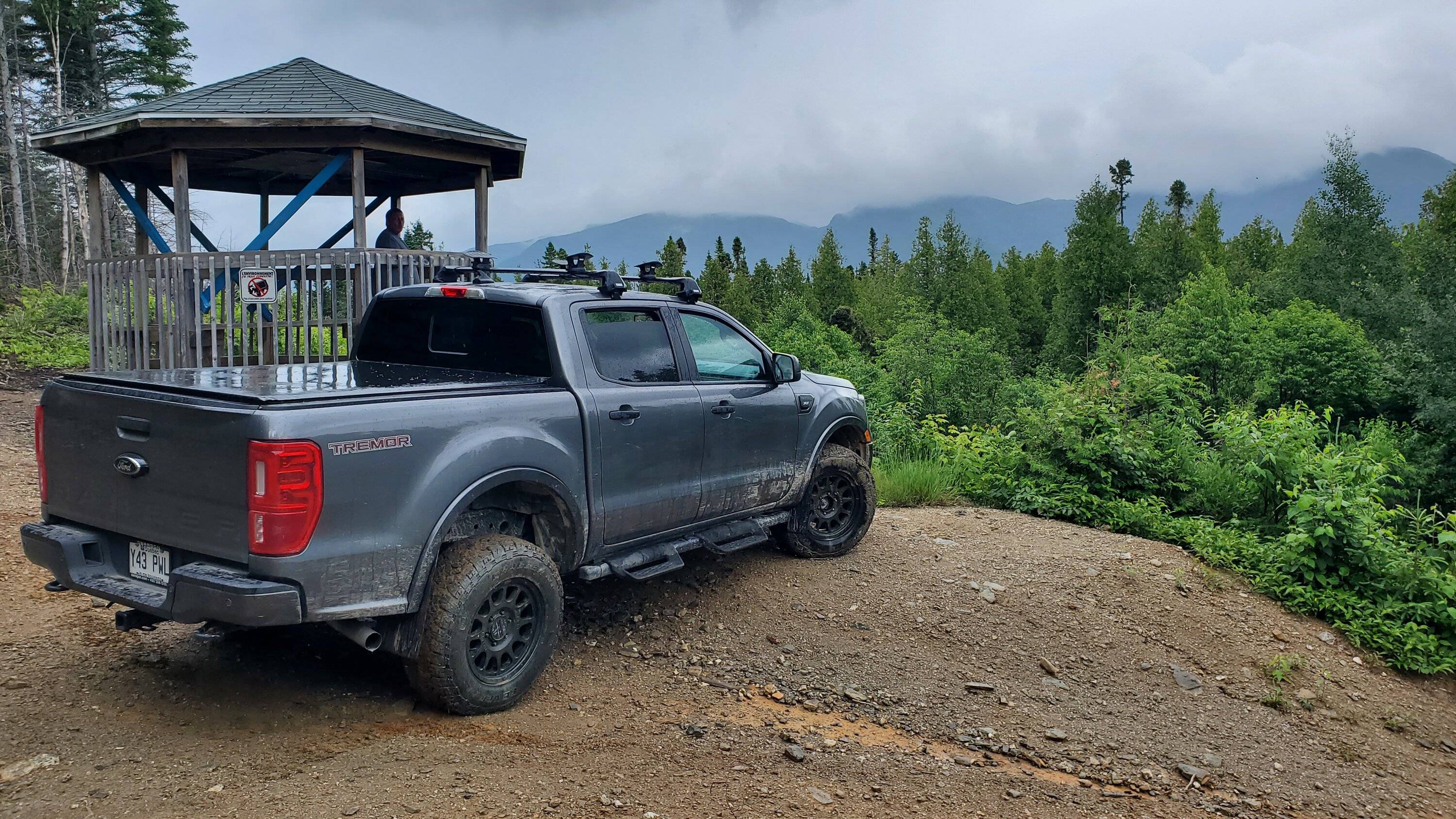

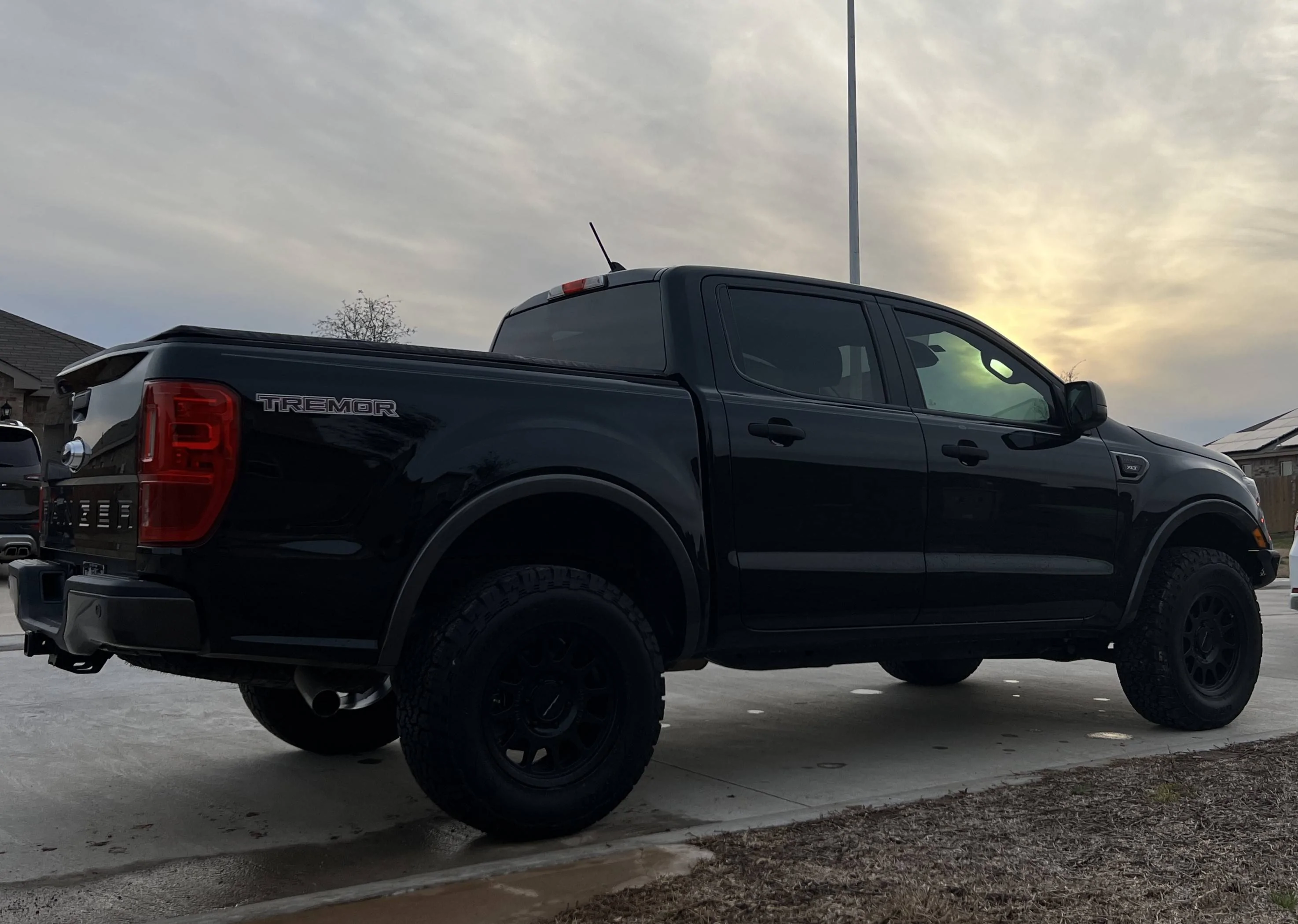

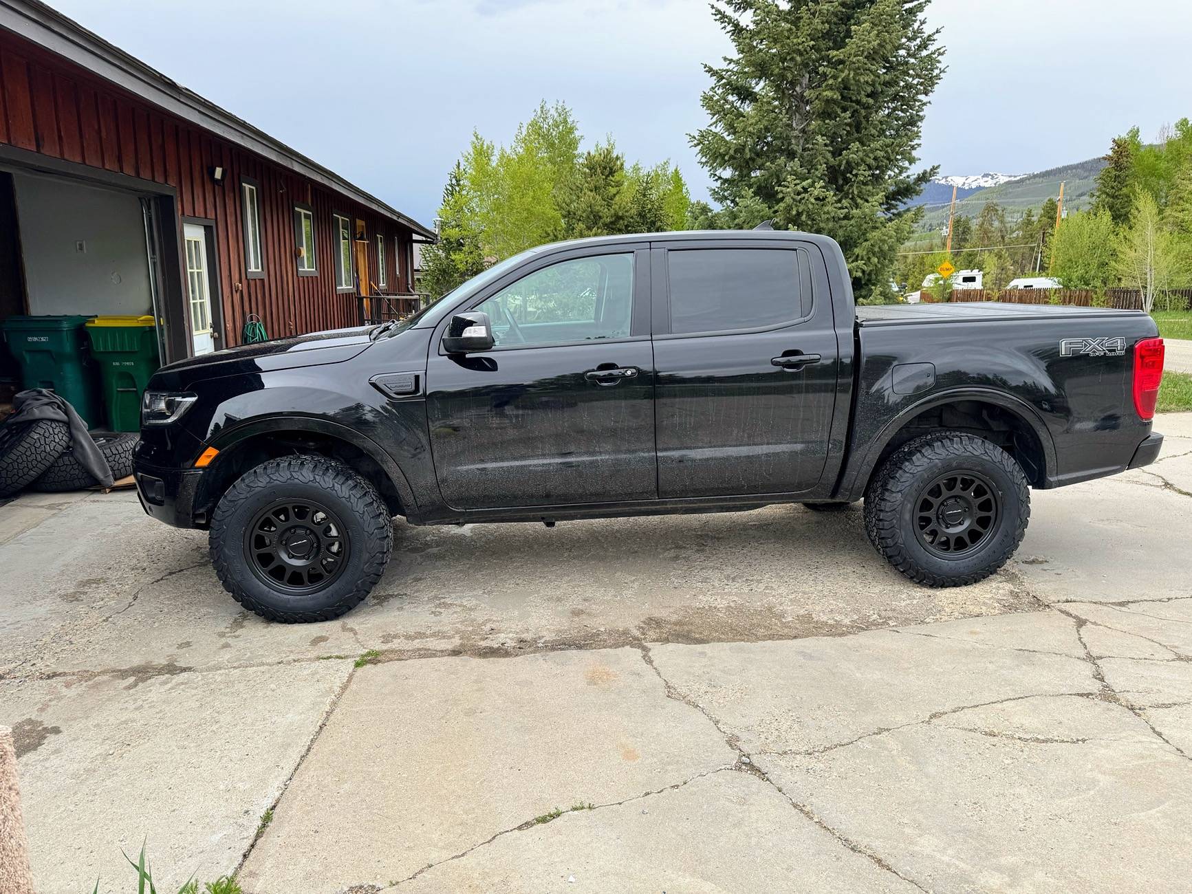

Just posting this in hopes it will help others in their wheel fitment search. I have posted photos below of the Method MR703 in matte black that I recently purchased for my tremor. I have my front crash bars removed, but the suspension is otherwise stock. I remounted the stock tremor tires (265/70r17) to the new wheels. Specs are: 17x8.5 6x5.5 +35 offset. There is 0 rubbing even when turning while flexed offroad. The +35 offset saves a ton of headaches regarding fitment. The 703s look really sharp on rangers, surprised there aren't more people running them.
I will post an update once I have my new suspension installed with 285/70r17s

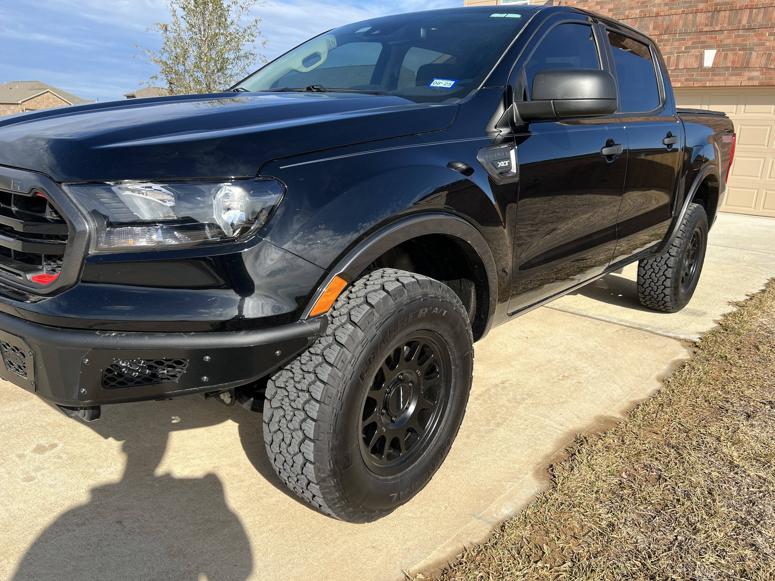

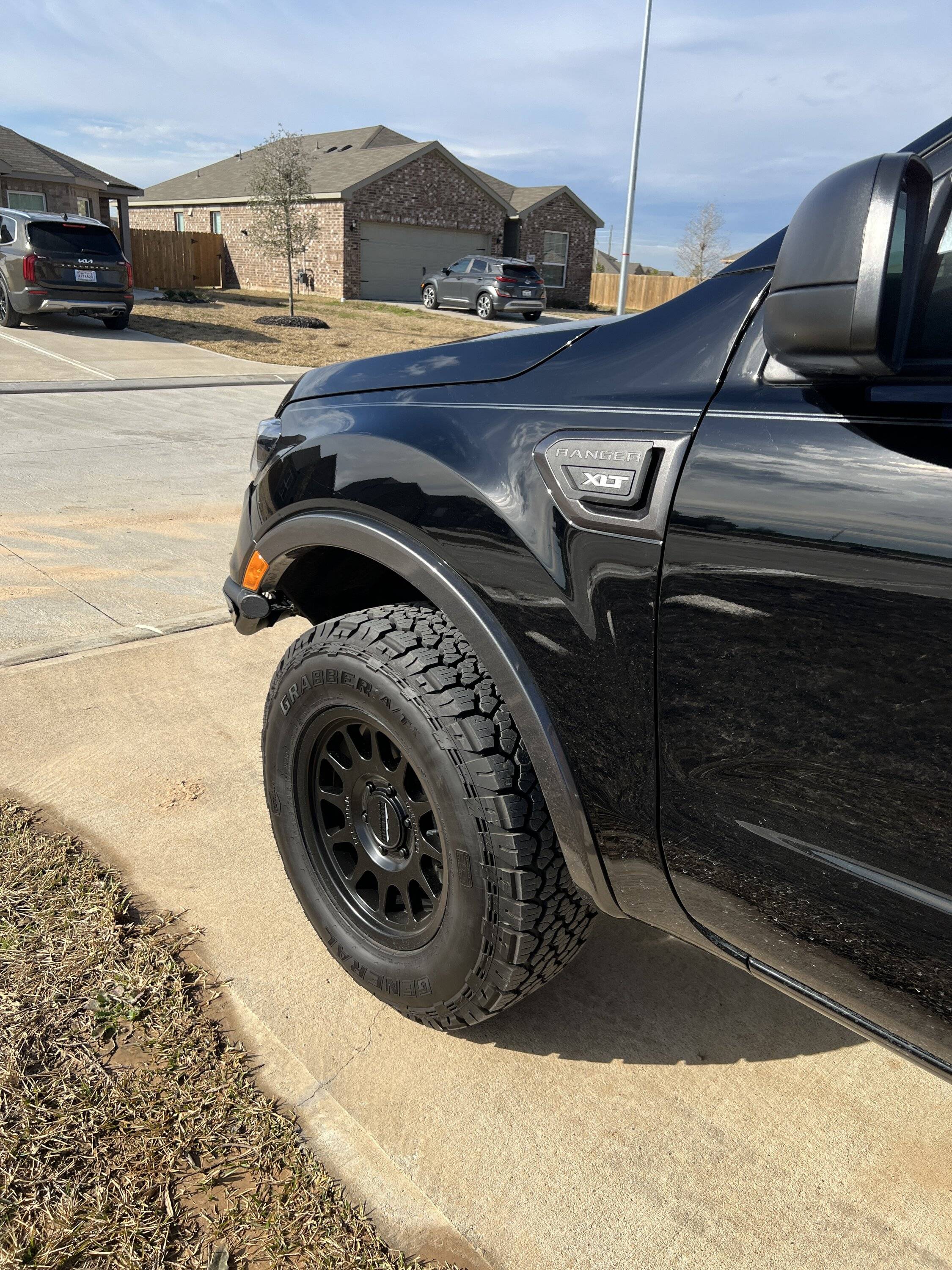

Just got the same set up with KO3s.
My tire guy said keep at 37PSI. But I thought it should stay at 30 like truck says?
Do you have any rubbing issues off-road? Looks like driver side might hit front beam.

What size did you go with? What load rating? Pressure is a personal preference. You shouldn't go below 30, since that can cause issues with safety. 37 seems high. The proper way to find pressure is the chalk test (LINK TO METHOD).

Went with 265/70/17
Load rating C I think
