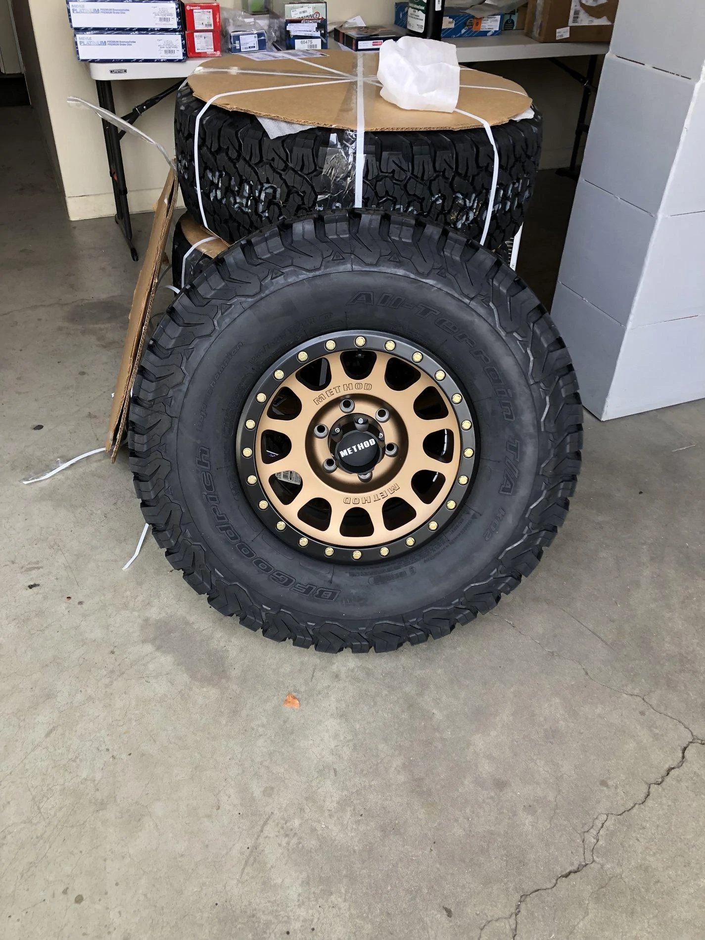

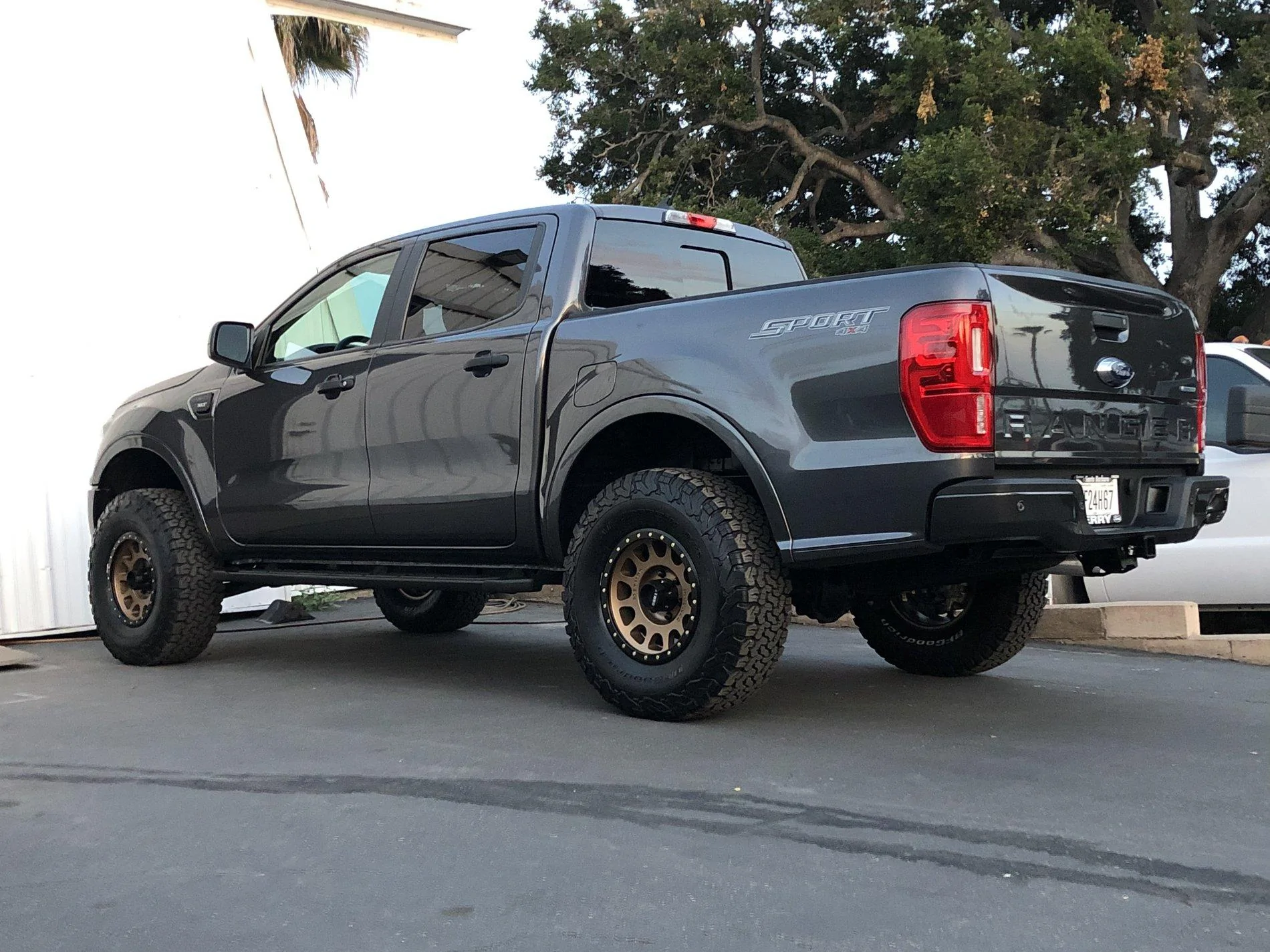

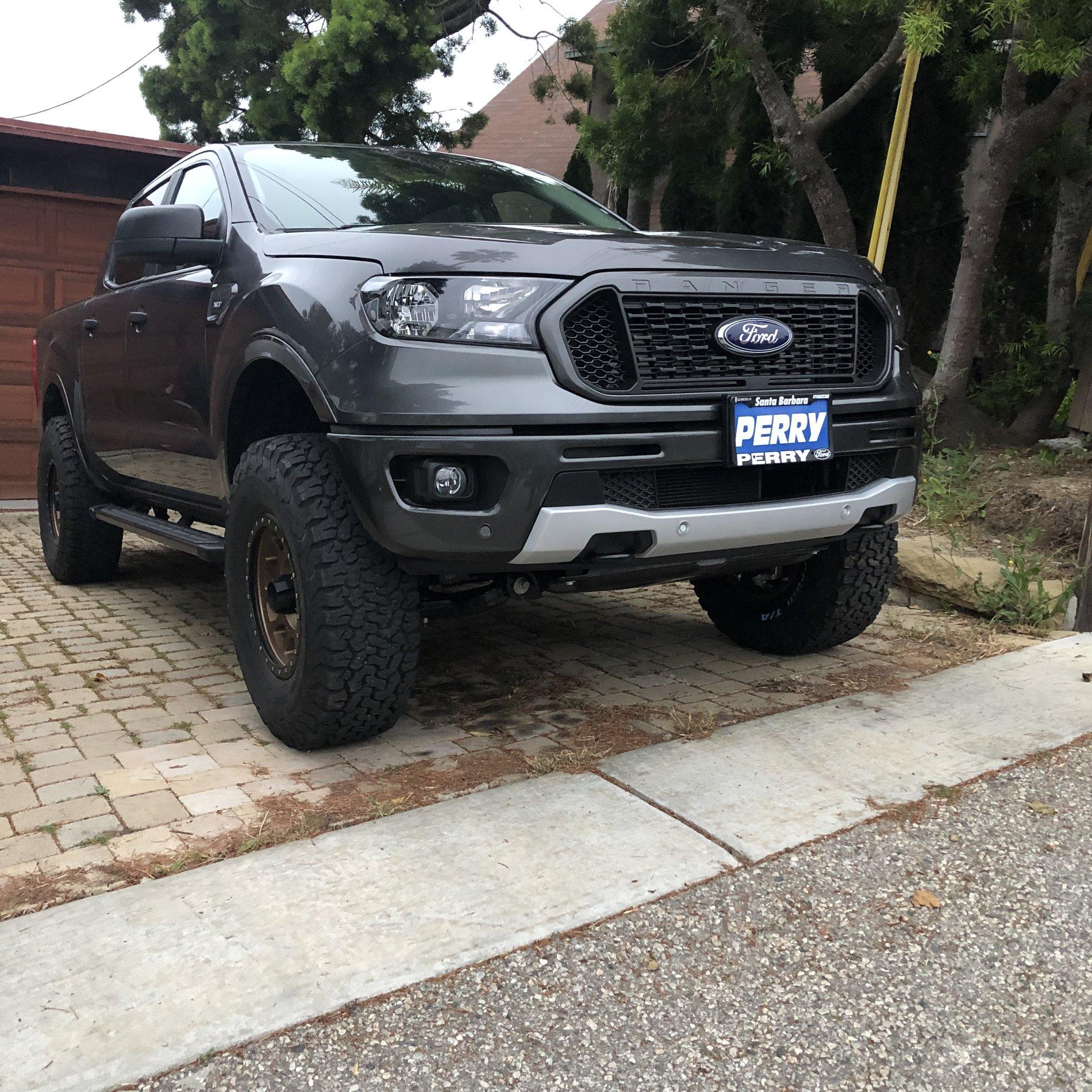

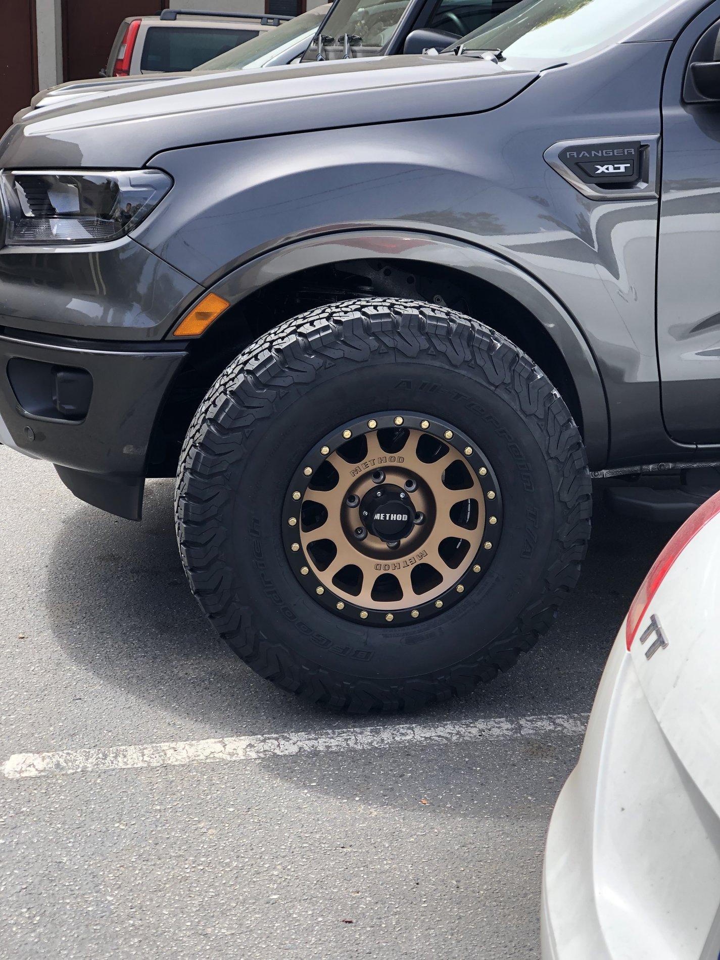

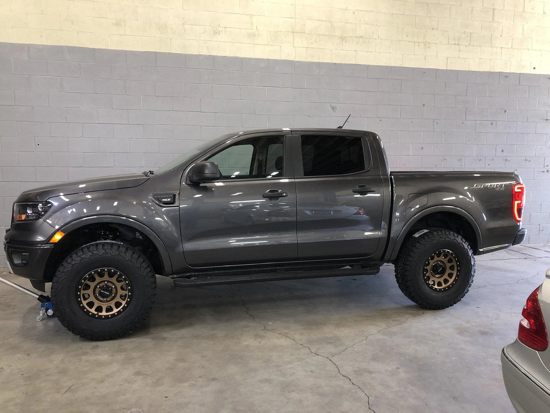

These are the wheels I decided to go with what do you guys think? Wheels are 16x8. 0 offset and 4.5” backspacing. Tires are 285/75-16.
Is it only leveled and no rubbing? Only needing to trim the bottom piece? Is it rubbing on the knuckle?

I want the same wheels but in 20s with less rubber! Lol. I think the bronze will play well with silver. Am i crazy?

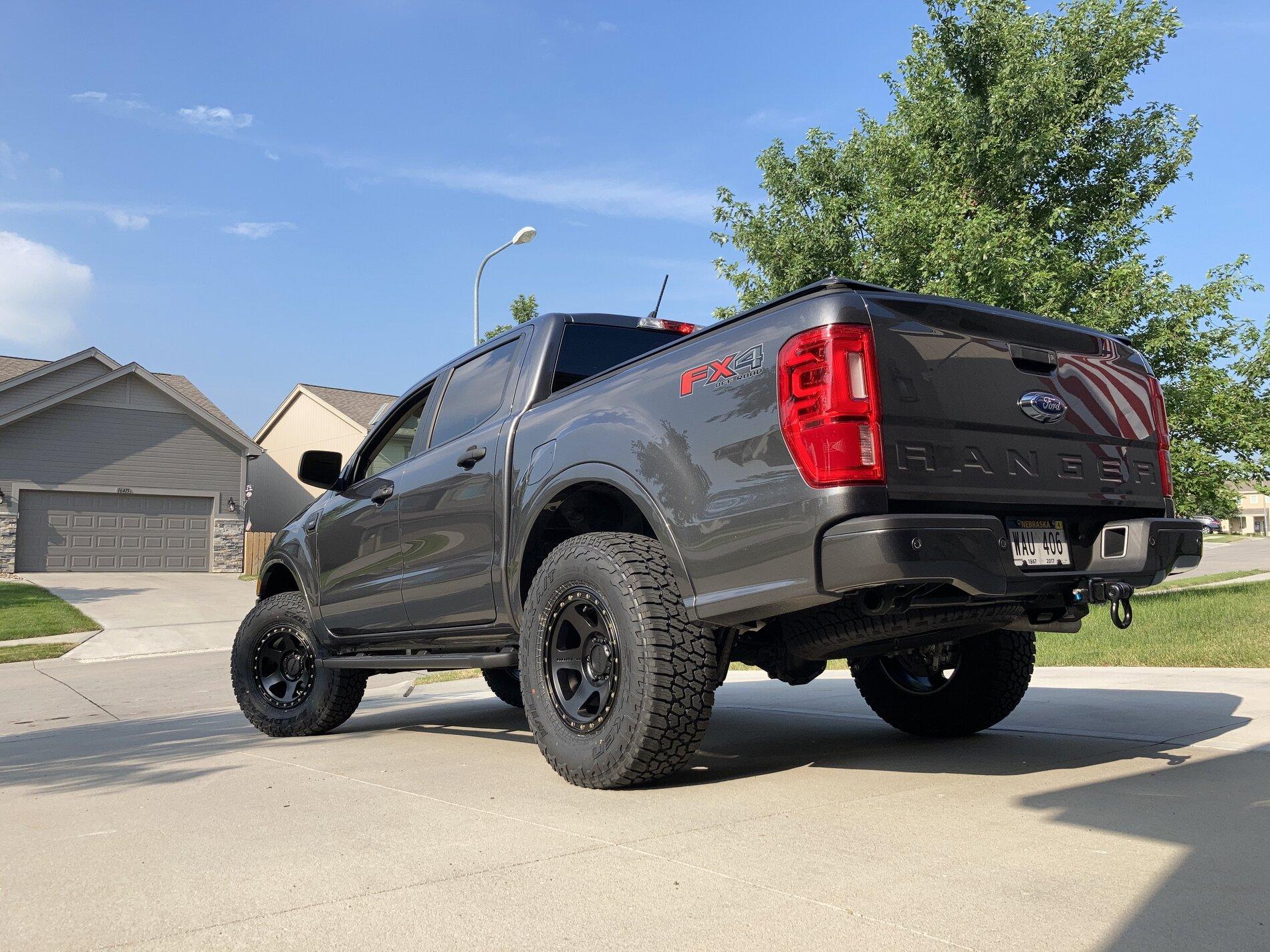

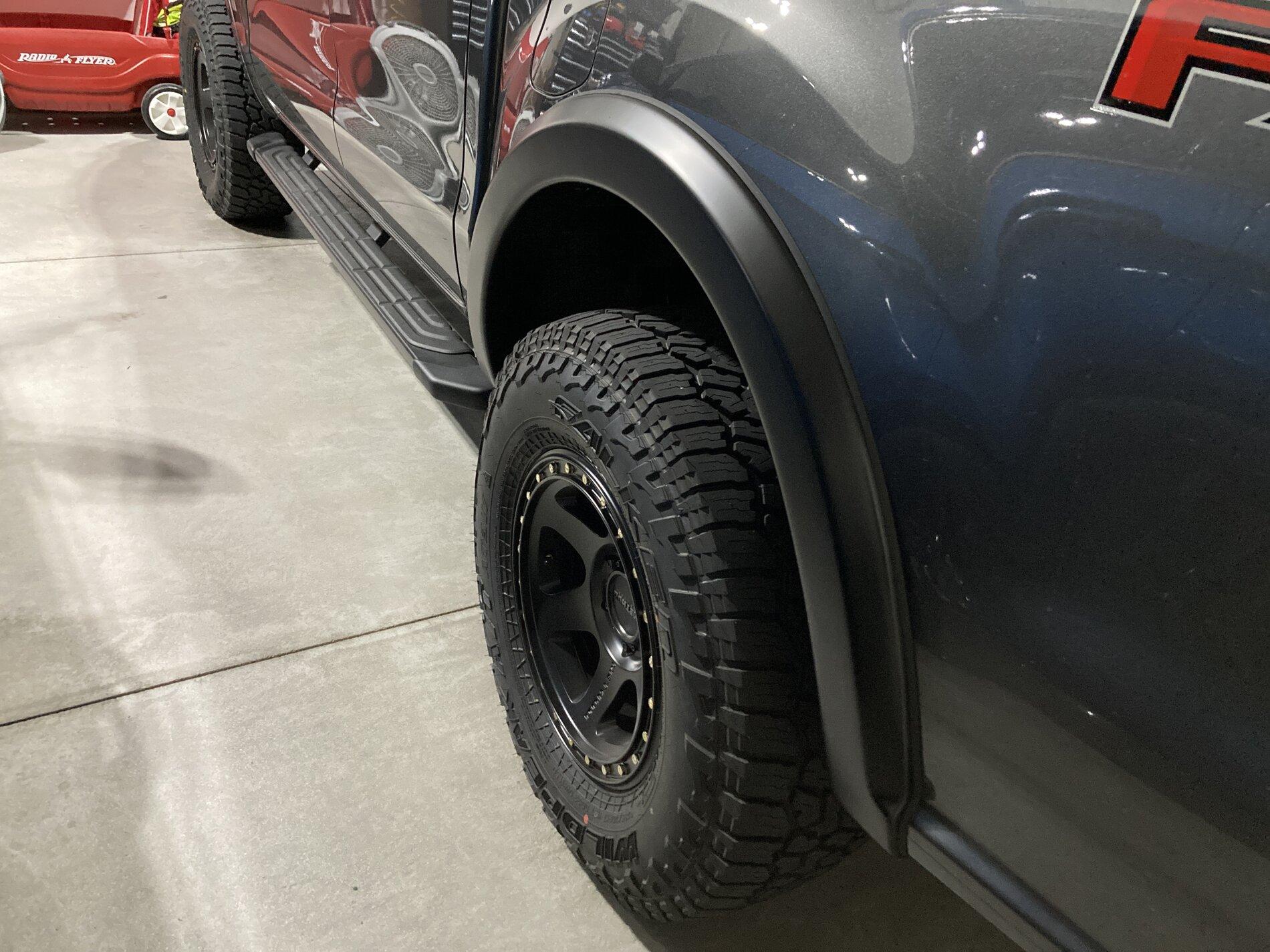

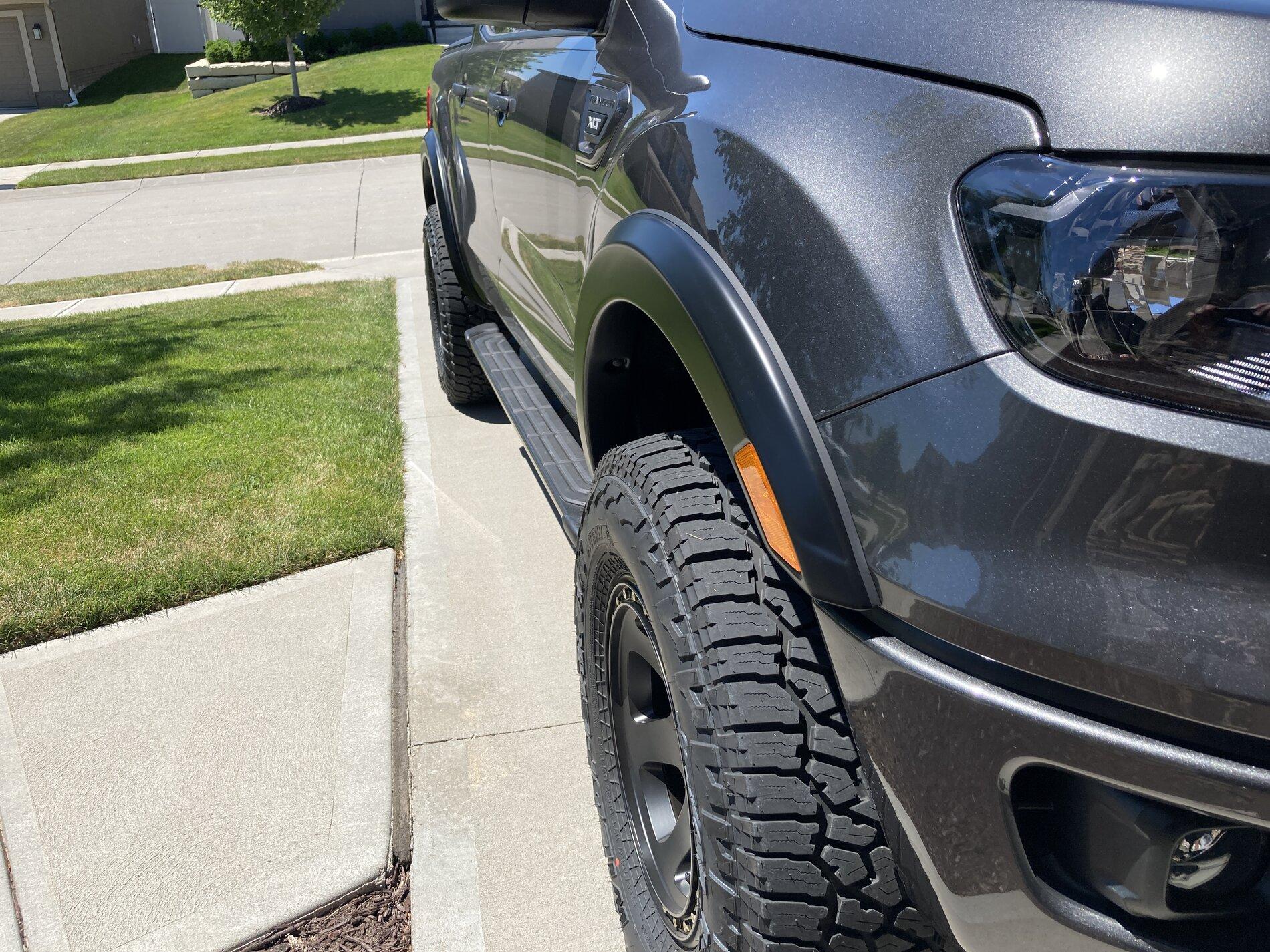

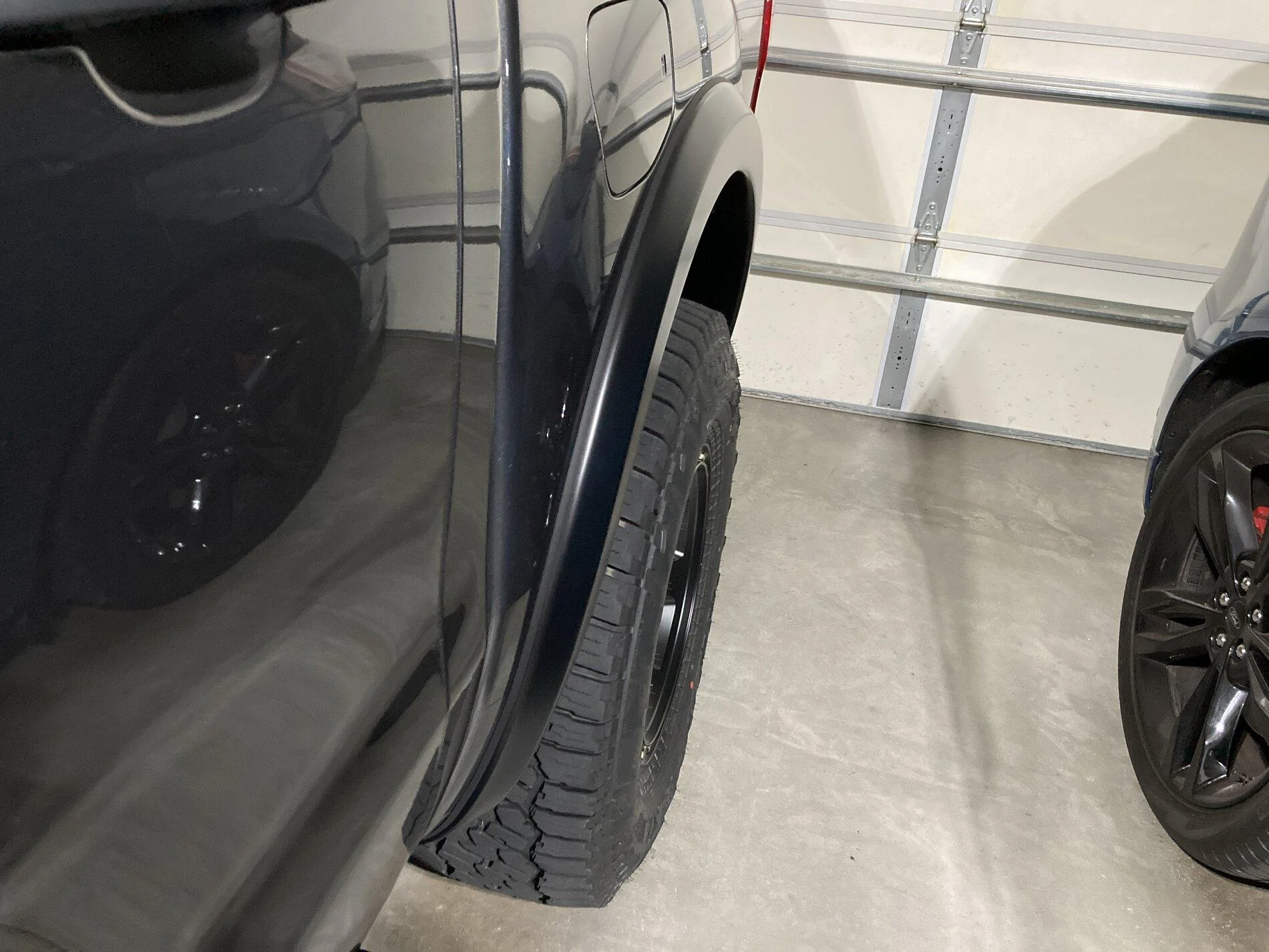

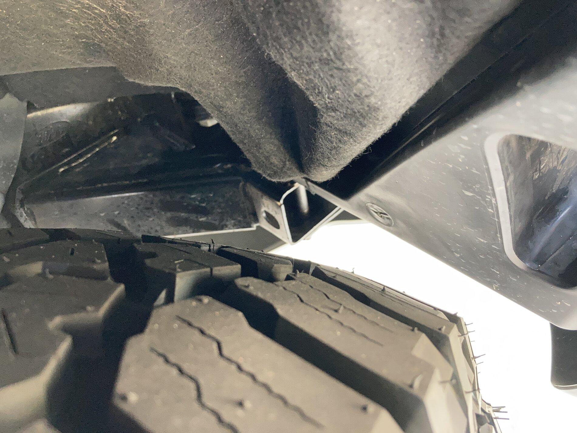

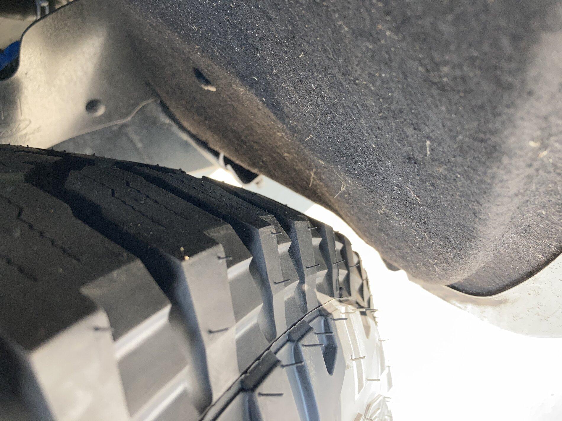

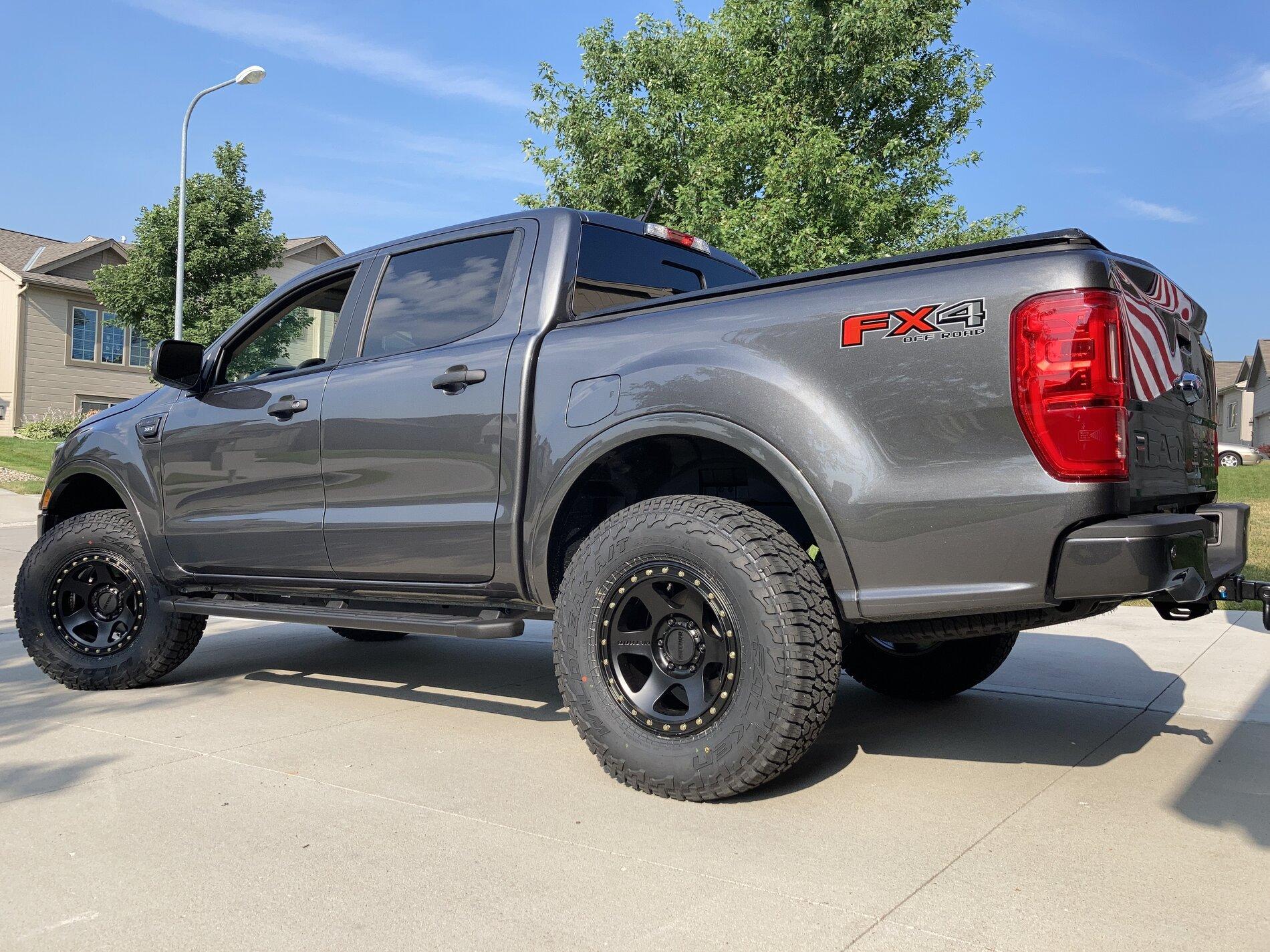

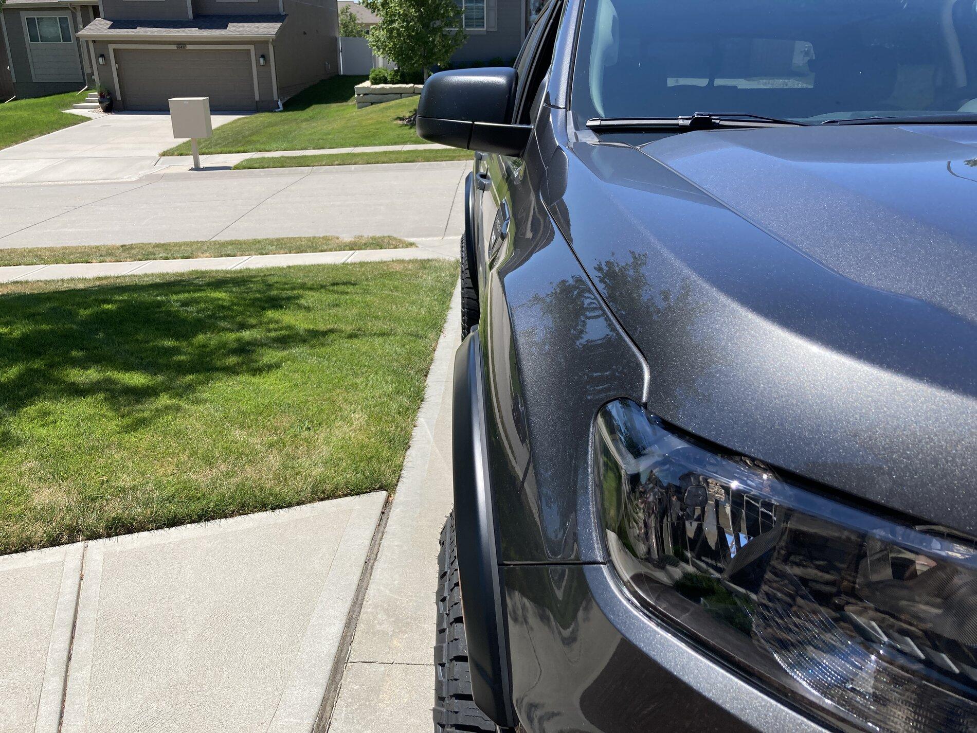

I purchased from DT Method 310's in the same 0 offset and 17x8.5 size as the 305's come in. Tires are a Falken AT3 in 285/70/17.
Sorry the pics are in weird order. I also installed BDS intrusion bars not shown and then added the Bushwacker OEM smooth flares (PITA).
I didn't have any rub before intrusion bars/flares. But now every once in awhile at full lock in reverse i'm hearing/feeling something. I see slight marks on both rear intrusion beams about 1/2" long from the tires. I think i might be able to push them back every so slightly more.
I also think the lower inside corner of the flare might be catching. I lost about 1/4" of space with the flares vs no flares. I may dremel that down slightly as it can't be seen from the outside.
Also, These are SL tires and they are still heavy. I've definitely lost about 2+ mpg on highway and the truck just feels heavy. I knew this going in but wanted folks to be aware Though these will likely last me forever, I may drop down to a 275 or 265 tire just to get some acceleration and mpg back. However the look is awesome and I can't wait til winter.
Unfortunately there is no where to wheel around here within 500 miles. So i'm a mall crawler. :)
