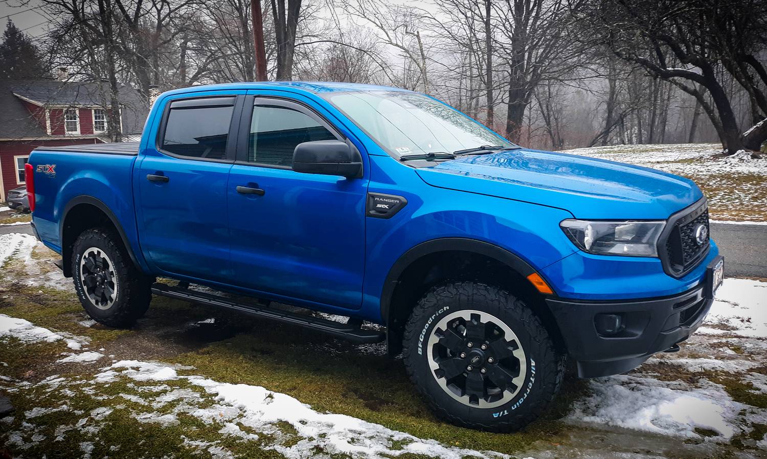

I've got 265/65R18 BFG KO2s on stock suspension, no rubbing. 2" level with Eibach 2.os as soon as I can get an appointment at my dealers to get them put in.

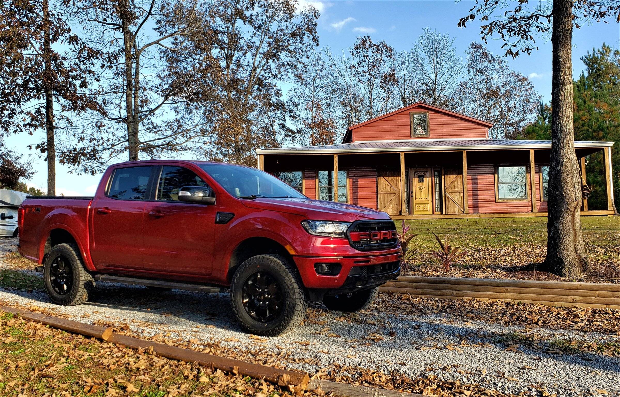

I wanted something simple that would maintain full off road capability so I went with 275/65R18 Falken Wildpeak AT3's on the 2.5" Torch Off Road front leveling spacers .
I've hauled azz through the pasture a couple times and nothing scrubs . It may be different if you only do highway but when things scrub it usually doesn't go well .
I think i will get that tires as well....thank you
Good to know, thank you
