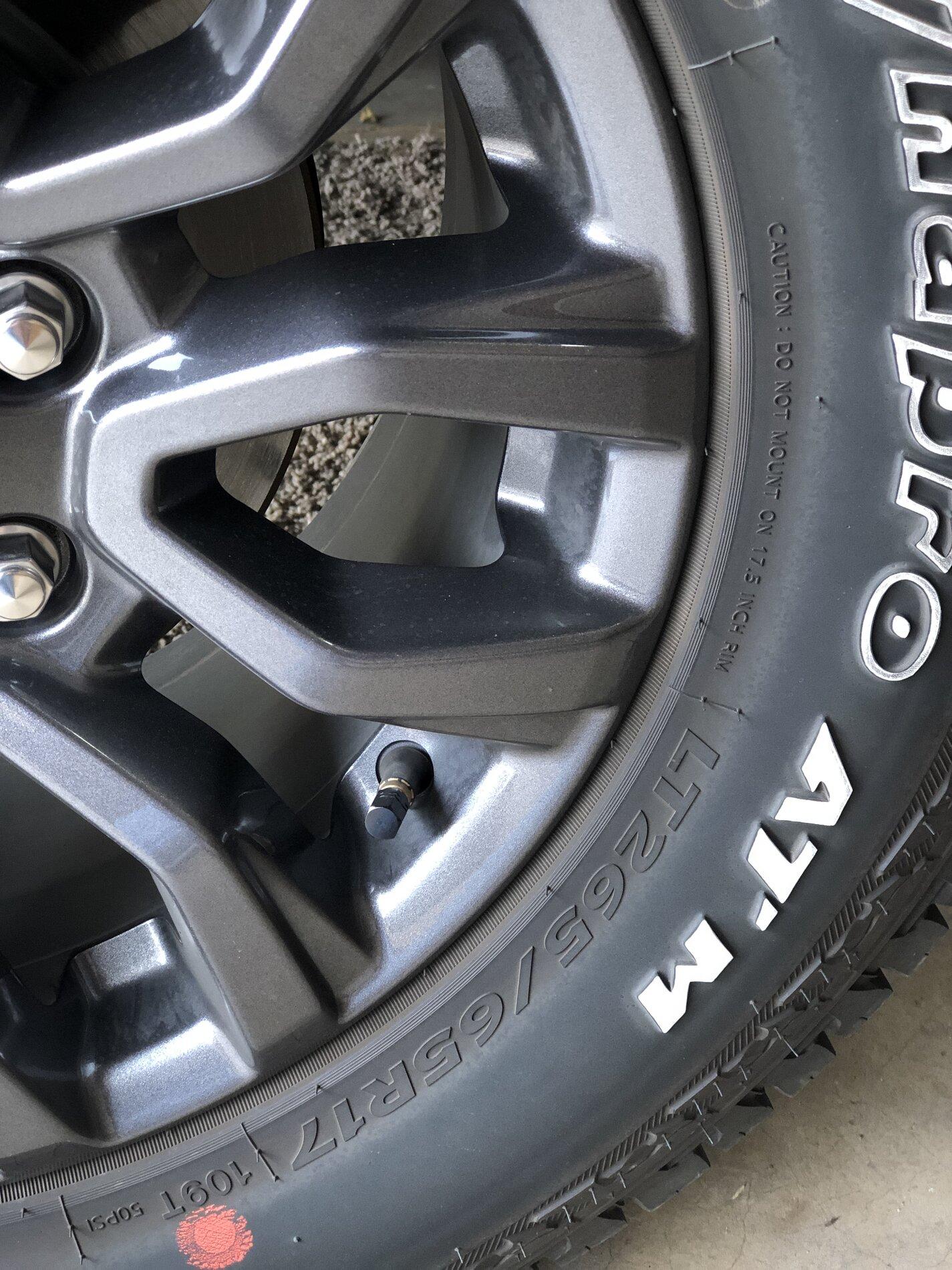

I still have the stock 265/65R17 Hankook tires on my Ranger. I will be moving up to a 265/70R17 in the future. I checked out the same Hankook tire in that size and they are SL with a 4-ply sidewall, which I thought I might be happy with because of the lighter weight and more compliant ride, but I learned that only the LT version of this tire is 3-peak snow rated. After my Hankook's great performance in the snow last month, I really want to stick with a tire that has the 3-peak snow rating. I couldn't find this information about the Maxxis. I think they are M+S and not 3-peak. Right now KO2s are at the top of my list.

These are my stock Hankooks.
Interesting my 265/60r18 Hankook Dynapro ATM are no lt..
They have a load range of 110T..
The maxxis 115t would be higher rating..

I don't understand it 100% but sidewall rating, the letters, indicate the number of sidewall plys in the the tire (or an equivalent). The load index number is a numerical rating based on its load carrying capability at the fully rated pressure. So I guess that my tire's C rating is when inflated to mfg specs and the load index of 109T is the rating when inflated to 50 psi.
