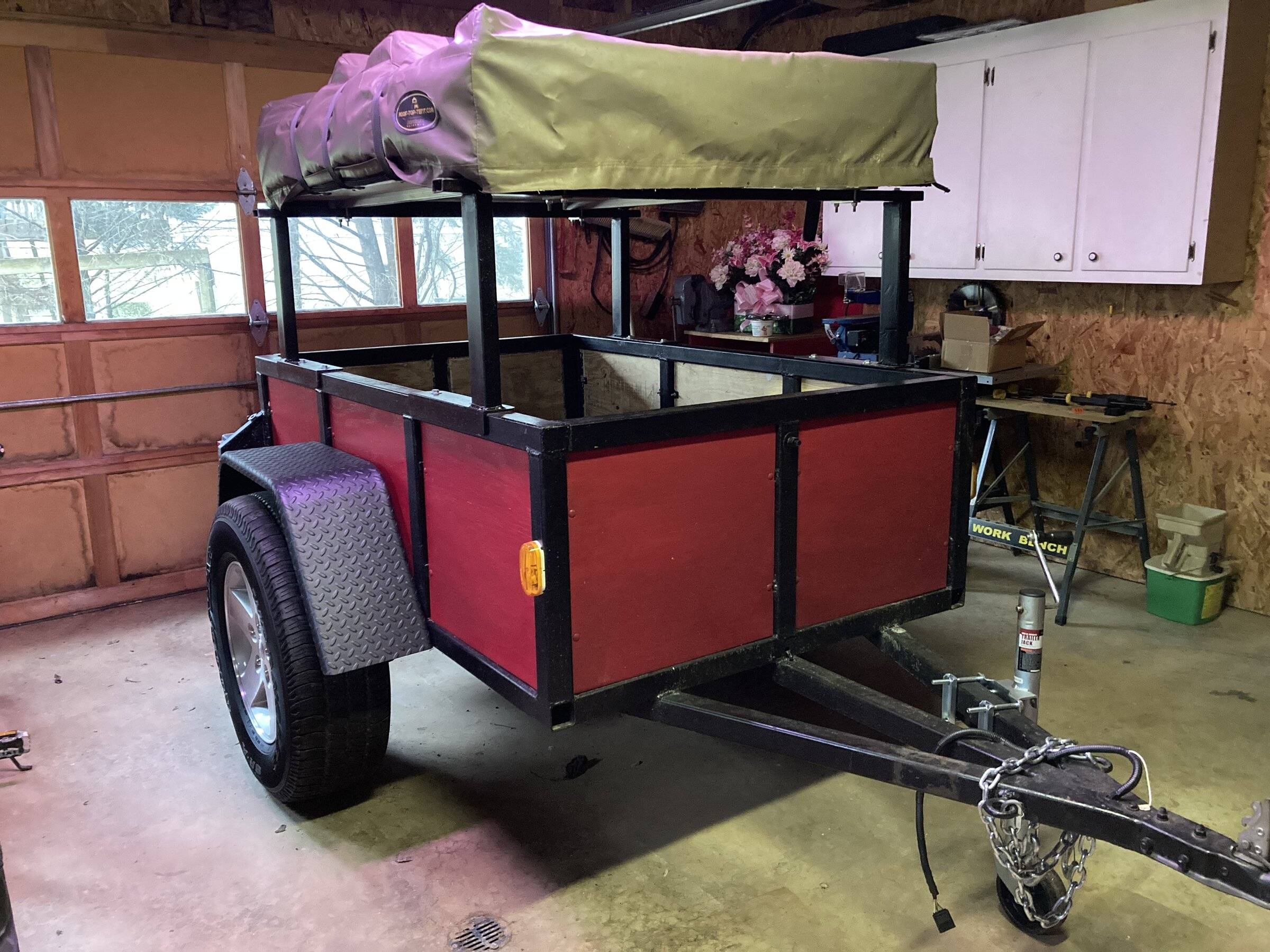

My homebuilt-in-progress trailer.

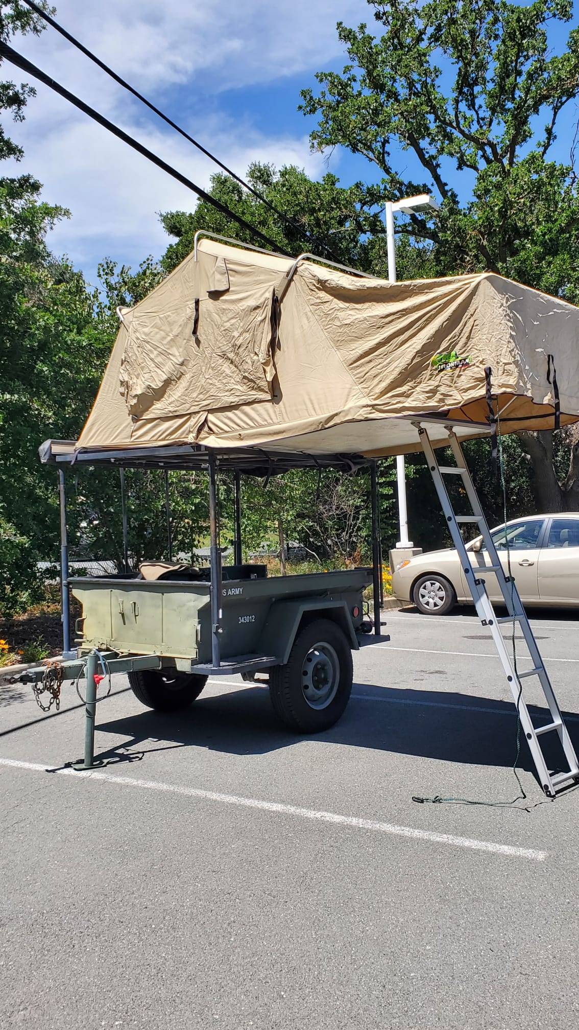

Just picked it up today, wanted to show off but not too many people in my immediate environment have an appreciation for this sort of thing.

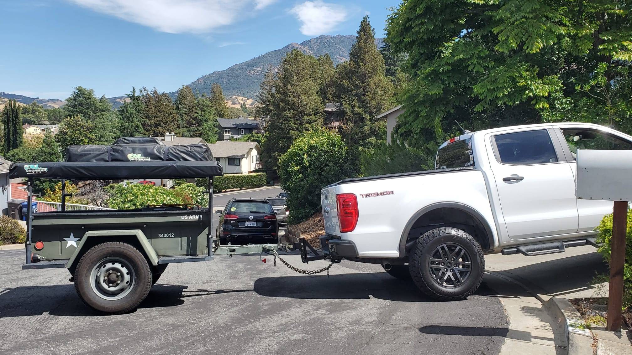

It's an original M416 with quite a few mods from the previous owner, including a telescoping strut-powered platform with RTT and awning. Also has line-x in the bed and they replaced the pintle hitch for a lock 'n roll type. They put it on 32s which tracks great behind the Tremor.

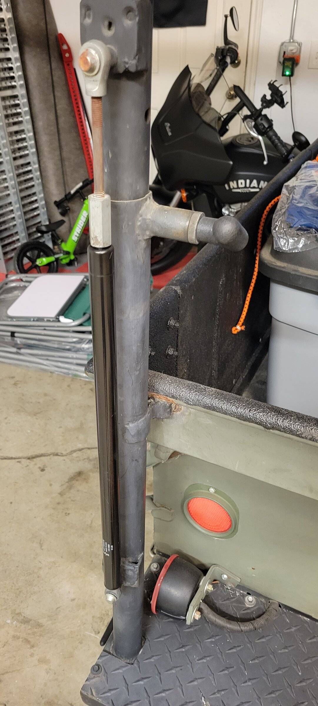

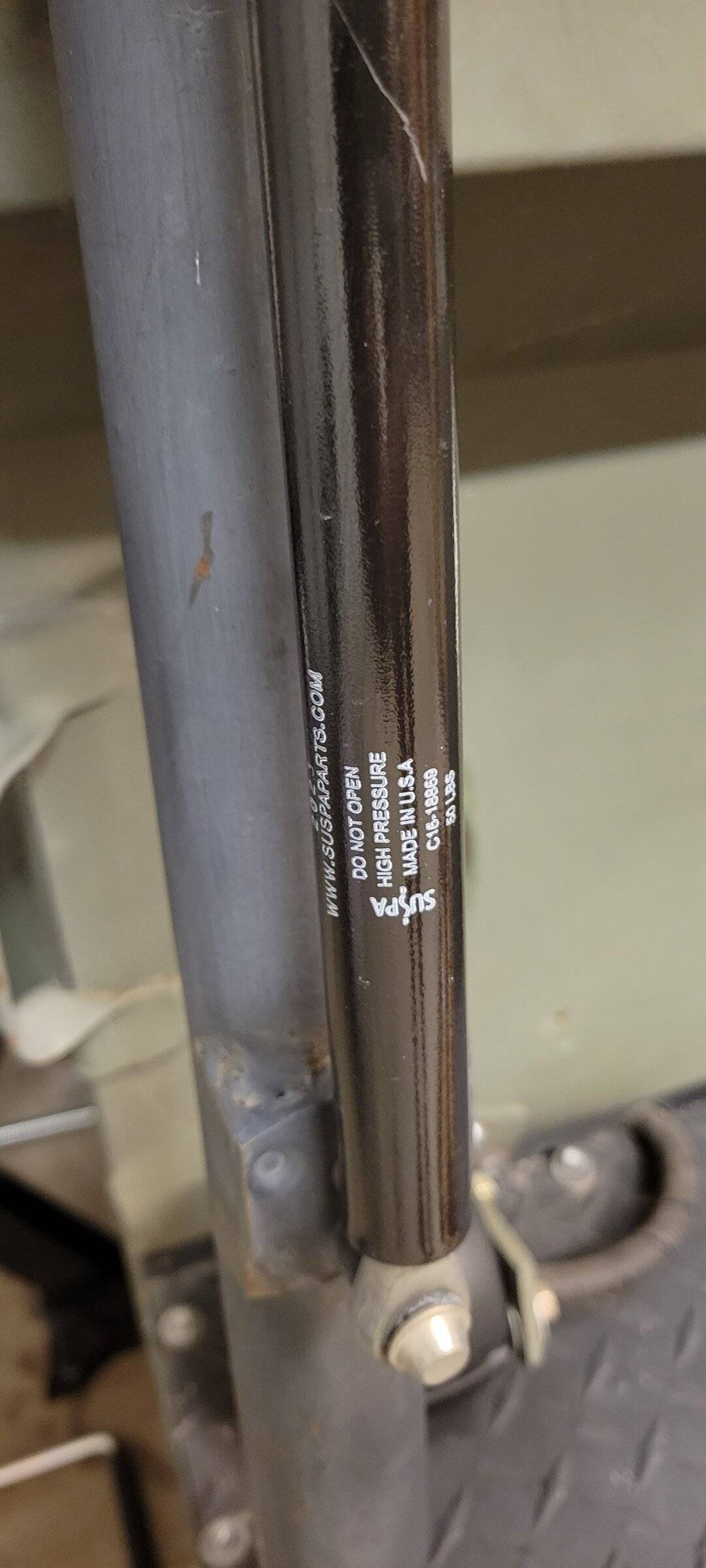

Here's some more detail on the rack. The way it works is you pull out the spring loaded pins one by one until they're all out, they the struts lift up the rack. Once extended the pins click back in place. To get it back down you need to pull it with two people.
Apparently the previous owner who designed and built it is a mechanical engineer. So far it has worked pretty well.
