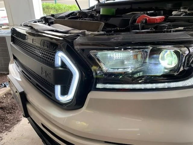

Installed it yesterday. Pretty straight forward. However, Couldn't get the passenger side to illuminate. Checked the connections, terminals were fine, reconnected everything, still no luck. Not sure what the deal is. Maybe I got a faulty LED/Wiring harness?
Looks awesome Mike. Hope you get the lighting issue figured out.

They did, thanks! Still haven't figured out the lighting issue. Submitted a support issue with RTR, have't heard back yet

Update: RTR sent me a replacement LED. Now just hope I don't break any tabs taking the grille back off....

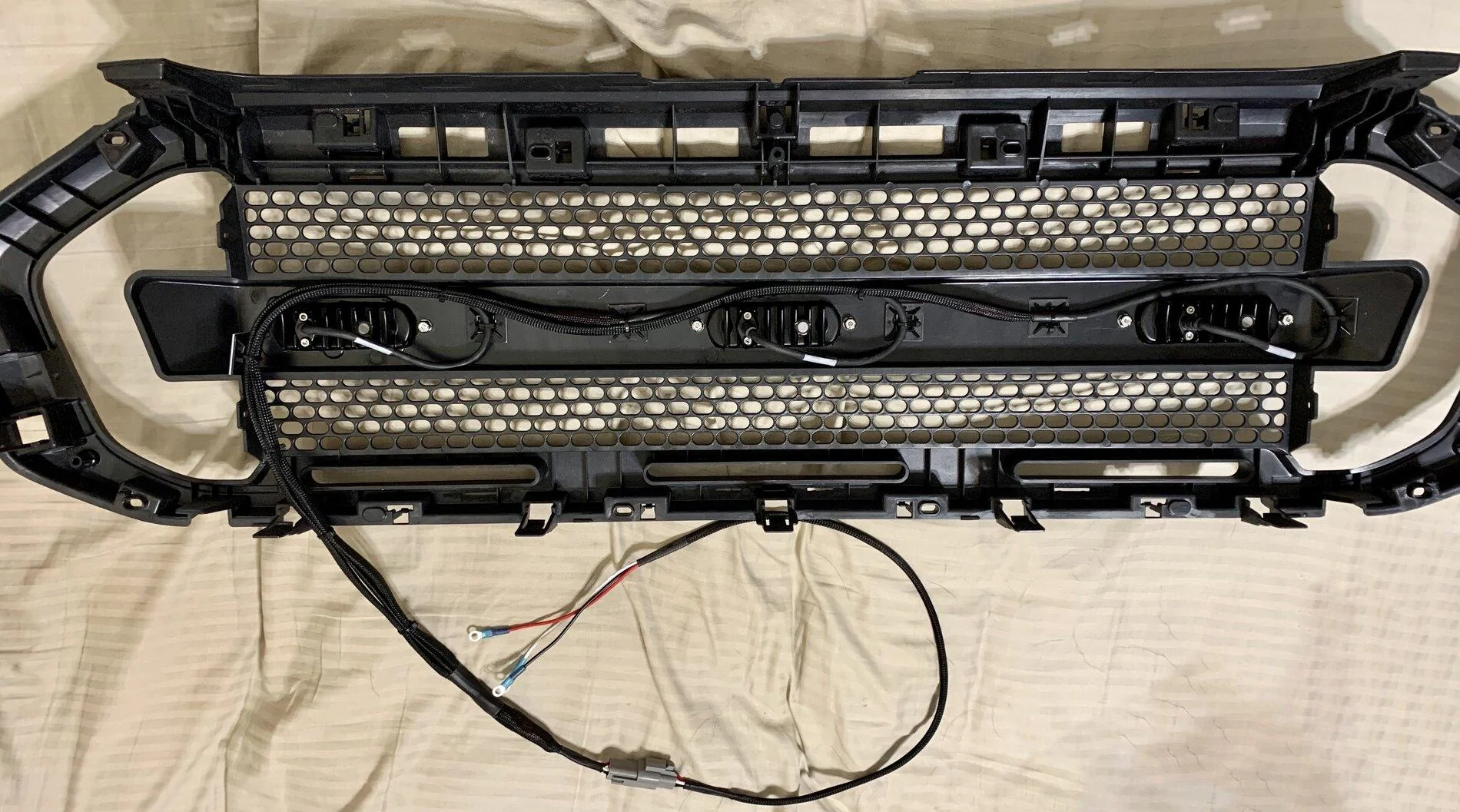

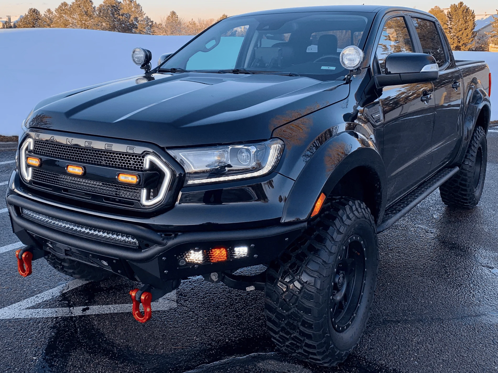

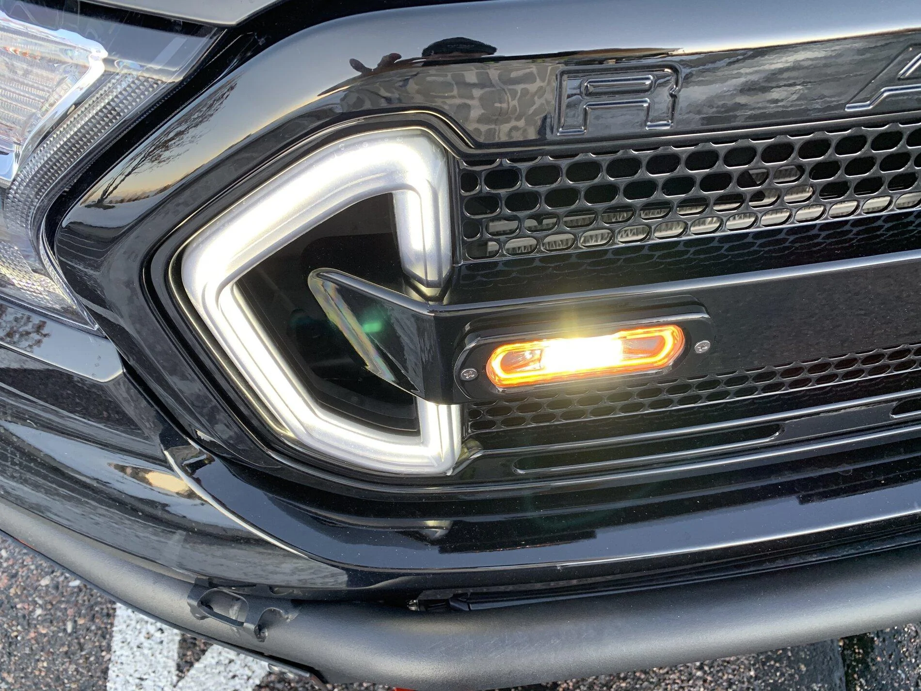

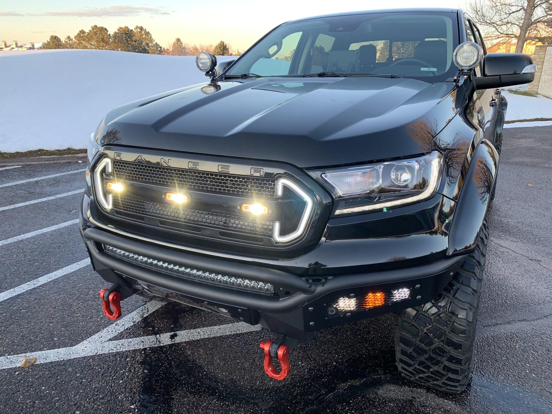

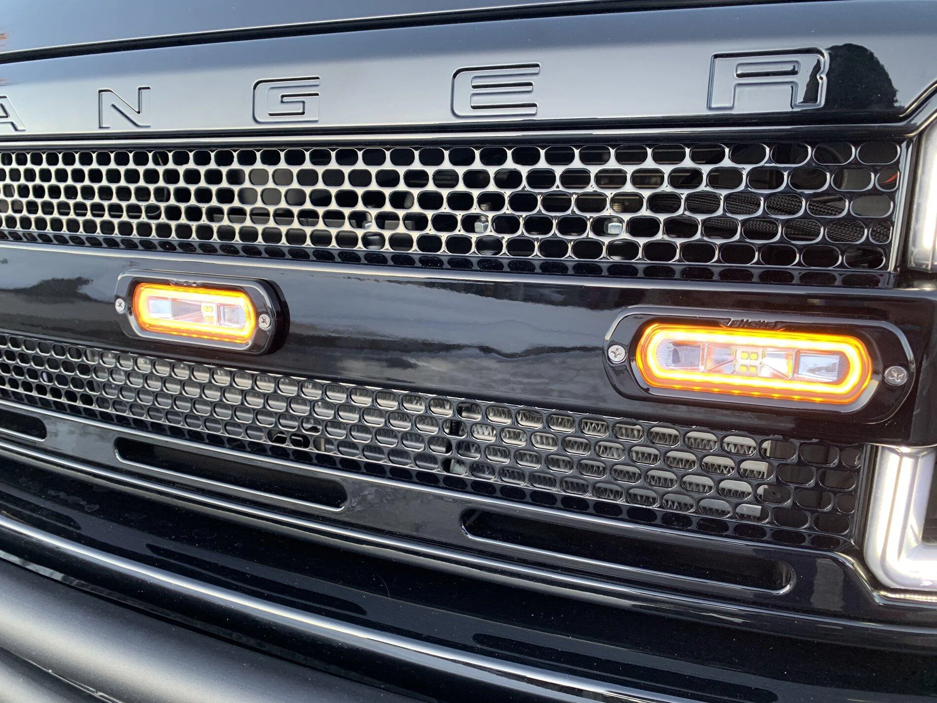

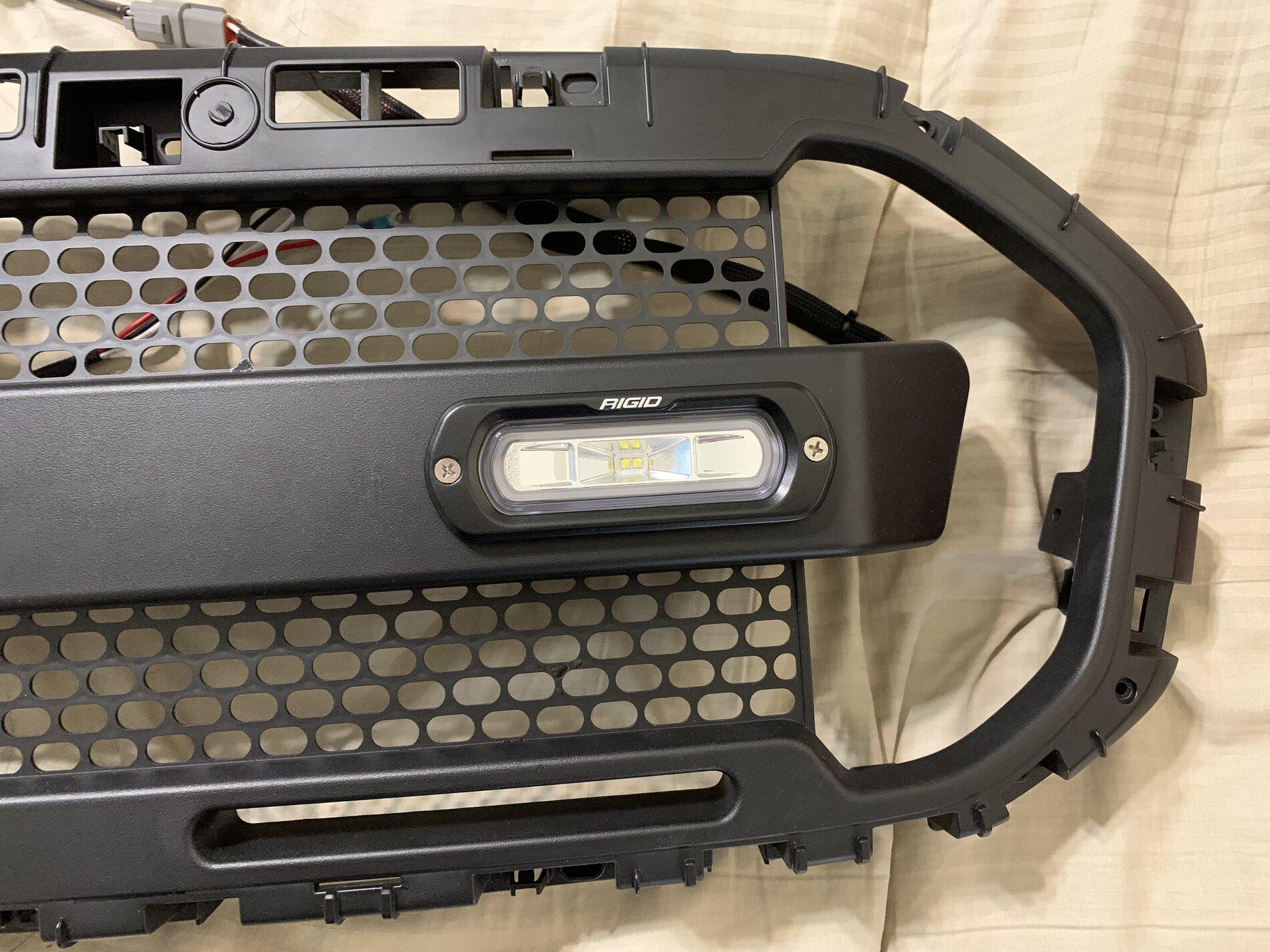

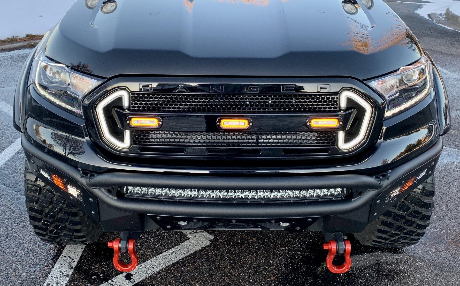

Finally finished this tedious (and pricey) mod to my RTR grille. It took a while to finalize the design, lots of very careful cutting, took it to get paint-matched, created a wiring harness (first time using Deutsch connectors), relocated my ACC relocation kit (so lights weren’t blocking ACC module), then wired them into my cab switches. They are Rigid Industries SR-L amber/white Spreader Series pod lights. Dual-switch for amber accent lighting, white super-wide floods, or both. I’ll probably mount the RTR emblem on the lower mesh under the far right light pod.
Also, the Rigid light bezels are removable for paint-matching, so they are Absolute Black as well.
Damn! That looks sick! What are you going to do with the old RTR badge?
