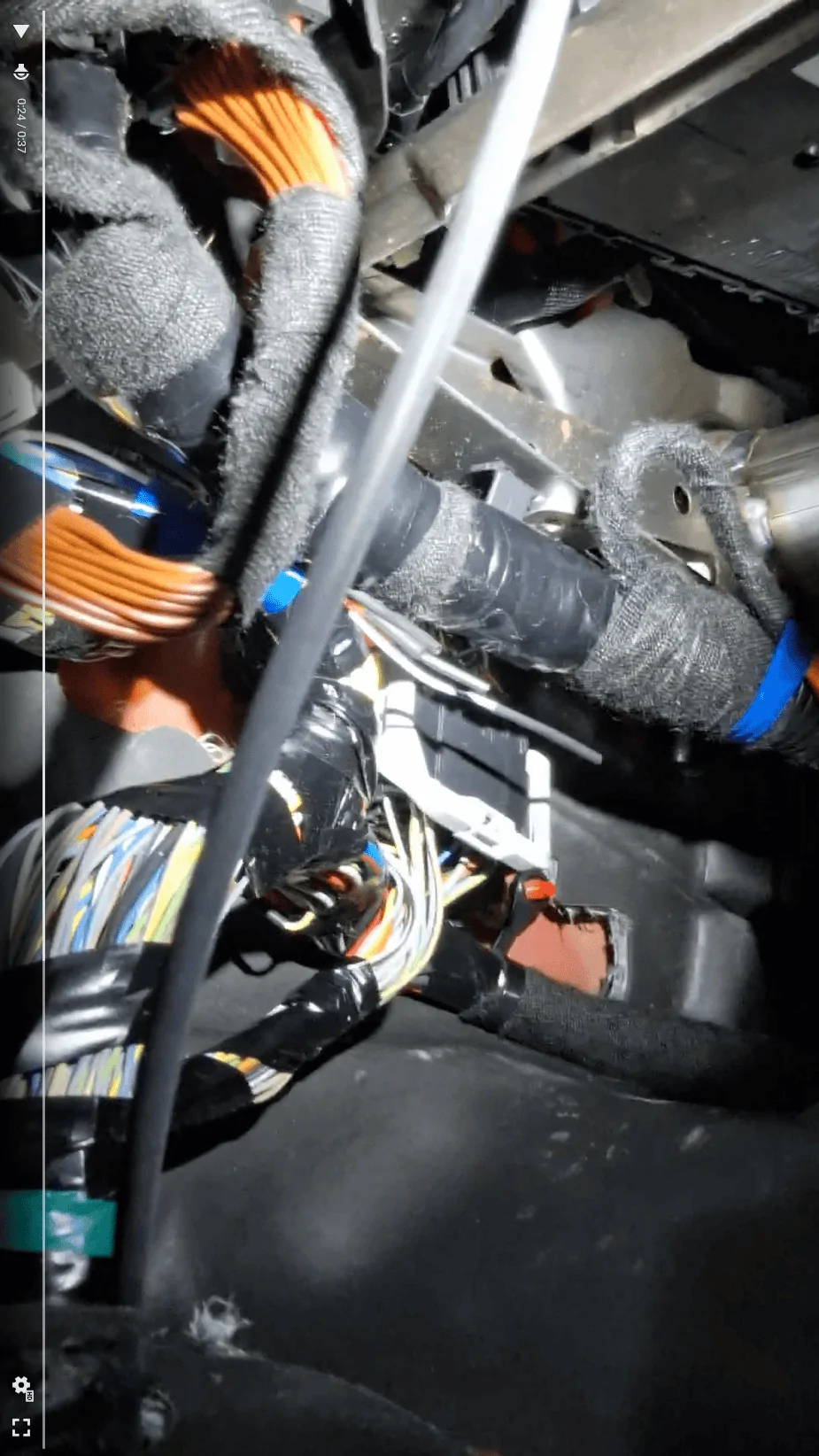

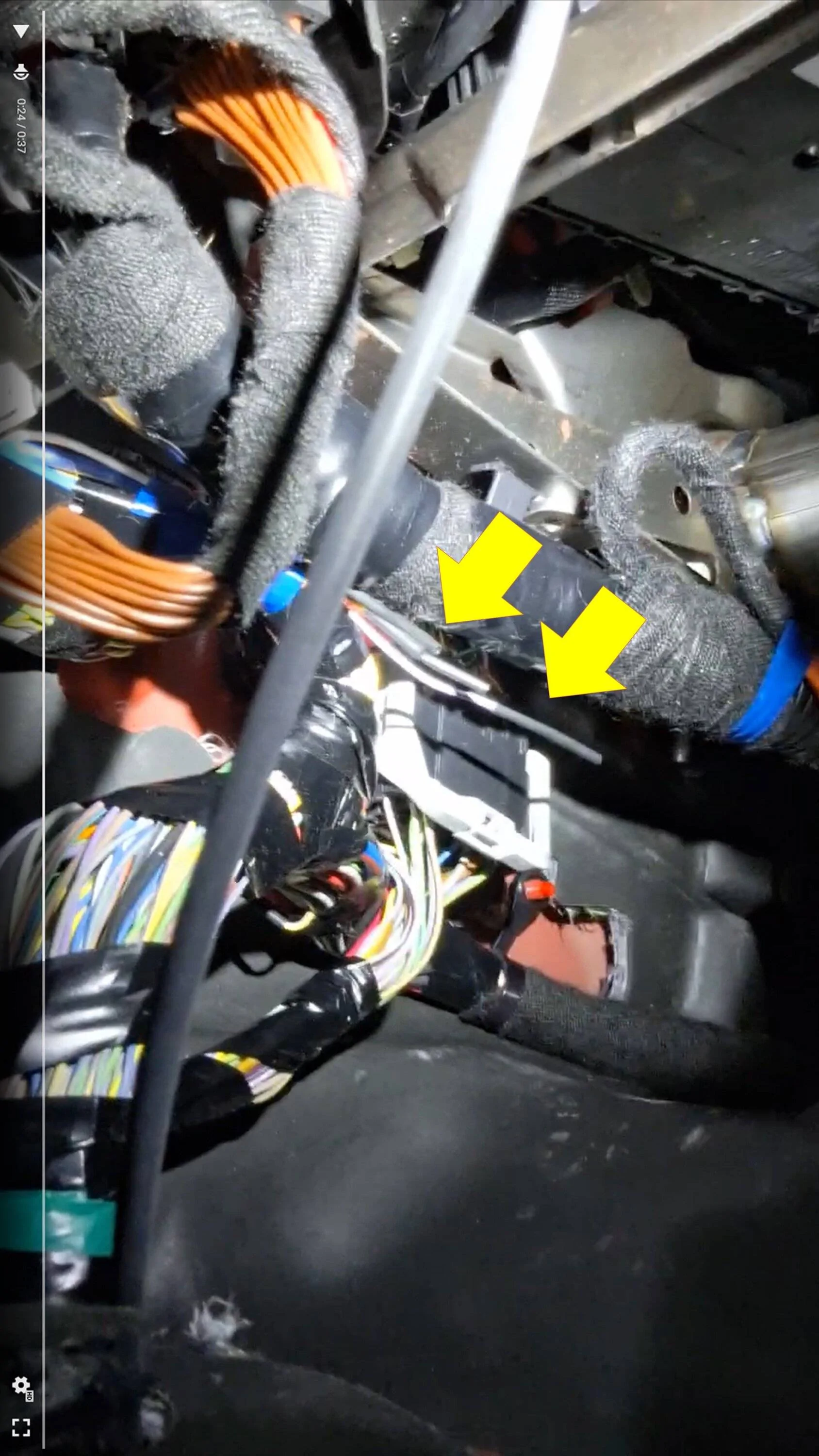

I have the same question for my bare bones '22 XL. I have the tow package with 4 & 7 pin connector at the bumper and I *think* I have the 4 wires under the dash. It's cold out (boohoo) and I'm tried to video under there to see. Looking with my fat head, I wasn't able to tell. =(

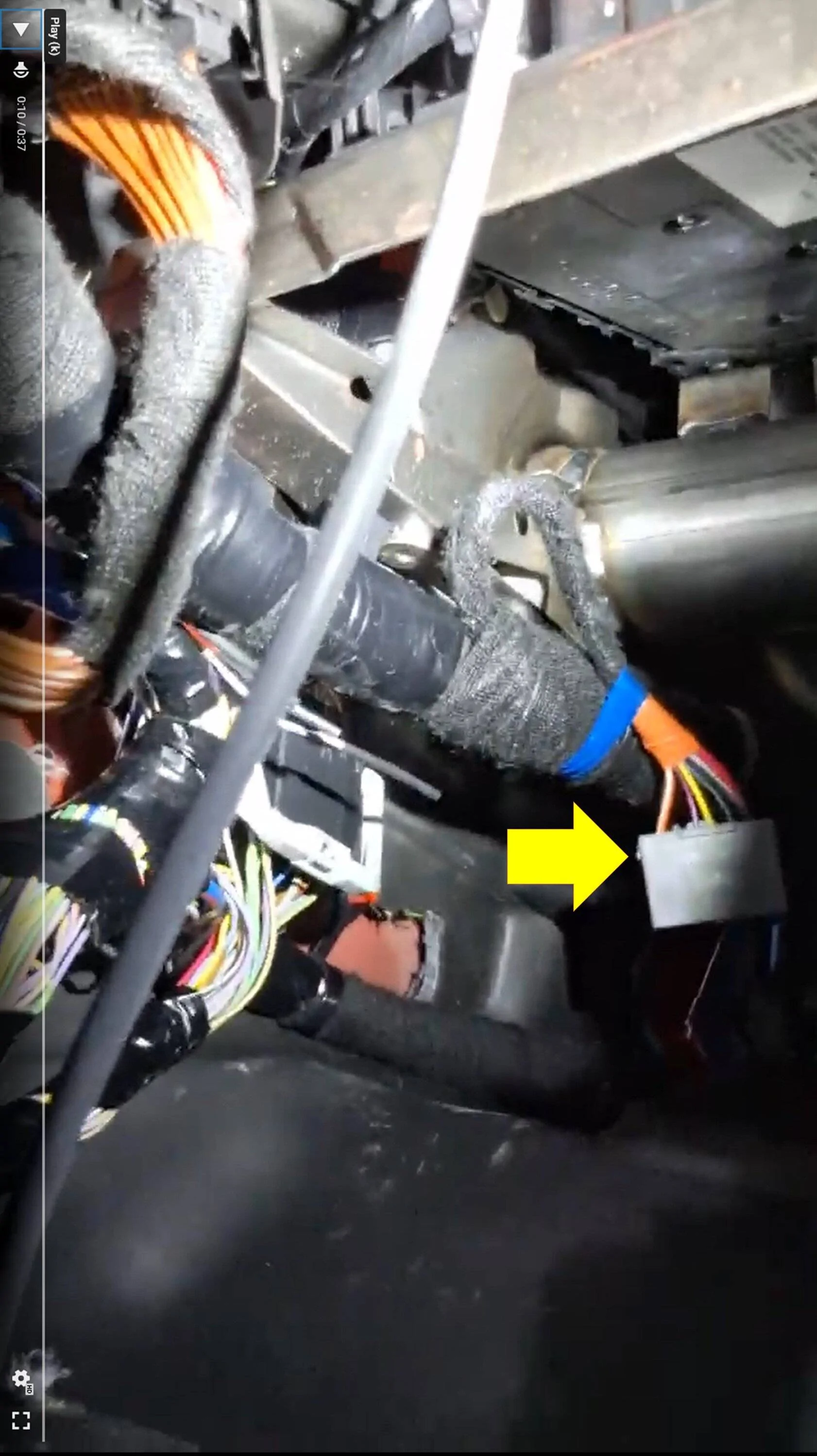

And I also see an empty plug and wonder if anyone knows what that is (second pic).
looks like these three visible ones have shrinkwrap on the ends and possibly go with the blue tape to the left (I just couldn't get deeper in there and should wait until spring, but you know ... Ranger + money = addiction) =D
what is this blank connector for?

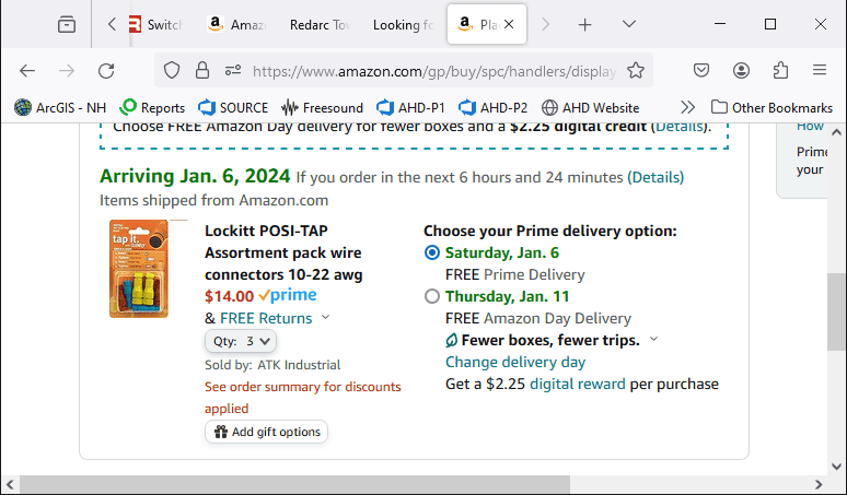

A little hard to tell from your pictures, but the TBC wires under my dash were finished with heat shrink like that. I used Posi-Tap connectors to attach my TBC and it was way easier than crimp connectors and way less flammable than soldering. I put the L3 end right over the heat shrink and it worked great. If I ever remove the TBC, I'll just snip the wires at the nick and cover with electrical tape.

Thanks for the tip and link for Posi-Taps. I'm making my list and those sound like the best way to go. =)

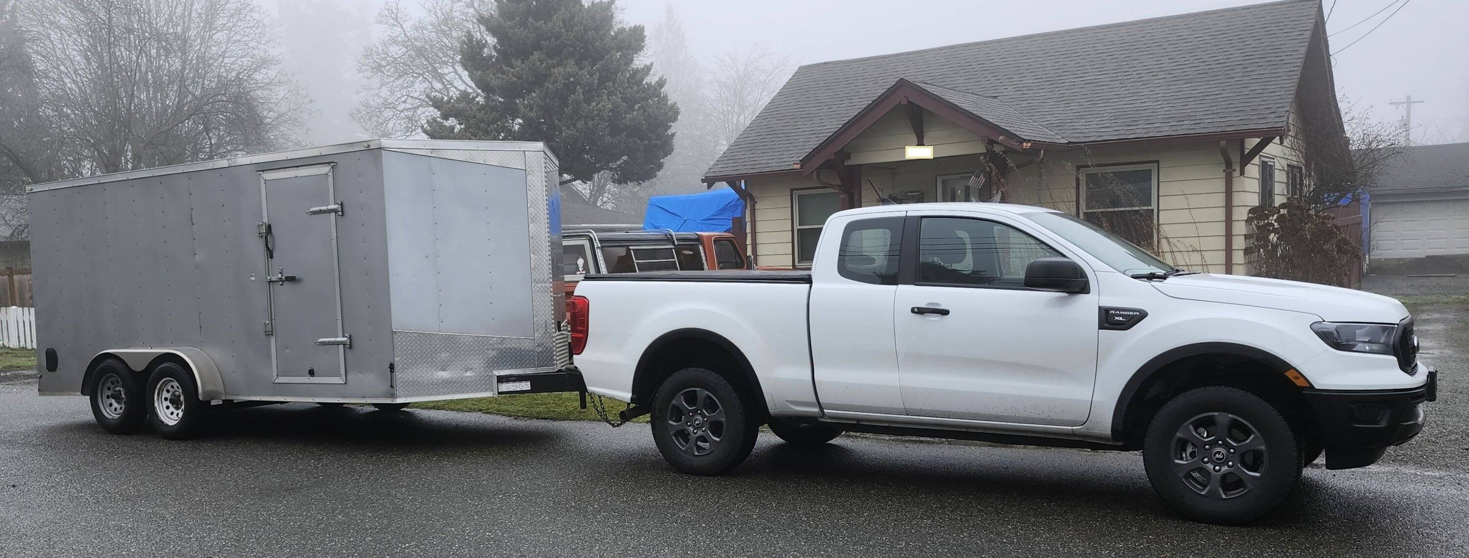

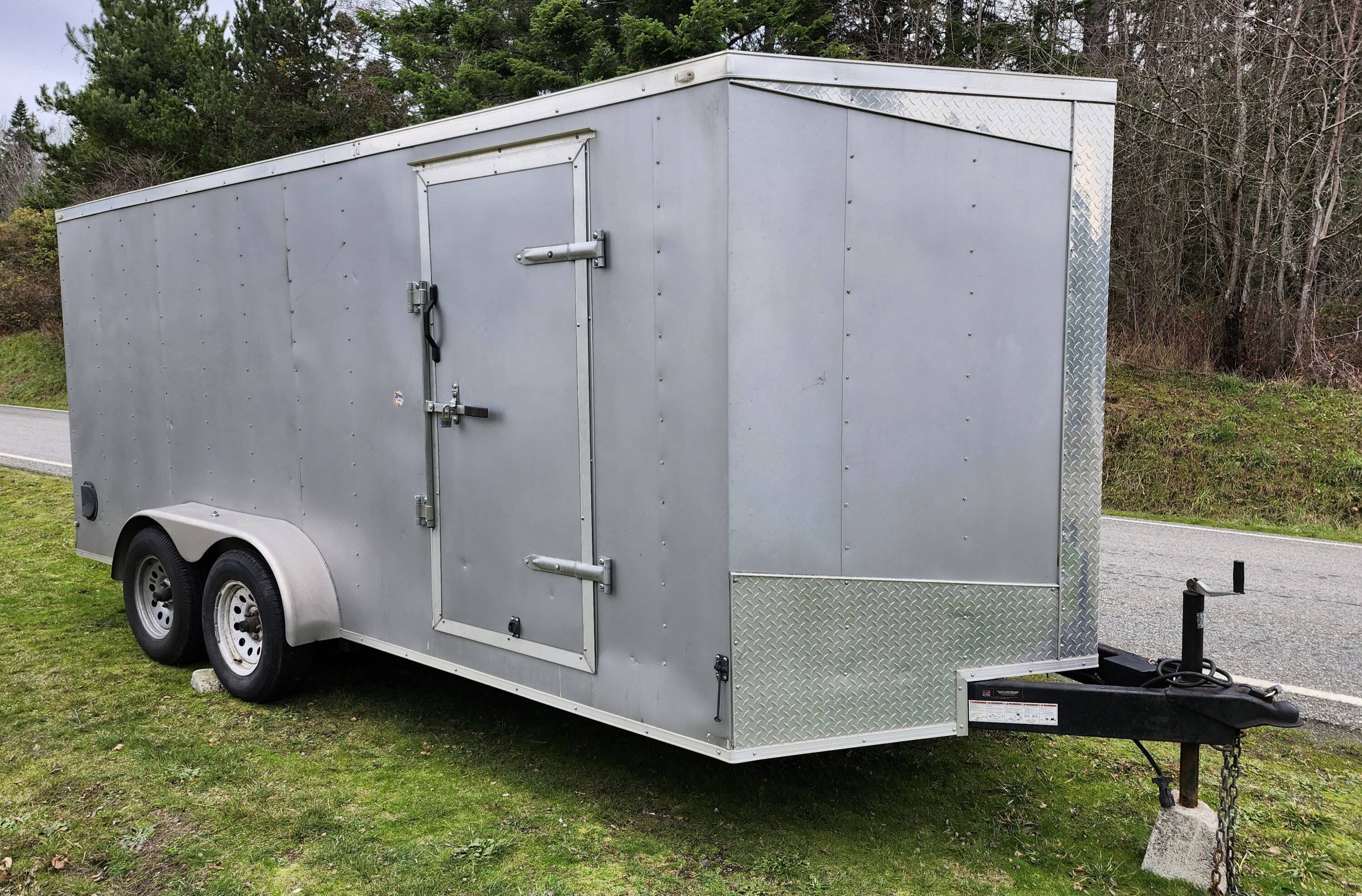

Thanks @subquark, that is a great writeup on the ranger station! I'll have to look for my wires this weekend. I have had to move my newly acquired 7x18 V nose car hauler twice now without trailer brakes, supposedly 2000 lbs empty and I have been taking it very easy and using the tow mode. My liberty tow controller arrived yesterday, good thing I read the comparison on Redarc's website since it looks like spending the extra $ for the elite doesn't do anything for me other than avoid having to buy the universal harness.

Wow! That's a very nice looking trailer! What do you use as a trailer hitch? I have a B&W Tow & Stow 3-ball 5-inch drop which is fancier than I need but I'm also lazy about removing it to save my shins and have so much other crap in the truck, SwingCases, and even off the front bumper, that I'm not sure where I'd store a ball mount!
I'm eagerly looking forward to hearing about your Redarc install.
And you have a '23 XL? If so, you have those 4 wires under the dash? I read some post where some don't and couldn't really tell if having the factory tow package guaranteed the wires were there. It sure seems that they do, but I worry (needlessly) about this. =p
Looks like I'll get my Redarc Liberty in March for my birthday and that'll be better weatherwise too, for me.
Thanks for sharing your exploration of all of this stuff! =)

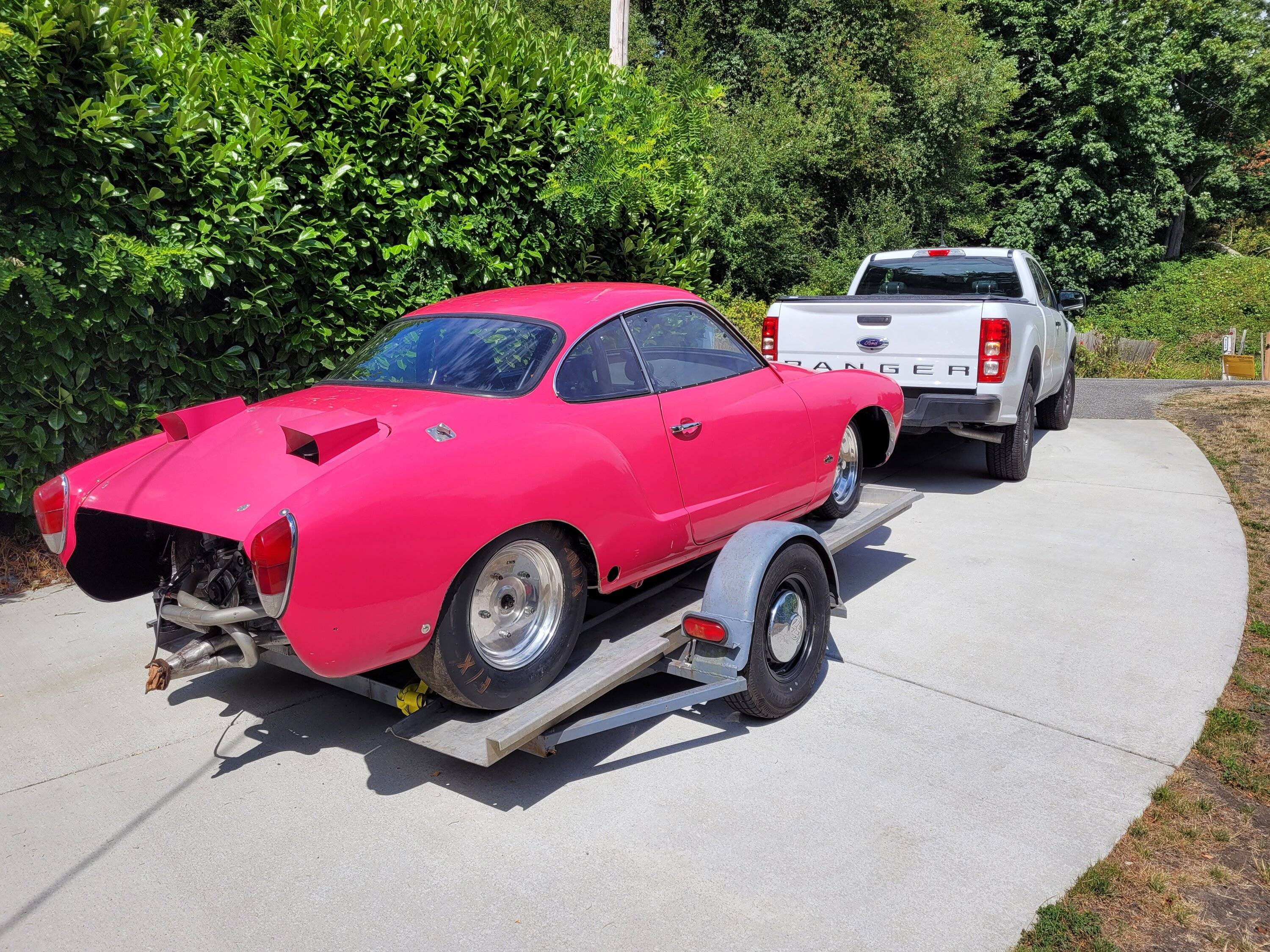

I have a variety of hitches I use. For the car hauler the tongue is up pretty high, I used a straight hitch (no drop at all) with the big ball when I bought it and it sits a little too high in the front so next time I'll use a 2" drop hitch and that should be perfect. For the other towing I have done with smaller trailers (open trailer for my VW drag car) I typically need a 4" drop since the bed/hitch of the Ranger is up so high.

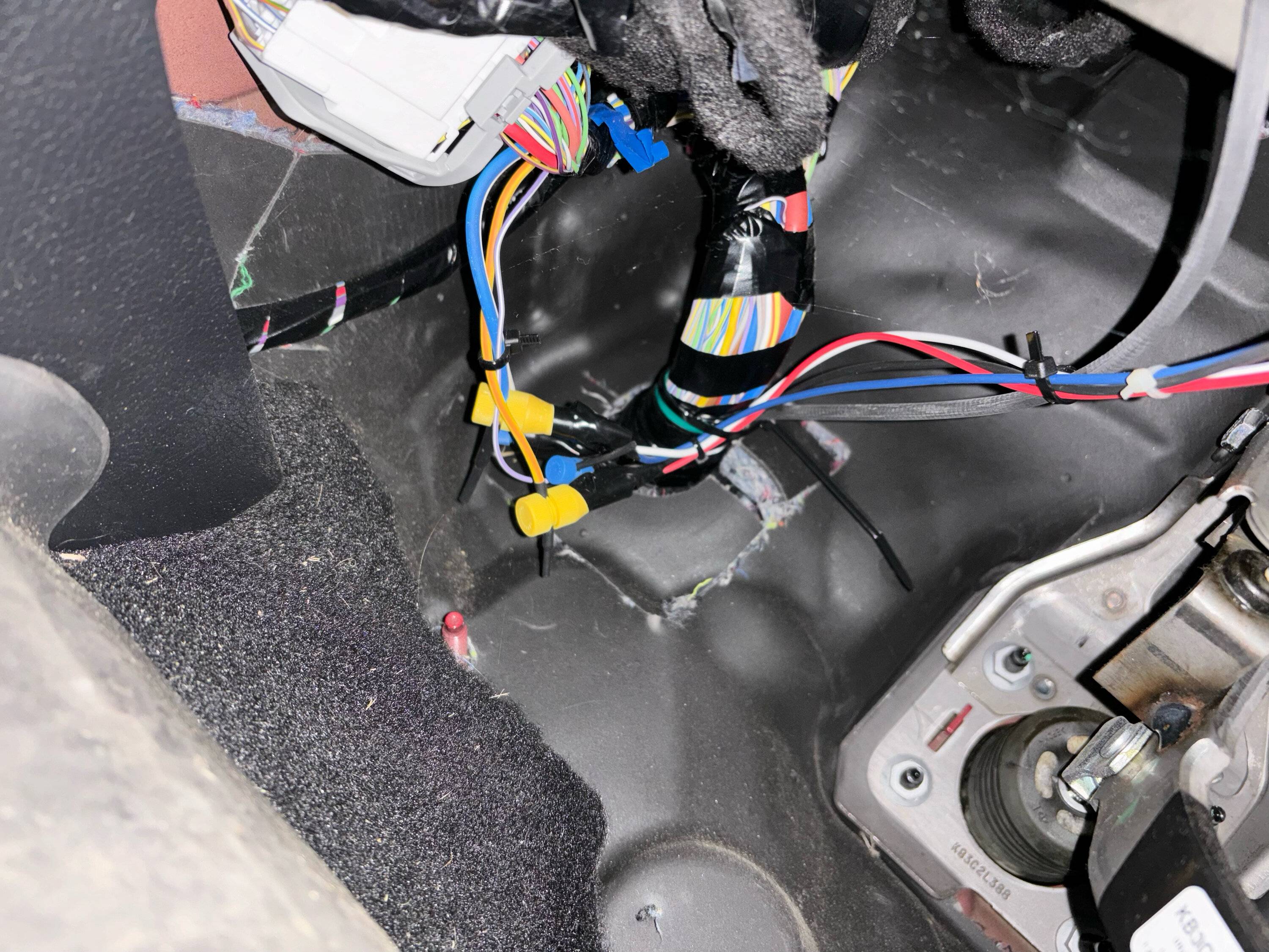

I have a 23 XL, produced late Nov/Early Dec and delivered at the end of January so I'll post an update on the wires when I look under the dash. Glad I ordered a 23 since so far the 24s only come in a crew/quad cab config which I don't have any interest in.
