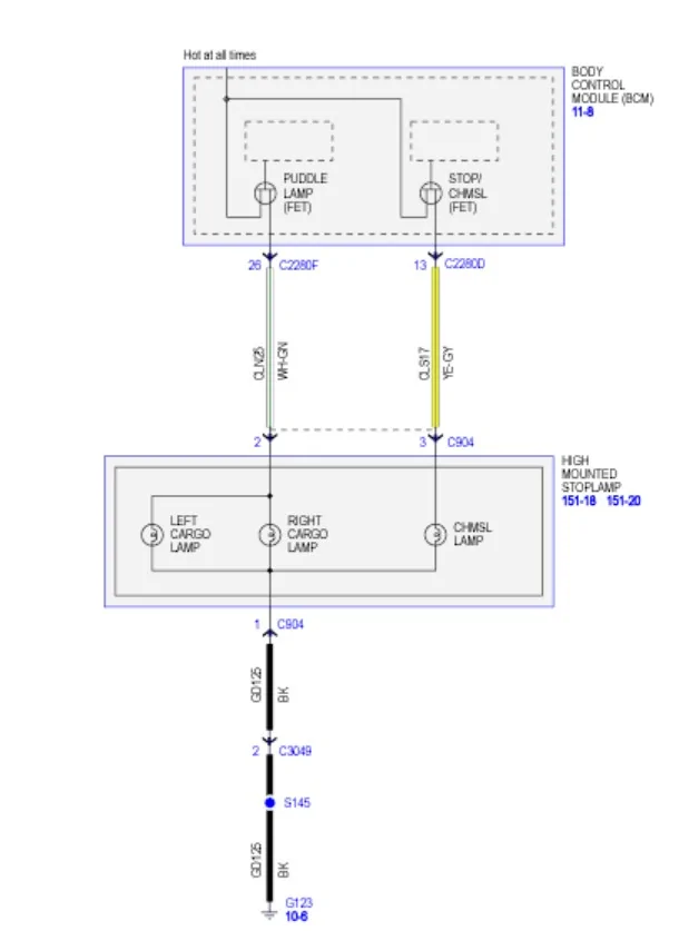

Using trailer hitch wiring will likely cause the truck to think that a trailer is connected and may cause issues. The puddle light circuit is shown below but will probably need a relay to isolate and power your running board lights. The Puddle Lamp FET probably will not be able to handle the extra current directly.

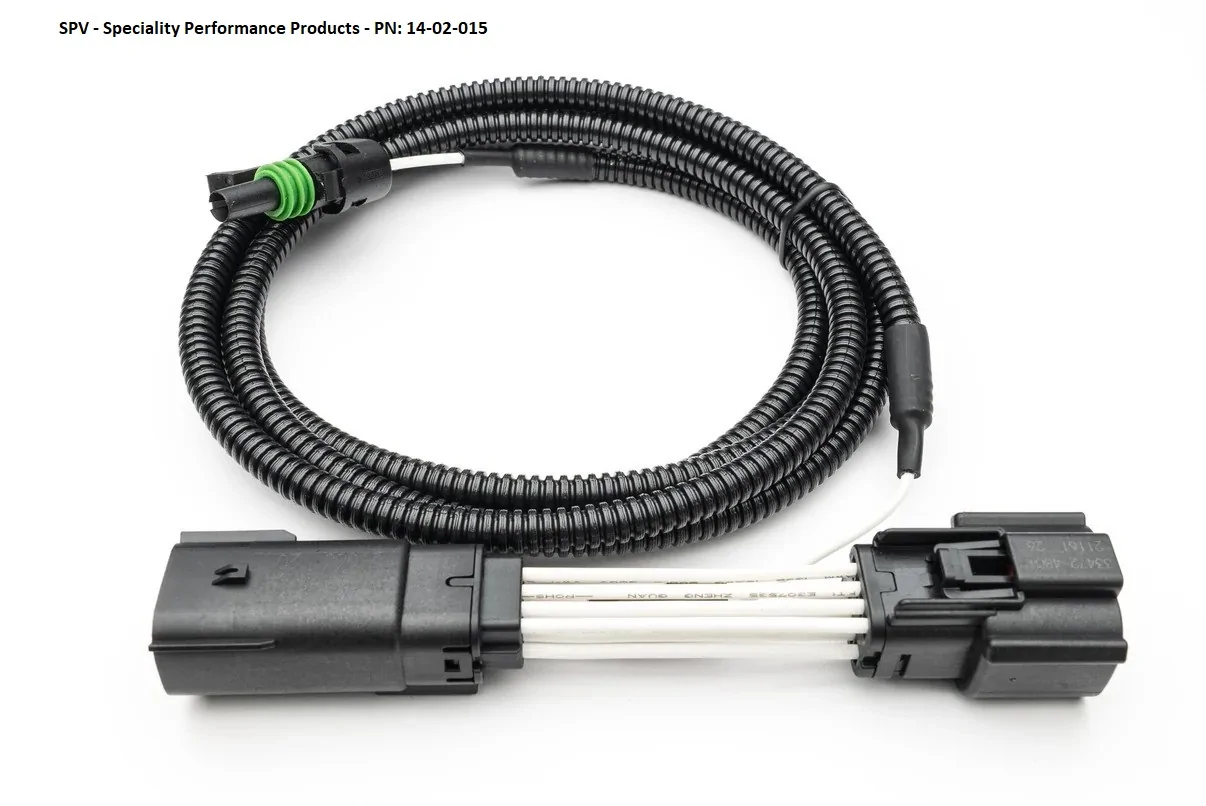

There are some adapters available (Aftermarket) that provide a cleaner tap for the Park & Turn instead of tapping into factory wiring
One is a side marker - from Custom Autoworks - Provides (Park) - I cannot locate my pic of this one
and this one - it comes pre-tapped for the (Park) so you would have to add another tap for the (Turn) - Would Require (2x) T-Harness
I will always push - spend the money to do it right over wire taps into an expensive harness, this way the only wire (tapping) is on the aftermarket harness (if extra tapping is required) if one is available or make your own

I realized that the post in the other thread is for - LED Lighting and as Ranger Bill Posted above - it is a direct run from the BCM to the CHMSL - so you will have to tap off of the BCM output feed wire if you want it to be easy access.
C2280F - Pin 26

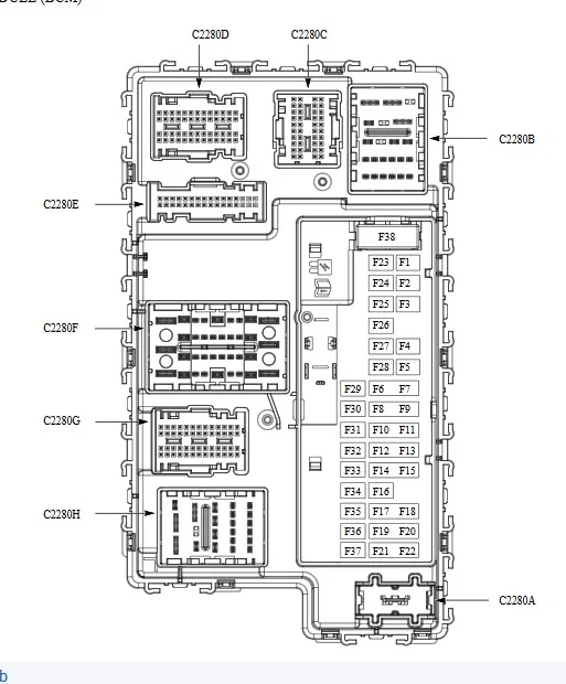

This is very helpful, is this fuse block behind the instrument panel on the drivers side? Also, connector C2280F pin 26 is that 12v when the interior lights are on? Thanks!

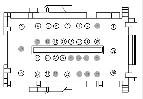

Yes - This is the (BCM) Fuse Box - Driver's Side
This circuit is for (Cargo Light) - The Center lights that come on within the 3rd Brake Light
They come (ON) as (Entry/Exit) when the door is opened - along with park lights
They come (ON) as feedback to (Door Unlock - FOB) - along with park lights
They come (ON) when you hit the cargo light -Switch
The BCM can be finicky for adding any additional lighting to it without triggering faults, you also have to take into account that the (Bad & Interior) lights are (Theater Dimming) and I the OPT7 may give issues (operationally) at that transition - owners that have it installed have not reported any and they use the (Cargo Light) circuit for the Running Boards as well as the Lighted Sill Plates
