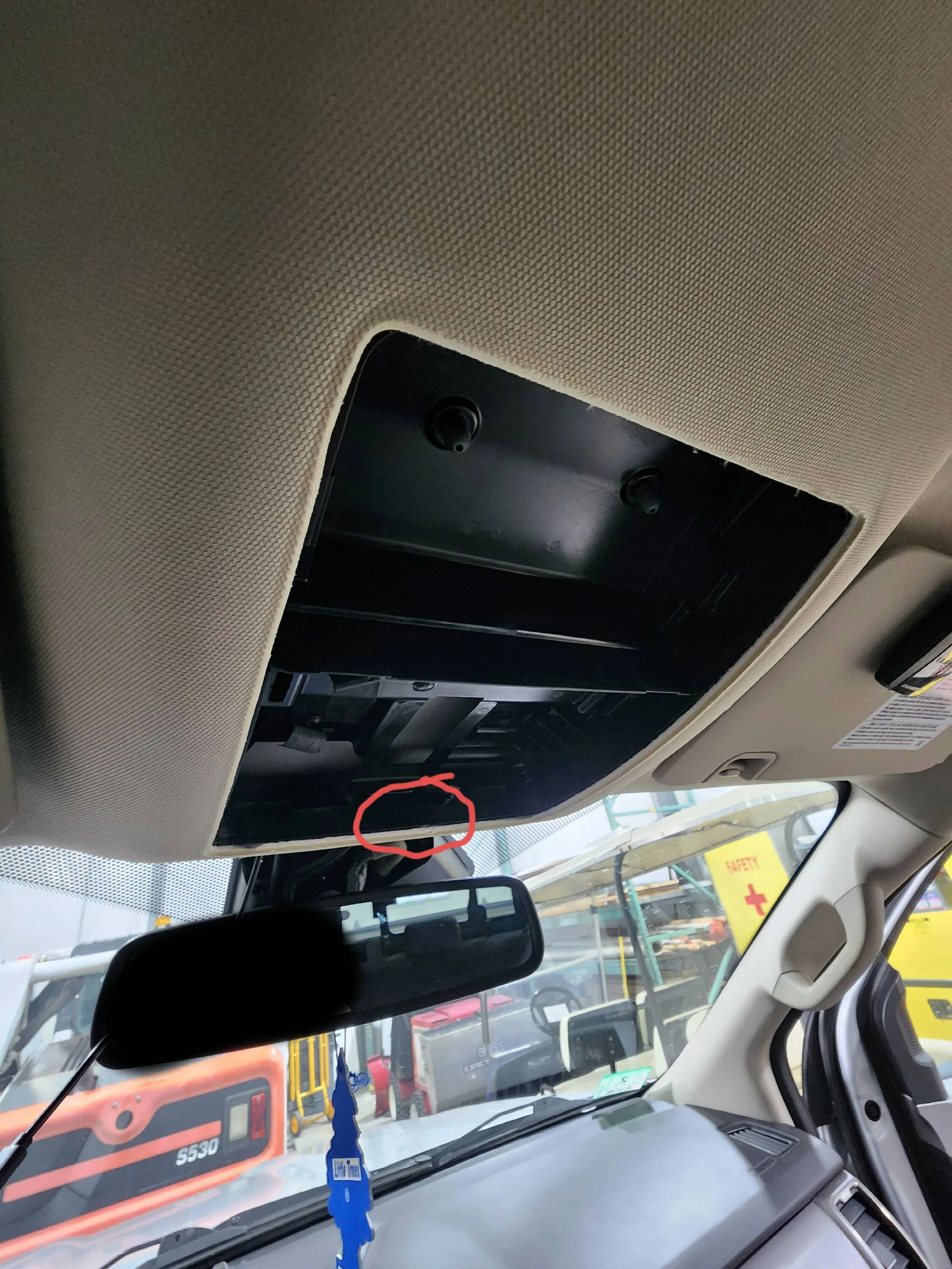

I removed mine in my 2019 xlt
to run wires for my dash cam. It basically just pops out. I started in the rear and worked towards the windshield. The power connector comes through where I circled and has almost no slack at all. It was a while ago but I think you pinch the sides to release it. Those long curved needle nose pliers would be useful if you have a pair. Other than that it's easy.
Thank you!. Volkswagen usually has a couple screws hidden behind something that need to be removed before the unit comes out so I didn't want to just start prying with out knowing that.
