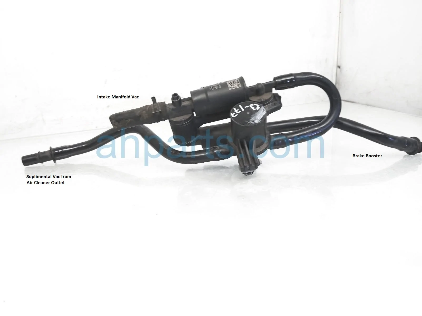

From my post above
"and Vacuum Pump???? I assume you are referring to the brake booster hose (aspirator valve)"
This is what I am referring - this takes the place of the vacuum pump, since our Ranger does not have the physical vacuum pump.
When the booster vacuum drops (This is the sensor on the bottom of the brake booster (Vacuum Pressure Sensor) it signals this valve to open, suppling an extra secondary vacuum source from the air induction tubing
I suspect they replaced this chasing a possible vacuum leak source.
Here is the manual description of it:
Vacuum On Demand System
Vehicles equipped with a 2.3L engine supply vacuum to the brake booster through the use of a valve solenoid and an aspirator in the brake booster vacuum tube. When the ABS module detects a low vacuum condition in the brake booster, a message is sent to the PCM requesting additional vacuum. The PCM responds by opening the valve solenoid which allows the engine to draw air from the brake booster, increasing vacuum in the booster. Once the vacuum in the booster has reached the required level, the ABS module stops sending the message and the PCM closes the valve solenoid.
