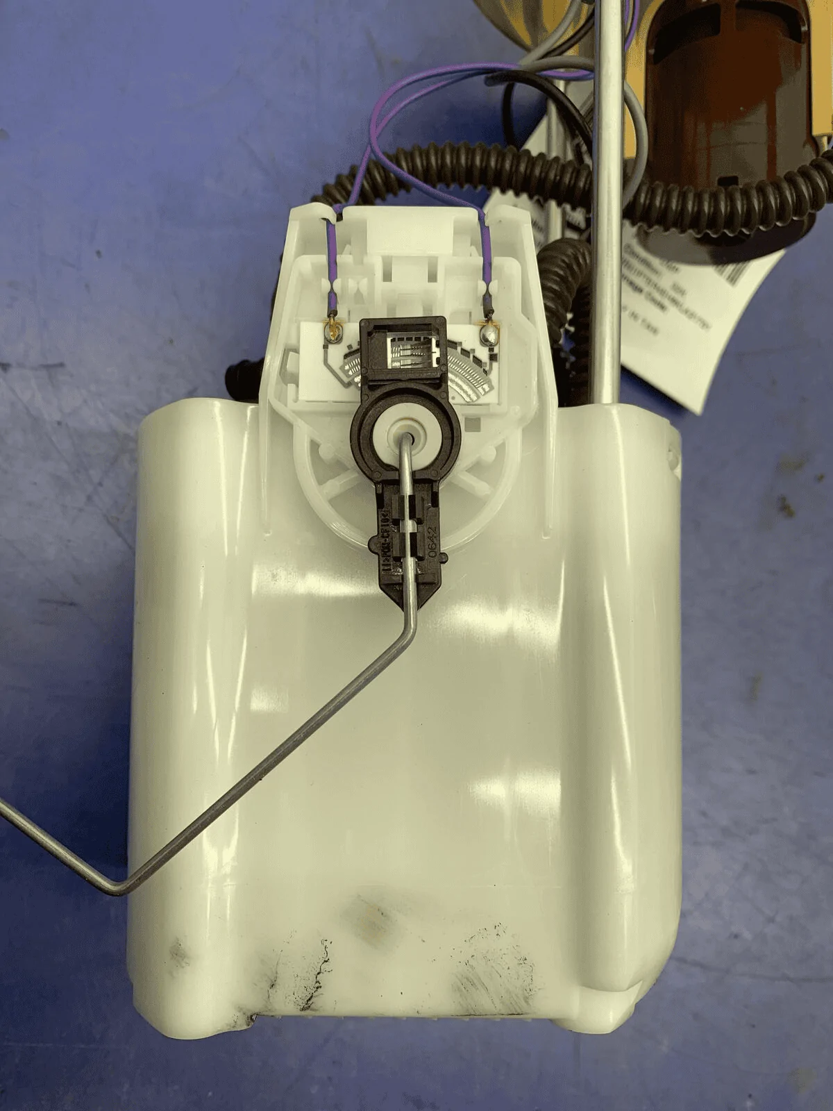

Should not cause any serious issues, it's my experience with Fuel Gauge issues like this, is that it will usually not be accurate and fault in the 1/2 to Full Range, more-so in the 3/4 to Full Range.I just started seeing this issue on my 2021. Not sure how serious it is overall. Has it caused anyone any serious issues?

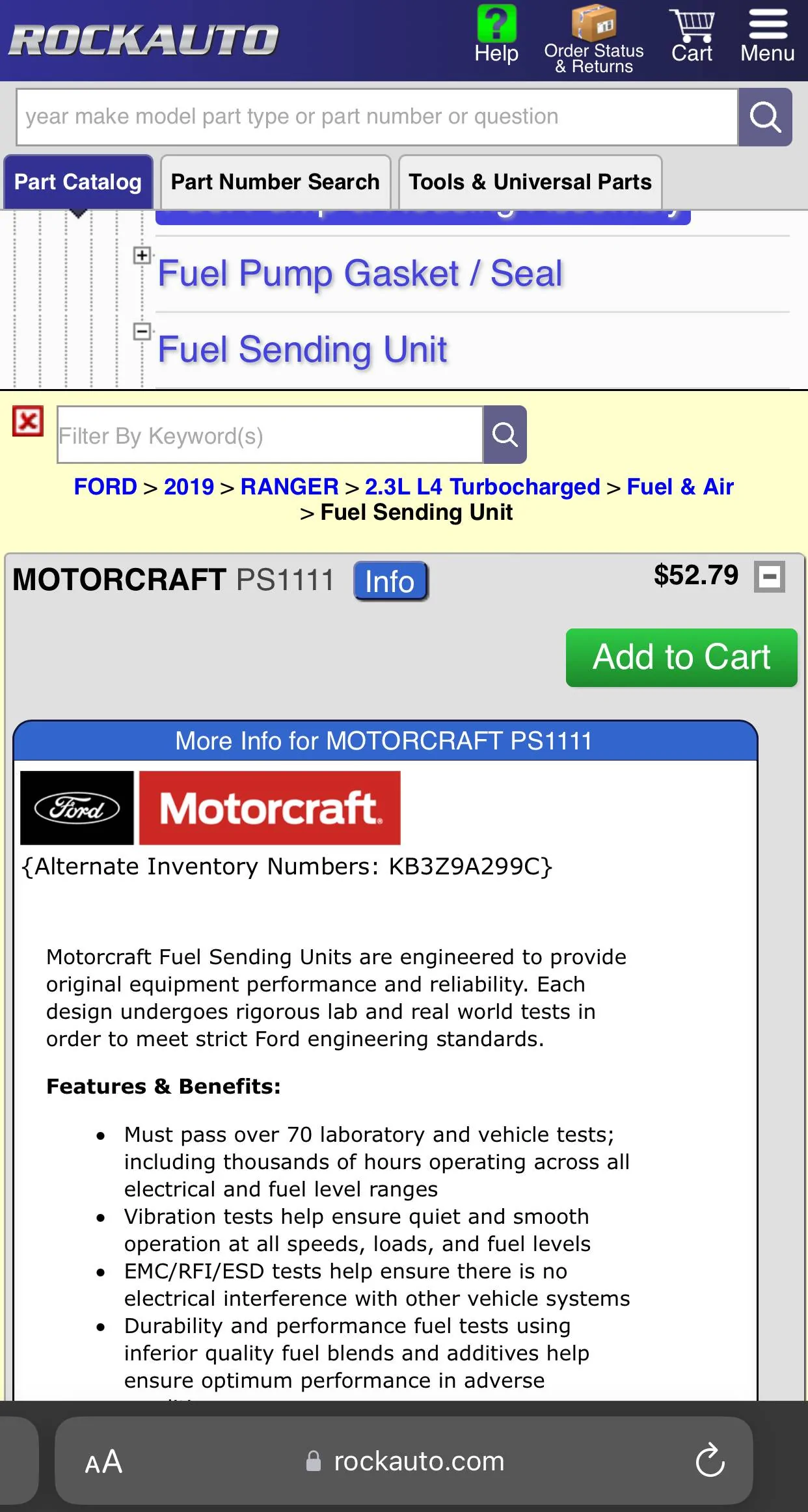

The Fuel Sender Current Price is $21.00, and Pump / Sender Assembly is $300.00. The Sender requires pump removal to replace it, so the same amount of labor involved to replace either.
