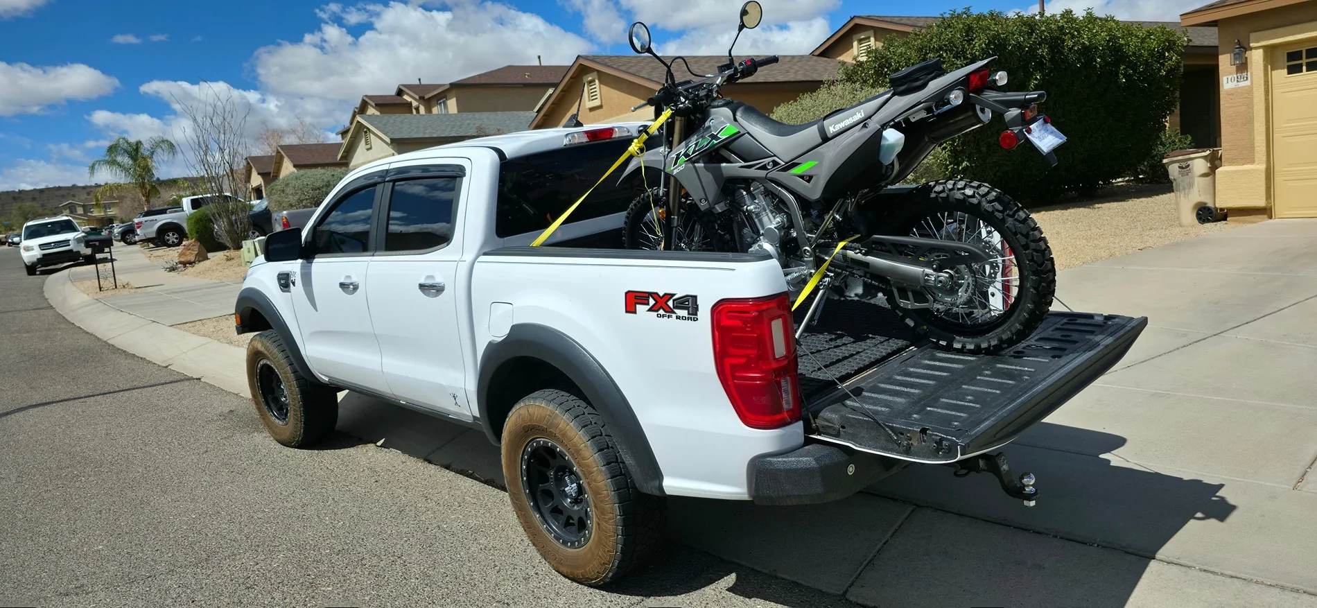

Emt
Nope. Same height as stock. You actually drop the overload spring and lower the back a half inch with those springs. And the ride is way better.
