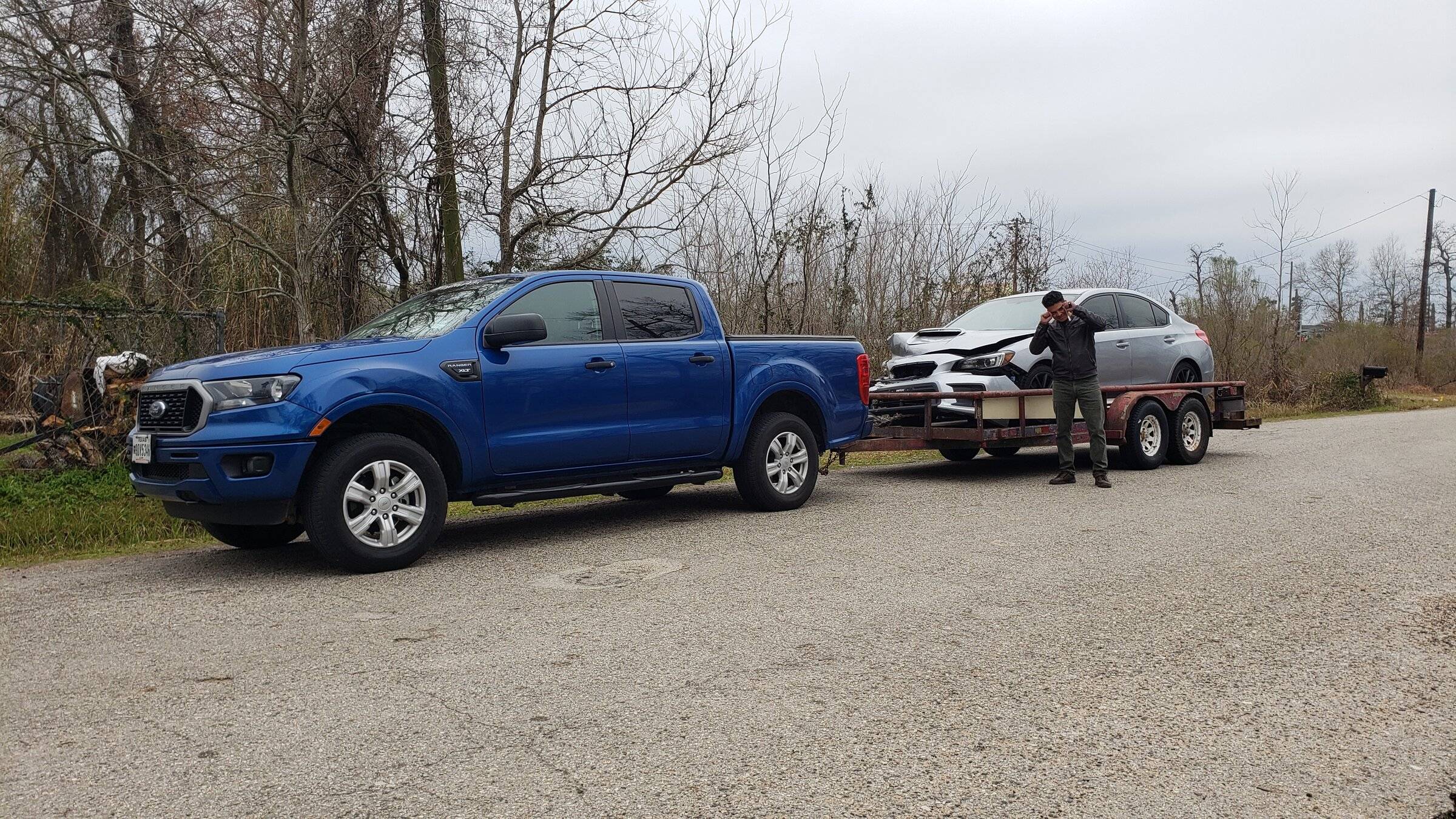

No leveling kit. Payload maxed.
2020 xlt 4x2
1752 payload from factory
Added receiver hitch 50lbs?
Side steps 40lbs?
Friend 200
I am 170
250lbs of tools
Friend had 300 of luggage
600lbs tongue weight. At most
1610 cargo weight
Plus 6000 pound trailer. At most
Trailer at 2100
Car 3k to 4 k.
350 miles such an easy and awesome tow. This pickup is amost just the same as a full size!
I am no engineer but i do know all the leveling kits and suspension mods cause big changes in handling as created by the engineers. I do this often enough where i need better bump stops and maybe a rear sway bar. No big bumpers and such it all takes away from my payload
