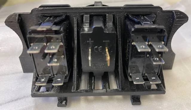

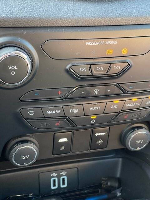

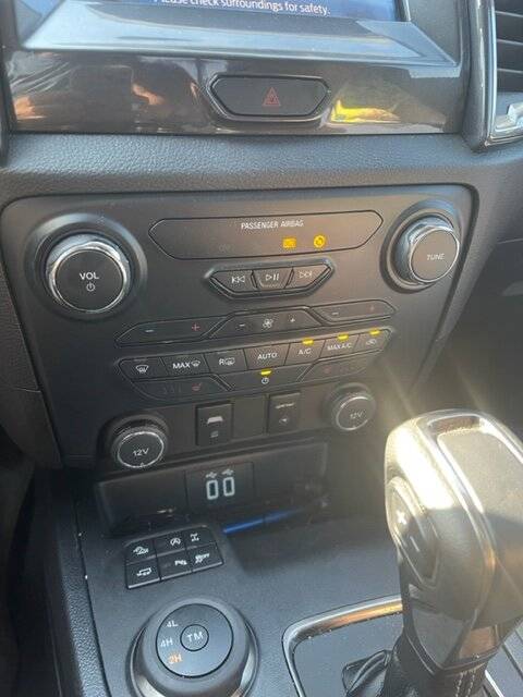

Did you have to drill a hole behind the switch to run your wires?

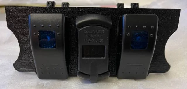

No Sir, I had the wires ready to go from adding Adaptive Cruise I installed my light bar at the same time. They were in a nice harness, I simply heat shrinked the 2 switches into a harness (One switch is a spare for something else) and mated them together. The whole thing tucked to the left side of the center console you can't even see them. I'm not a fan of chrimp style stuff, and always solder my wires together. I think you get a much better connection and a smaller end result.

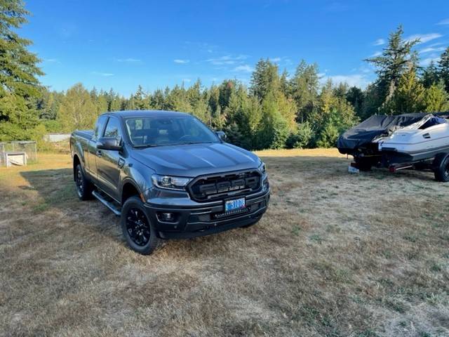

I wanted to share my light bar install:
20 inch 5W Osram LED about $80 on Amazon.
Covered
Uncovered

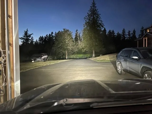

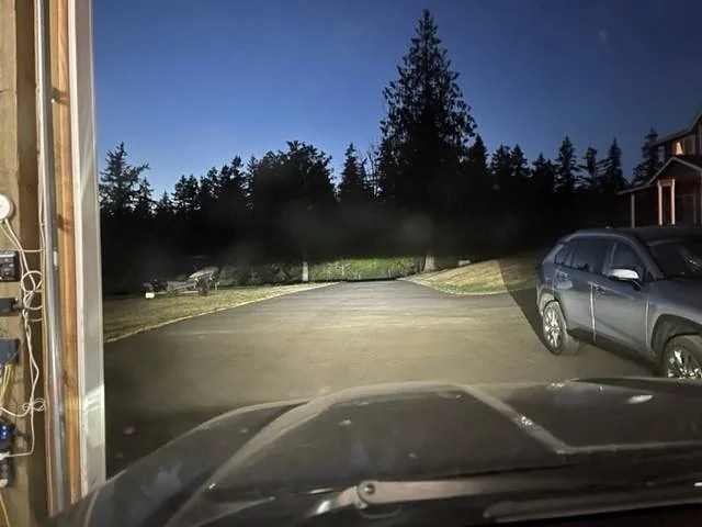

Shining down my driveway (DUSK, not quite dark):
Headlights Only (Lariat, so factory LEDs with very nice cutoff)
Headlights + LED bar
Very nice...but lights are over rated you know...?

Very nice...but lights are over rated...
In terms of Lumens, yes I agree and ignorance of the users. We've all had that one guy driving with a light bar on the highway. This is just one of those things that:
1. It was pretty cheap $59 light bar and $110 switch.
2. There are areas where I live that I just wanted a little extra light (Rural America) and this works for me.
I don't believe any of the official lumens ratings which is why I posted a pic. I am fortunate that my truck has the factory LED lights and they are better that many OEM lights.

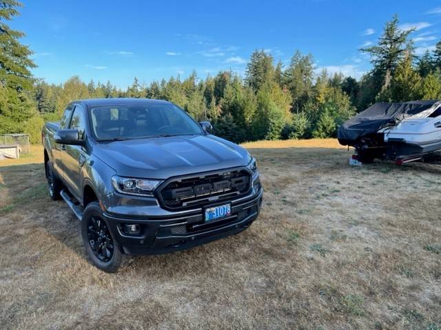

Did you have to relocate the adaptive cruise module to get this to fit there?
I didn't have ACC when I started. I bought the relocation kit, radar unit off ebay and installed it behind the grill and it works great. No issues.

I want to do the light bar there, but I worry about it deflecting air from the intercooler.
I originally thought the same thing, but I there is plenty of flow and flow around the bar. My Ranger is all stock so it shouldn't be an issue.
What you see in that opening is the A/C coil no the intercooler. The intercooler is at the top of the radiator.
