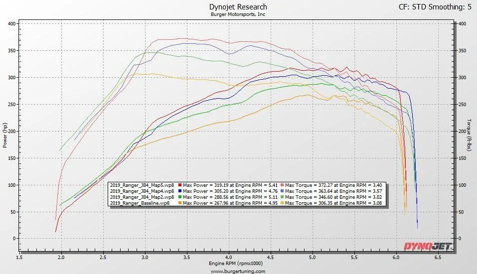

Yes stock vs. various maps on 93 octane.
As this being old I wonder if there was an explanation to be had. The Map options states Maps 3-4-5 are for E30 but this chart is all 93 Octane. What is the risk of running map 4-5 on straight 93? Knock or something worse?
Eskram
Oct 5, 2020
72
253
FL
2022 F-150 Lariat 502a Powerboost Hybrid
Something worse.
If the map calls for E30, use it. I'd assume there was an mixup in the wording in the post somewhere.
