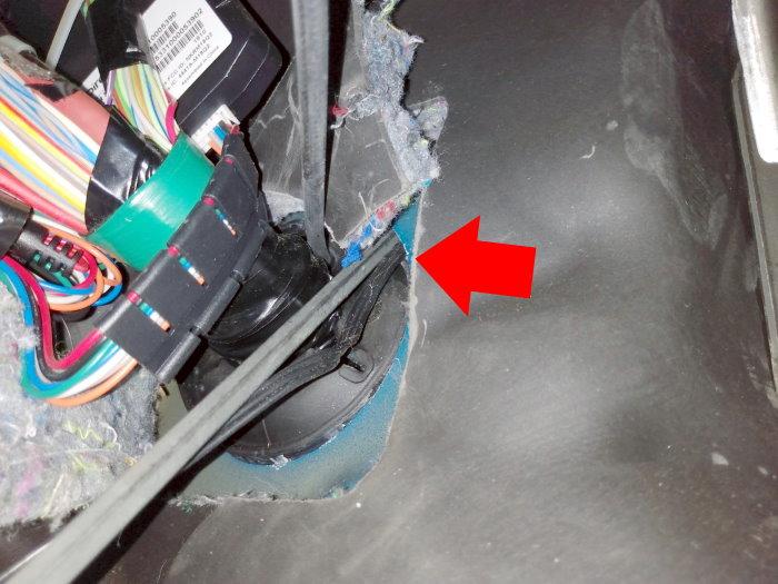

Yeah i ran the cord through the preexisting fire wall hole. It was not easy but I got it done. As for getting it out well I haven’t had to yet, i keep it in and tuck it away. If you are not comfortable doing that when taking it to Ford for a related issue I would 100% just cut it if i could not get it out. It’s just a cord, price is extremely low compared to voiding ur warranty.Confused in Sandman Land!

The other issue I have and maybe the 30 users can help. Running the small cord from OBD2 back to the module in engine, where did you run the cord? I tried through the boot they suggest but the plug, not large but not small can not just be pushed through a hole one makes. I pulled the hood latch cable back toward engine and fished this plug through. Then pulled hood cable back in place. The issue will be I see no way to pull back out, as the plug is large enough to make this hard and I can not reach down to the rubber boot to help get it started. For a return to dealer I can only see cutting the cable and pulling it out. Then buy replacement cable. Or cable stays in place and I tuck away to hide.
