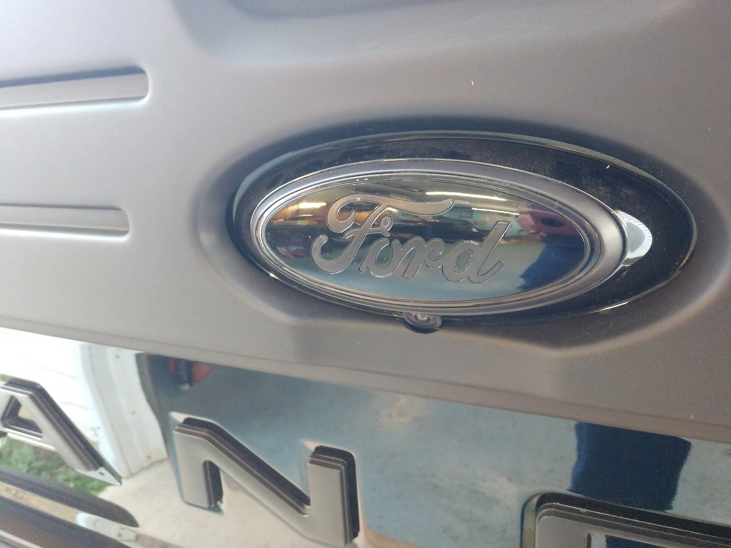

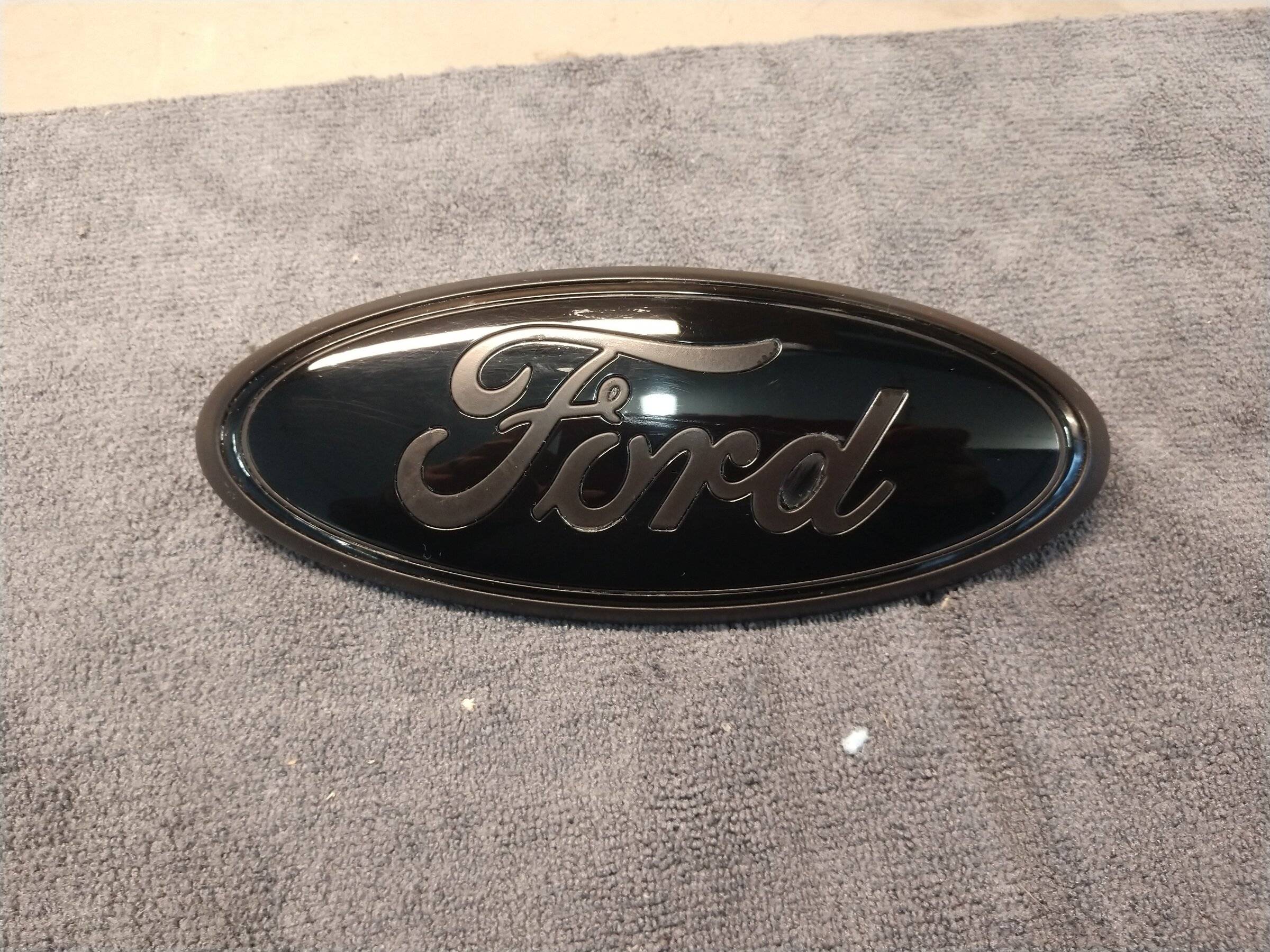

A somewhat good note though, I put my freshly painted tailgate emblem back together. There's a couple of smudges on it, since the super glue seeped through a little bit, but I polished it up and I think it looks decent enough.
I can always touch it up later, but there's no more chrome showing, so that's good enough for me :)

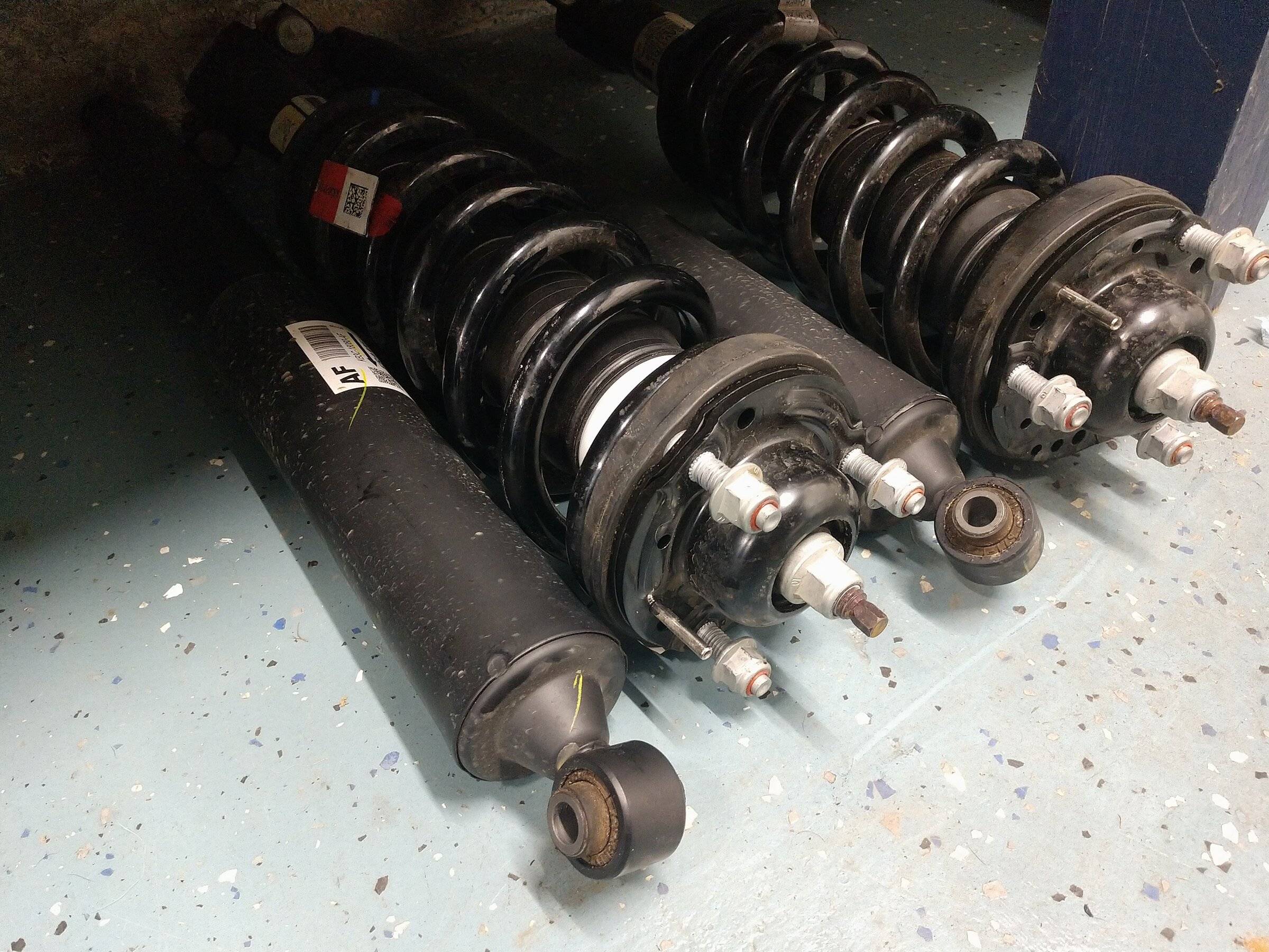

I guess it's time for an update, since I'm definitely not a worn out as I was yesterday...

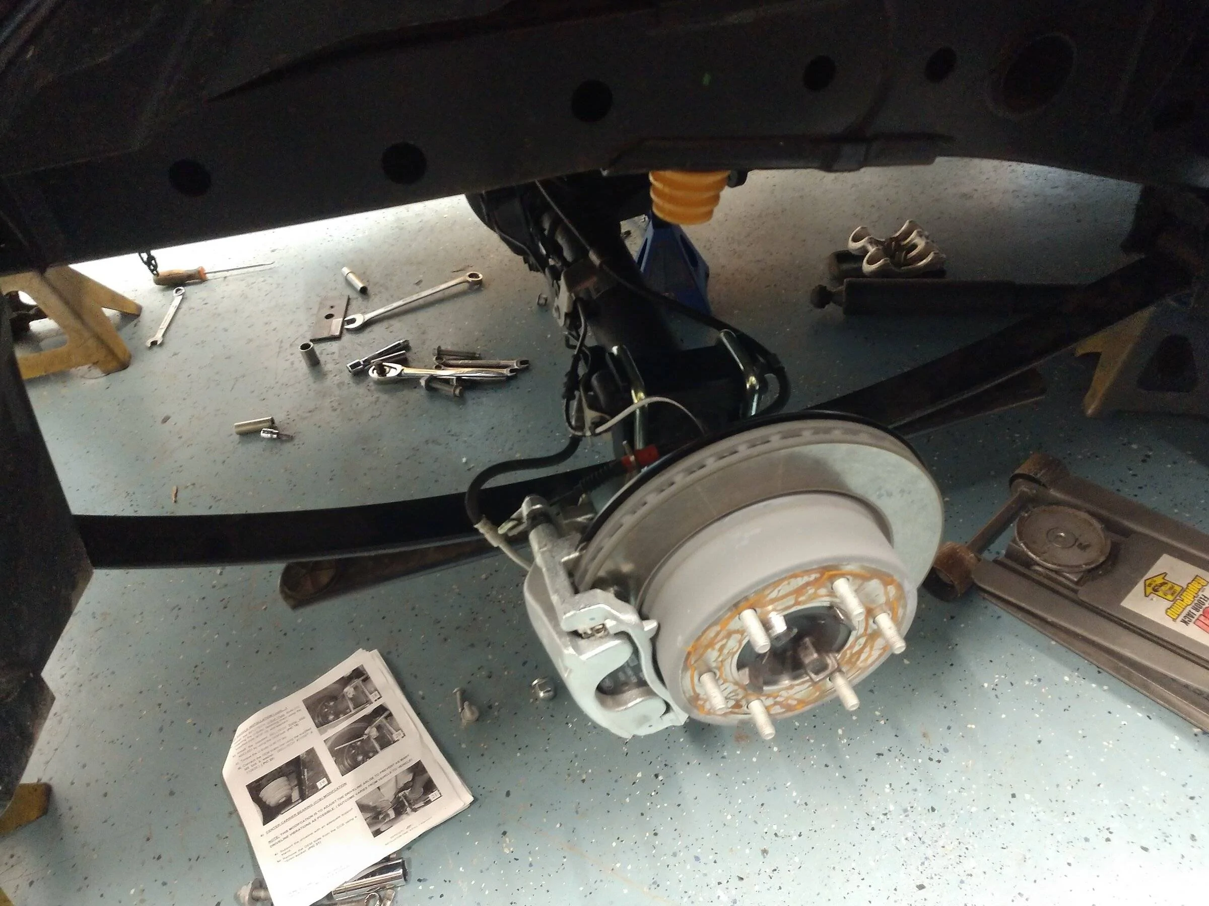

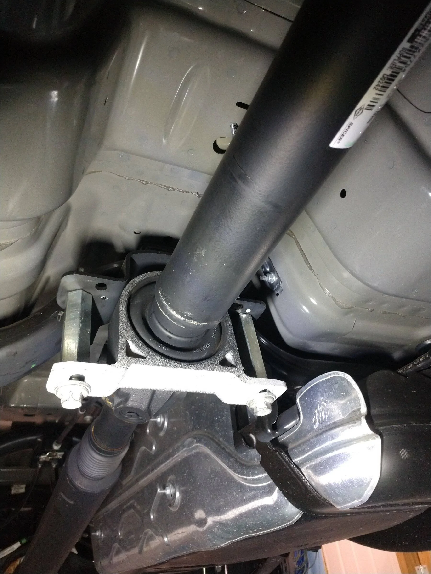

So, Tuesday afternoon, about 3:30pm, I went out to the garage and started the rear drop process.

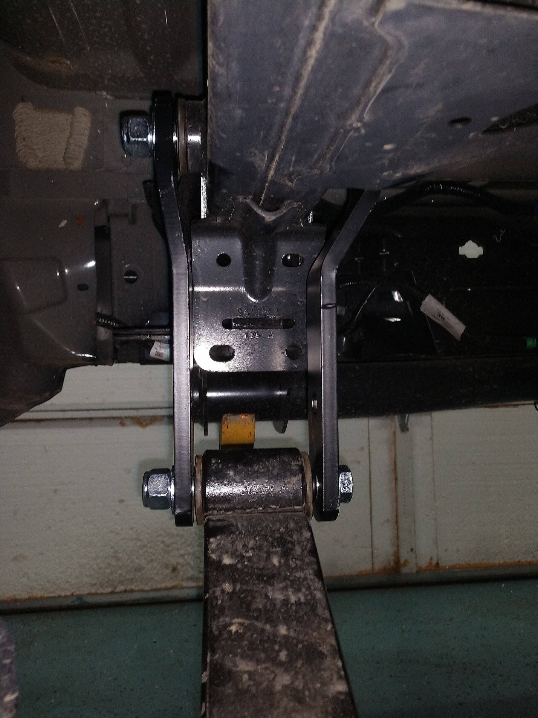

First leaf spring pack out at 4:22pm, since I sent this pic to my stepfather :) I did one side at a time, but this flip kit wasn't really as complicated as I was expecting, since it's my first one ever :)
Done with both sides here at 6:02pm. Everything but the shocks are installed on both sides here.
4" drop holes. I'm probably going to drop it to the 5" hole down the road. This pic is before I put the truck back on the ground and tightened and torqued everything.
CCB Modification.
Everything installed. 7:06pm

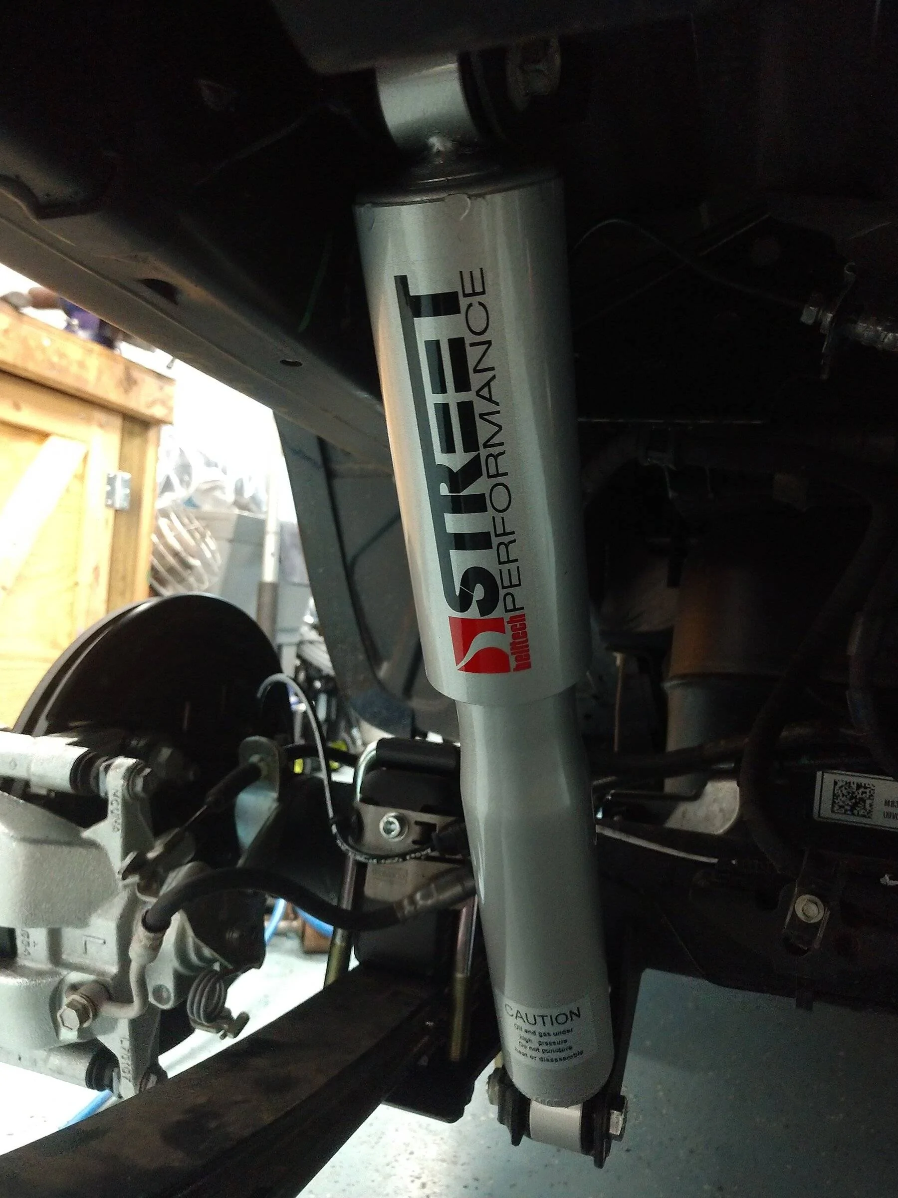

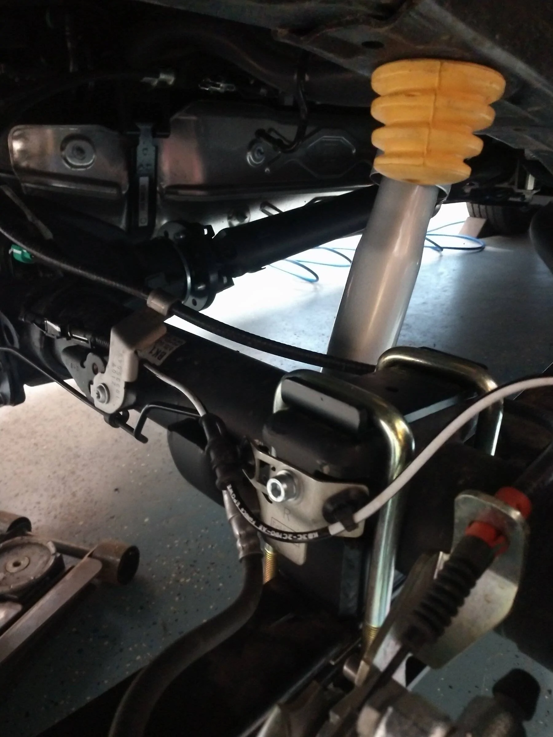

Belltech Street Performance Shocks.

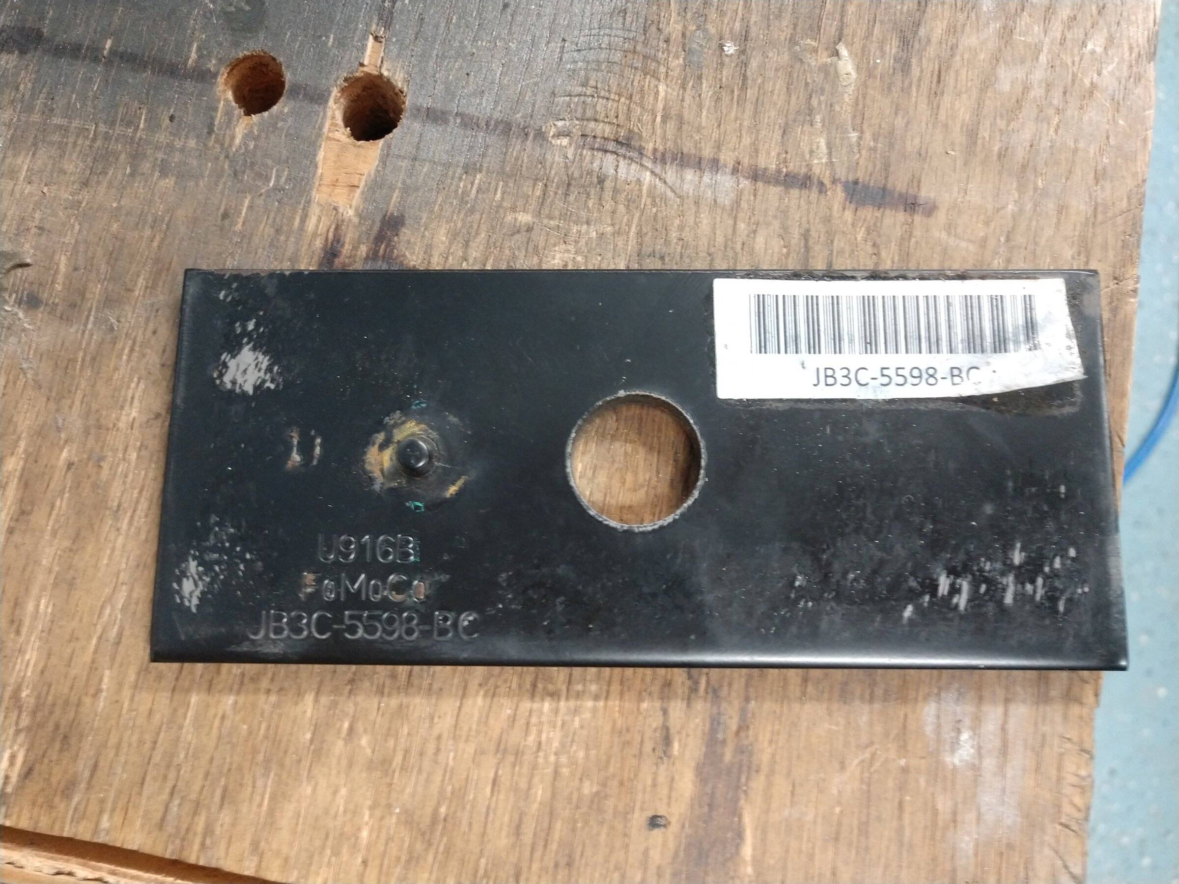

This spacer is about 1/4" thick and was on the stock Left Rear suspension. I assume it's for the height of the driver and fuel tank. Belltech doesn't mention if you're supposed to reuse it, but I kept it, because I assume you do reuse it? Does anyone know for sure?
:giggle::giggle::giggle: I had no words when I took this pic, other than childish giggling and goosebumps, LOL! This pic was taken at 7:44pm.
So, I got the whole rear OEM suspension removed and replaced with the Belltech rear 4" flip kit in about 4.25 hours, start to finish! I had to stop a few times to clean up and get some bolt torque specs, since Belltech doesn't include anything and they're instructions are pretty shitty! Just an FYI for all the novice guys wanting to do this :)
I used 2 large jackstands, 3 smaller jackstands and 2 floor jacks. I used a plethora of air and hand tools. Just take your time and you'll be able to do this in 4-6 hours, assuming you do all of your own work, like myself? ;)

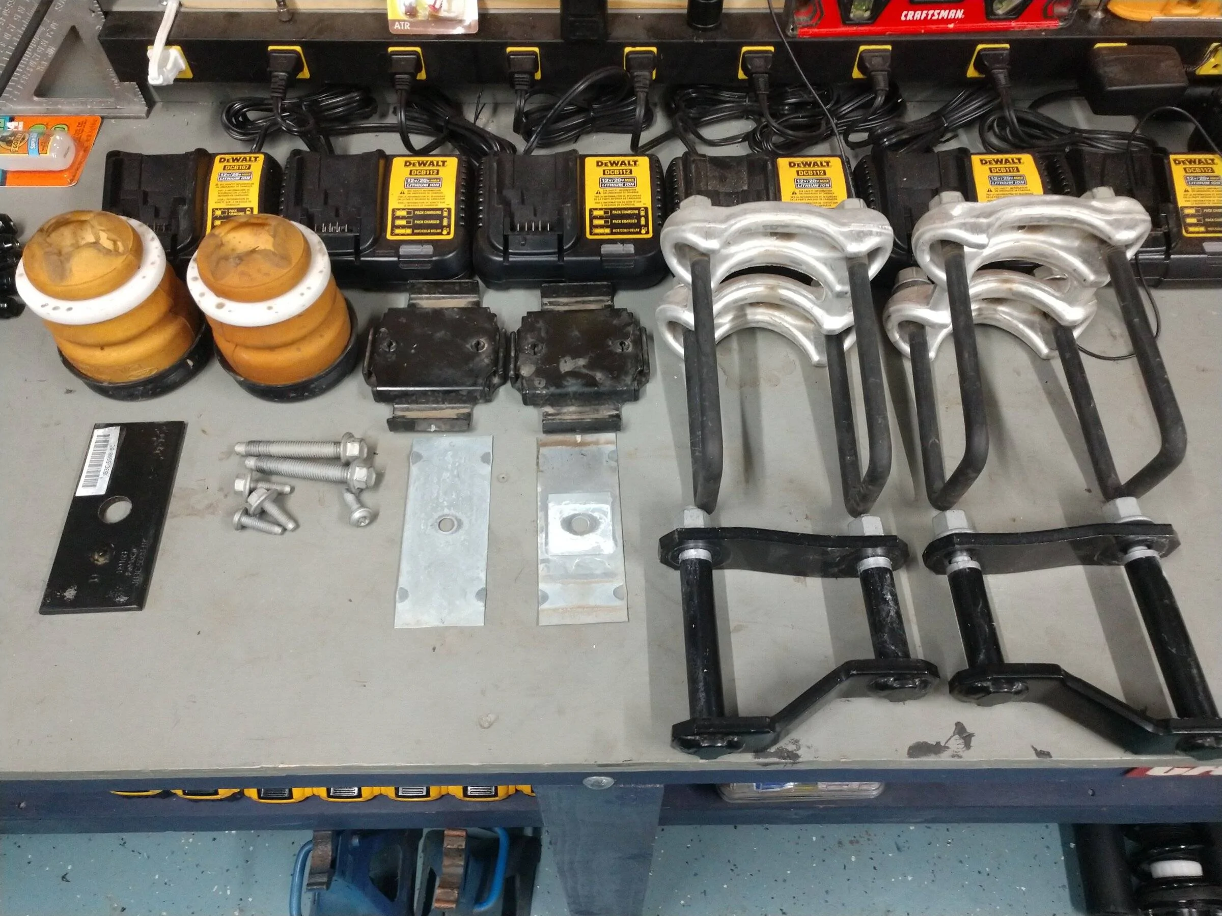

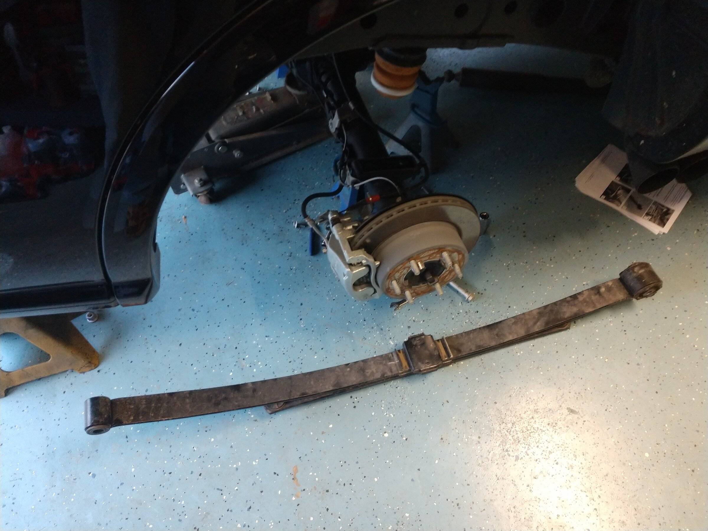

Leftovers.
I have to keep the rear shackles, in case I want to drop it 6". The rest of these parts are no longer needed, unless you plan on raising the truck back up? I'll probably box all these up and keep them :) I've made the mistake in the past of throwing stuff away, only to realize down the road that they're either discontinued or super expensive, if you can even find them?

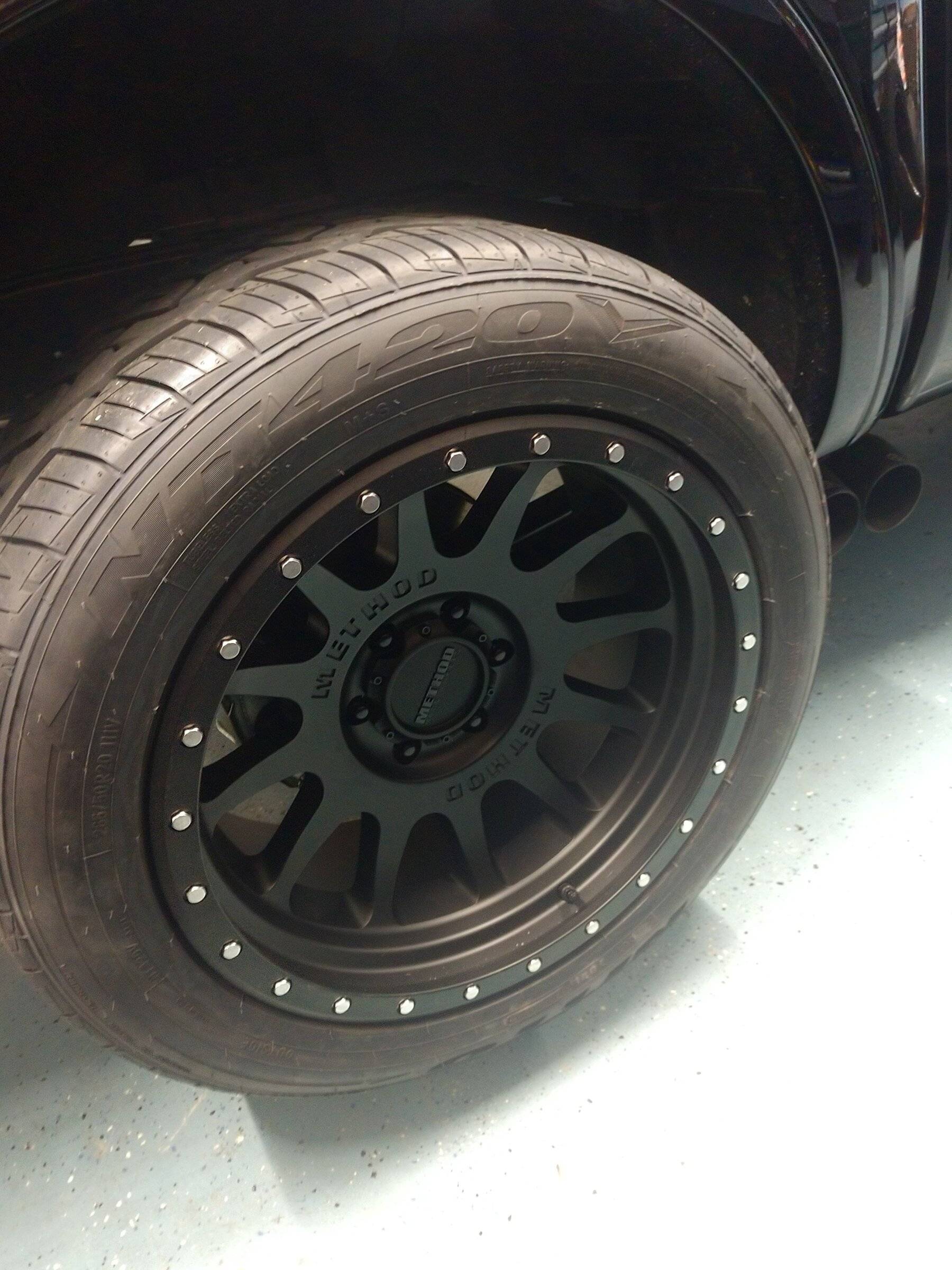

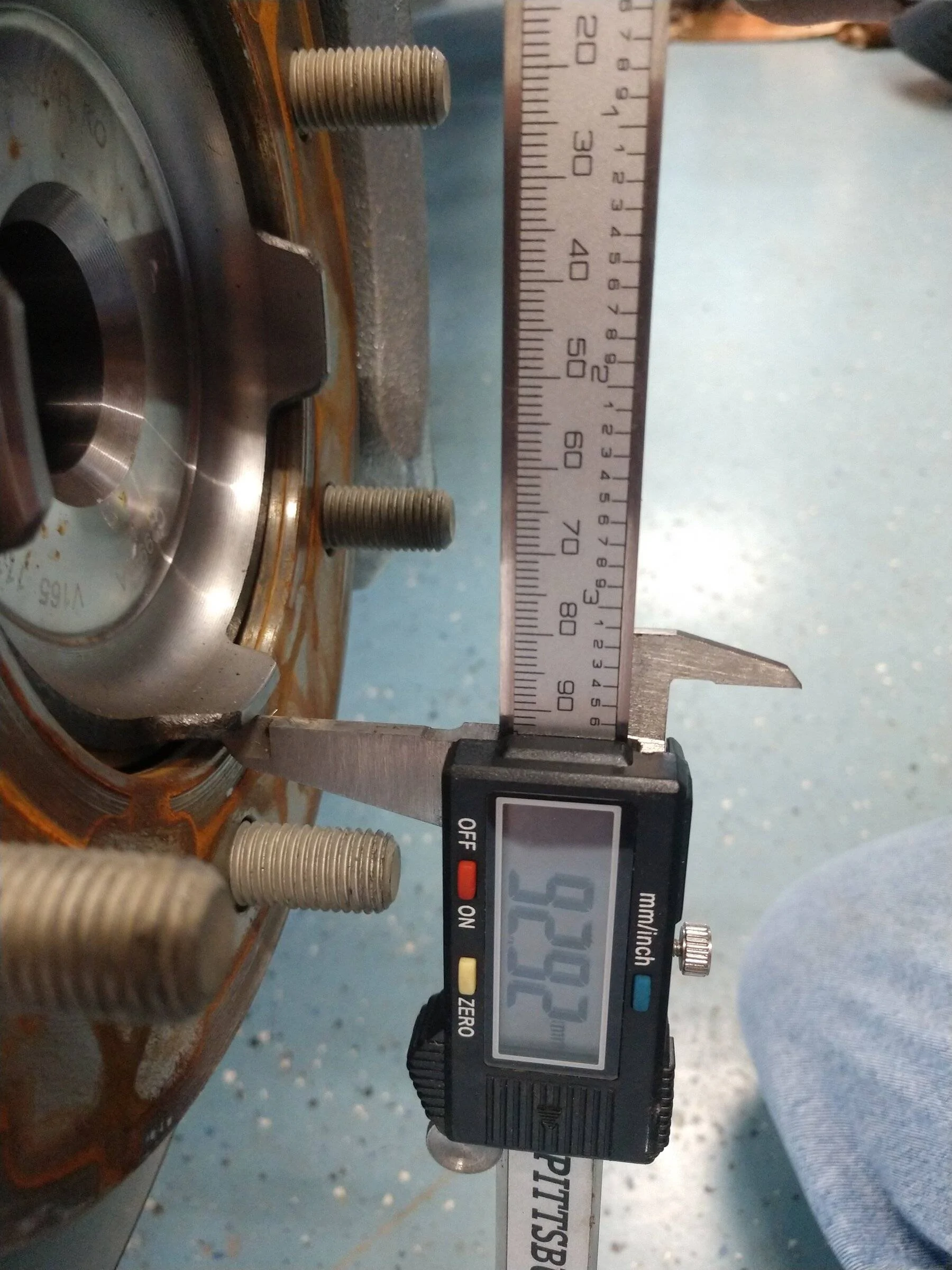

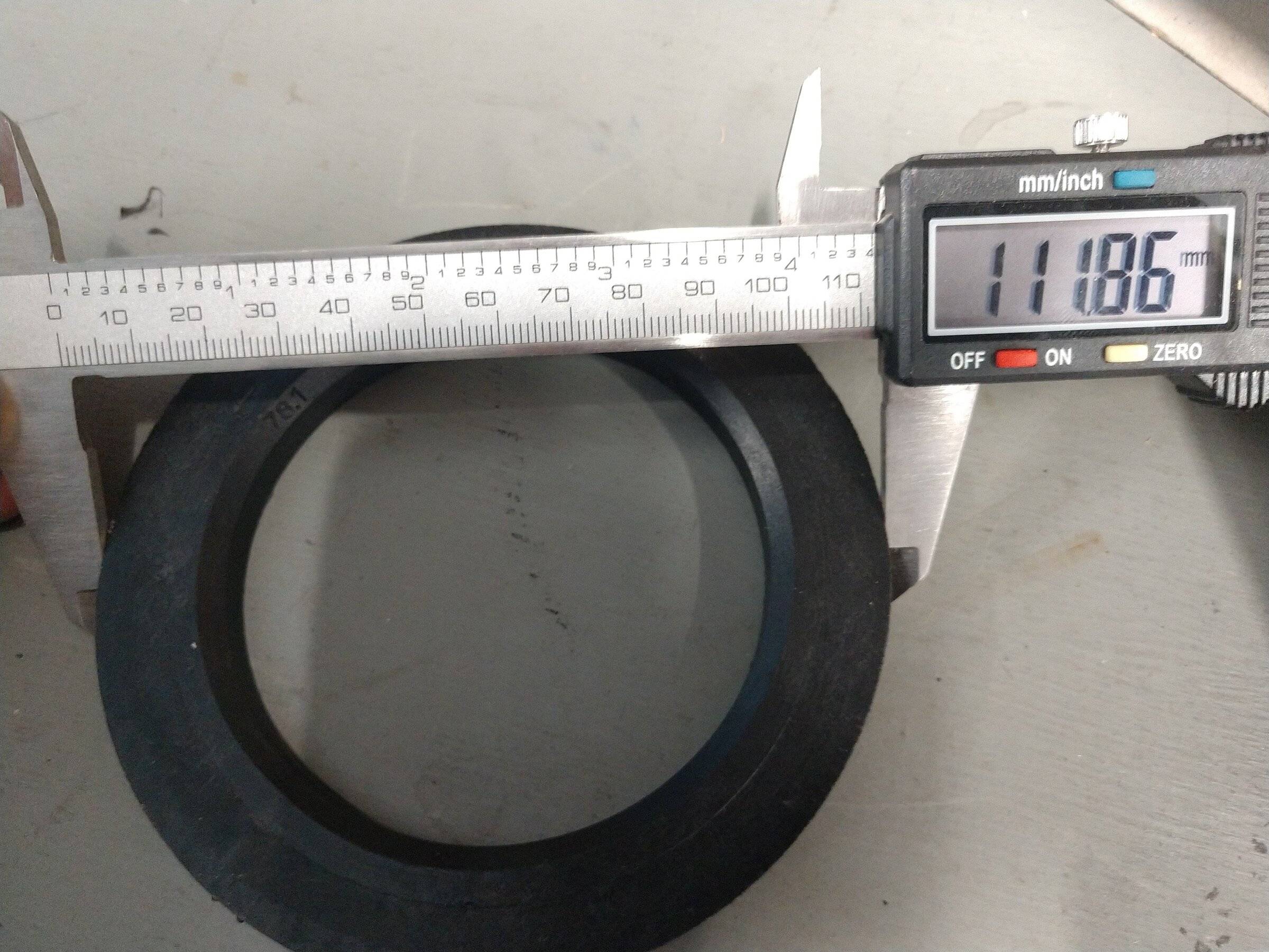

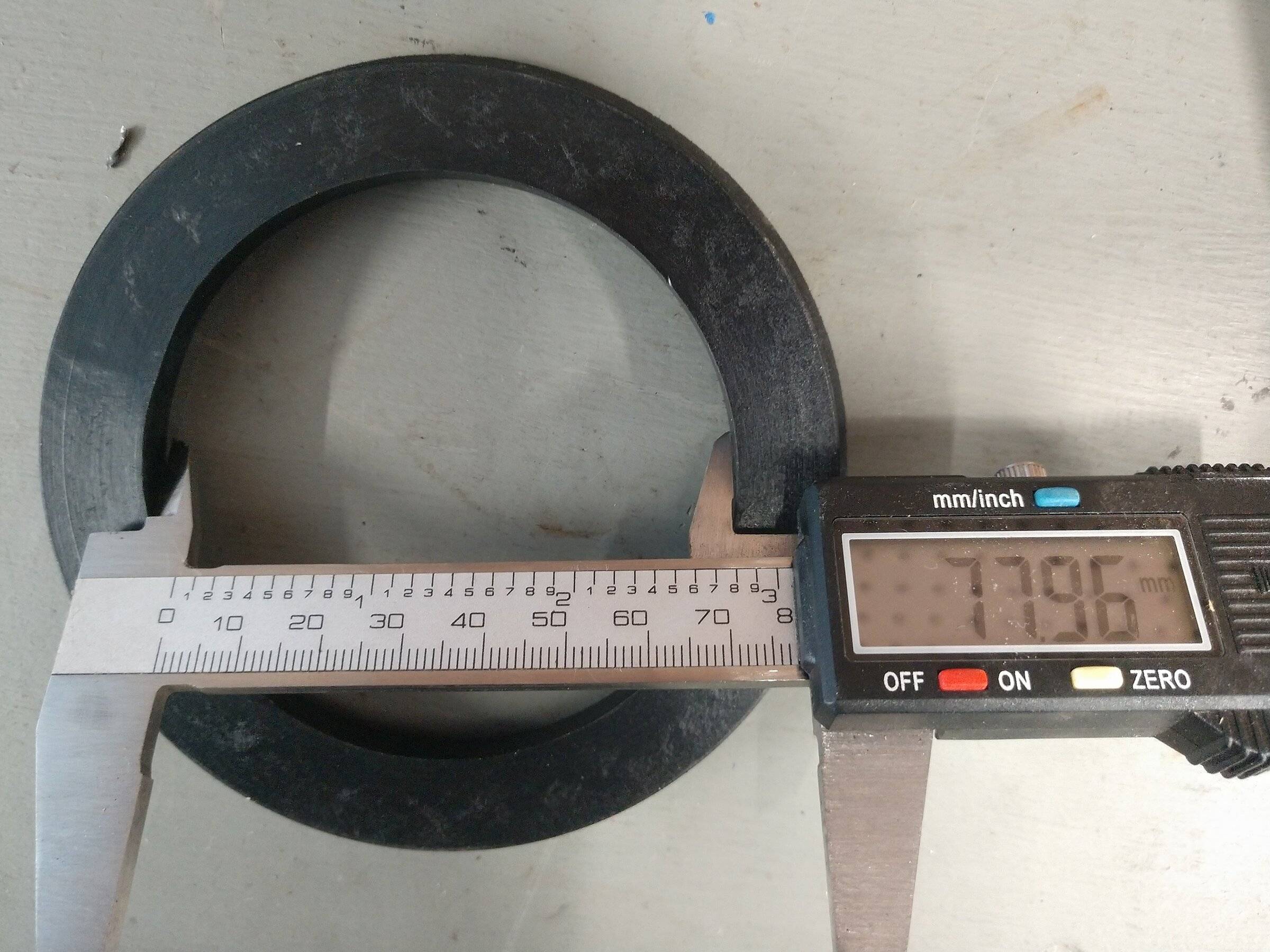

So, before I put my new wheels on, I was surprised when my new hub-centric rings fit the Method wheels, but not the hubs and after further research, I discovered why....
OD 111.86mm on hub-centric rings
Hub 92.92mm
ID 77.96mm on hub-centric rings
I order the correct size through Stage 3, but was unhappy the ID of these rings was this much smaller...
The lug nuts that came with my new wheels are so much smaller than the OEM ones. They seem to be holding them on, but I ordered some different ones from Stage 3 as well.

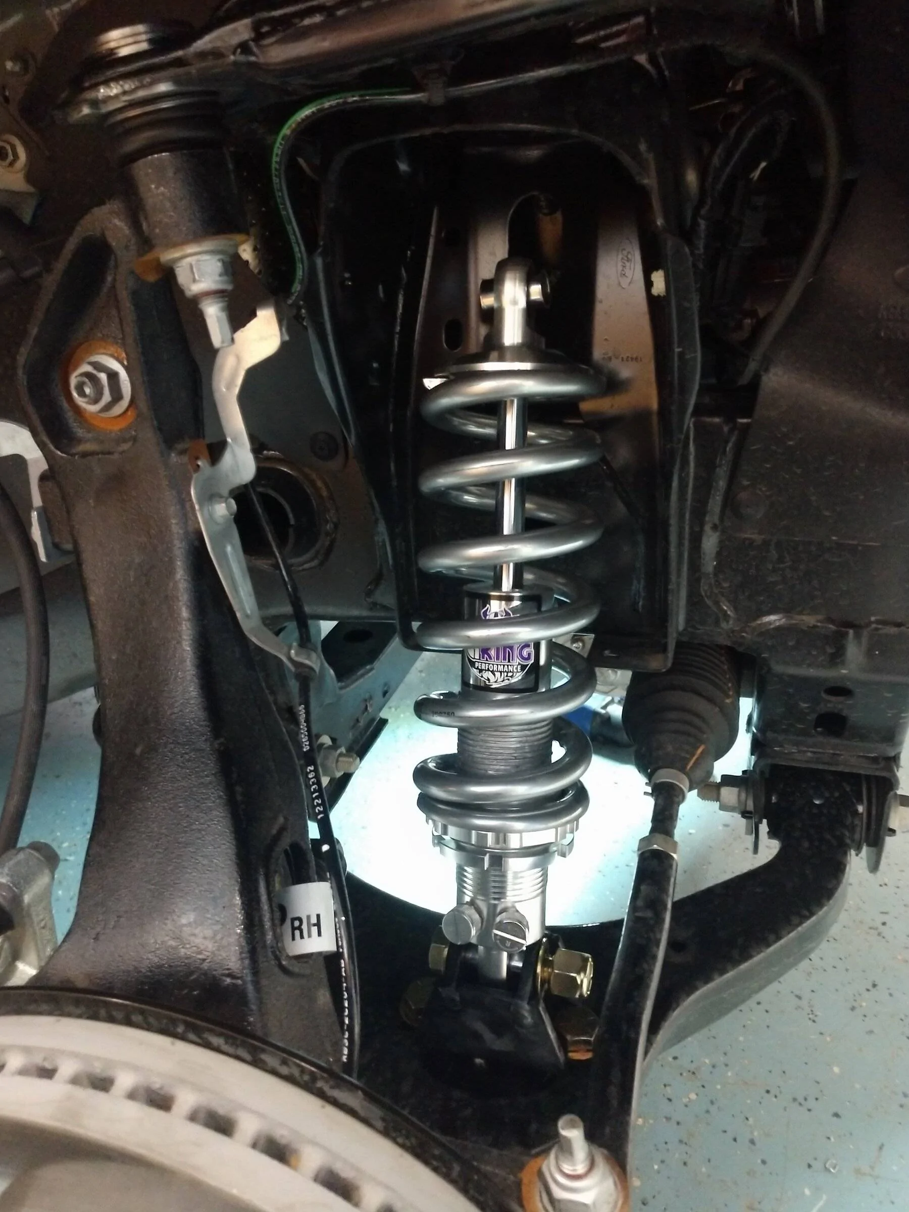

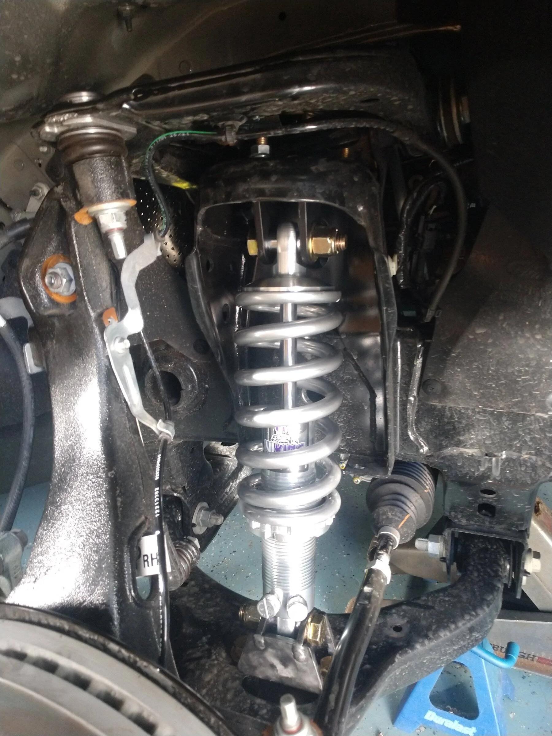

That same Tuesday night, I decided to start working on the front suspension. I knew I wasn't going to get it properly complete, but I wanted to get as much done as possible.
"Story is, my Control Freak front coilover setup with adjustable upper control arms, kinda messed up on me, during assembly, Monday afternoon. Coilovers went together fine. Control arm assembly did not... :( 2 of the heim joints decided to stop midway through the install and froze in place wherever they were at and they're not coming out, period, trust me...
Anyway, I have to wait until the 1st week of January before I get the new arms. Al @ Control Freaks is going to pre-assemble them for me."
So, I started the front end stuff at 8:23pm.
Got the OEM front suspension removed from both sides and as much of the Control Freaks suspension installed at 10:39pm.

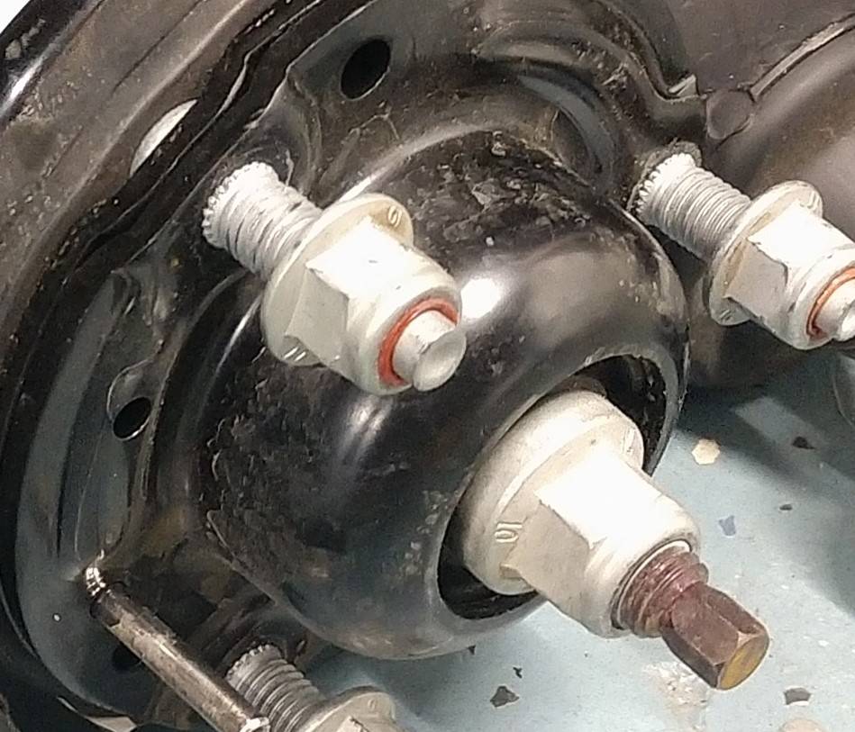

CF didn't include any bolts, washers or nuts to install the upper coilover mount to the frame, so this ended my progress on the suspension swap Tuesday night. I emailed Al, to let him know I was missing a bag of hardware. Wednesday morning, he emailed me back and said nothing was missing and to use the stock hardware, off the OEM suspension.... I sent him this pic of the stock suspension...
I told him I couldn't use the stock "bolts" and I was going to buy the correct parts at Lowe's/Home Depot.
Things must've changed between early 2019 and later 2021 Rangers, since mine were installed with something more like wheel studs...
I came in the house Tuesday night at 11:15pm... I was so tired, that I didn't even eat any food, just took some Alieve and passed out...
So, Wednesday morning, around 9am, my stepfather picked me up and I luckily found 6 M10 Class 10.9 bolts and nuts and 12 flat washers at Lowe's. We came back home and I finished installing the coilovers. I torqued everything to specs and adjusted the coilovers so that 2 inches of threads were showing below the locking ring.

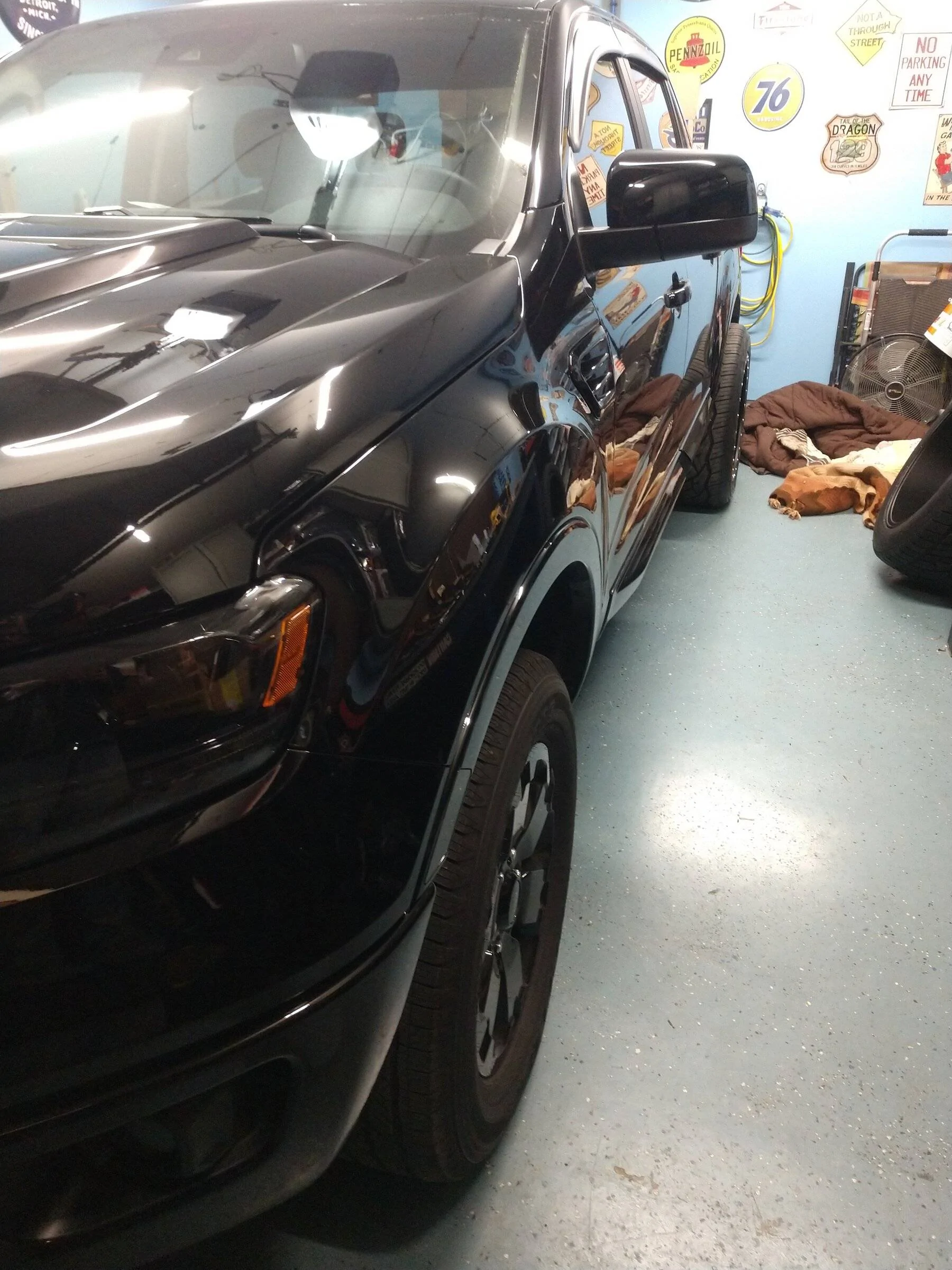

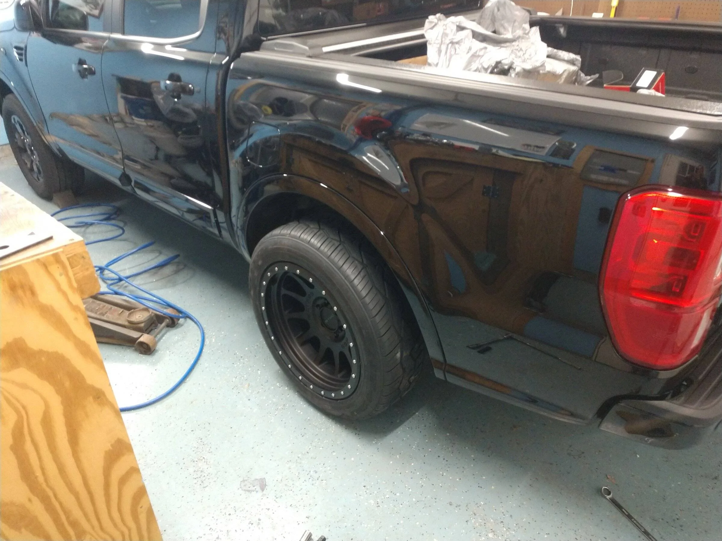

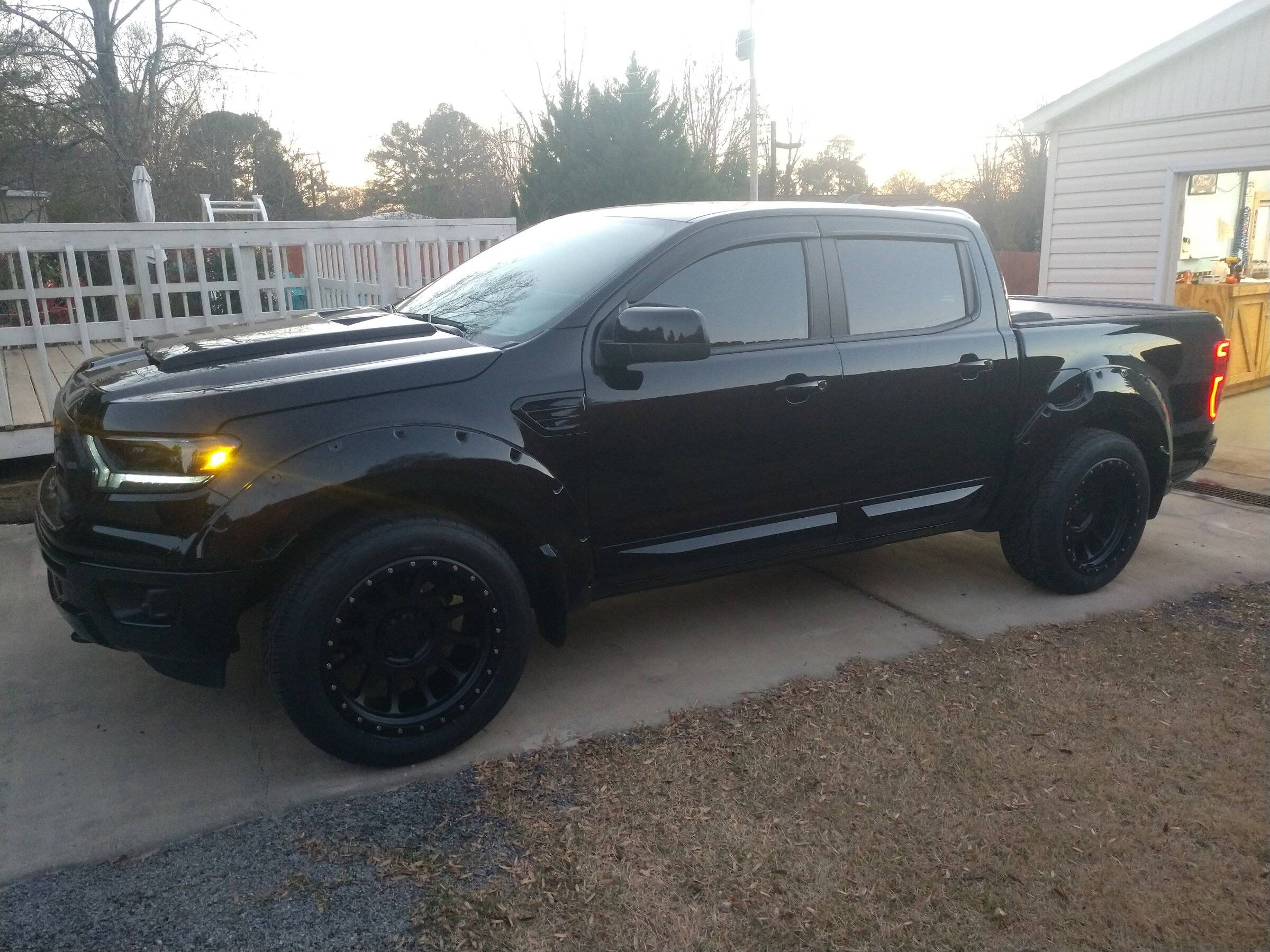

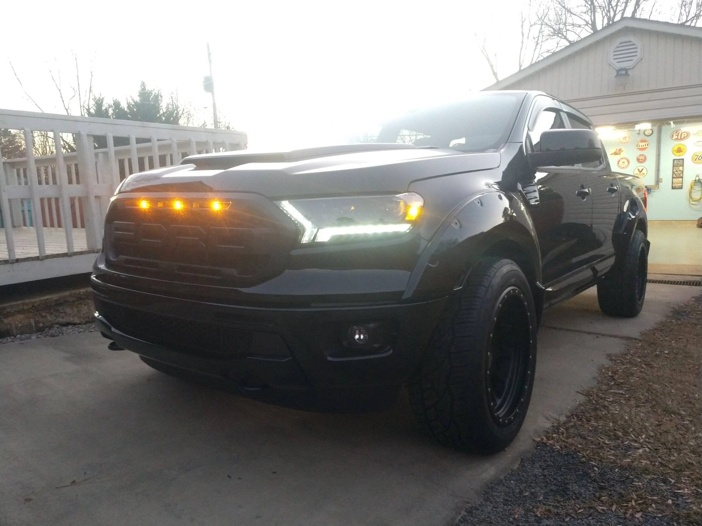

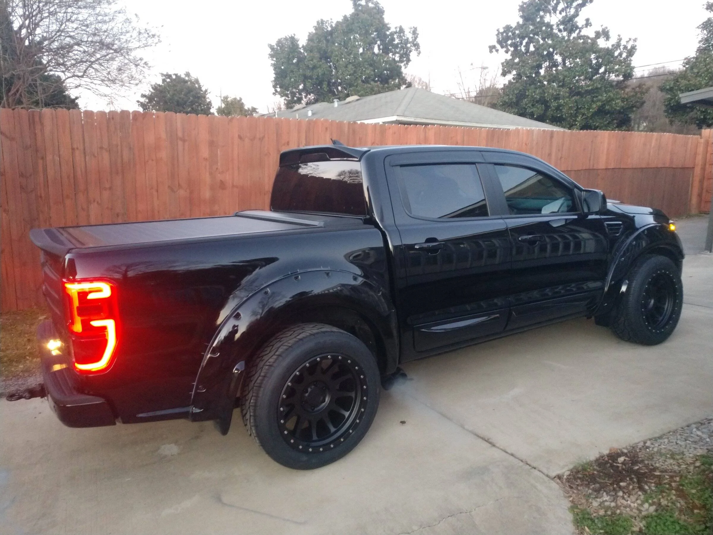

We put the front wheels back on and mocked up my Air Design Fender Flares and pulled the truck out of the garage and took some pics about 5pm Wednesday afternoon.
Truck sits sweet now! But, I couldn't turn my front wheels much.... :(

Lookin good man!
Your truck puts all the Air Design pieces together well. I think it's the black, they look more subtle with their matte black against the gloss black. On lighter colored trucks they "pop" too much, I think, making them look a bit ricey.
Looks like your plan is coming together nicely. Looking forward to seeing your final stance. I don't think I've seen another SCrew dropped around here. They all seem to be SCabs.
My FX-4 is totally different. But I really like the lowered trucks. I'd love to build a sport truck one day.
