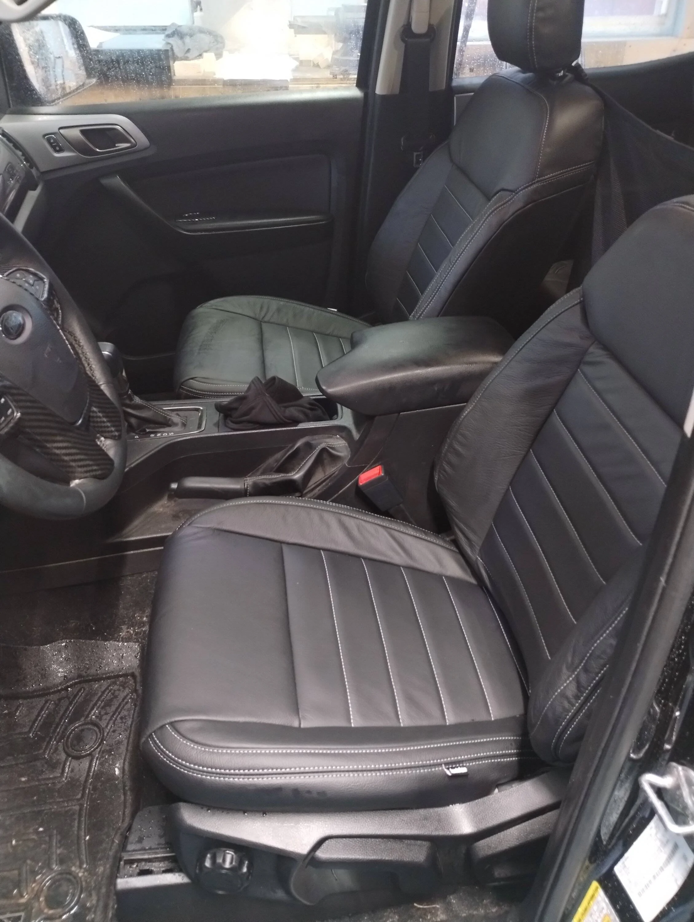

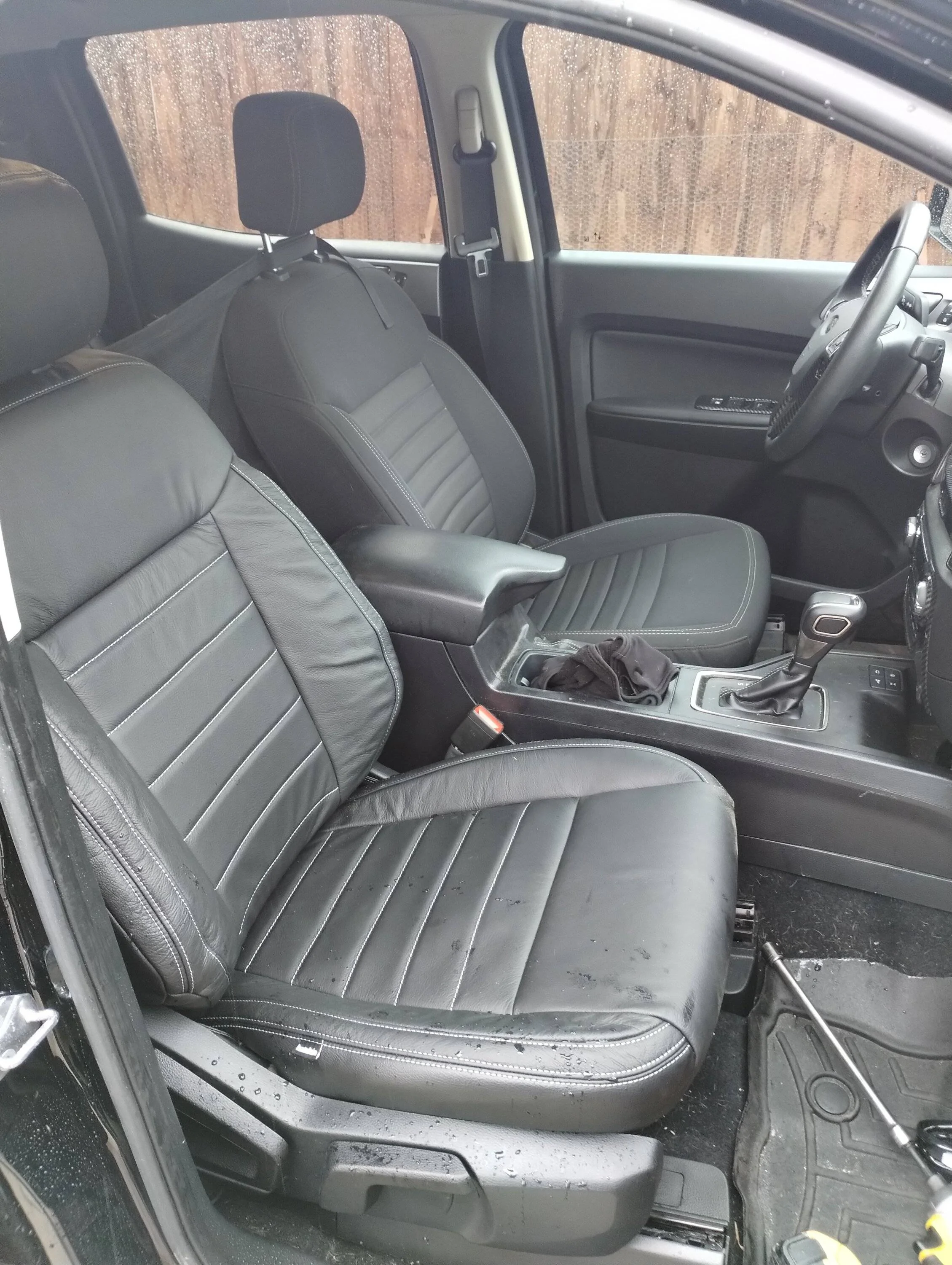

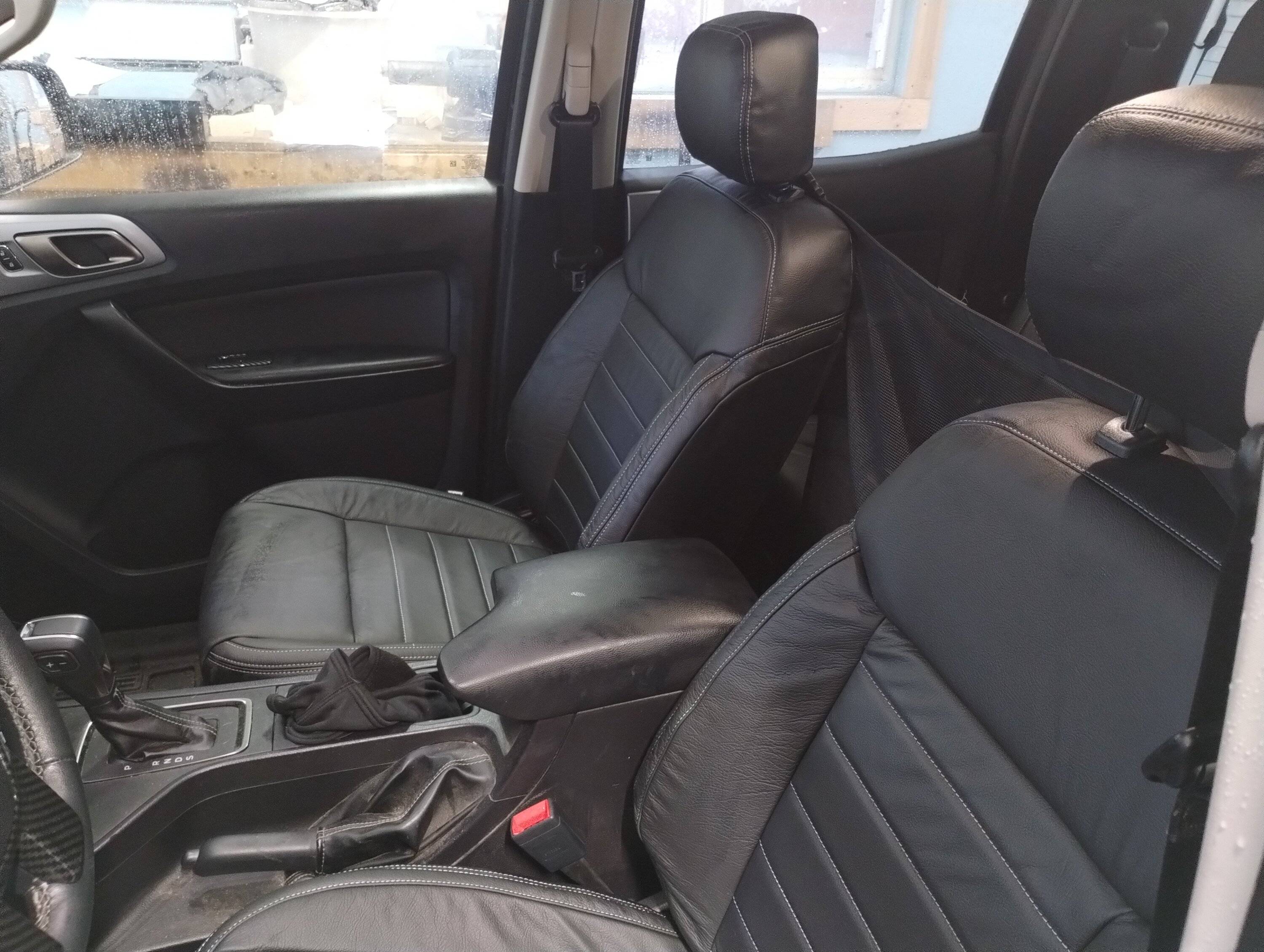

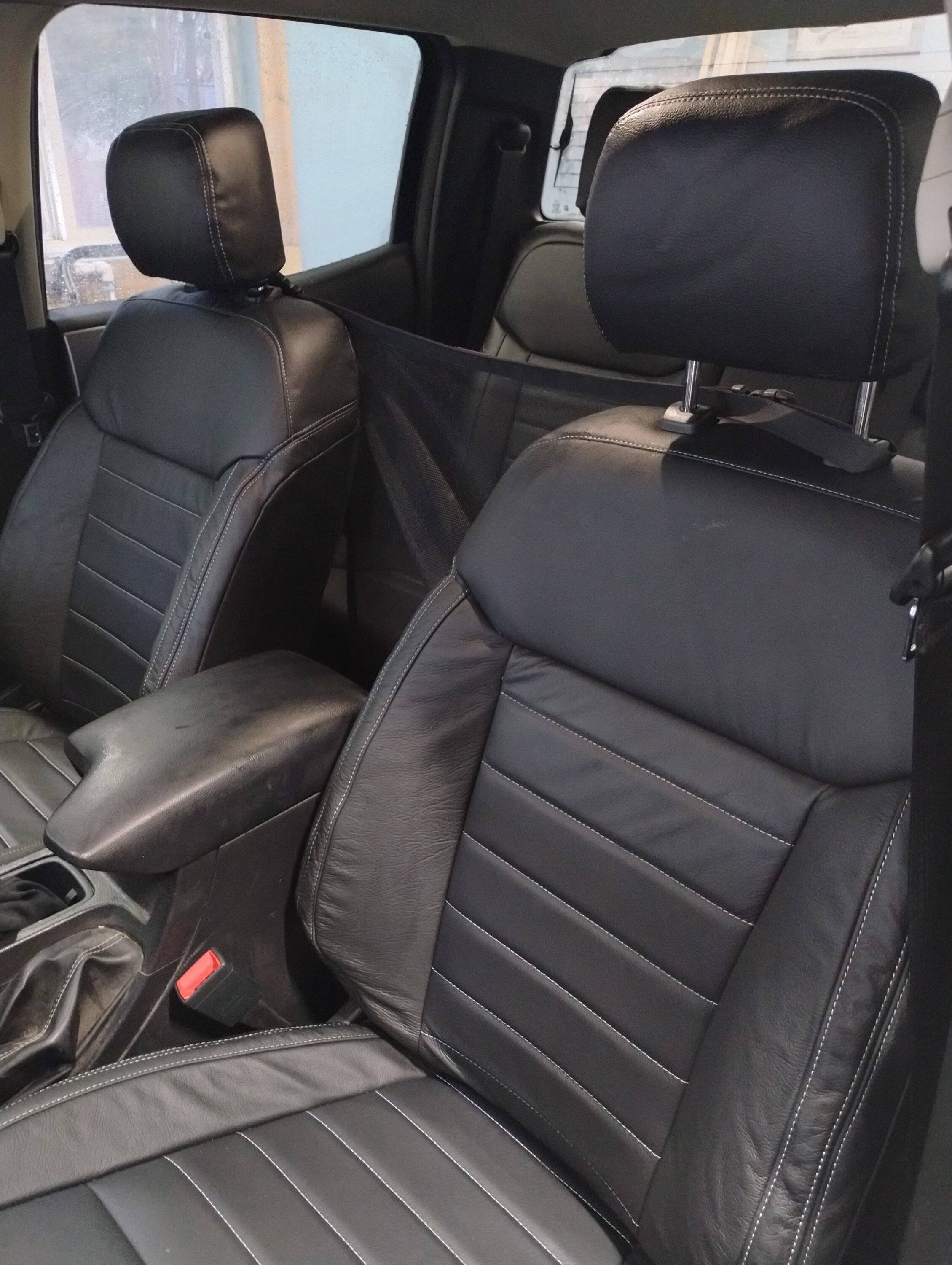

So, Tuesday, the seat heating elements came in. I watched the other 2 videos about how different both front seats are, last night. I went to work for 3 hours this morning and decided to take off and come home and get these seats done!
Got home about 10am, starting working on the seats about 10:30, passenger side first. I almost didn't install the heaters..., first they didn't look like that were going to even fit, the secondly, I noticed you can cut them to a certain length. I then installed them in the passenger bottom seat, only to realize I forgot to put the protection tape over the cut.... ?‍♂ I then had to take the bottom part off the seat frame and fix it, but all in all, the passenger seat took about 2.5-3 hours, from removing from the truck to installing in the truck and prerunning the heater wiring under the carpet.
It's been cold and raining all day and during this whole ordeal, I got soaked, LOL! Enjoy the pics!
2021+ Ford Ranger Katzkin Leather Installation PART 2 - Passenger's Seat video
Drivers side took roughly 2 hours from removal to install. I honestly didn't think I was going to get both done today.
2021+ Ford Ranger Katzkin Leather Installation PART 1 - Driver's Seat video
Again, I used zero steam on these. I guess I could rent one or just wait till the summer heat hits :D This weekend, it's supposed to be a little warmer, so I'll probably wire up the butt/back warmers! I've never owned anything in my life, with heated seats :O

Nice job Jason! I don't think I'd tackle taking the seats apart like that as I know I'd be driving around with just the foam afterwards.? I've been in plenty of vehicles with them but my Ranger is the first I've owned. I'll tell you what, I'll never buy another without them! Besides warming you up they're great for when your back is sore and aching. I use mine all the time here especially when getting out out work. It's like having a built in heating pad. ?
Yessir. Back problems make heated seats almost mandatory anymore.
Thanks Dave! I was a little nervous honestly, but once I watched those videos, I figured I'd be fine?
I was super nervous about the headrest guide plastic pieces and actually broke one on the rear seat... I didn't do it like the video guy suggested and I totally broke it, LOL! The front seats, however, I did exactly like he did and it worked exactly like his video did :)
My wife's super ancient CR-V has heater leather seats, but I rarely ride in her car, cause it's not an ideal ride for a 6'6" man to fit comfortably....

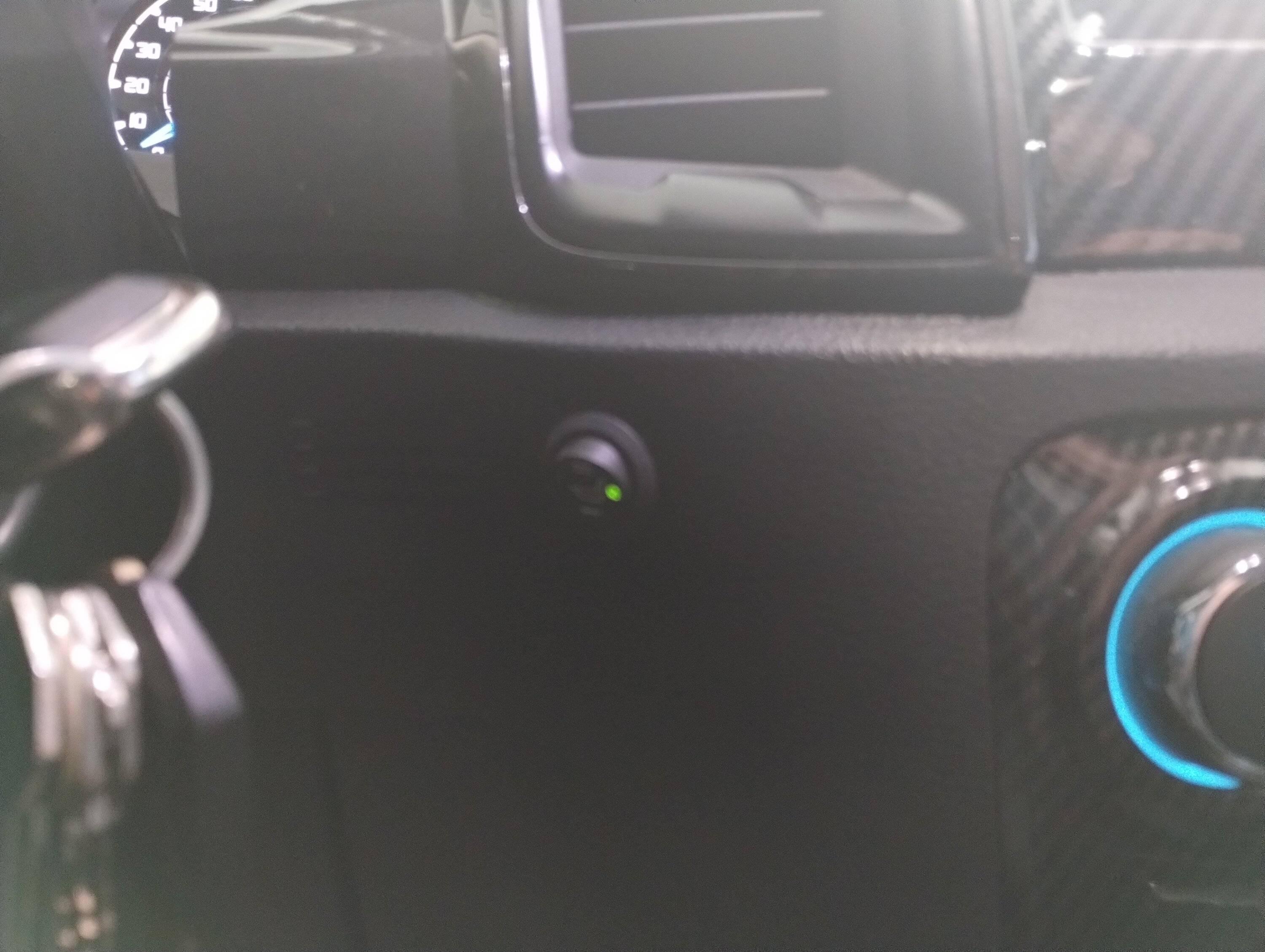

Earlier this afternoon when I got home, I decided to go ahead and wire my seat warmer switches. After I decided on where I wanted to put them, I drilled the holes and ran the wires and got it done so quickly, I just decided to splice into one of the 12v ports under the AC controls. Before I reinstalled everything, I did a 5-10 minute check on both seats to make sure everything was working as it should and it was :)
Somehow I managed to eyeball the switch holes to be somewhat in the same spot on each side?
Low heat setting (Green light) Super tough to get a clean pic... :(

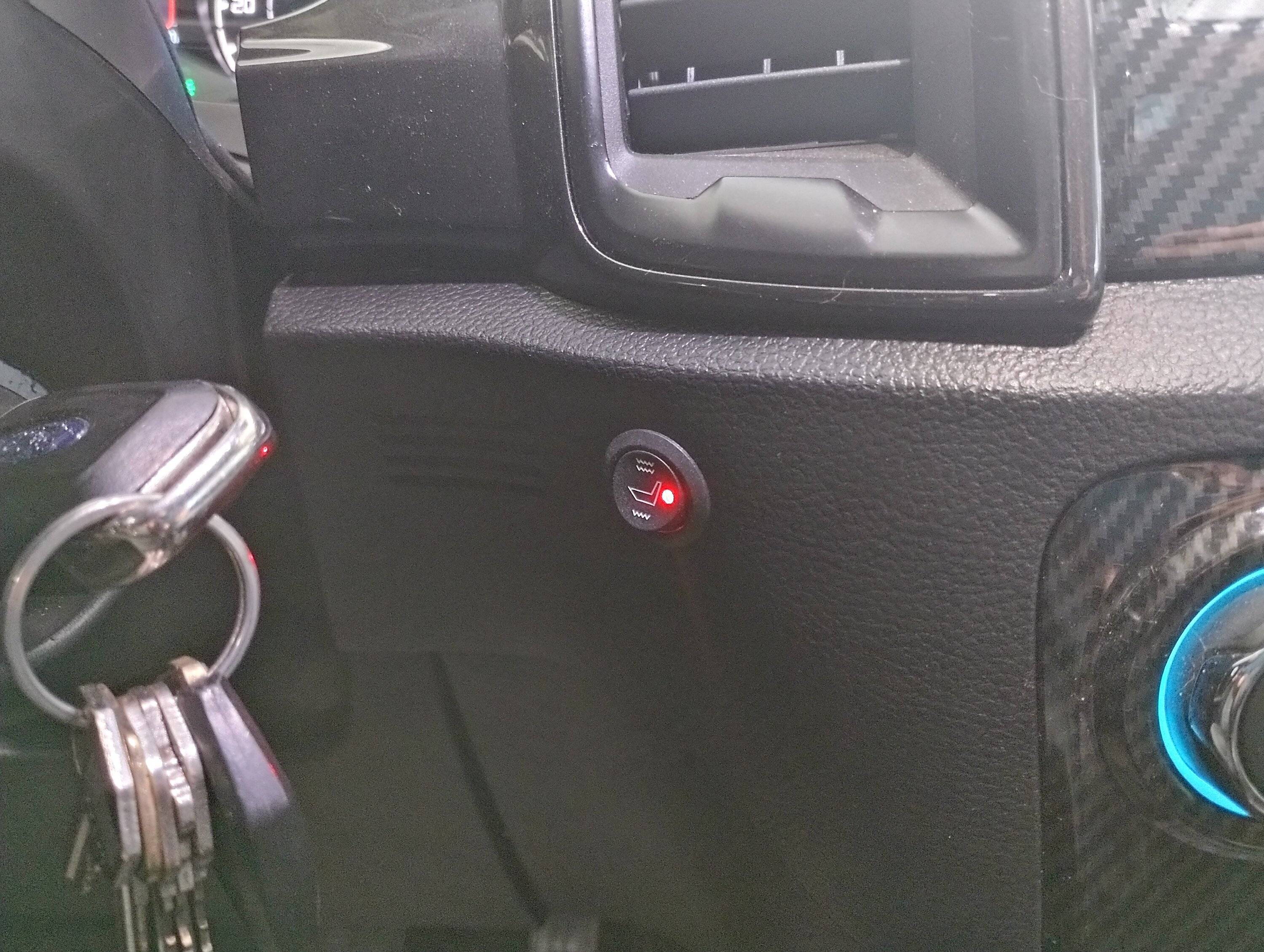

High heat setting (Red light)
It took a few minutes before I felt any warmth on the lower part of the seat and maybe 10 minutes before I felt anything on the back. Might be because I had all my warm clothes on, as it was super cold in the garage, but I could definitely tell they were working

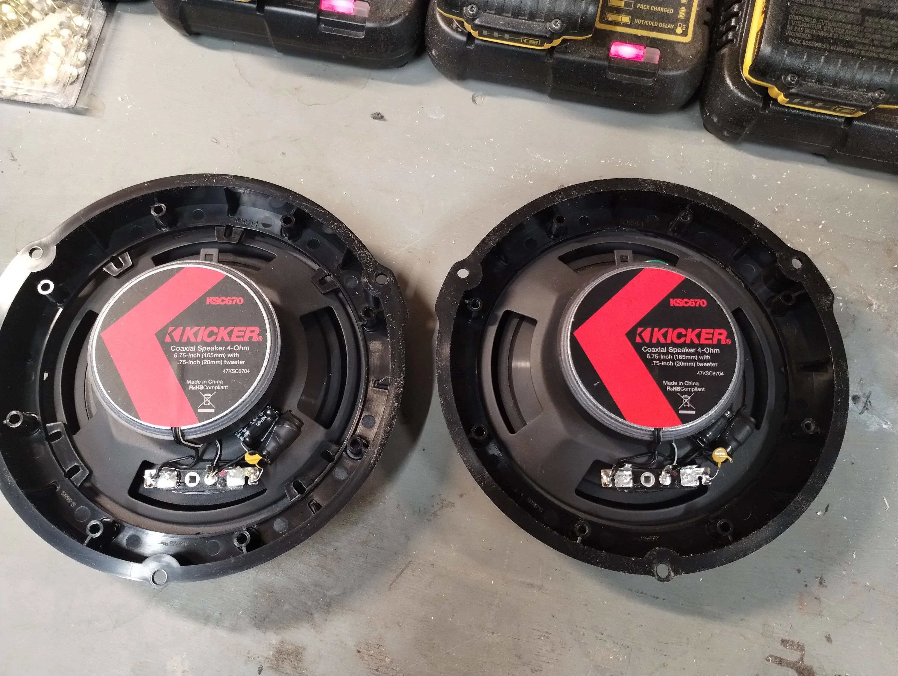

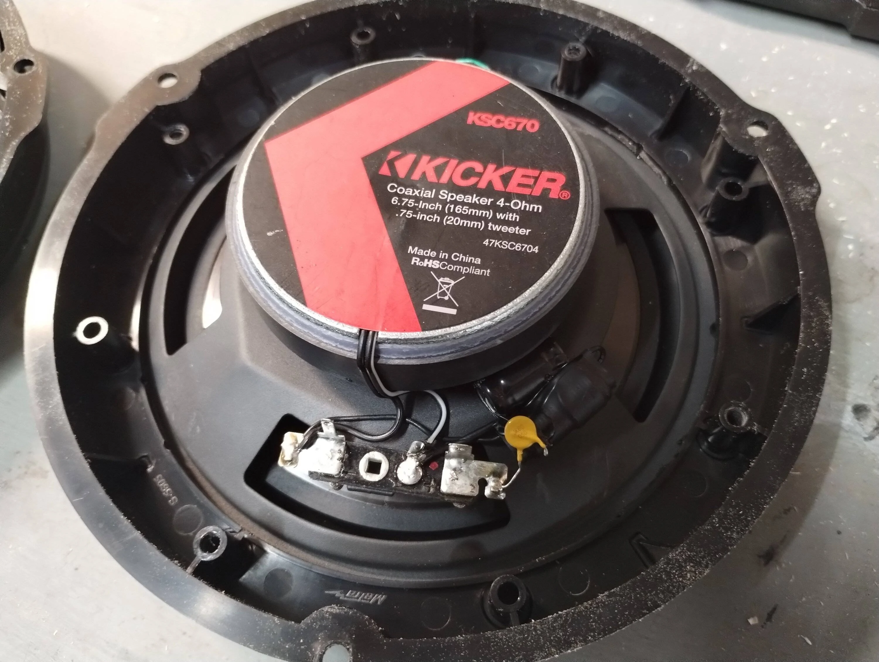

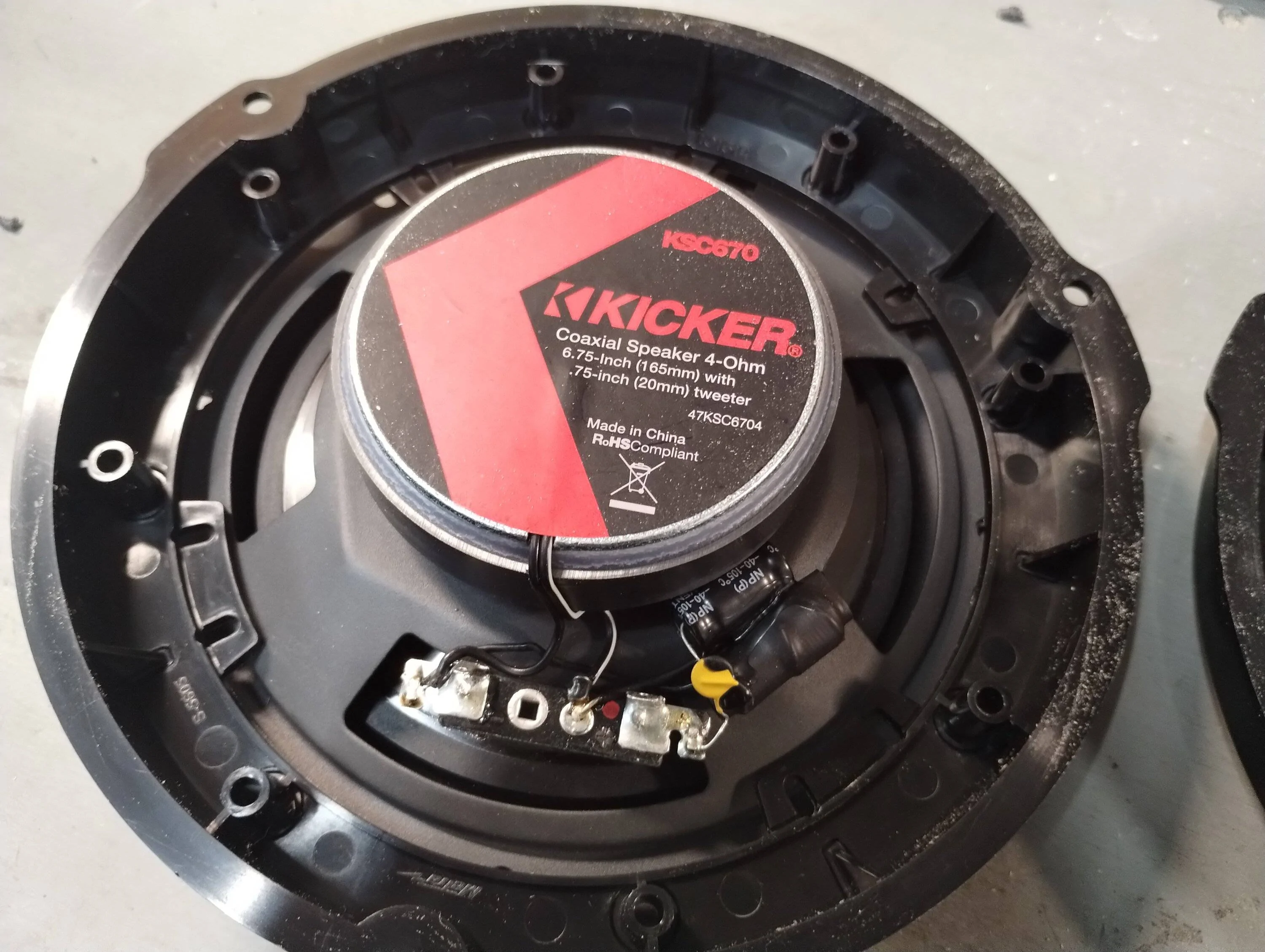

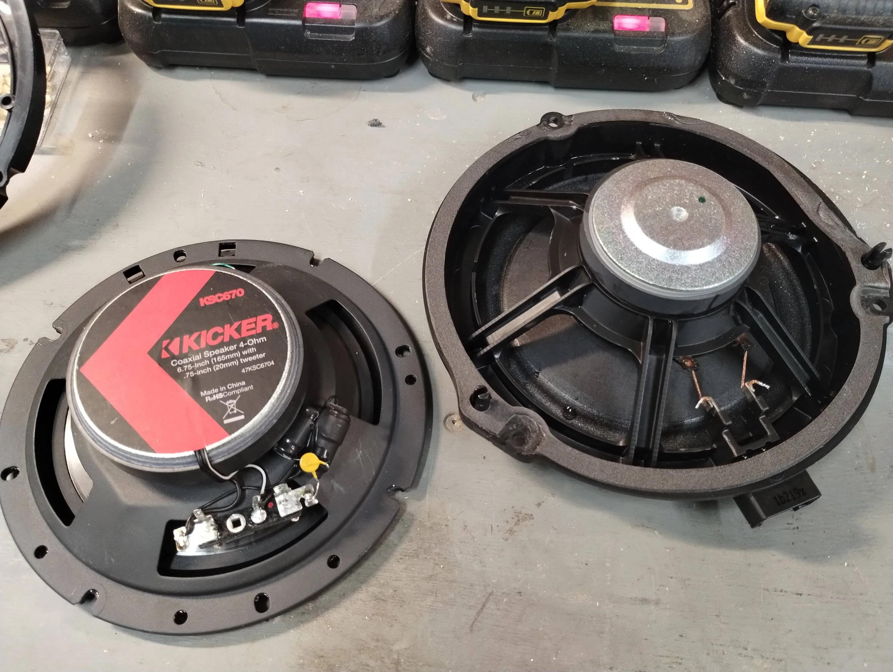

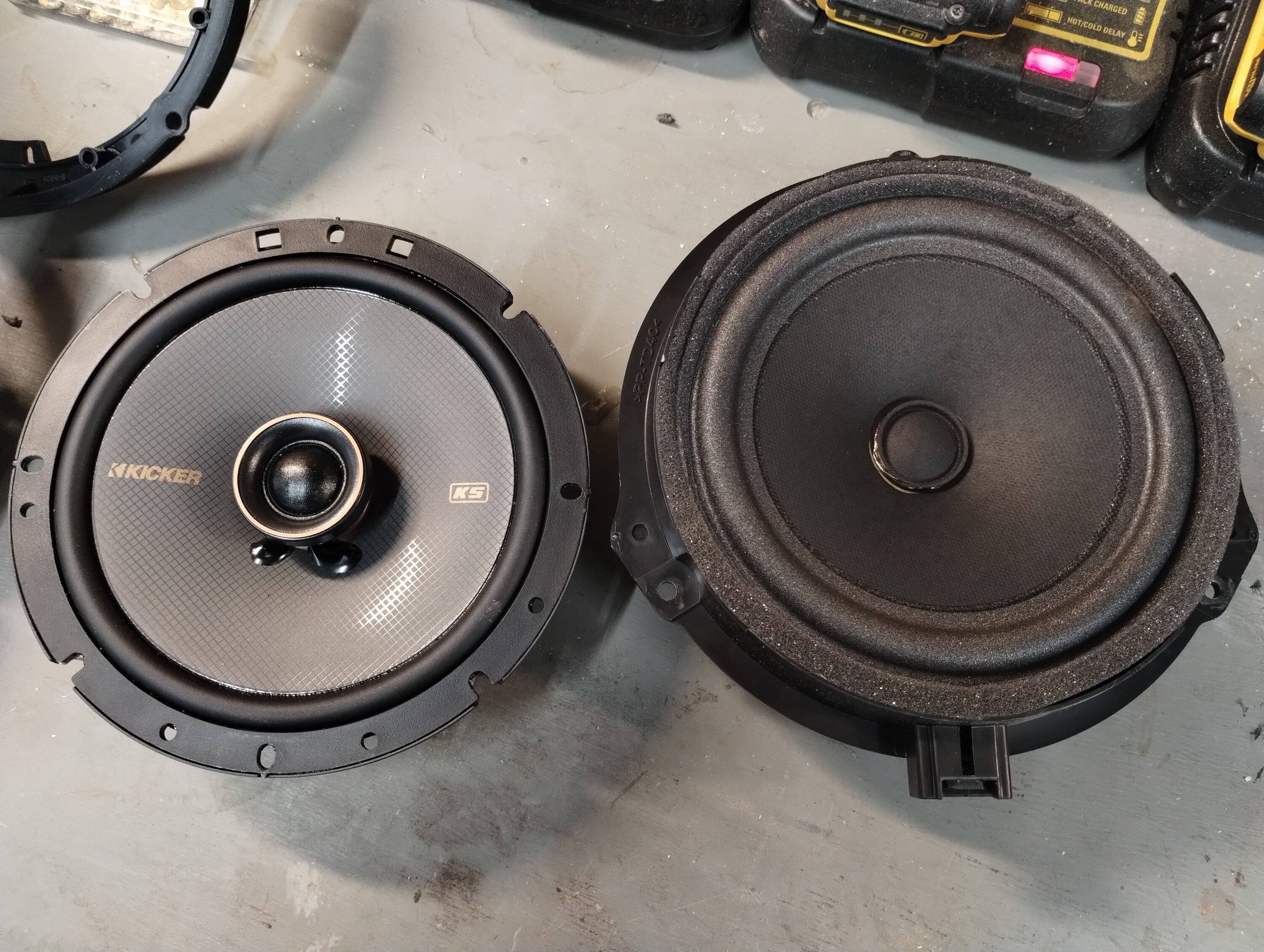

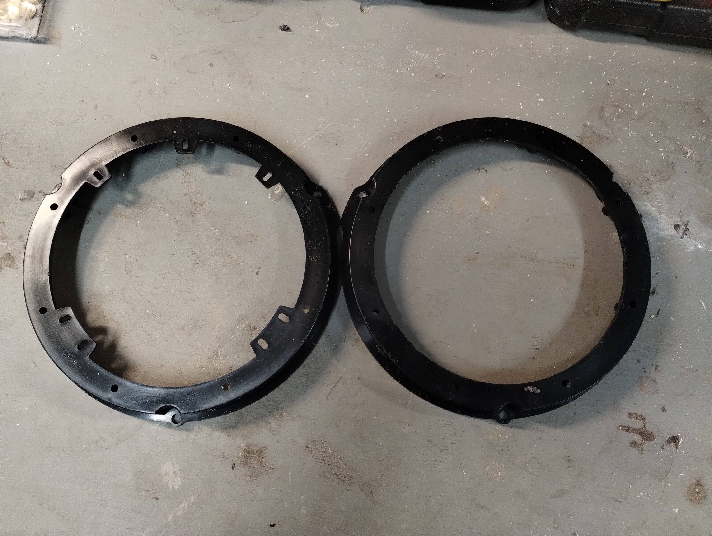

Anyway, let's start with the Kicker KS (part #47KSC6704) Door Speakers, Metra (part # 82-5605) Speaker Mounting Brackets and Metra (part #72-5602) Speaker Wiring Harnesses, all ordered from Crutchfield. Zero instructions on how to install these, so after some test fits, I decided to remove the 5 little "tabs" from the Mounting Brackets.
This is how the speaker fits with and without the "tabs"
Gap with tabs...
Flush without tabs.
Comparison between Kicker and OEM speakers.

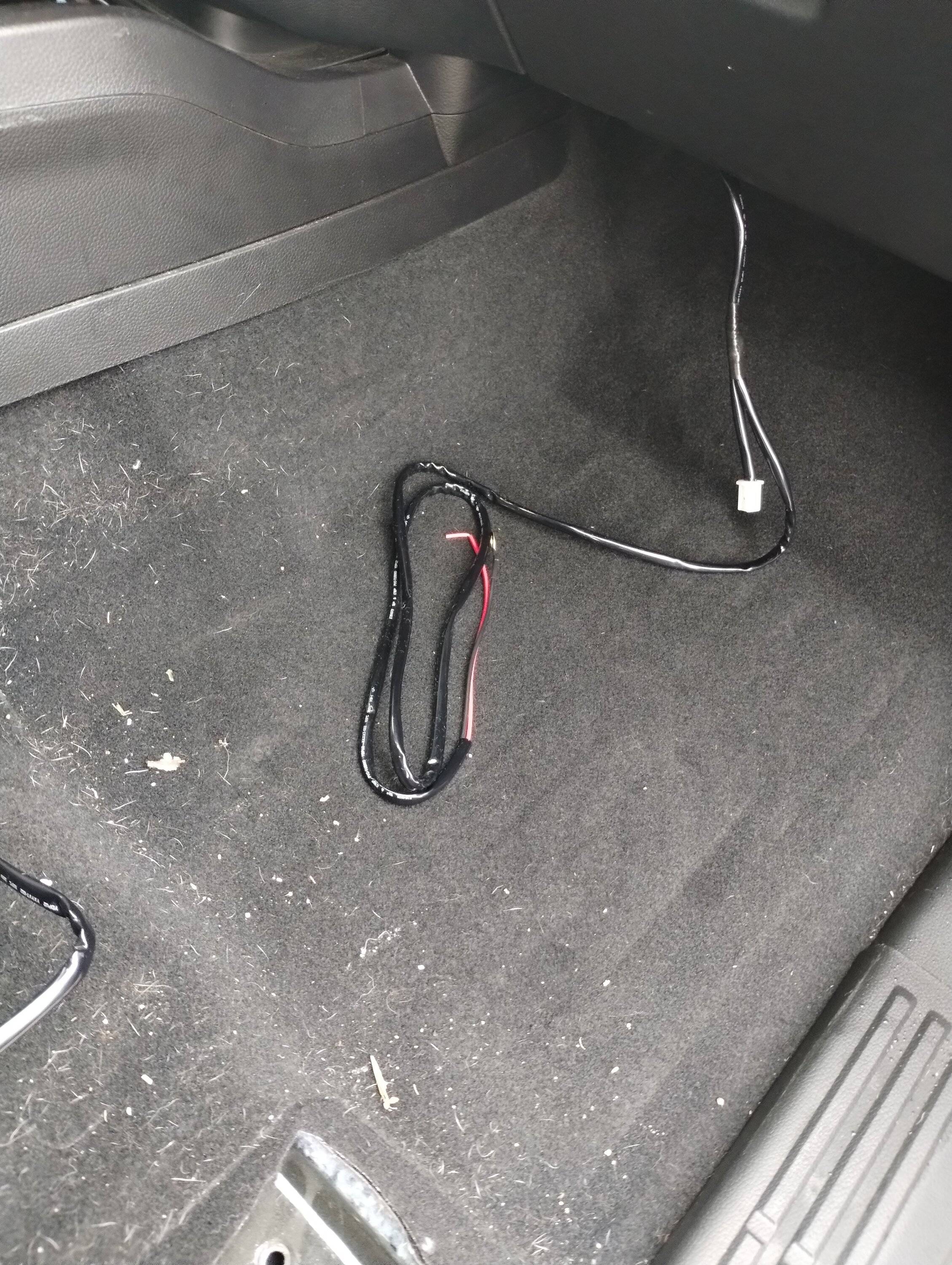

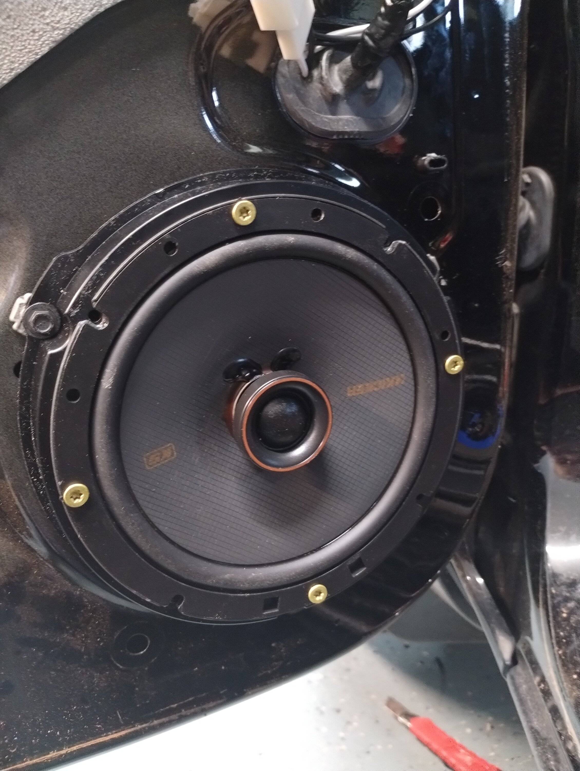

Pic is drivers side front door. I made a little slit in the grommet, above the OEM speaker and ran the new speaker wires through the slit. I used some 1" exterior screws to hold the speaker into the mount, since there weren't any with the kit... I used the OEM screws to install the mounts to the door.

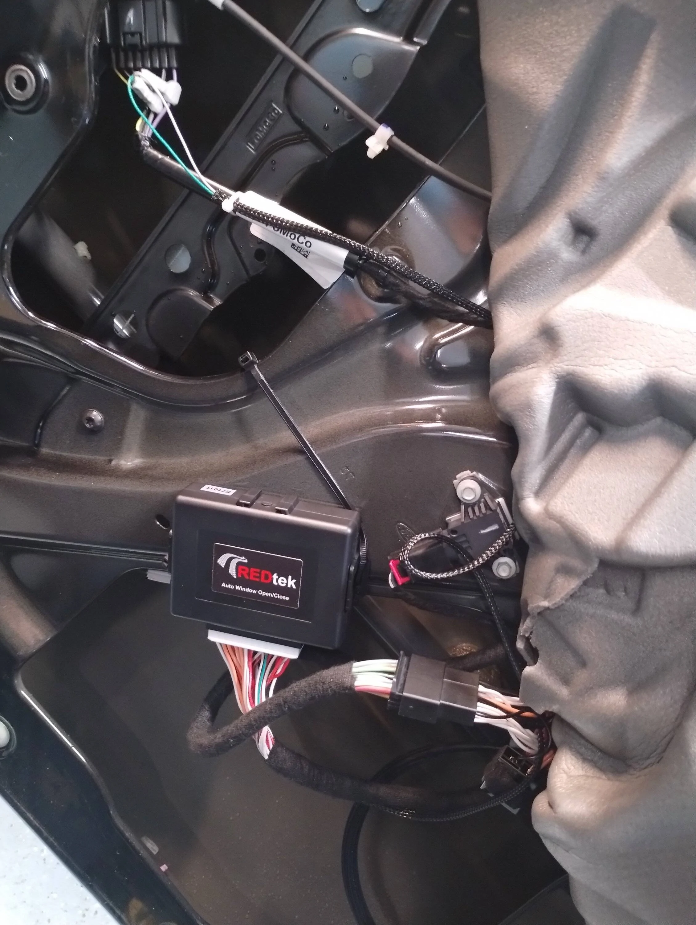

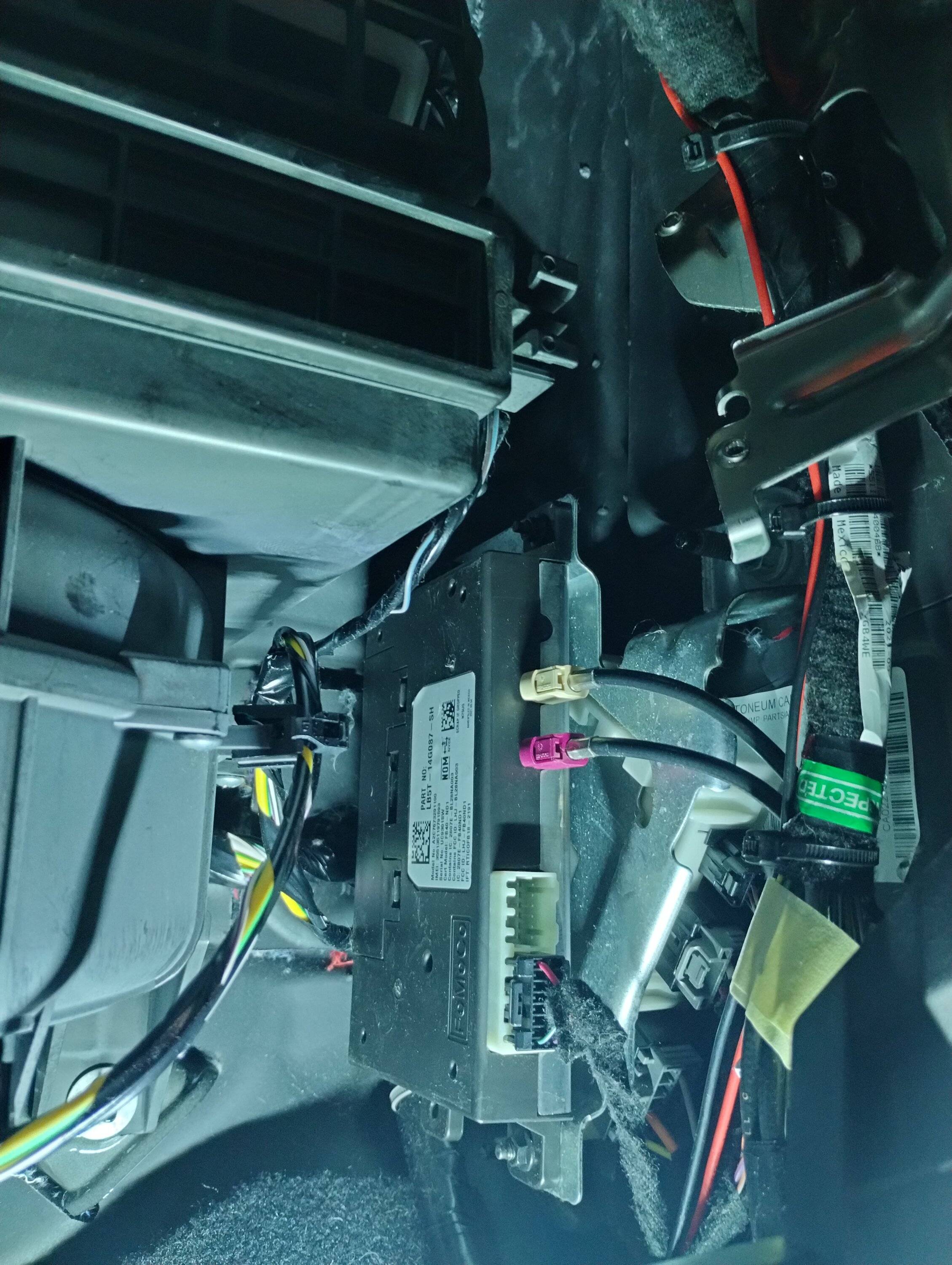

While I had the front door panel off, I installed the REDtek auto window module. I had to relocate the module, as it was hitting the door panel and it had to be mounted between the weather barrier and door panel. It works great, EXCEPT the windows do not roll back up after 1 full minute of being down or after you lock the doors... I have contacted REDtek about this issue...

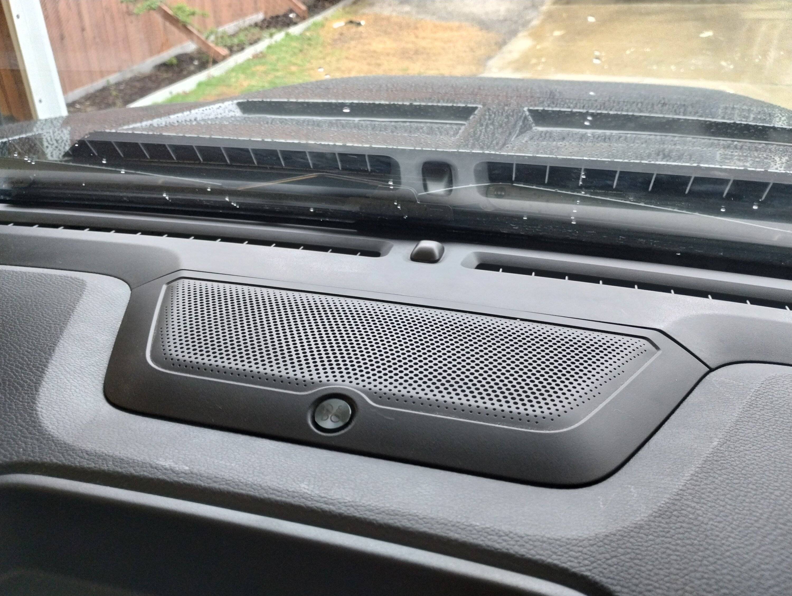

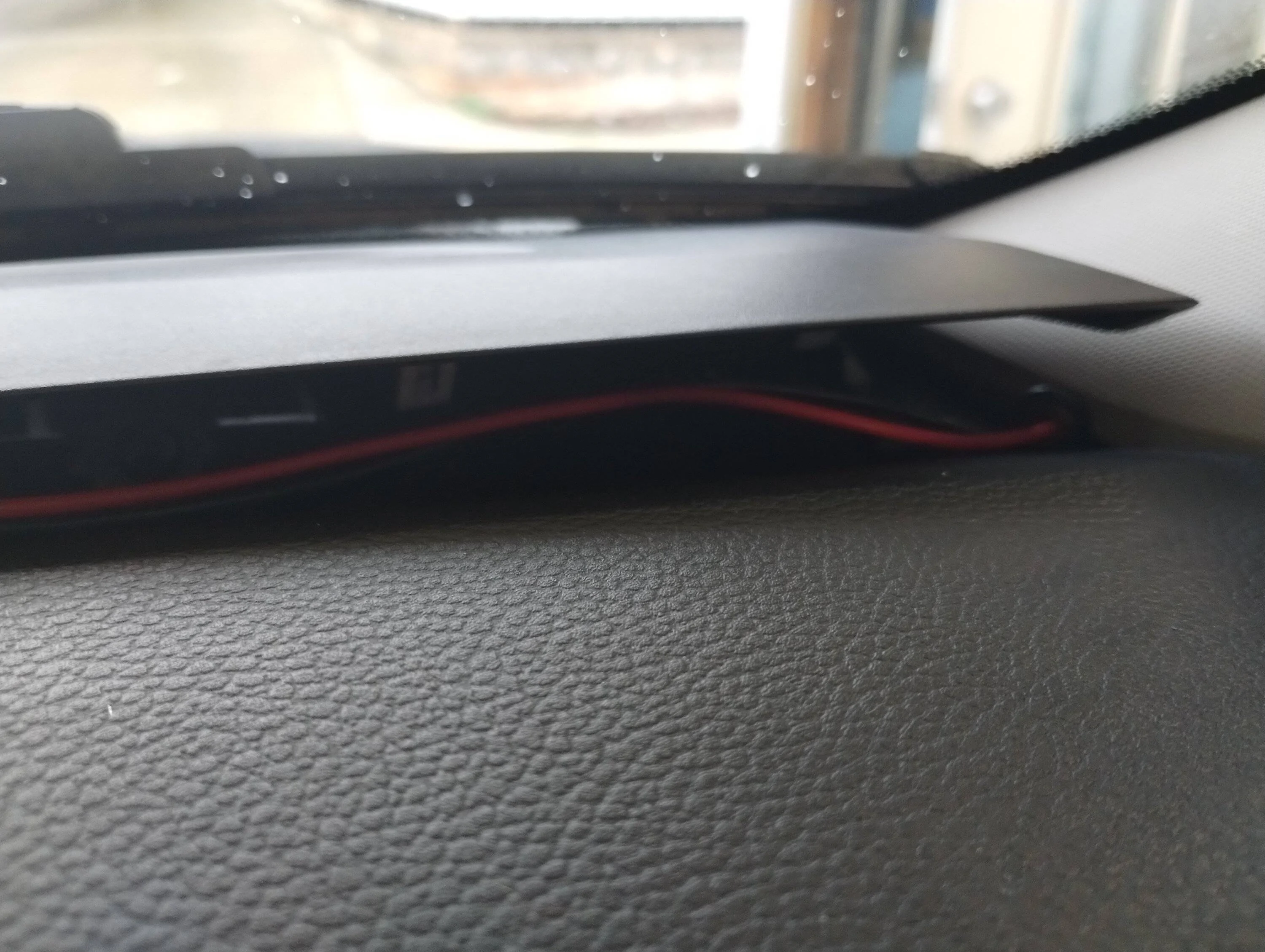

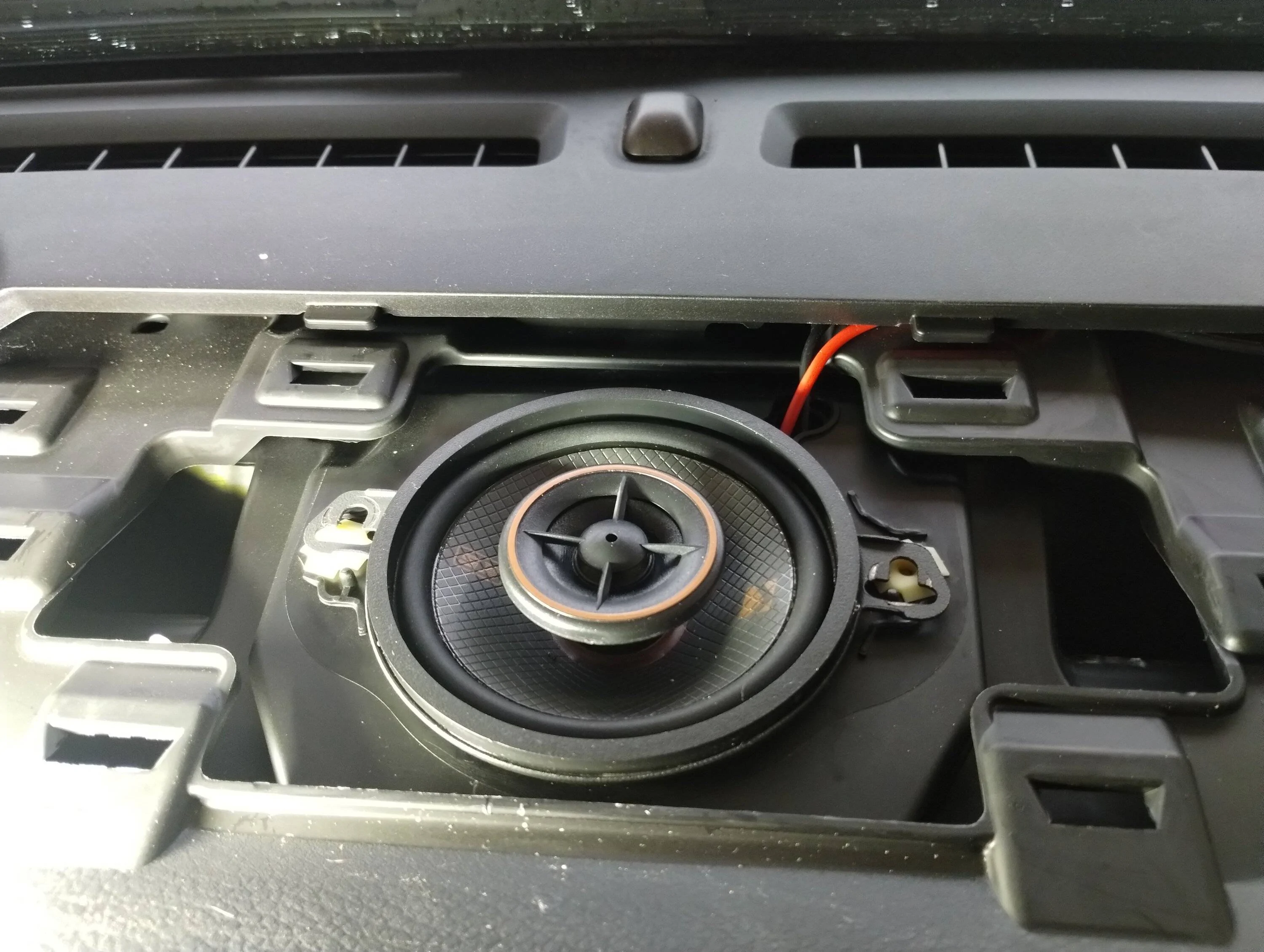

I also installed a Kicker 3.5" (part #47KSC3504) Speaker for the center of the dash, since the XLT didn't have anything here. You can see the red/black wires I installed and started running them under the defroster panel.

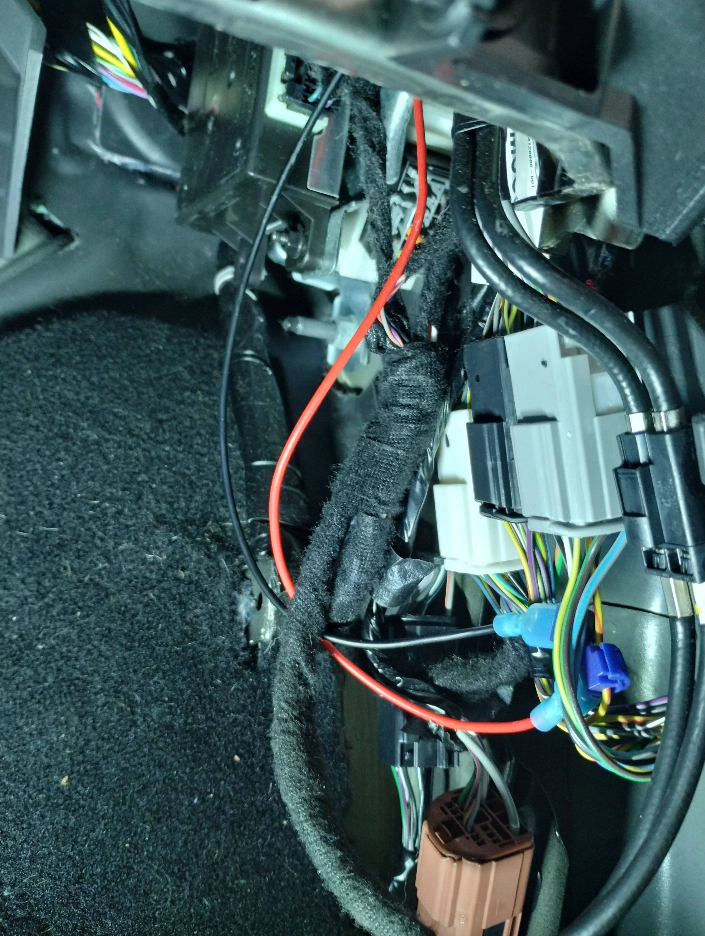

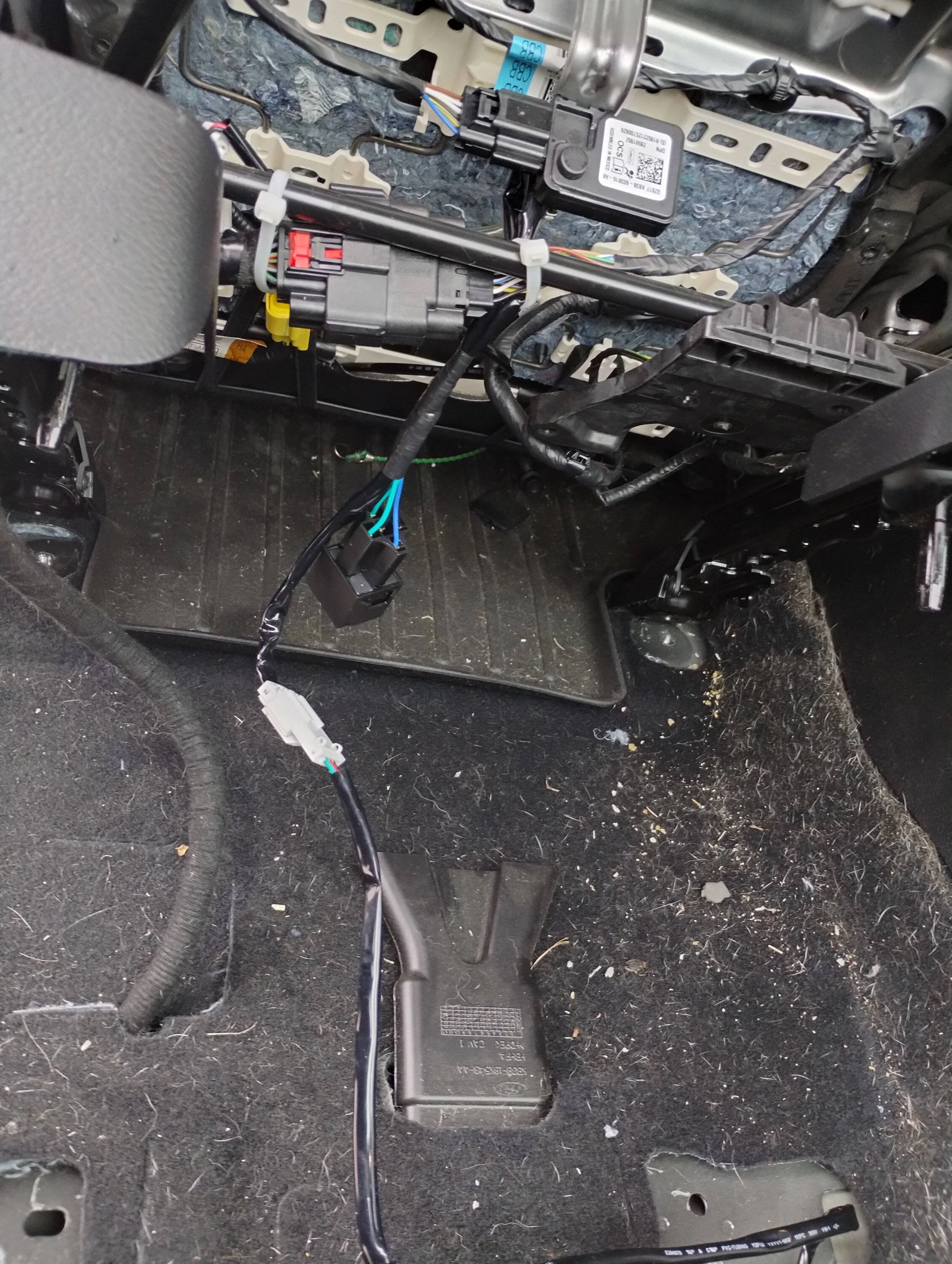

Running new speaker wires along the defroster panel toward the passengers side.
Ran new speaker wires down/behind the glove box and secured them to an existing loom of wire.
I used some vampire taps in the passengers side door speaker wires (Yellow/Orange-Positive, Green/Brown-Negative).

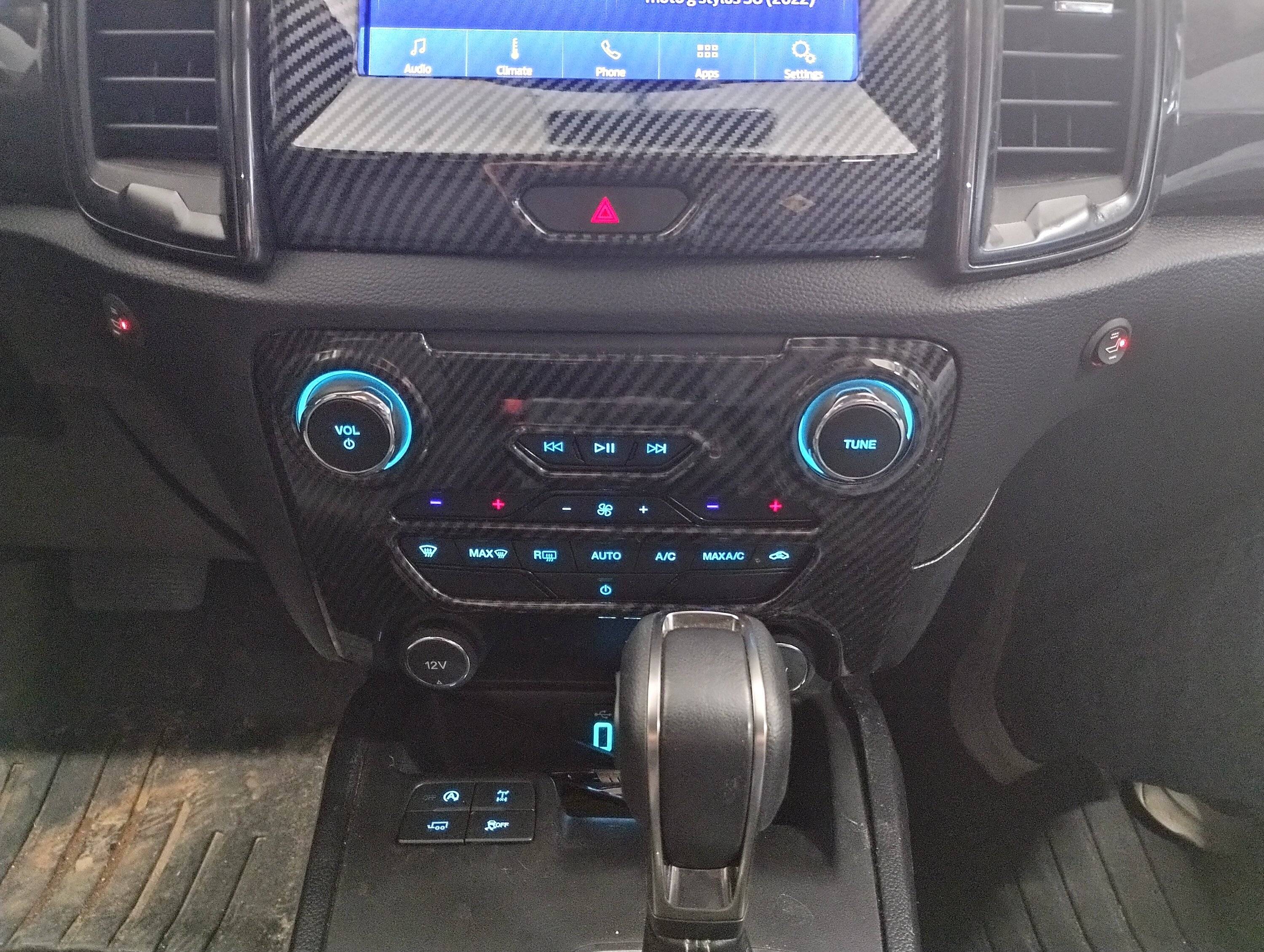

Replaced the solid XLT dash center cover with the Lariat cover. This extra speaker makes a major difference!

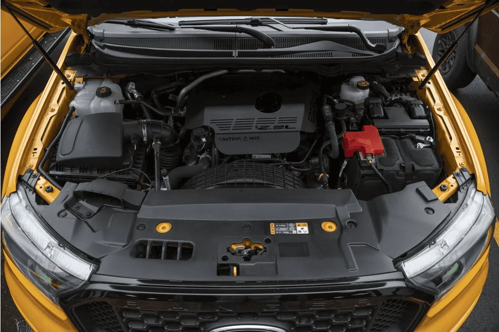

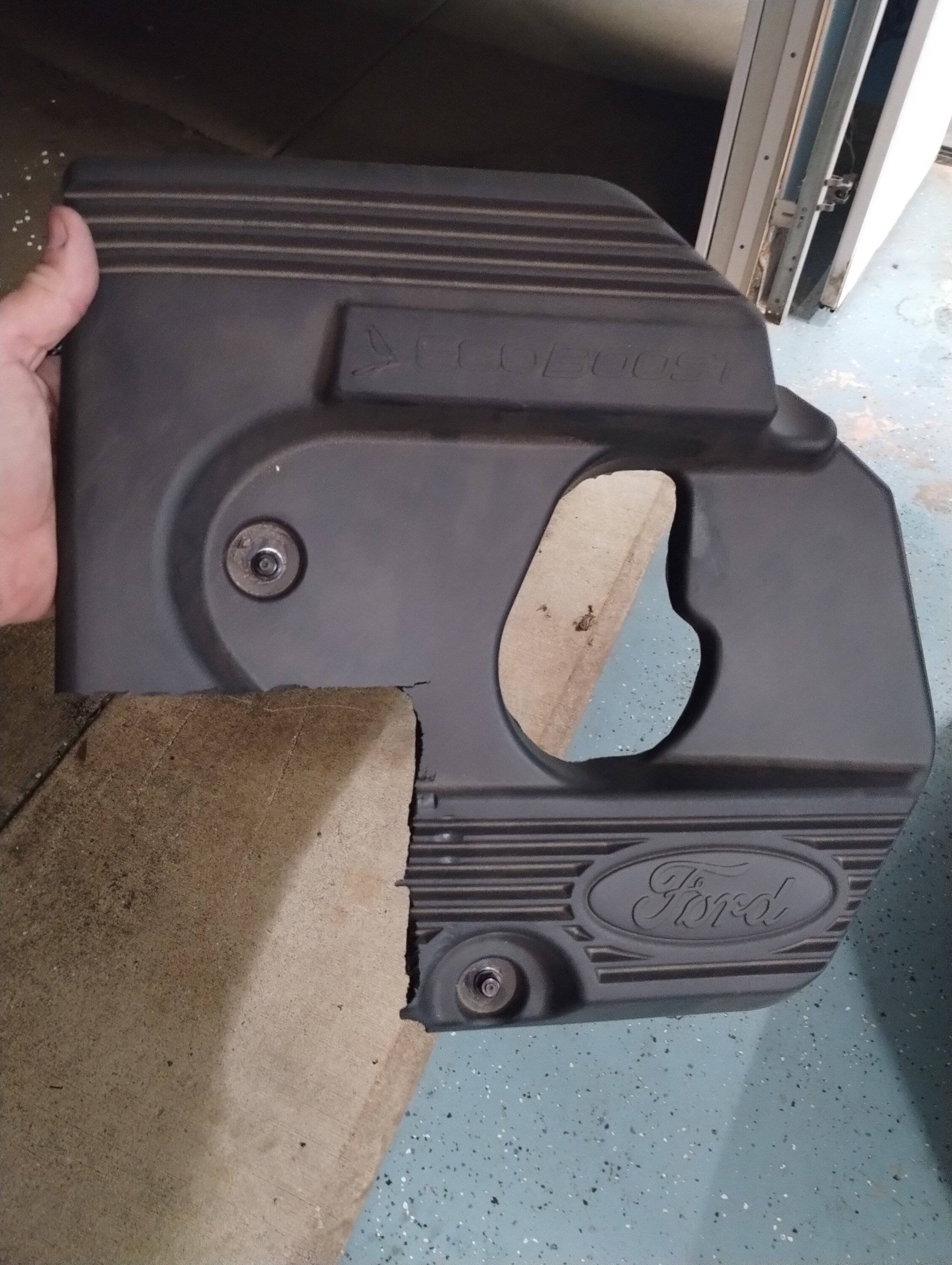

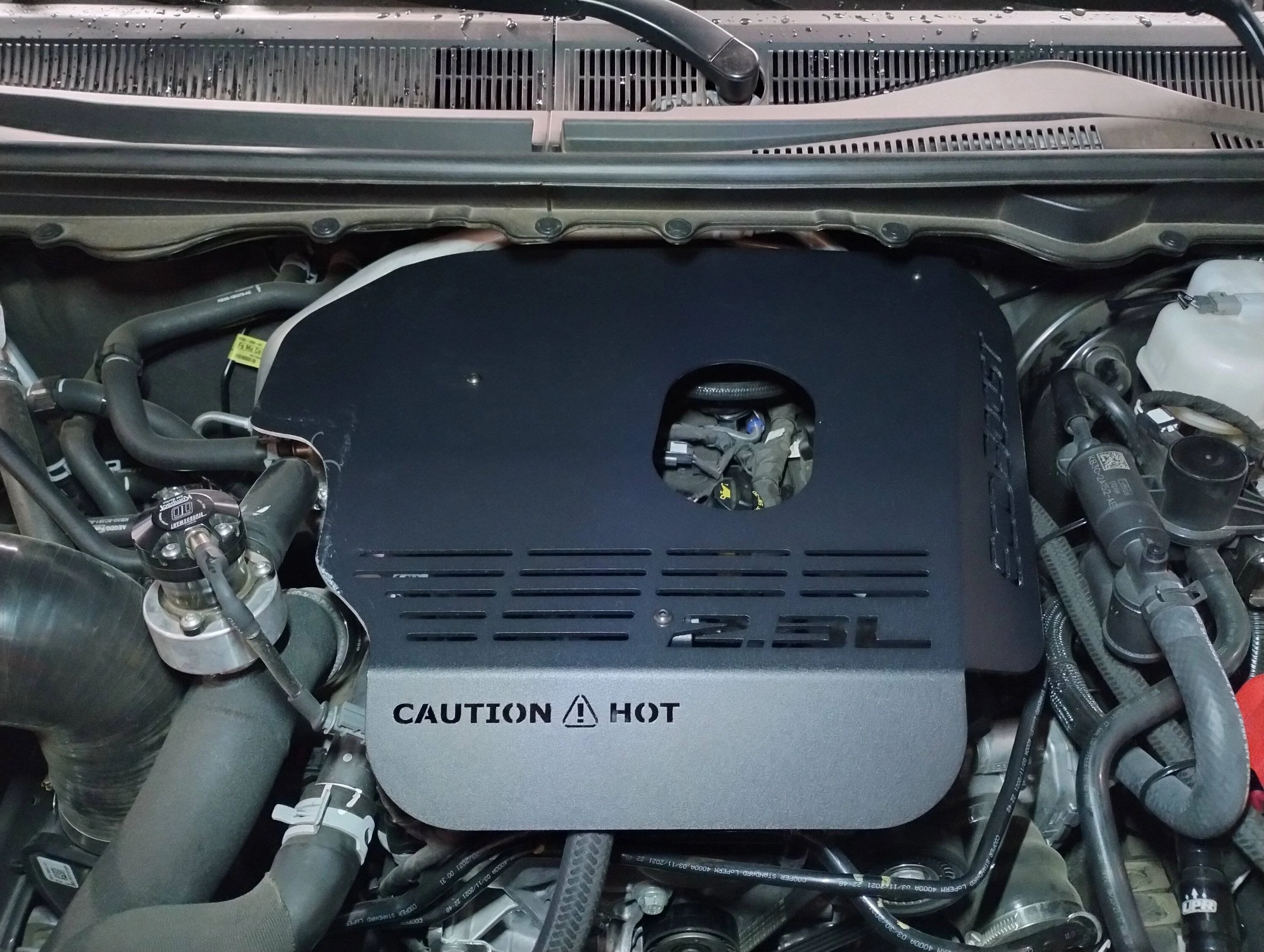

Lastly, this was my OEM Lariat Engine Cover after I had to modify it to fit around my Dual Valve Catch Can piece on the valve cover.
Since the OEM cover has inflated into stupid prices $250+! I found an aftermarket cover and even though the company has shitty reviews, it was $30 off, with free shipping at $170. Customer service is awful and I had my doubts about it fitting correctly and it might, if my engine was stock still... Had to shave a good bit off it, in order for it to fit around the BOV/Hose. They also say it's powdercoated, but in my opinion, it looks like rattle can spray paint. I'll use some wrinkle black paint, when it gets nicer outside.
This is how it looks on a stock engine.
