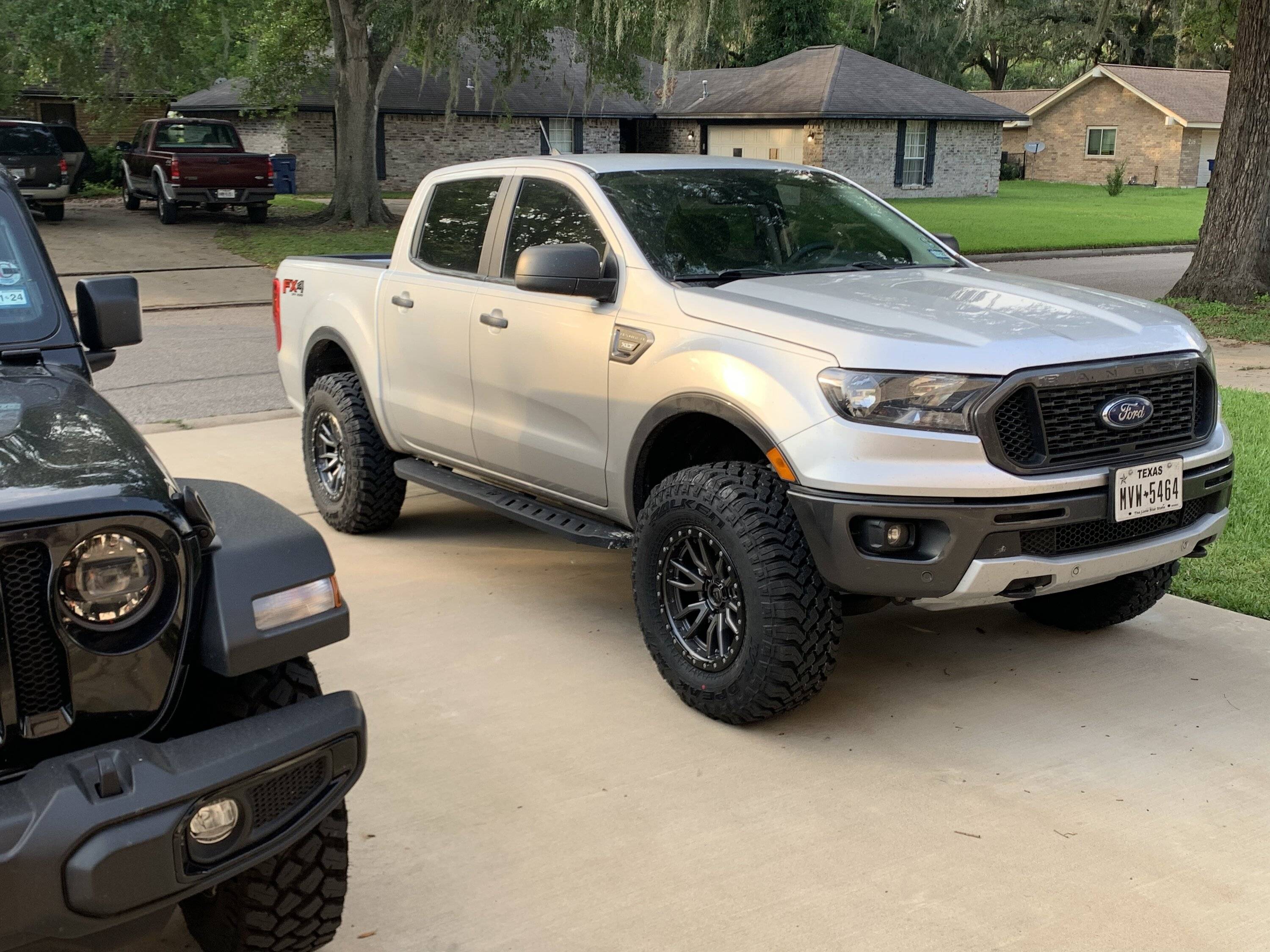

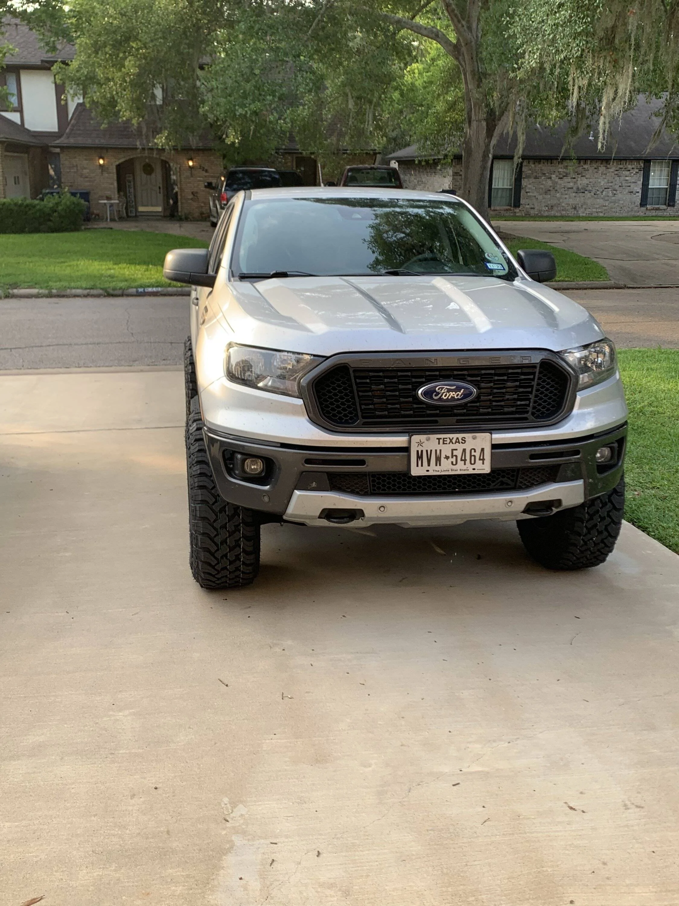

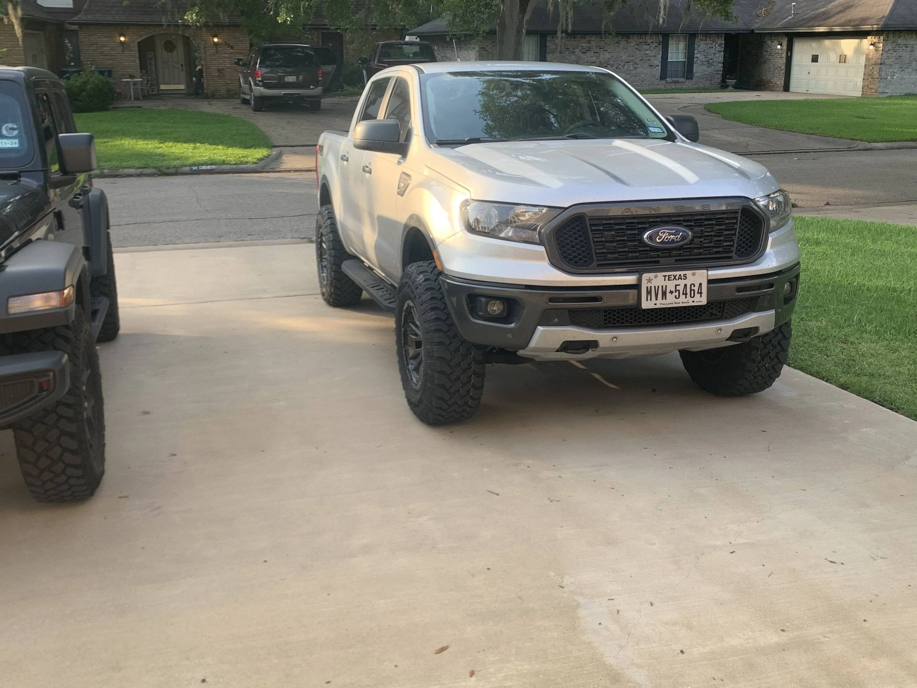

Here is mine with 285/70/17 tires. Wheels are 17x9 with +1 offset and 5” backspacing. Just got it all installed yesterday. Crash bars had to be cut out.
