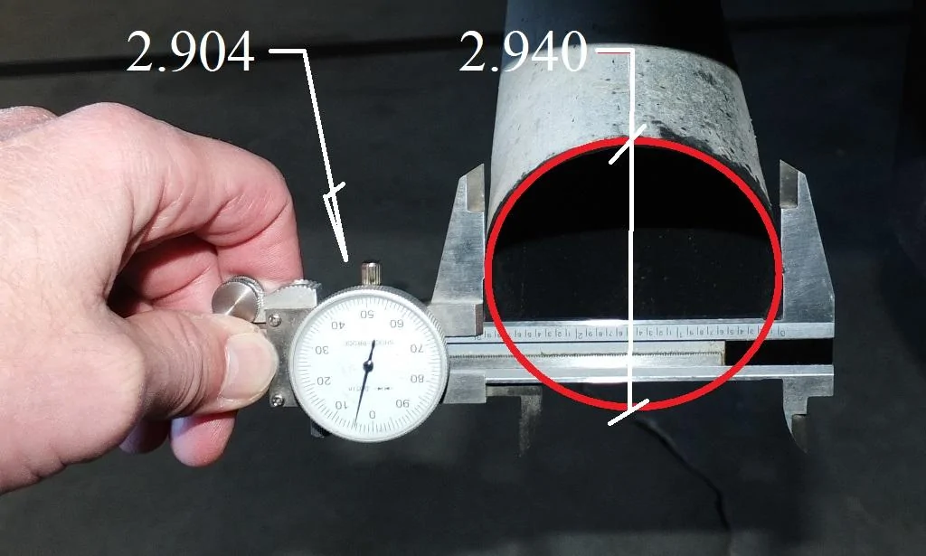

Anyone know what the outside diameter of the tailpipe is ? I know someone else asked about it too. TIA !!
It's about 2-15/16". 2.904 in the horizontal.... 2.940 in the vertical
(I didn't want to get soot on my calipers.. so I didn't use the end of the jaws)
Dang why didn’t I use mine?! And I’m not afraid to get my tools dirty. :facepalm:

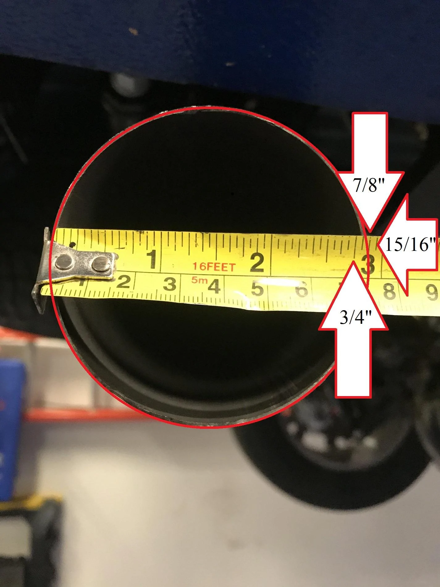

Say What?.... Look again.
The trick with a tape measure is the tip moves a bit, thus, its movement fully extended needs to be included. I read the above as 2 and 3/4" as it is just not aligned. Another useless fact is the groove cut in the tip is to hook on nails.

Meh.. really? Read the tape. It's not 2-3/4. Not sure how to make it any clearer.... I even took the time to supply a diagram and go out and measure it myself with dial calipers.
2-3/4" = 2.750 always has, always will.
Any muffler or exhaust tip that is 3" i.d. will work just fine.

Hello, I was looking for the size of the exhaust diameter to buy a tip. I’m to lazy today to walk out to my driveway. I felt the need to respond on how to properly read a tape measure.
Again, to lazy to write the explaination myself today. According to, This Old House:
The end of a tape measure wiggles on its rivets to make up for the hook's thickness. Push the tip against something for an inside measurement, and the hook is included in the reading; hook it on the end of a piece for an outside measure, and the resulting gap equals the space the hook would take up.
The measurement from the tape measure can be read as it is at the opposite side of the hook. No need to add or subtract anything.
