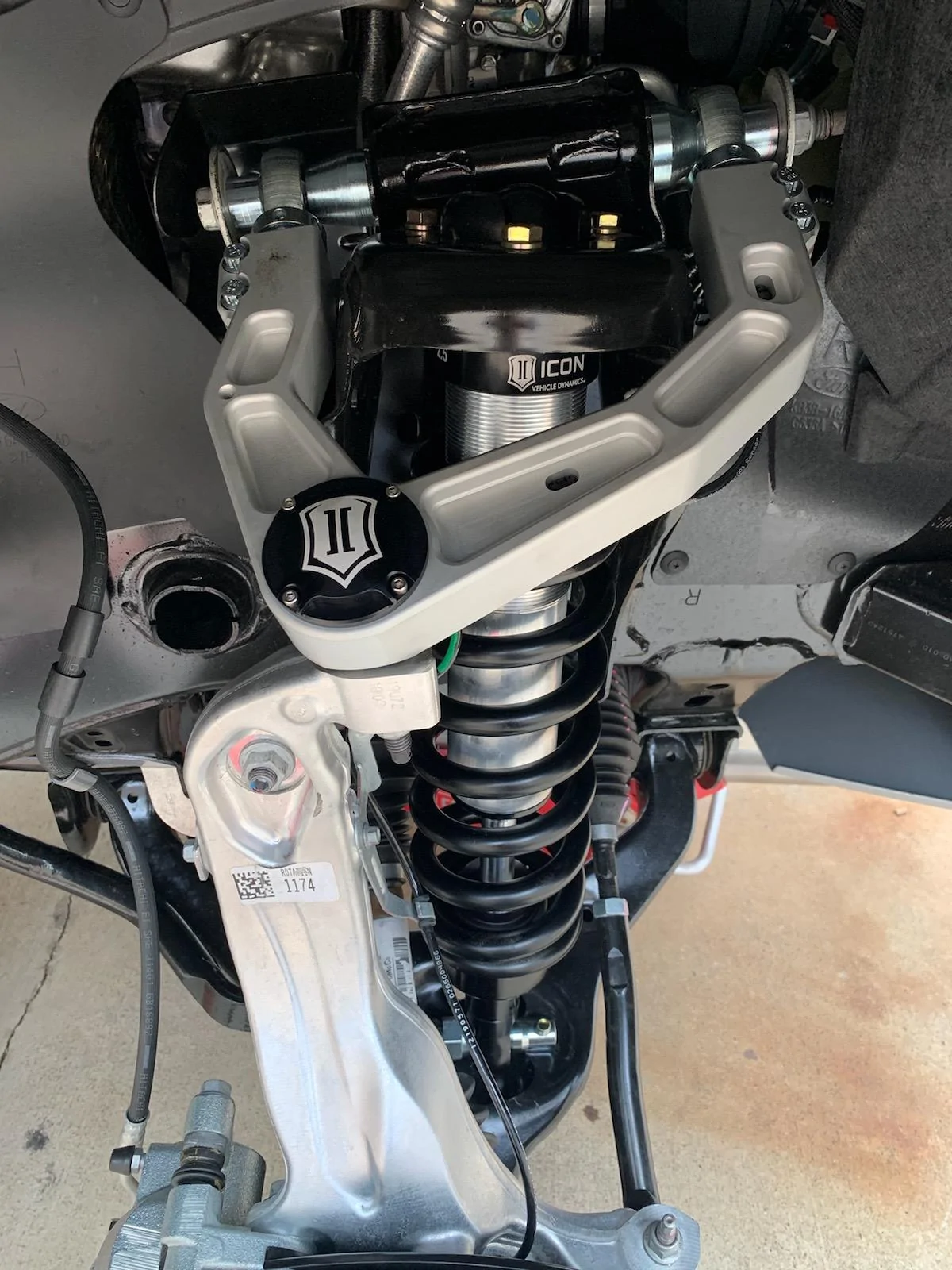

I can’t comment on a full ICON set-up, as I only installed the ICON tubular Upper Control Arms to primarily correct alignment issues after the installing the BDS 2” leveling kit (which consists of disassembling each strut, adding a spacer under the spring, reassembly, then add another thin spacer on top of the strut’s “hat”). The new tubular UCAs from ICON will allow me more downward travel (and a bit more upward travel), but in terms of everyday ride quality, no change at all. Most of all it allows a lot of flexibility for future upgrades as well. I’ve heard nothing but excellent remarks on the ride quality for full ICON suspensions. The only complaint I’ve heard is that the shocks are rebuild-able and need rebuilt more often than average.
Thanks Randy and Mike!
Wanting to hear about how the ICON suspensions changes the truck before dropping multiple 1000s on it.
