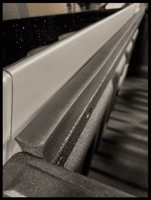

RetraxPRO XR covers used to have a metal rail adapter. Newer production uses a tall dense foam seal held on with 3M tape. Works well.
Contact Retrax. They may sell the seal separately.
Pic from my RetraxPRO XR install.
Yep, that's the ticket. It's got a bit of a funky shape, and there is a similar seal on the cover that mates with the bulkhead seal, and the bulkhead seal is sort of lower on the side toward the cab, so water runs off the cover and not back into the box.
