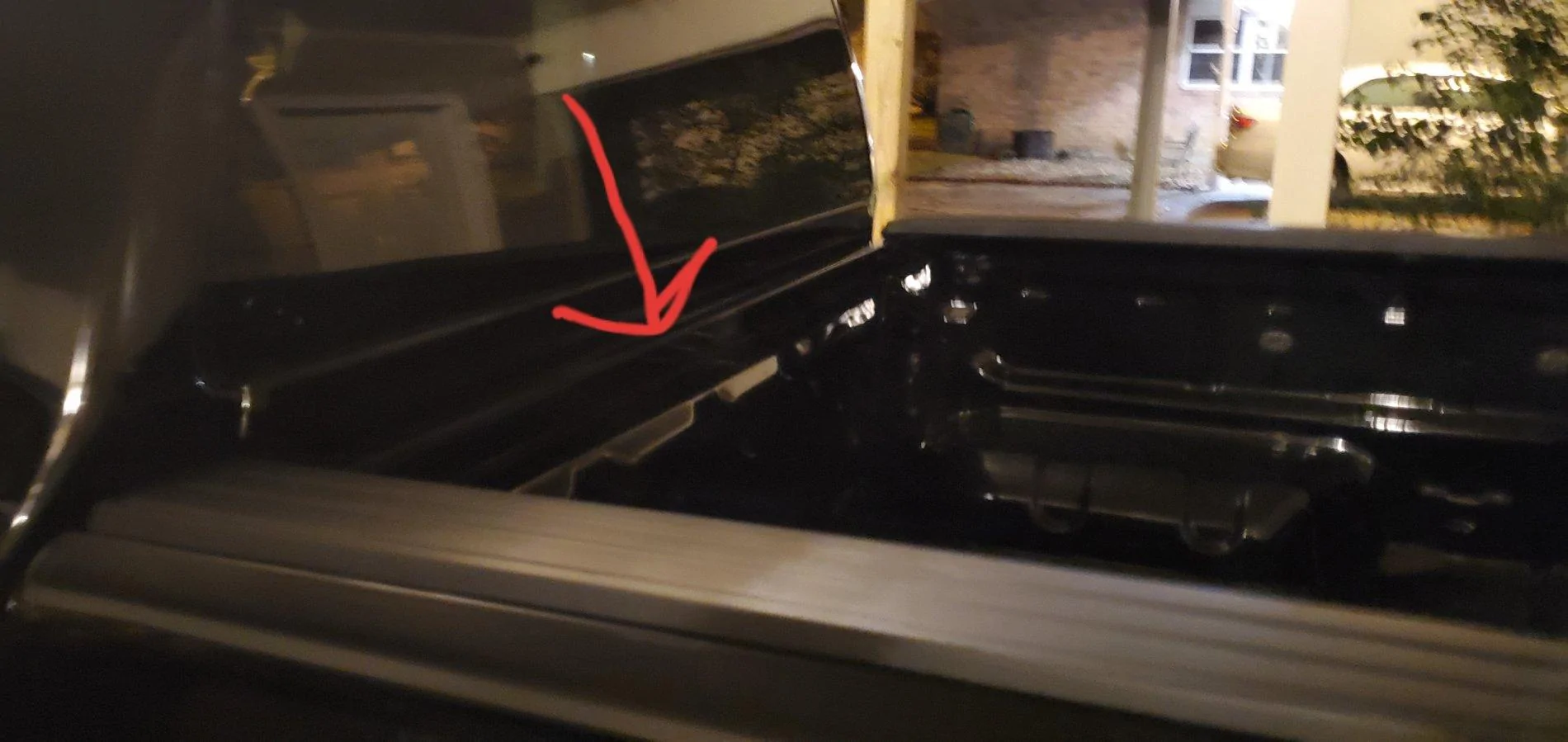

Underneath this rail. The rail closest to the cab. The angle is like 35 to 45 degrees?

It stopped raining so I went outside to get that angle but the bulkhead of my Undercover tonneau covers that area just enough that my angle finder won’t fit in there. Sorry!

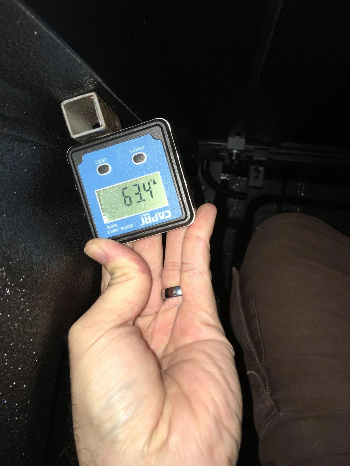

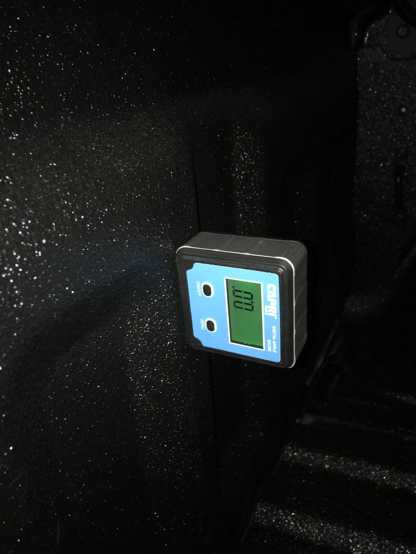

I found a scrap piece of square tubing to space out the angle finder away from the tonneau so hopefully this is the info you’re looking for.
I first zeroed the gauge on one of the ribs of the front of the bed.
This is the angle I believe you’re looking for, the one right below the top of the front of the bed relative to that original rib of the bed.

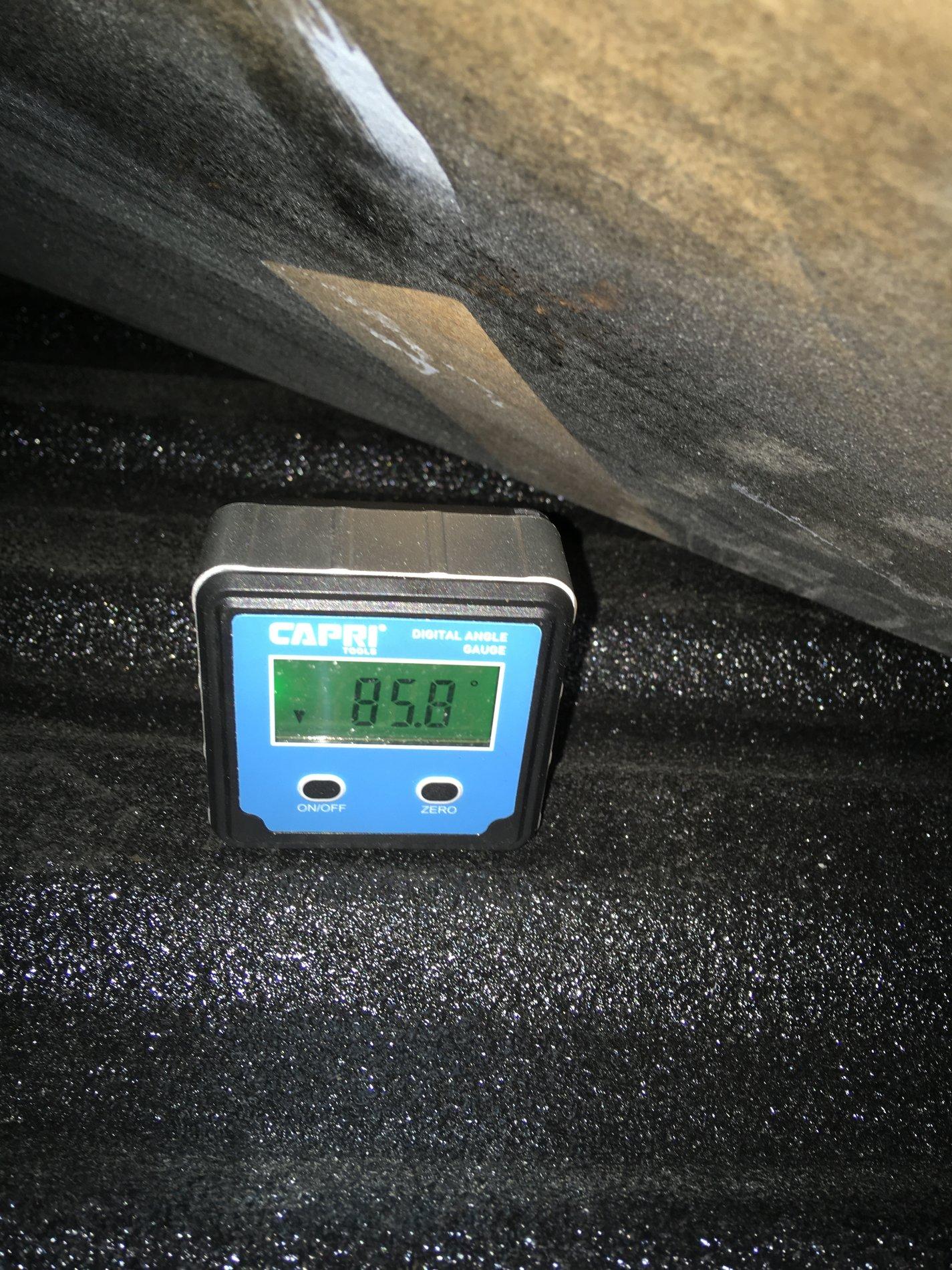

Just because I found it interesting, this is the floor of the bed relative to that original rib... I was surprised that it wasn’t closer to 90 degrees.

63 degrees? Hmm ok. Thanks for being able to get this for me! I really appreciate it, and the work you had to go through to get this!
Also if your truck doesn't have a true level on the front, it will be raked forward. (The reason for the floor not being level I suppose)

It’s definitely 63 degrees as I zeroed the gauge on the front of the bed and the went directly up onto that angle. I didn’t check the bed floor to see if it was level, I was comparing it to the 0 degrees of the front of the bed. Hope that makes sense!

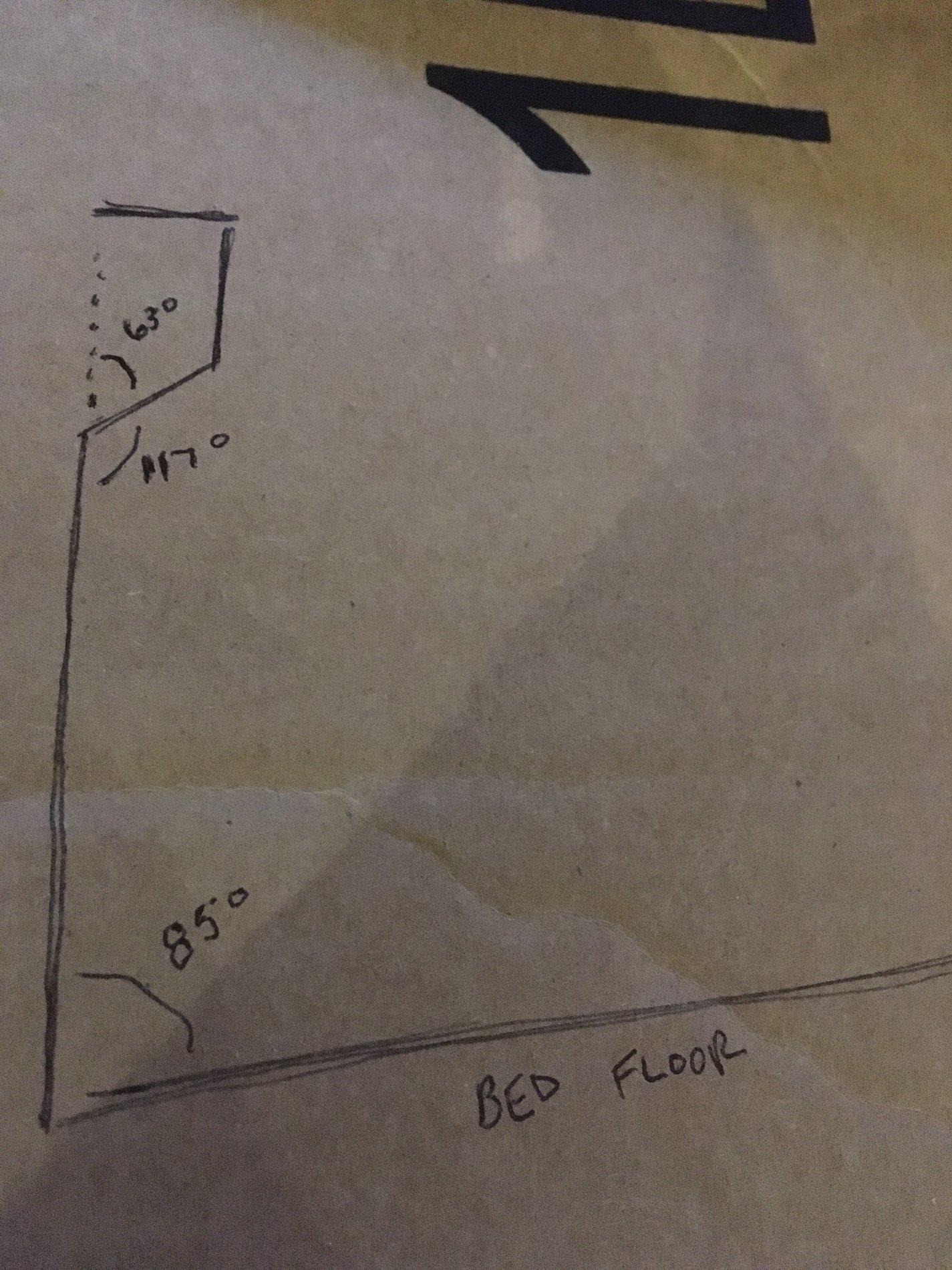

Hopefully this makes more sense, I didn’t realize until later that the pictures weren’t really clear as to where I was measuring!

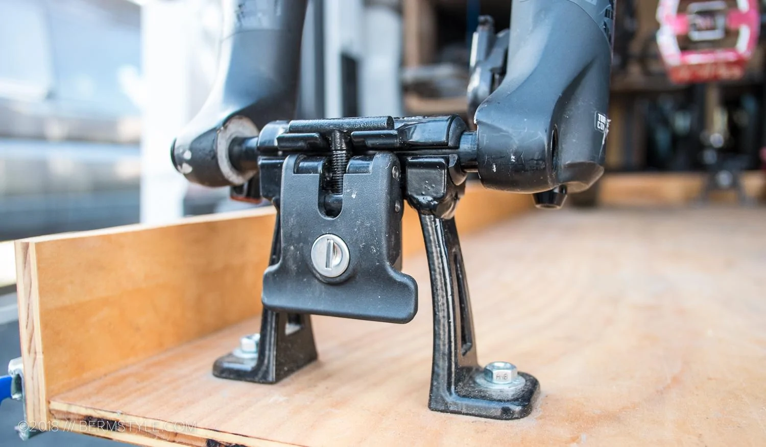

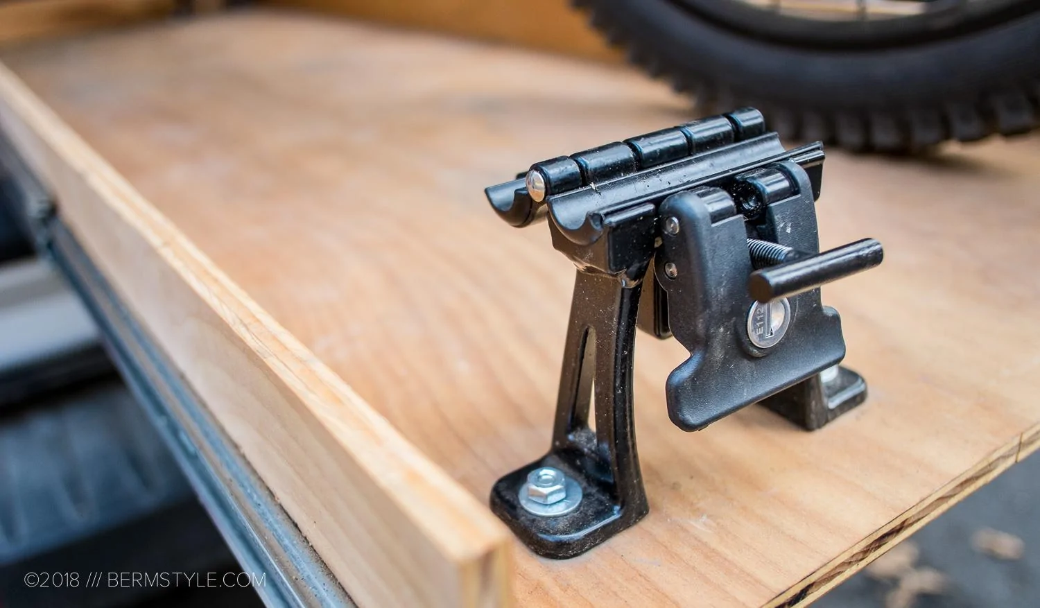

That drawing helps alot! I just don't get why they just didn't square that edge. Thank you very much for this info! My mounts come in Friday, and it will give me time to acquire my materials. I'm using these fork locking MTB mounts...

No problem at all. I like those mounts, they look good and solid. Do they fit different diameters of axles? I still have my old Norco Six One with a 20mm axle and my new Sasquatch has a 15mm. Do they lock on so tight that the axle can’t be turned out?

Yep! Can fit 15mm or 20mm axles, and also 12mm. Different shim inserts(cost extra if not 15mm). Fits both 100mm or 110mm boost too. They are fancy, but $75 each.

Thanks for the info. A little too much for me, I don’t carry my bikes around enough to make it worth the cash. I’ll stick with my hitch mount rack!
