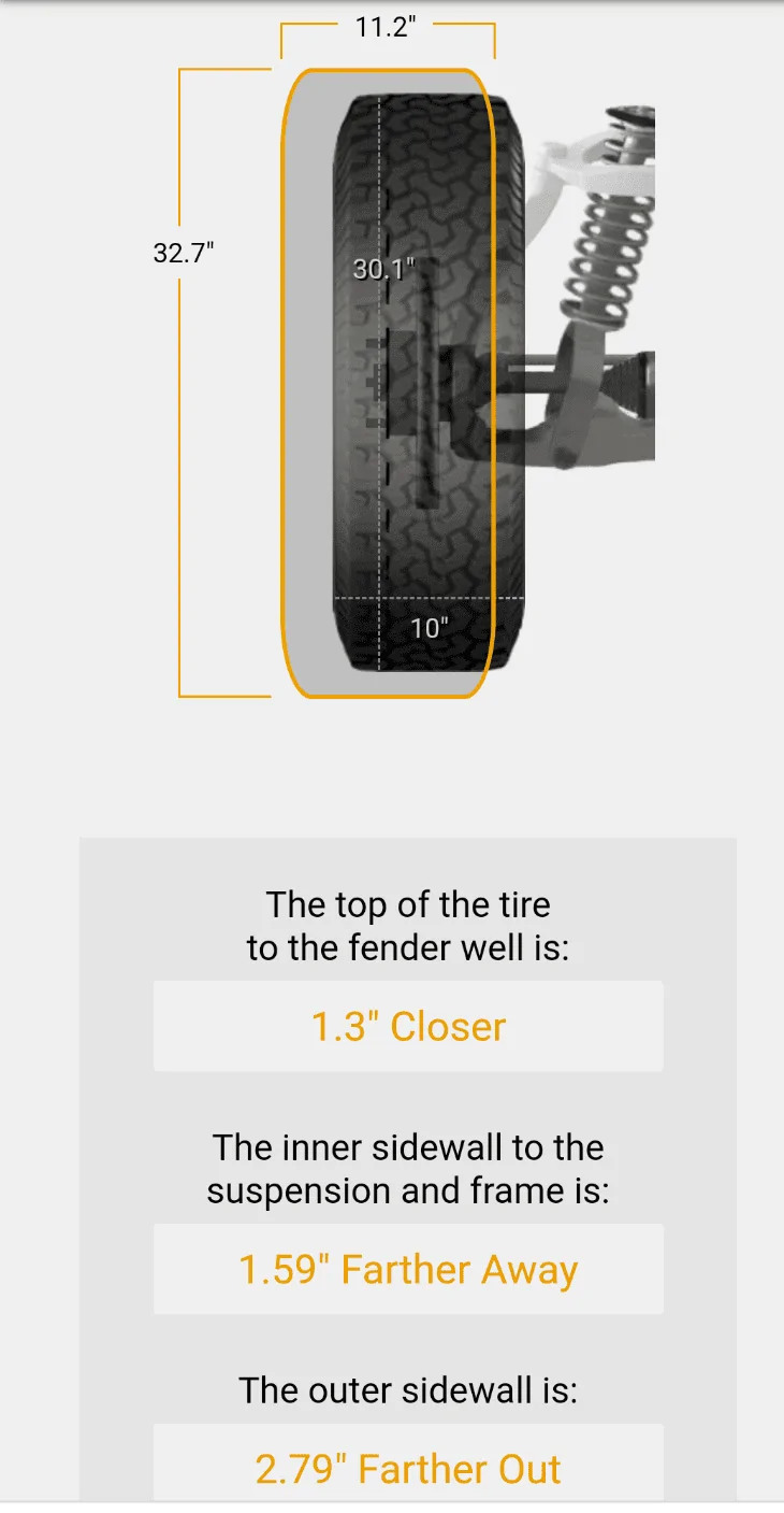

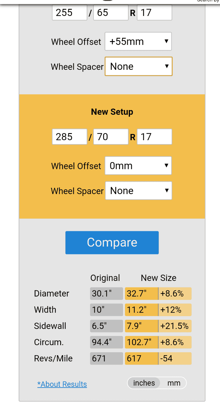

What do I need to do to get these tires more in line with stock offset? Almost 3" further out. Not what I want.

somewhere on here someone has chronicled what it takes to fit a 285 regarding offset. Somewhere. Probably multiple places idk. I had no desire to go that wide so I didn't read into it.
Just going by the numbers listed though, and considering a 265 barely clears the spindle @+55 .. a 1/2" wheel spacer would allow them to fit with stock wheels, and make the new location of the outer sidewall a touch over 1" further out.

That sounds perfect. I think I gotta live with a little poke going wider. Thx
