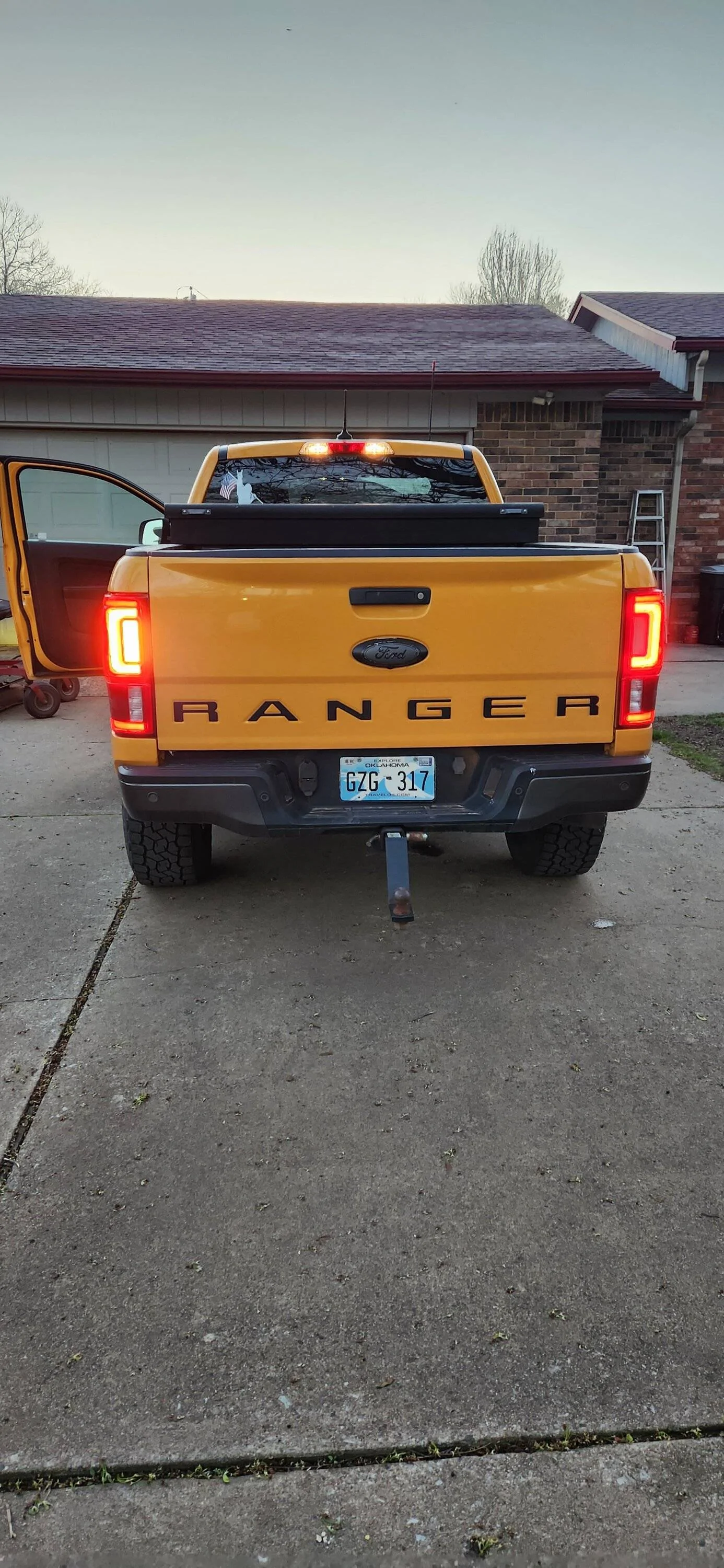

Left signal indicator hyper flashing, checked and found left rear signal light always on. Search didn't turn up anything similar.

Thanks guys, cycled the hazard switch and it seems to be working now. Don't know if it is fixed but it's working now.
