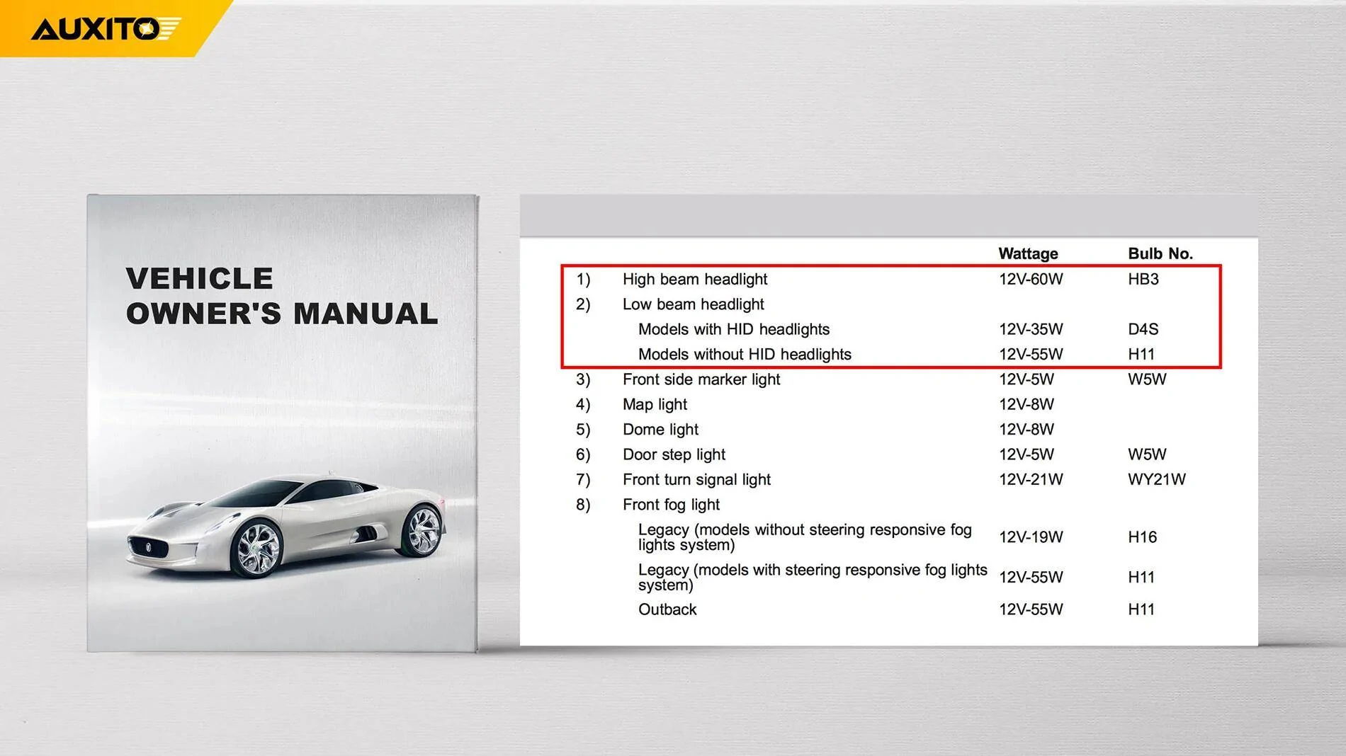

B. Check The Owner's Manual:
  • Refer to your vehicle's owner's manual.
  • Look for information on bulb sizes and specifications.
  • The manual should provide details for each type of light in your vehicle.
  • If information is not found, contact the manufacturer for bulb fitting details.

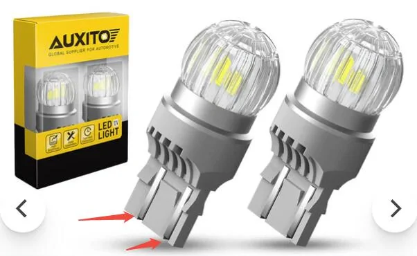

The original halogen bulb for the 21 Ranger front turn signals is the 7443 model, which has two wicks, the thicker wick works when performing the turn signal function, and the thinner wick works when performing the parking light. You'll also notice that it has two pins.
And the 7443 LED bulbs for sale also have two pins for different jobs, so it's the same as the original halogen lamps, except that the illumination shoots light from the led wick. I attached a picture:
Again, I randomly checked other brands of 7443 bulbs, and they are the same.

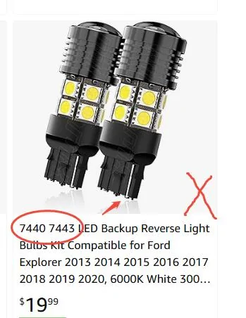

So what bulbs don't apply to your vehicle? I think you might want to keep an eye out for ones that have only one pin but are labeled as a 7443 model number, they only perform one function, which could be turn signals or parking lights.
