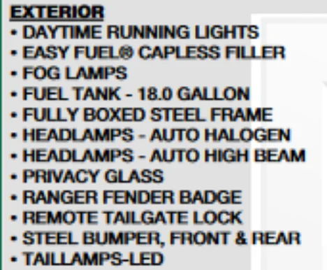

i made the same mistake shortly after i took possession of my truck. didnt think there was any way xlt trim came with ANY led lighting. but there it was all along on my window sticker.
ended up selling them to someone here IIRC.
