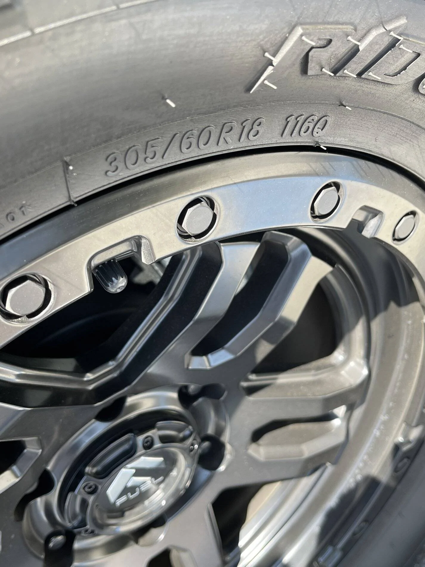

Is that not what normally comes on these? As mentioned new to all this. This was completely stock when I saw it at dealership.
"Stock" doesn't mean the dealer didn't add some mods. At the price you mentioned, it's not Factory stock that's for sure. Bottom line is you bought a brand new truck that has a problem. It should not rub period! Take it back for sure and have them make it right or choose another Ranger.

That’s what’s on the truck now … says 32” ..
however - it’s only when it s a very tight turn or u turn: that’s when the rubbing occurs. Nothing else. Basic turns either direction are perfect.
You Got Screwed By the Dealer....Never...Never...Should even a properly lifted Suspension accept 305/60/18 tires....You are talking a safety Issue Here....Get an Attorney unless they address the issue Immediately....You are also due a refund of approx. $15,000.00...Boy what shit Dealer to pull a trick like That...

Sounds like dealership fu**ed me. Awesome. I was told this was the Roush package … what the AF.
Sorry to say this man, but you screwed yourself when you paid $70k for a Roush truck without knowing what makes up the Roush package. A simple google search would've told you something was off. It's up to you to do the due diligence and understand what makes up such a big purchase.

Hello all … new guy here. New to Fords.. and well, especially Roush and the Ranger Pickups.
Just picked up a brand new 2021 Roush Ranger… but curious if I’m wrong here… when I go to do u-turns or even tight turns (either direction) it feels (and hears) the wheels rub pretty bad. Almost scary sounding especially for a close to $70,000 truck??
I know it being the special edition; it is lifted and has the Fox Suspension but is this just normal based on wheel rub coming from stock dealership?
Any help greatly appreciated.. and if you need more info from me, I’d be happy to tell anything else I can!
Thanks for the help everyone and happy to be here with you all.

I'm a Ford Roush Performance Dealer in Canada and I can tell you right away that the Fuel Rim is not included in the Rosch Package. I'd be curious to see your bill of sale and see what items were on it. Reach out to me if you need help with that.

Most likely crash bars are rubbing the tires. Could be more though, how much lift is there? Past 3” is another potential issue with UCA joints or CV’s bind.
That's where I was going myself. Rick is good, Rick is wise.
