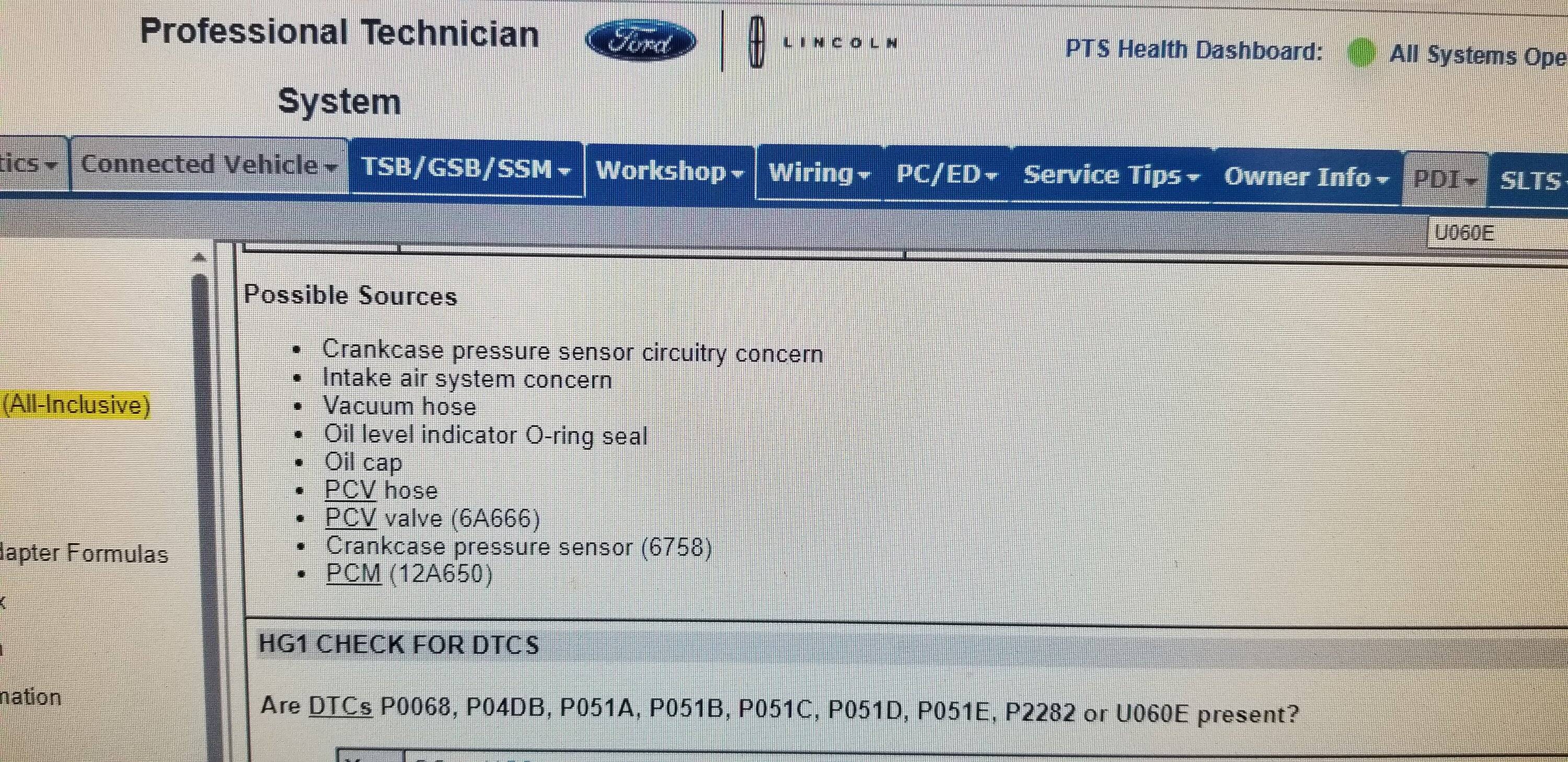

I have no idea what U060E is and neither does Google apparently. I cleared it once with my Procal and then it came back the next day. Cleared once more and it hasn’t came back. Any idea what U codes are?

U060E - ties to PVC system or intake duct leak - (air filter/ tubing)

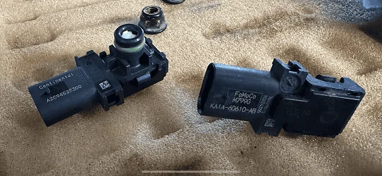

Yep so I kept clearing the DTC and it would come back pretty quick. Checked all connections and reconnected the crank case pressure sensor on the PCV line multiple times. It kept retriggering a CEL/MIL. Apparently it's a fragile little guy and didn't like being transplanted to the new FP PCV line. Swapped in a new crank case pressure sensor and voila, no more DTC. Interestingly Ford Pass never reported it. The sensor is dirt cheap on ebay, looks like Ford uses it as an intake pressure or MAP sensor on other models.
