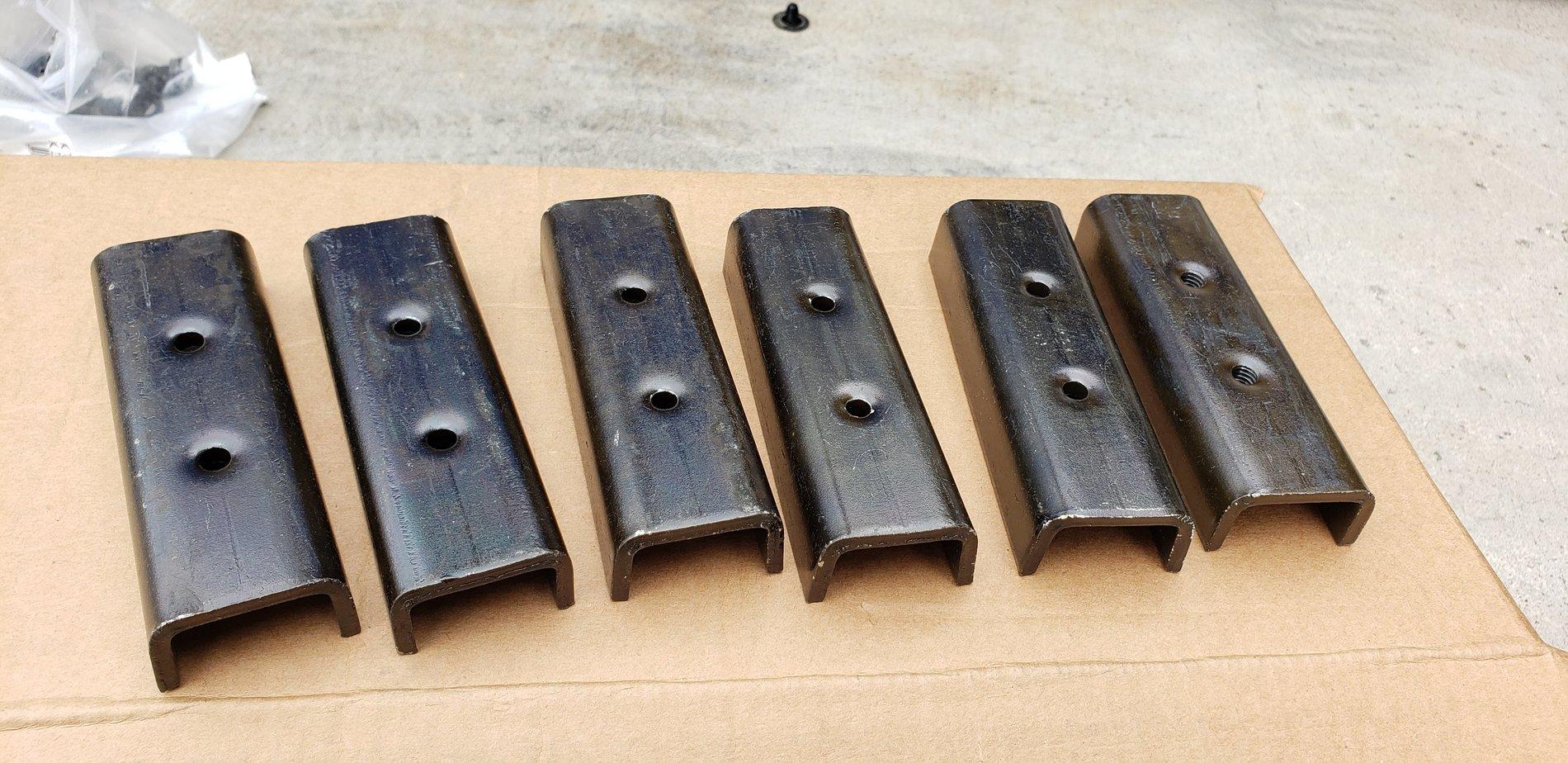

The brackets that come with the Gohinos are made specifically to attach to them. I am certain the factory ones are not. They are easy to install. Only six bolts per side for the brackets and six bolts per side to attach the boards to the brackets.

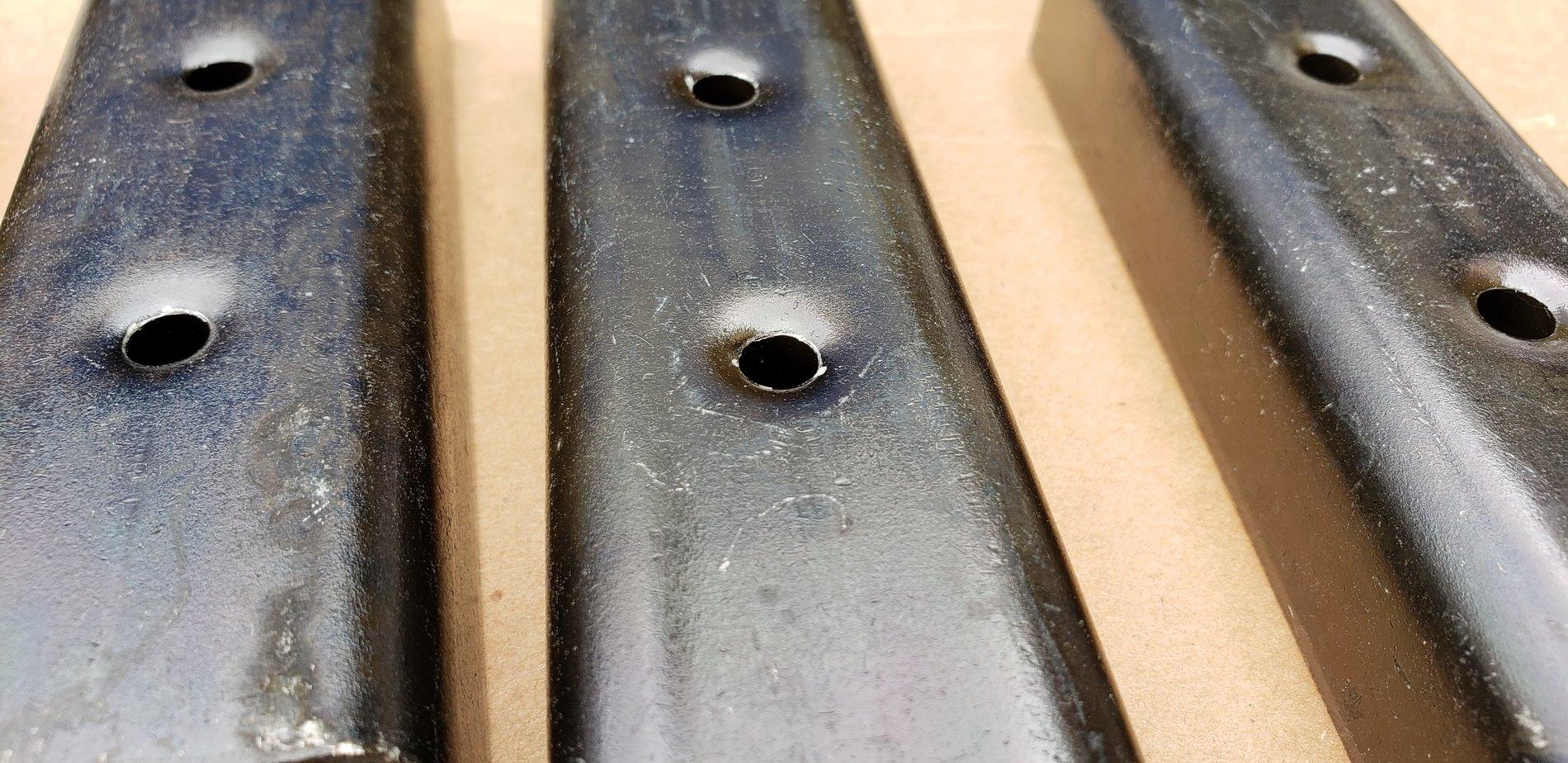

Just received mine, RB20 textured powder coat. Went to install, almost got to finishing the passenger side and discovered that the U-brackets weren't threaded. Called support and sent an email to the warranty department, hopefully they can send a new set out soon. Its such a tease though because it looks sweet. Hopefully you guys don't have any issues with your orders.

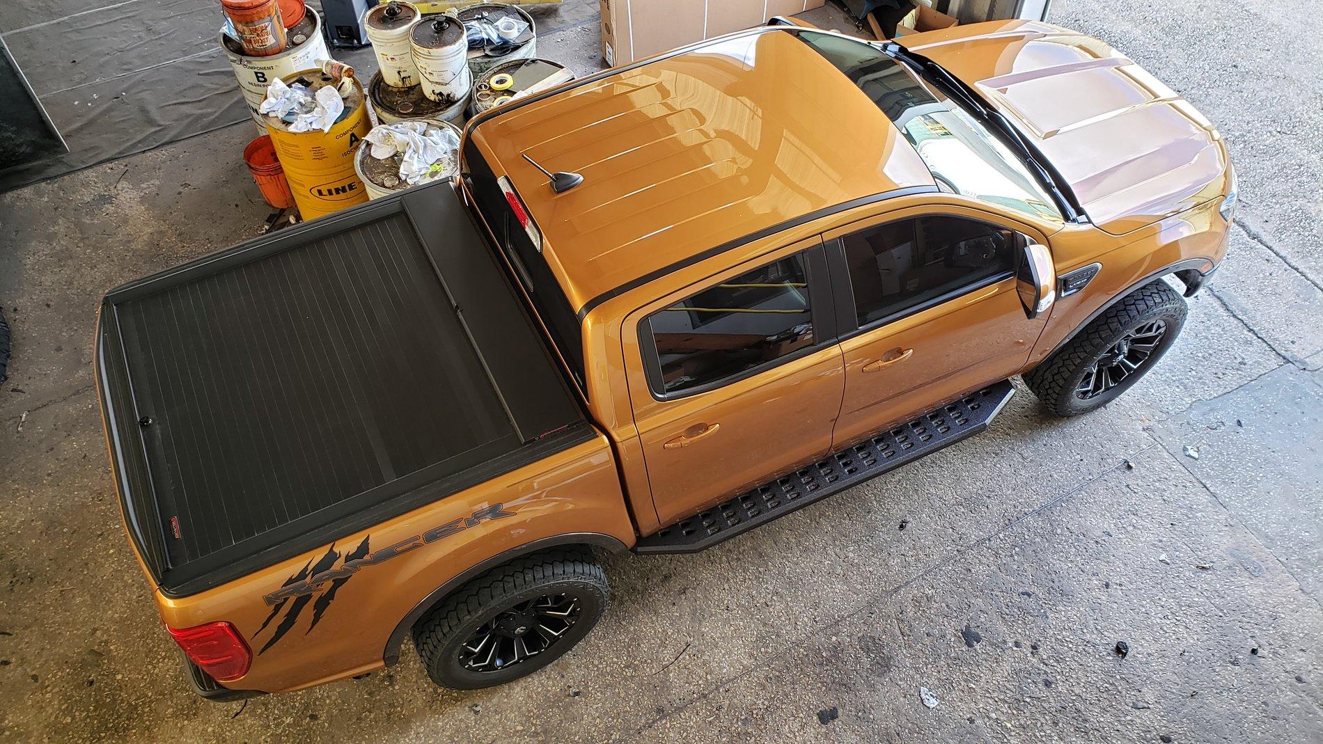

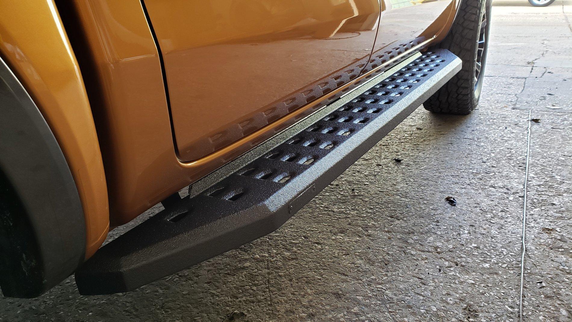

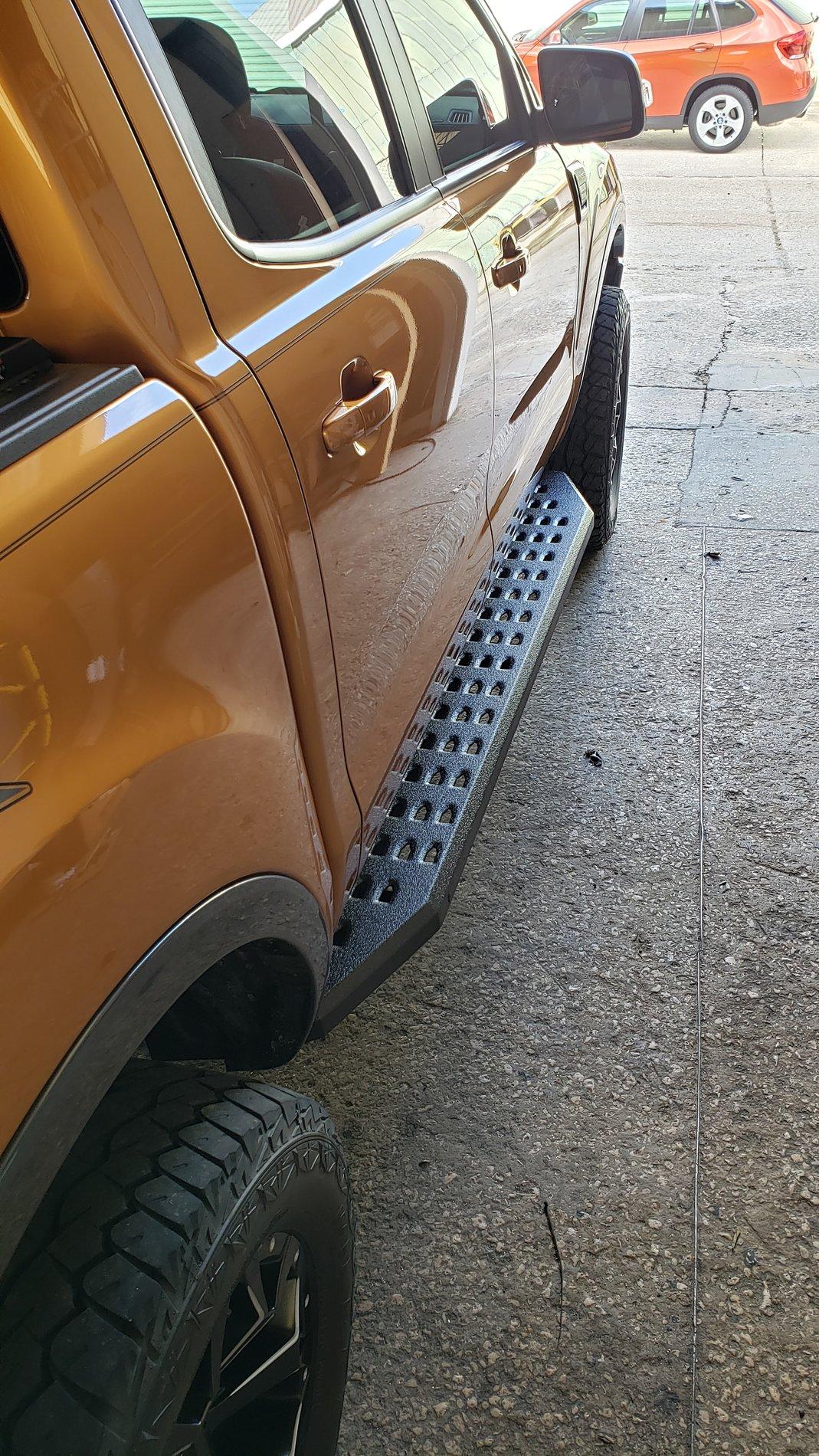

The liner coated ones are black as well. My lighting is hot but they’re darker than the dark gray body for sure.
Installation was pretty easy. I took a by over an hour with a friend’s help only because i was picky on alignment. Can be done solo.
Basically go under the truck (no jack necessary).Pop off the rubber caps on the pre-drilled slots.
Attach 3 brackets.
Place on brackets and bolt on the step.
Repeat on the other side.
Love the look and functionality. They’re a firm & grippy step to help get in/out of.
I also really appreciate that theyre not the lowest point in the truck, so it doesn’t change the bottom-out clearance. (See the underside photos)

The brackets don't need to be threaded. IIRC the bolts go straight through and are secured with a nut and locking washer
