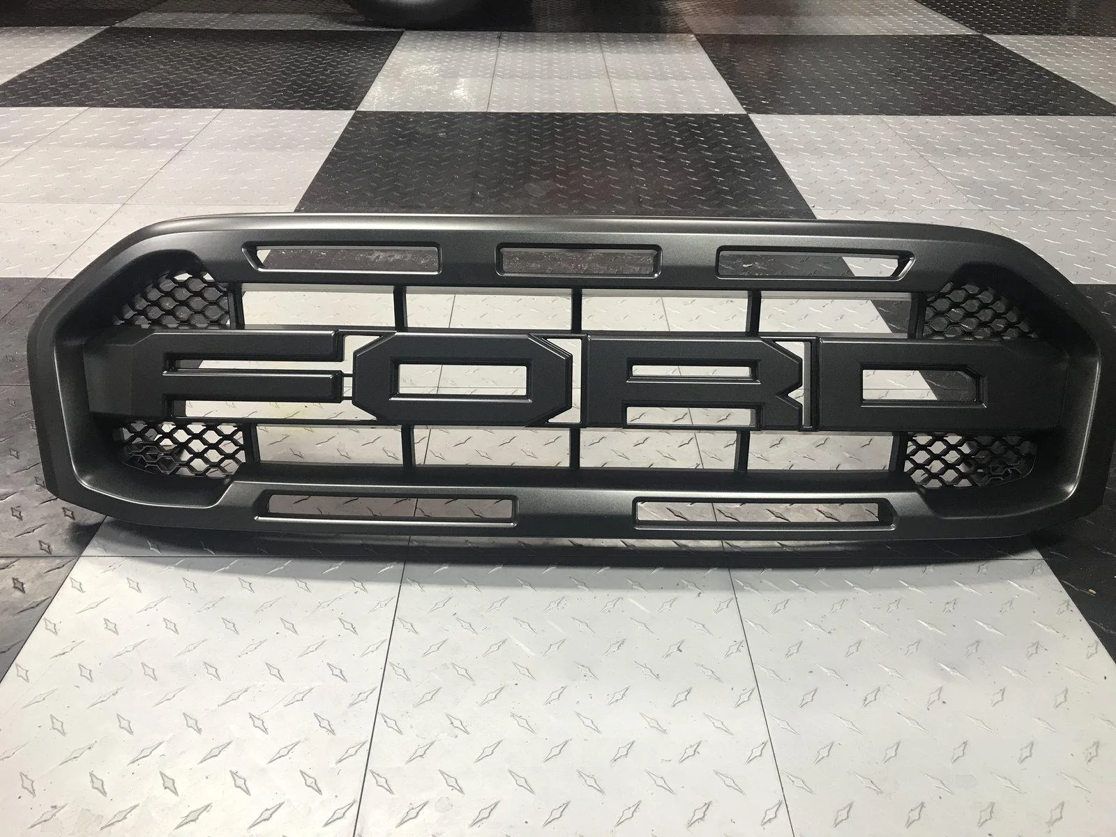

It’s here. Now if the truck will just make it here. Keep your fingers crossed for proper fitament
Is it possible to order the factory ranger grill and compare??? Not sure which would get to you faster grille or truck!

this is a Ford Factory Grille, just not from the USA, Thailand…..

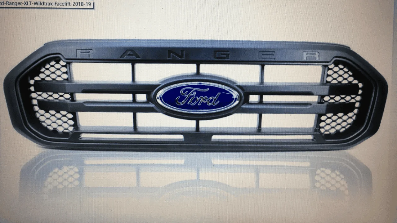

Oh I meant the factory USA standard ranger grille and than comparing it to the Thailand raptor grille.

So, this happened. Hardest thing was getting the old one out, bottom clips are a mofo. The fitiment isn’t exact, but close. Had to trim a wee bit off the bottom corners. The mounting points at the bottom are not the same but will work with some patience. With a little more time I will get it perfect.

NICE! Any pics of it straight on? Curious if there's any gap between the grill and bumper.
EDIT: Looks like we'll need a new source for these if they're not too hard to install - the ebay link has dried up.

I will say that this grill is much better built than our U.S. version.
