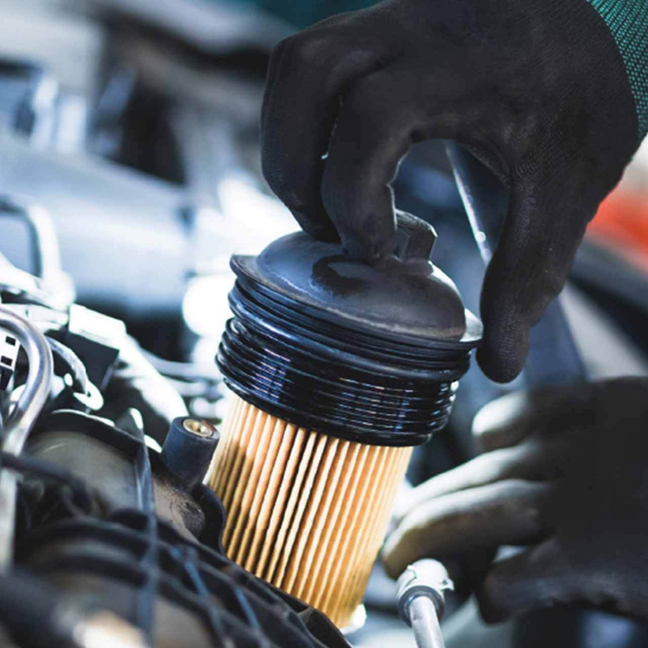

Yes I normally also fill my oil filters too where I can, unfortunately the filter on the diesel is a paper cartridge in a plastic holder which screws on sideways in a similar position to the ecoboost engine so unfortunately no way to fill it first.

I still prefill the filter to a large degree on my 2020 Ranger. The filter will soak it up enough to stop the engine rattle on start up. Just keep filling a little at a time watching it absorb. At the first sign of pooling let the filter sit upright and it will soak the puddle up. Then install the filter with no drips. It might take a few times to get the feel for what is too much, but this method works for me.
Yep this is the technique I use when doing my son's Hyundai V6, which goes on sideways but that's a traditional metal can filter, which tends to keep any excess inside because of the anti backflow valve. Whether it makes a difference or not ???? But it certainly makes the oil pressure pick up faster on the first start and minimizes lifter rattle.
The one on my diesel unfortunately is just a paper filter inside an open ended plastic can.

Does that go in from the top? If so, can you partially fill the filter bowl and then insert the filter? If not, there's no getting around that.
No sadly it's just the camera angle, it goes in sideways through the wheel arch under the flap just like on the Ecoboost engines. You need an extension bar on the socket wrench to reach it.
