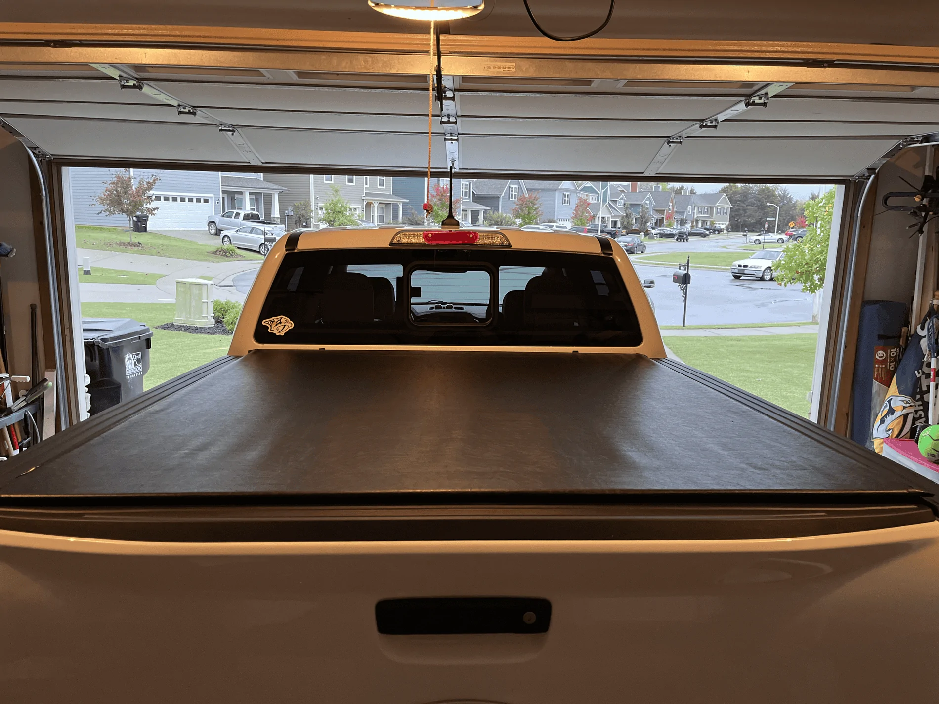

Installed the gator roll up tonneau with the clips that attach to the bed rail lip. This is a terrible way to attach this and I hope the company changes the way this attaches. The ranger bed barely has any metal to attach the clamp to, less than 1/4". I struggled for about 2 hours and the rails fell into the bed twice. I wound up finally moving them to a few different locations as the manufacturing process of the bed isn't exact and had to find spots with a hair more metal. Anyone buying this style cover should look for something else. I'm just waiting for this to fall into the bed or blow off on the highway. The Gator also came with 4 different bags with directions for different things, one being foam blocks and a front bed rail foam piece. The ranger photos provided of where to put the blocks look nothing like the 6 foot ranger bed. The channel in the pic doesn't exist and the only area up front to put them is too small. Giving this another weekend of use to see if it holds otherwise it's going back or credit card benefit time. Pretty surprised on this product as the quality of all the component is decent, just terrible implementation. The rails also sag in the middle so the whole thing sits lower in the middle. Can be seen on the edge of the cover.

Can you loosen the back clamps and lower that side rail and re-tighten...looks a bit high in the back?

Nope, the center sags even lower. Water will run right in. It's overall a poor fitment. Just looked at the Truxedo lo pro you tube video on the F150. The clamps look much larger and that bed lip is much bigger.

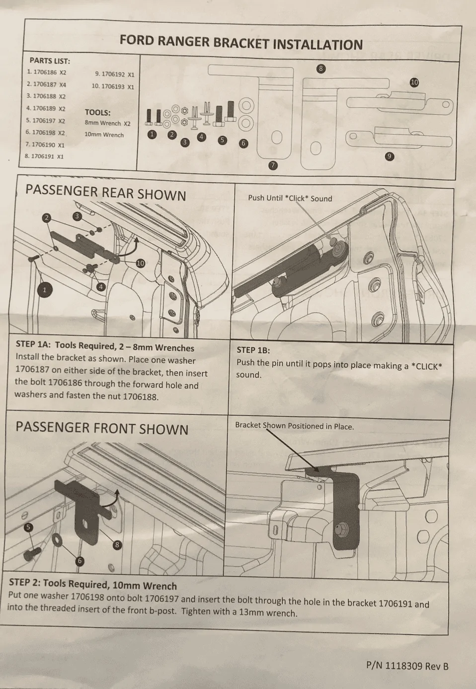

Did yours come with a bag of brackets specifically for the Ford Ranger? If so how in the world did you mount those back brackets?
How in the heck did the rear brackets get mounted, if at all? I believe I can mount the front brackets but the back brackets, I just don't see a spot for them.
I got the cover and the side rails on with no issues with these brackets that I guess were supposed to be support for the side rails or stumping me with their rear bracket installation.
Here's a pic of the bracket installation. Mine is the gator SRX cover.

I have the Truxedo and installed mine without those extra brackets...couldn't figure out their orientation due to poor instructions. Clamped the rails directly to bed rails...
BUT...after re-looking at the instructions, the brackets will fit the Ranger. If you look at the very rear of the bed rail, just underneath where it curves over, you'll see a hole and a slot punched into the metal support.
I believe those brackets are to be fastened to those mounting points...holes in the brackets match up with the bed rail holes. I haven't checked the front bed corners but willing to bet there are matching attachment points for the front included brackets.
I think those brackets are used to give the clamps something to support them rather than using just the Ranger's bed rail edge. On the rear brackets the push pins supplied go into the hole which is "blind" while the front bracket hole matches up with the "slot" so you can use the nut/bolt supplied.
Don't have the time in next day or two, but I am going to strip mine off and re attach using the xtra brackets. I think they might help in securing the cover a lot better.
Didn't realize how back brackets attached until I read/re-read Nicks post and pics and it hit me.

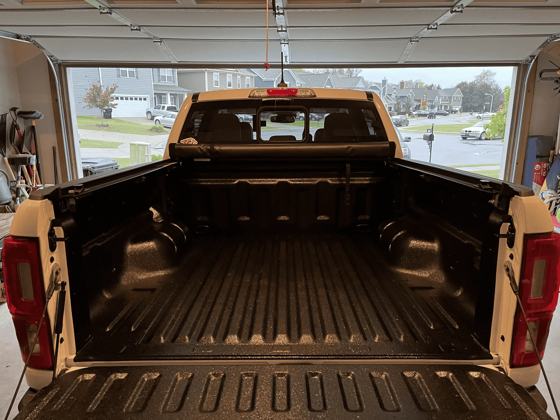

And if you have a spray-in liner, then the mounting holes are probably filled with wonderful Line-X and will need tapped out. They do fit. And they help with fitment of this cheap cover.

Friday - Spray in Linex
Saturday - Installed Gator SRX Rollup Cover, used all brackets included. I ran all the bolts in before mounting the brackets to clear out linex and had no problems
