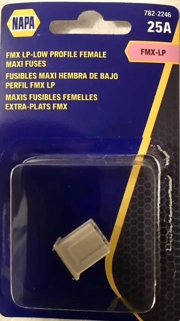

Thank you Daniel for posting the video.
It made the change much easier for sure.
I am attaching a picture of the fuse # 71. The local parts store could not tell me which fuse type it was. From the Ford manual, I knew it was a square type rated @ 25 A. So I picked the only 25 A they had. It cost under $6
Luckily it was the proper size.
Keeping the lights on. :)
