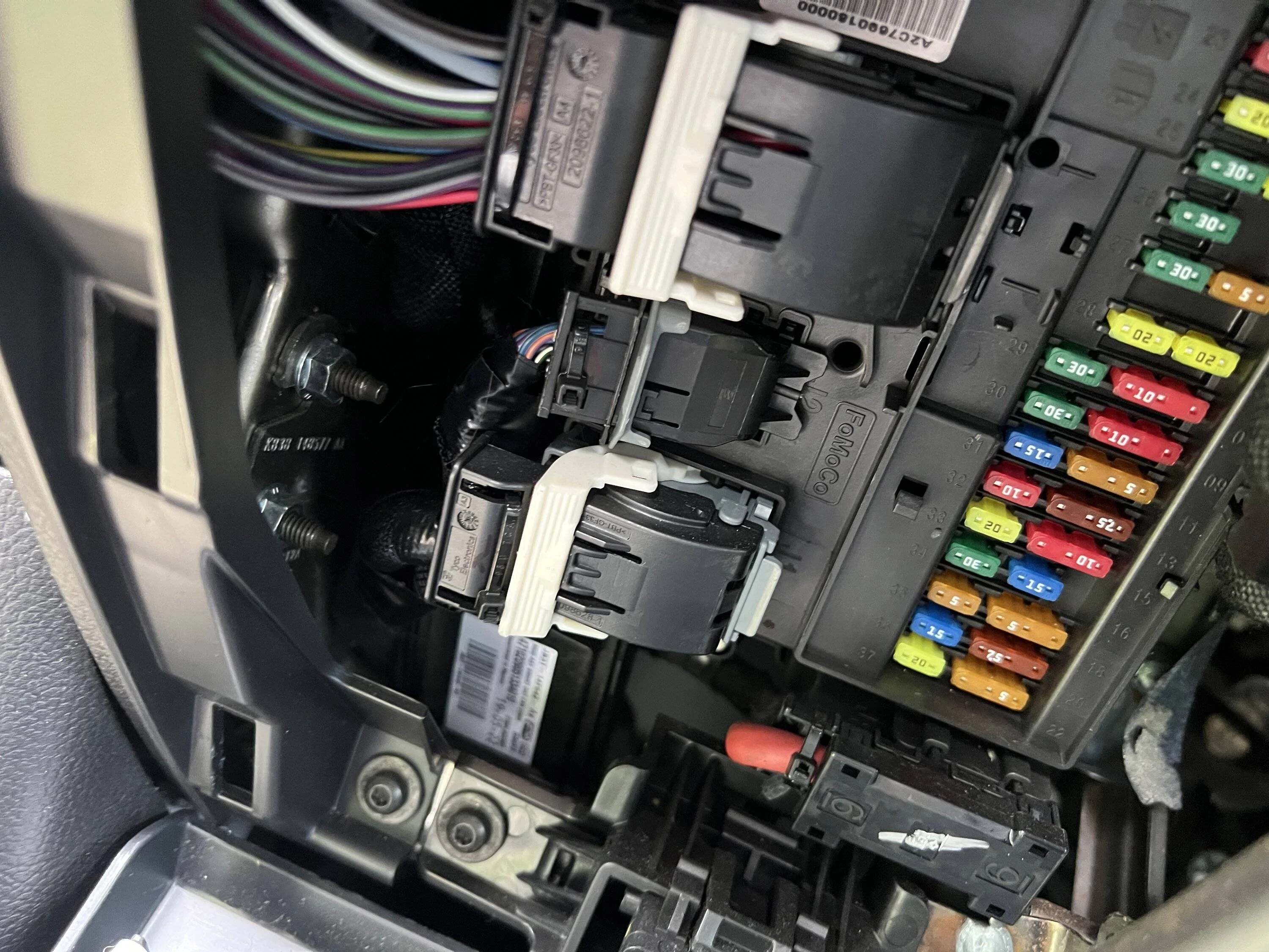

Getting ready to hook up a Dsr1 processor in my 2019 xlt without B/O. I only intend to connect the front left and right speaker wires to the processor. I would rather not have to disassemble the dash. When I opened the fuse box panel, I noticed a harness that appears to be all the standard car audio wiring colors. Is that what this is?

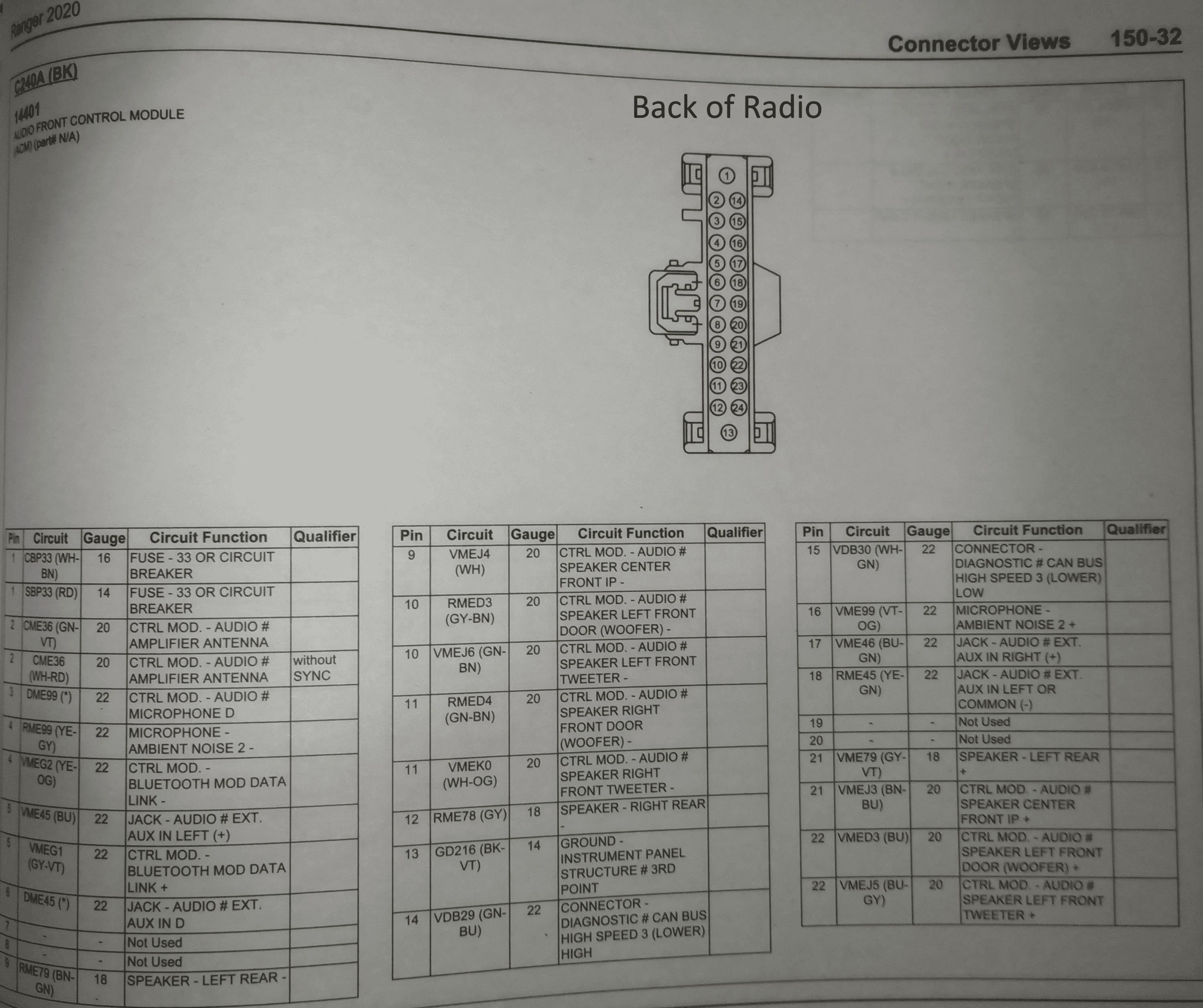

The connector your looking at is for the BCM. It does interior lights, door locks and stuff like that.

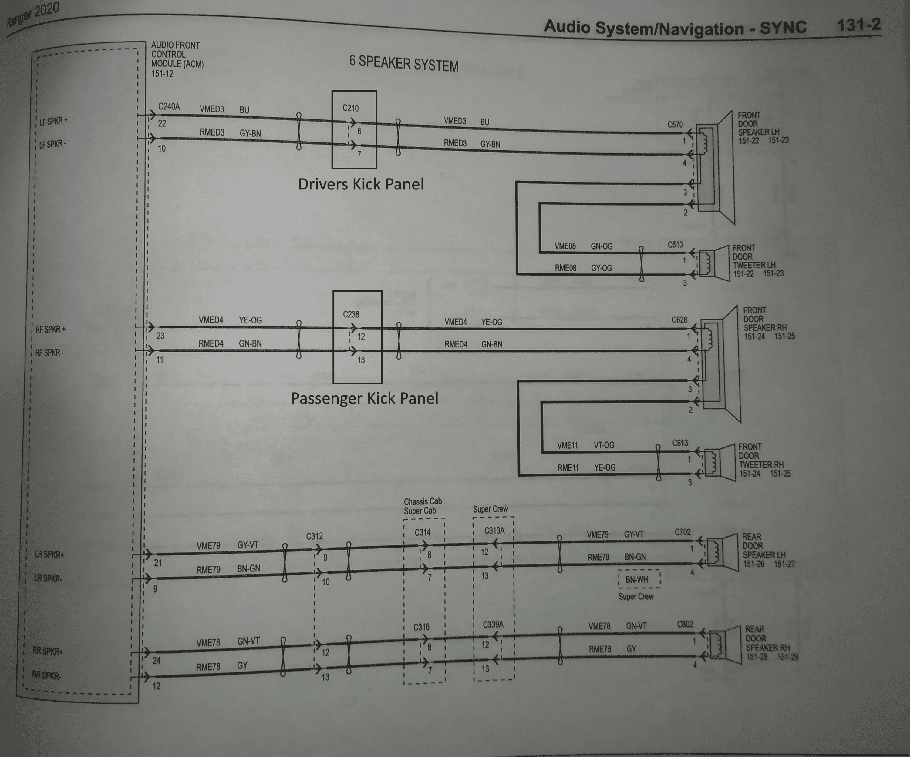

There are two places you can tap into the front speakers.
1. The door connectors behind the left and right kick panels.
2. The connector behind the stereo.
I would go for the stereo connector so there's less wire to run.
It's pretty easy to get the stereo out. Most of the interior panels just snap on.

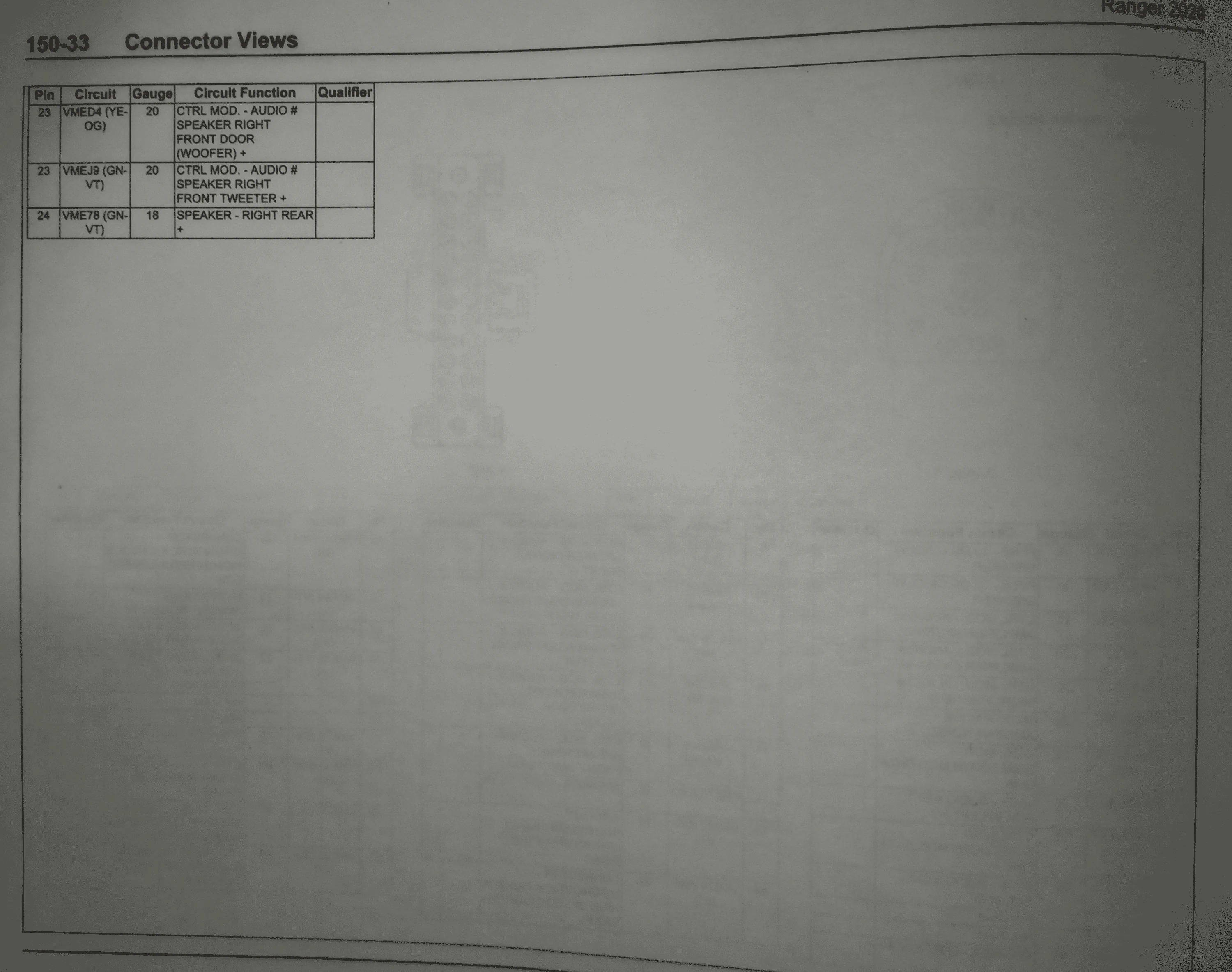

Here are some diagrams with wire colors so know what to tap into.
