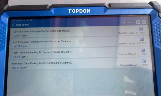

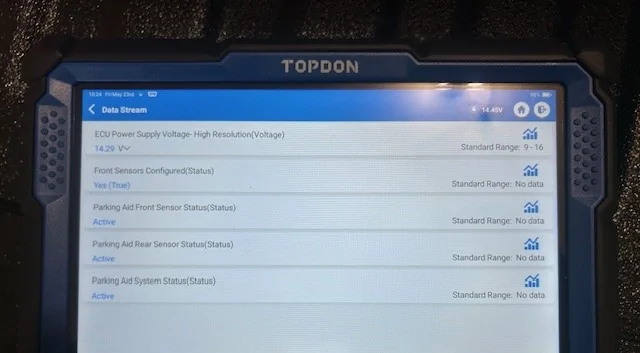

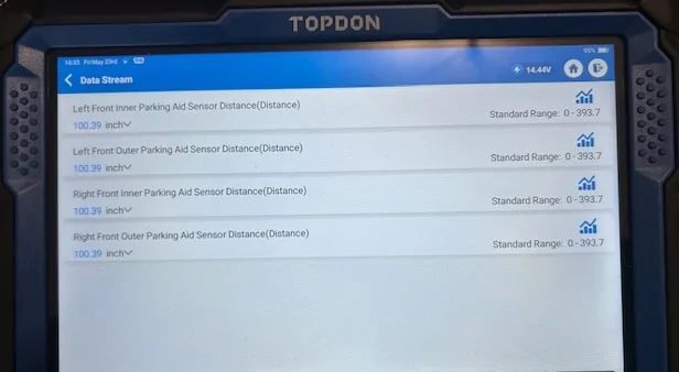

I wanted to clarify something and needed to take a drive with the scan tool hooked up.
I wanted to see (if the sensors deactivate) at speed and turn off.
They do indeed (deactivate) but the switch has nothing to do with it - it's the speed input parameter.
To clarify, they are always active when speed is below 5 MPH
So, the Ref of the switch (off or on), only turns off the feedback indication and alert when the speed is below (5 MPH Fronts & 3 MPH Rears)
All 8 sensors are still picking up (proximity) and are active & powered
They are never (disabled) by the switch and the only thing that is disabled is the - Visual & Audible aids you see and hear.
This is proven by my scan tool test PID, as selecting the switch to (off) provided no change in the sensor status
So, all manuals (owners & service) which state that the system can be turned off, is incorrect and misleading as long as the BCM has Power feeding the PAM Module they cannot be turned off, however they will auto deactivate at speed.
So, if we reference the OP's issue, he is selecting the switch off (to rid the annoying) park aid warning he is getting from the front sensors picking up the bar as an object (proximity)
if we were to hook up the scan tool, with that switch On or Off those inner sensors are still providing feedback to the PAM module to generate an alert.
With the switch off - that alert is turned off, that's all that is turned off.

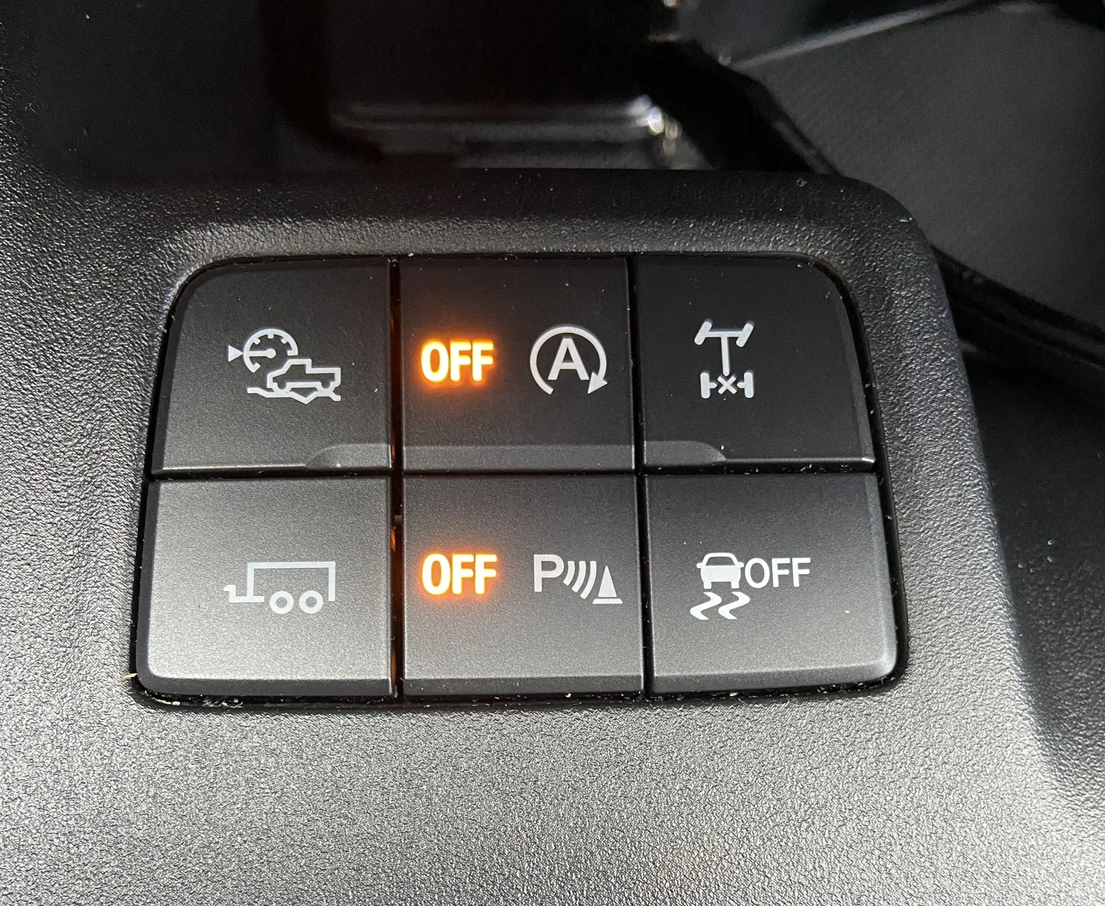

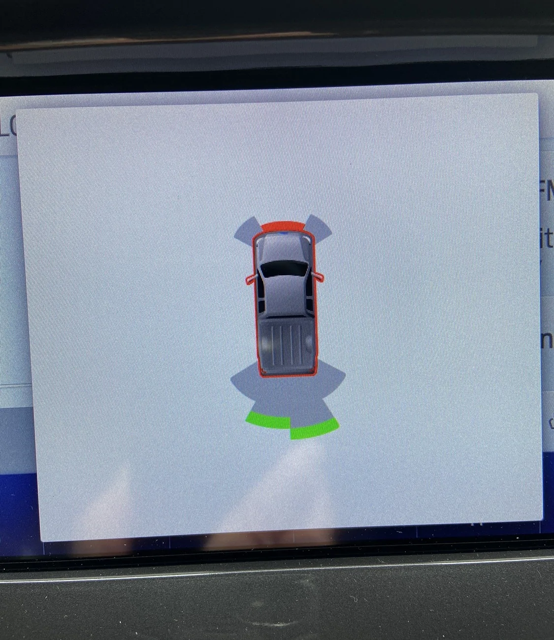

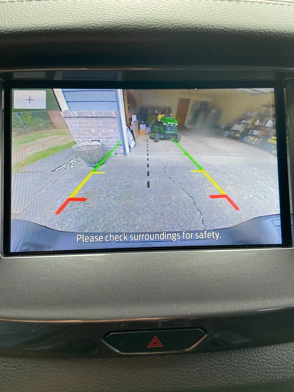

So, here are some pics of what's going on specifically when the ignition is ON, and parking assist switch on or off... will explain.
When ignition is ON, PA switch is ON, and in DRIVE - Nothing seen or heard from front sensors. Pic of various center console switches.
When ignition is ON, PA switch is OFF, and in DRIVE - Audible alarm and what is displayed in pic of truck on screen.
When ignition is ON, PA switch is ON or OFF, and in REVERSE - No audible alarm and what is displayed in pic of reverse travel.
I conclude that only the two inner front PA sensors are picking up the lower bar and likely the front lower parts of upright bars of the grille guard.
