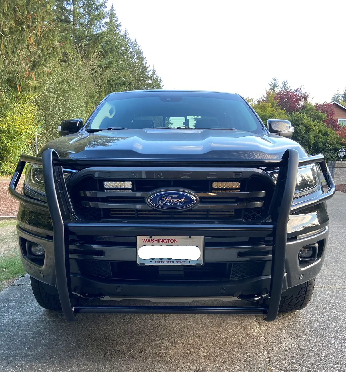

So, here are some pics of what's going on specifically when the ignition is ON, and parking assist switch on or off... will explain.
When ignition is ON, PA switch is ON, and in DRIVE - Nothing seen or heard from front sensors. Pic of various center console switches.
When ignition is ON, PA switch is OFF, and in DRIVE - Audible alarm and what is displayed in pic of truck on screen.
When ignition is ON, PA switch is ON or OFF, and in REVERSE - No audible alarm and what is displayed in pic of reverse travel.
I conclude that only the two inner front PA sensors are picking up the lower bar and likely the front lower parts of upright bars of the grille guard.
