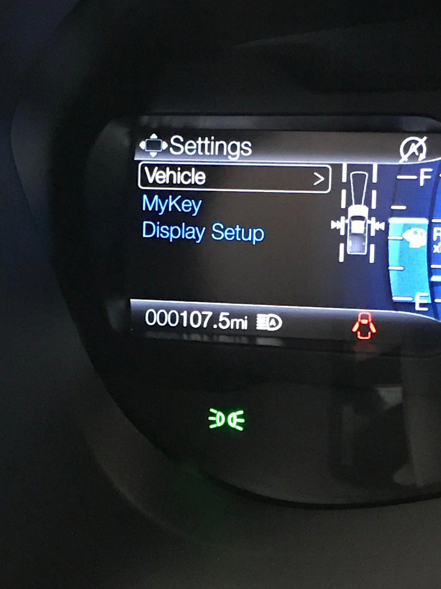

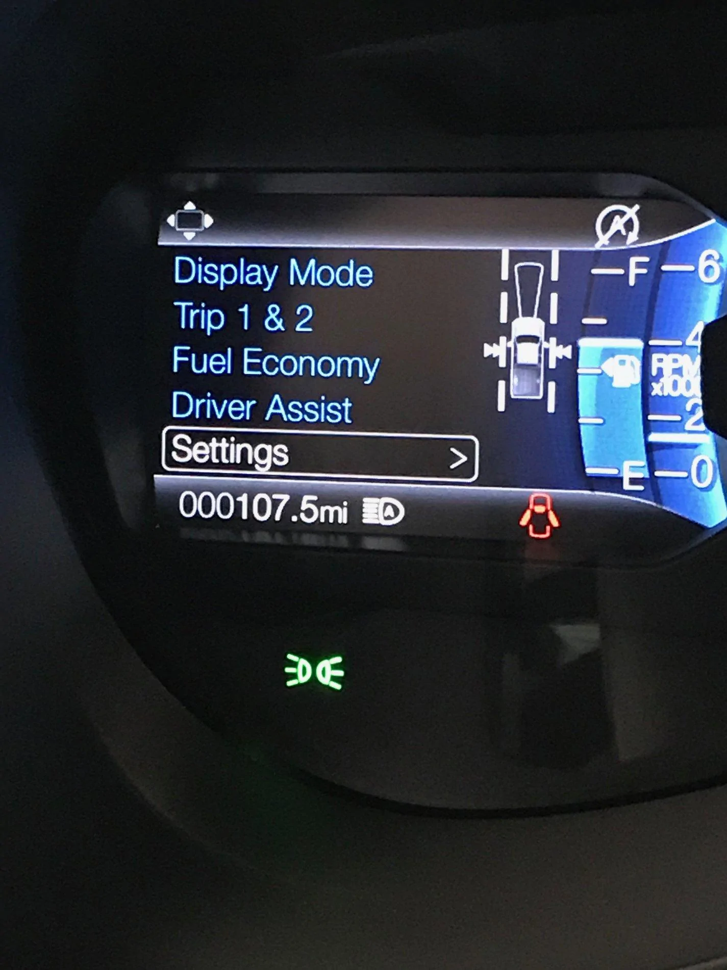

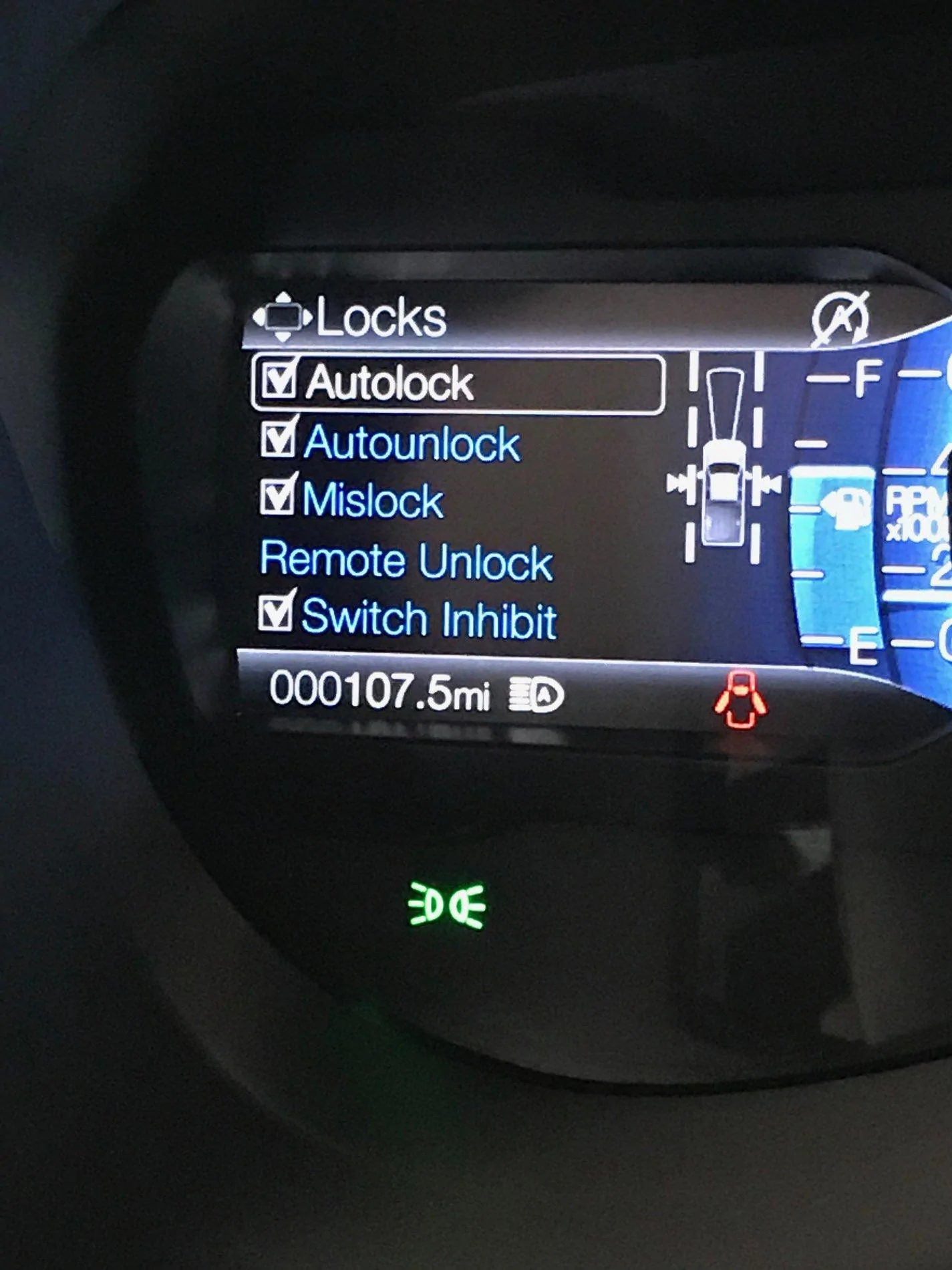

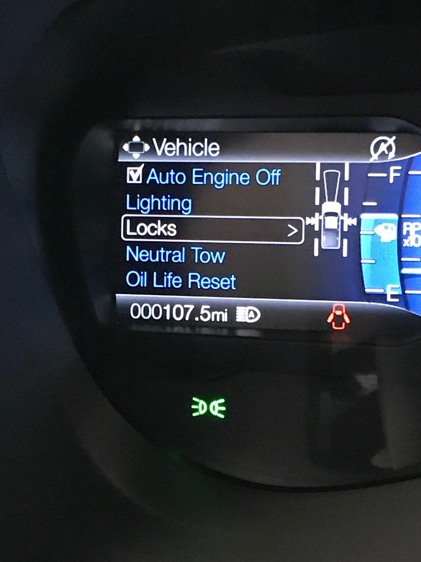

Here is the menu sequence... You'll just have to play w/ the settings as Mislock and Switch Inhibit aren't even in the owner's manual so I don't know exactly what they signify. I even searched the PDF versions 1 and 2.

Switch Inhibit turns off the power lock switches after 20 seconds. Either the ignition needs to be turned on to restore unlocking or the key-fob needs to be pressed.
Mislock is the double honk when you try to Lock the vehicle with the remote but a door is still ajar.
