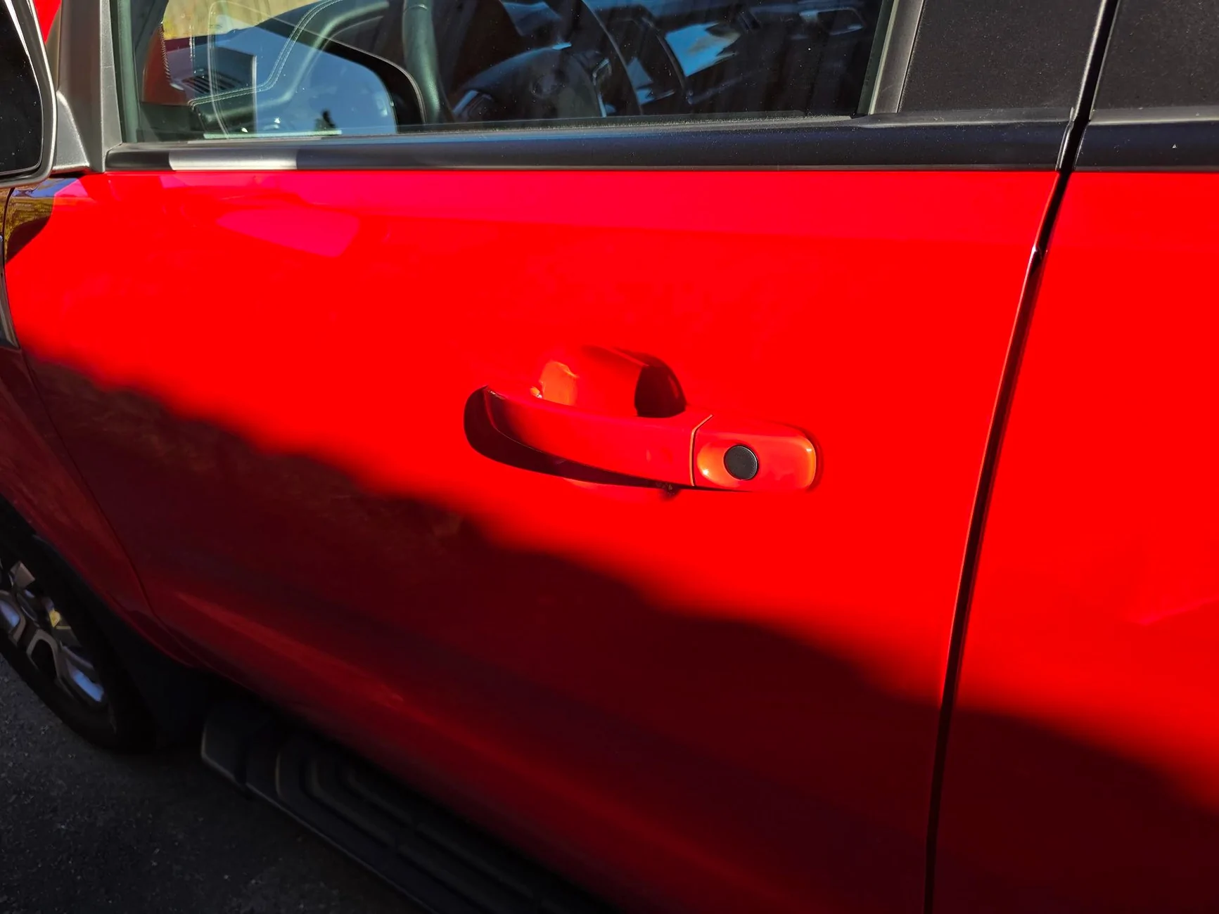

First, I want to apologize for being negligent in updating my findings to everyone who has taken the time to assist me with this issue.
After several days of testing, the only conclusive symptom that remains the same is that when I press the driver and/or passenger side door lock indents, the lights flash on the outside of my folding mirrors to indicate that the lock signal was received.
I was asked to check and see if the mis-lock check mark was on in the dash panel, and all three check marks were flagged in the lock section.
So, sometimes it locks and sometimes it doesn’t. I’m starting to get good at the difference between the two sounds. One is, shall I say, more solid than the other. Since I really can’t trust the pressing of the indents, whether I press it lightly by a light touch of the fingertip, or depressing hard with my thumb, I’ve just been reaching in my left front pocket and finding the small round button by feel and pressing it which is always a solid lock.
Up here where I live, I’ve had too many bad experiences with dealership service. Even though I have an extended warranty, my experience has been that the vehicle is returned in worse condition than when it went in for a repair. So, this is something that I’m just going to live with for now.

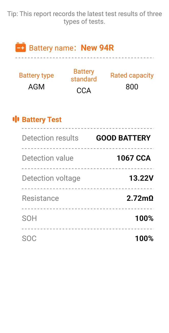

My OEM Motorcraft 94R battery actually tests out with higher ratings than the loaner Odyssey 94R, so tomorrow or the next day I’ll probably swap them back out and return the loaner to my friend.

By any chance is there dirt or grime on the back side of the front door handles or anything touching the back of the door handle when you lock using the outer door handle touch point?
No, I might live in Alaska but with the exception of rain and snow this how I keep my vehicle.
