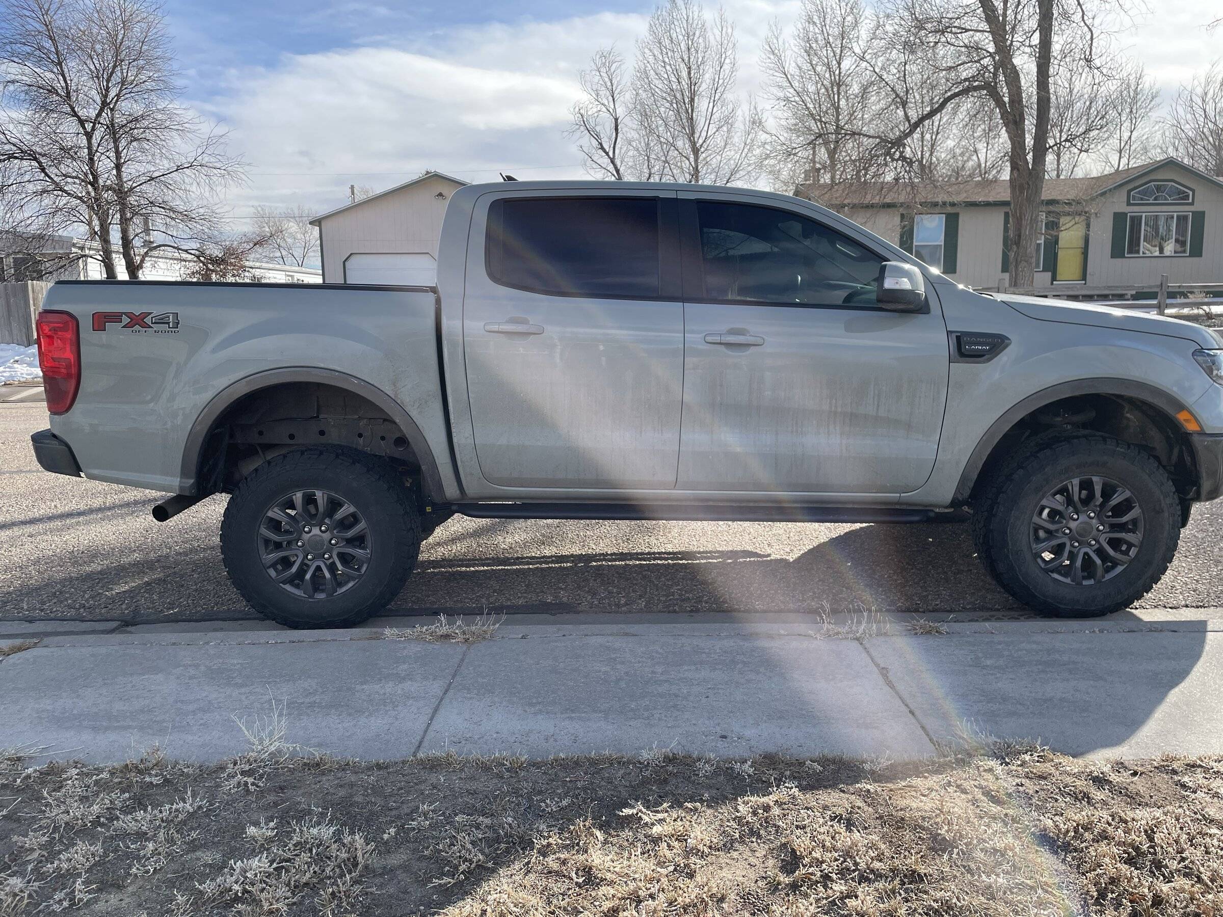

Ok so I had a shop do this one as I’m on a time crunch. Result: a lot more than 2.2”! More like 4”. Got some crazy rake so looking forward to it settling. Also with the camper in it of course not so bad (will try that out tonight).

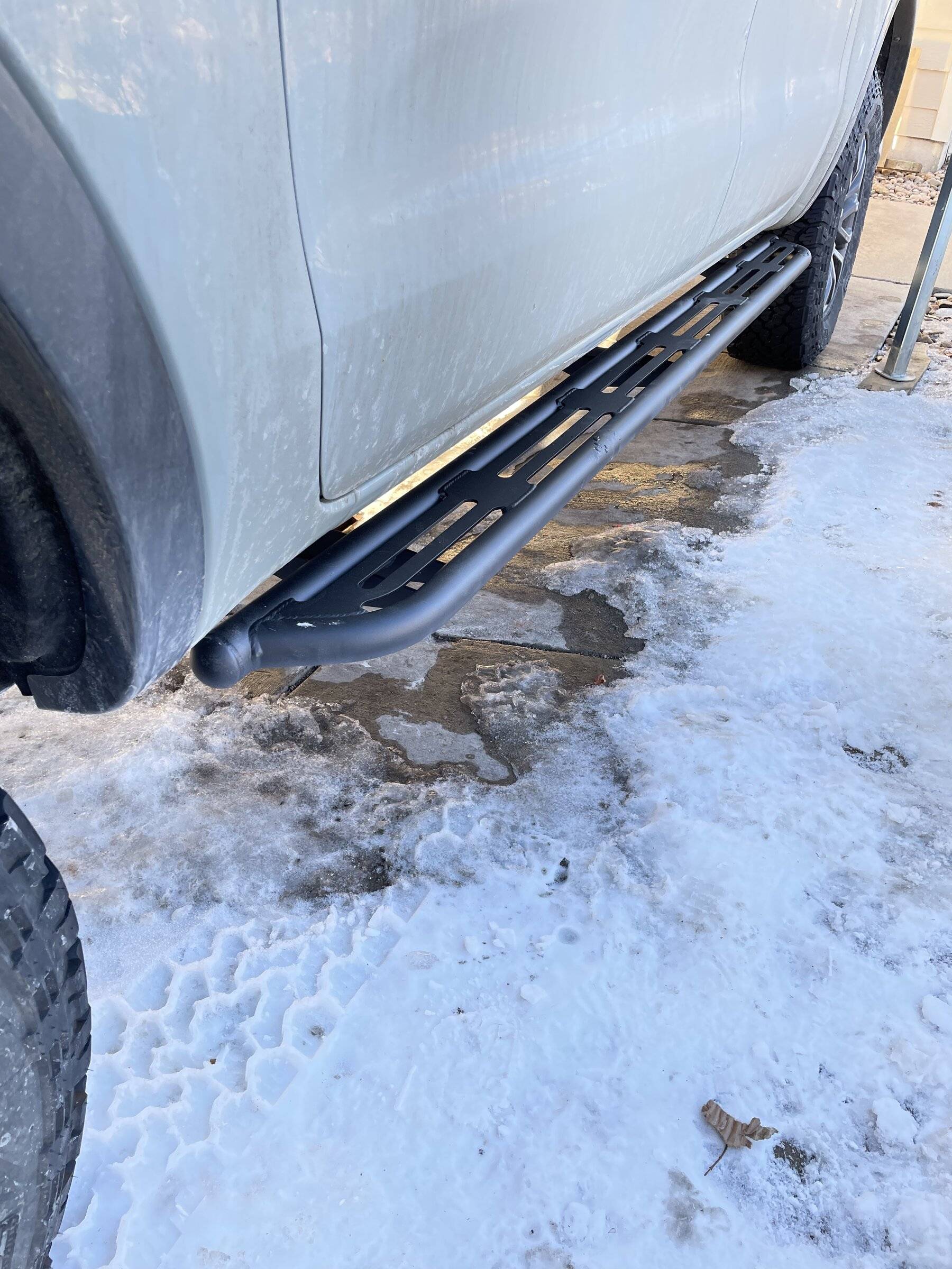

If the rake doesn’t settle enough there’s always the extra .5-1 inch adjustment to be made on these front 2.0 shocks. To be continued. Also peep the ADD Lite steps! Super solid. And easy install bolt right in.
