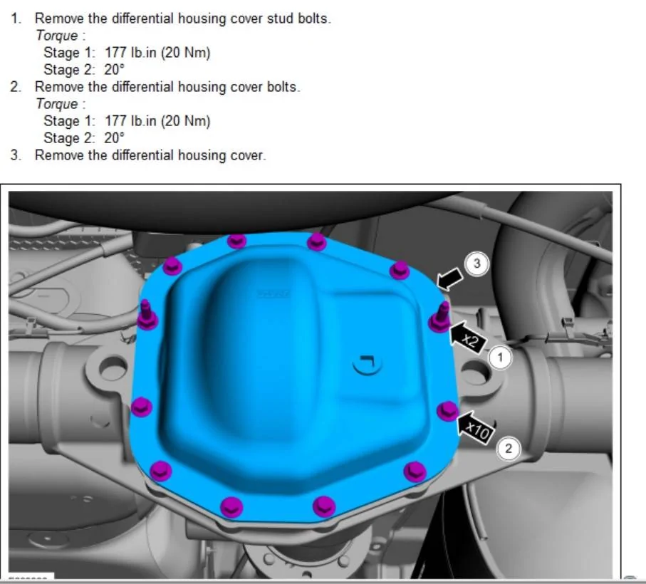

Not sure where the 29 ft/lbs came from.
The cover bolts are to be torqued to 177 in/lbs and then an additional 20 degrees. Here is the shop manual on this. 177 in/lbs = 14.75 ft/lbs.
The 29 ft-lb torque came from the instruction manual that came with the M220 (M-4033-BR) differential cover.

I would say that the instructions are wrong.
It may be a little different with the other cover. Also with the 20° extra you will probably be close to 29 ft lbs of torque
