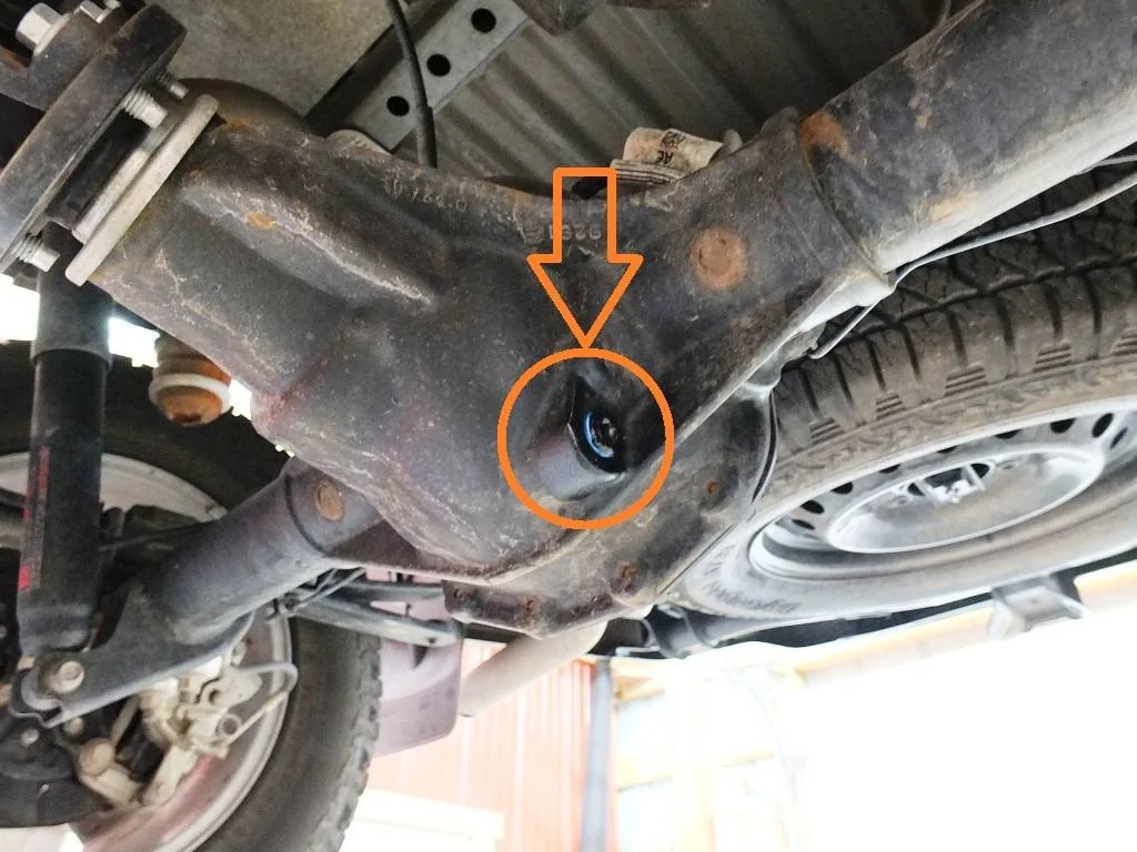

Nope…no drain plug on my 2022..…this is why i want a cover with a drain plug.

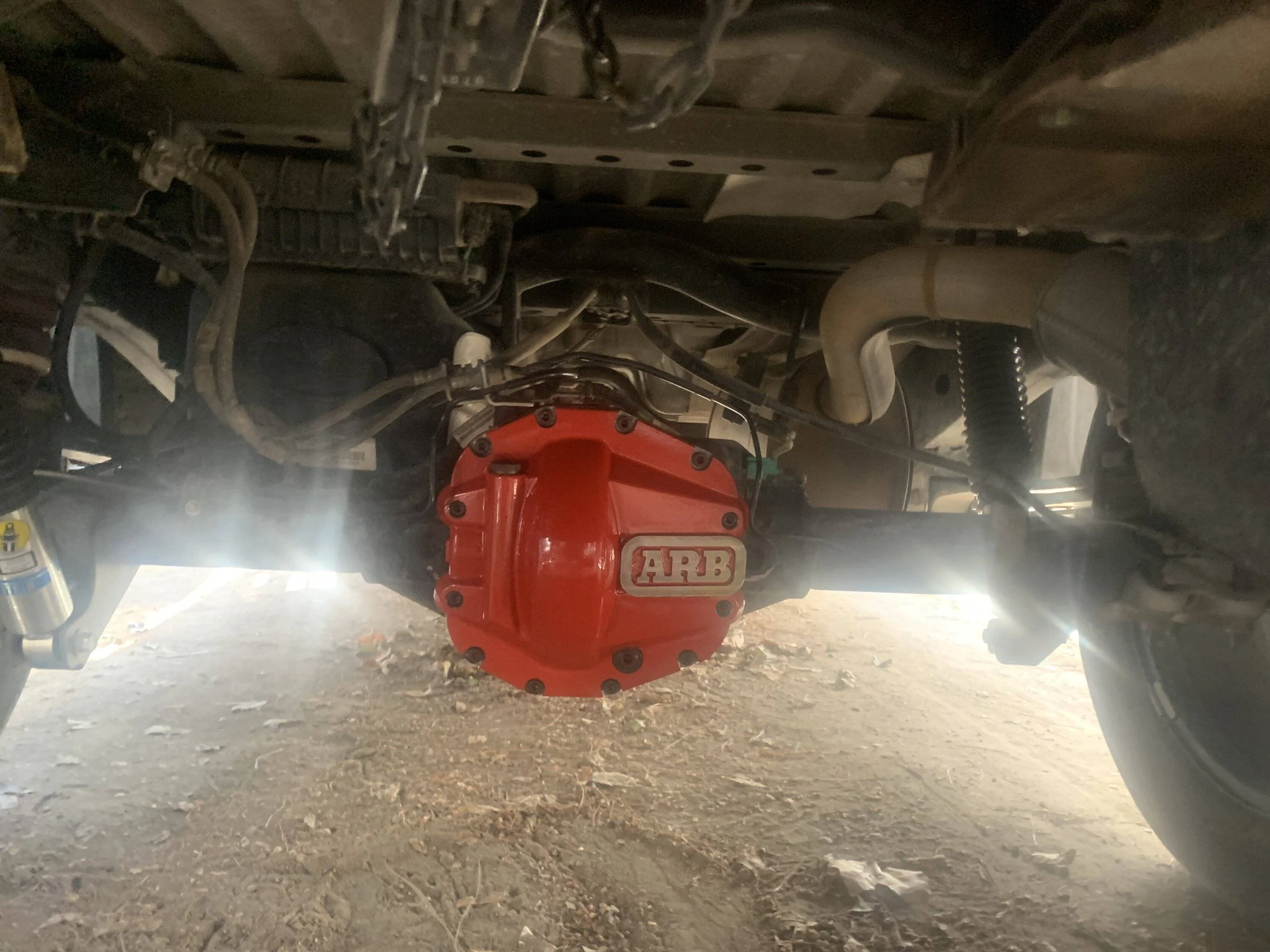

Go with ARB I did has a drain plug and dipstick. The brake line does get in the way of dipstick but it still can be used to measure and fill from hole. I have 2019 with drain plug on housing.

Not sure if it really increases capacity by much. It’s made more for off-roading applications It’s stronger and won’t crack or break off if I hit a rock on the trail. If you do some research I’m pretty sure Bronco cover will work. Not sure 100% but I believe this rear end is used on multiple vehicles. The ARB cover works on Jeep jk I think. Here’s a link they have a few more options now on stage 3 then when I bought mine that also have ford performance for sale on site now.

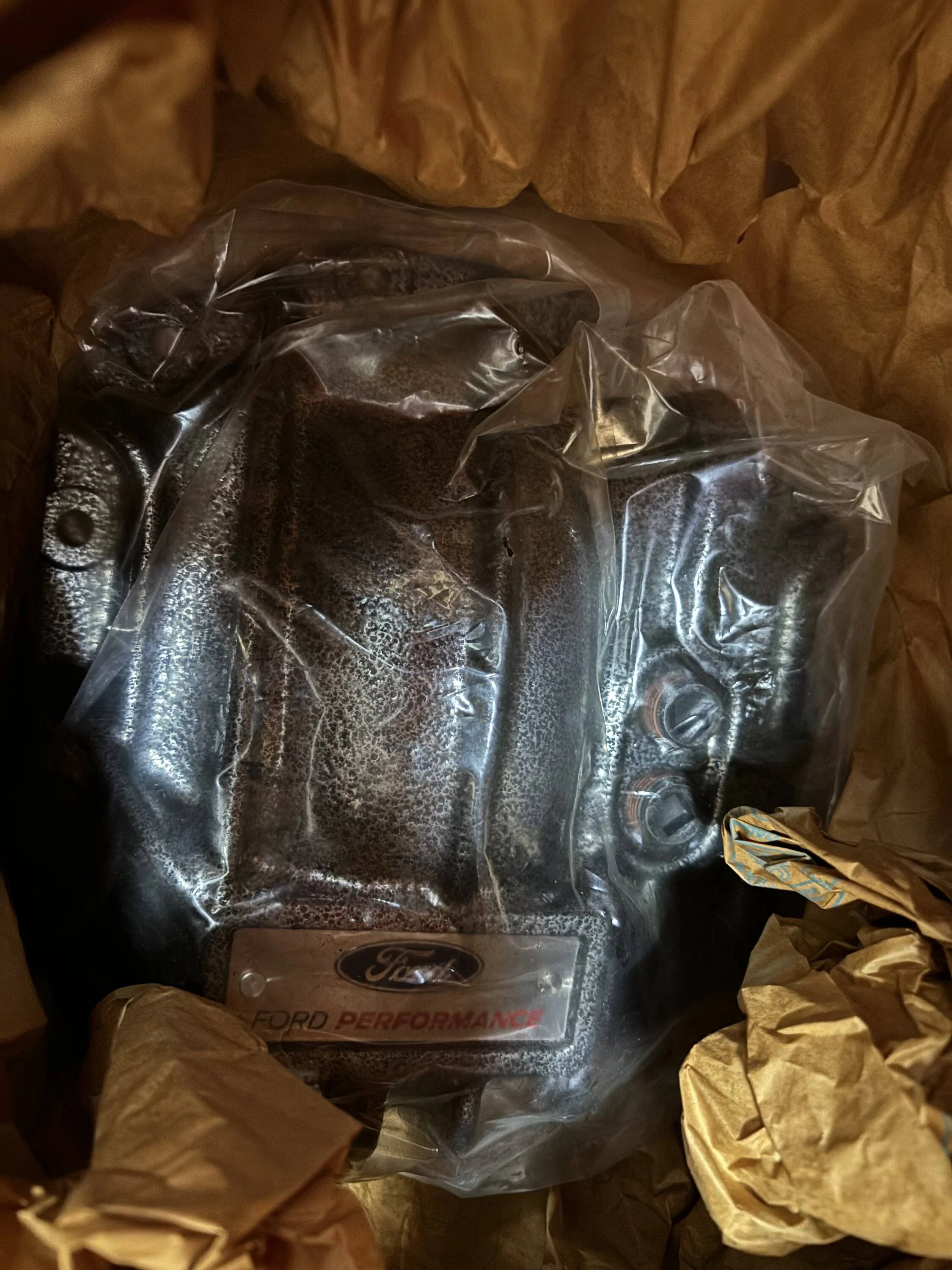

I have the fp diff cover, haven't installed yet. Don't think there'd be room to add a drain on the cover
I have 2022, no drain of course. Though I wouldn't have a need to do frequent changes, only for maintaining, I don't mind buying another gasket if it's damaged. The fp part does come with gasket as well.
only at 15k now plan to put on around 20.

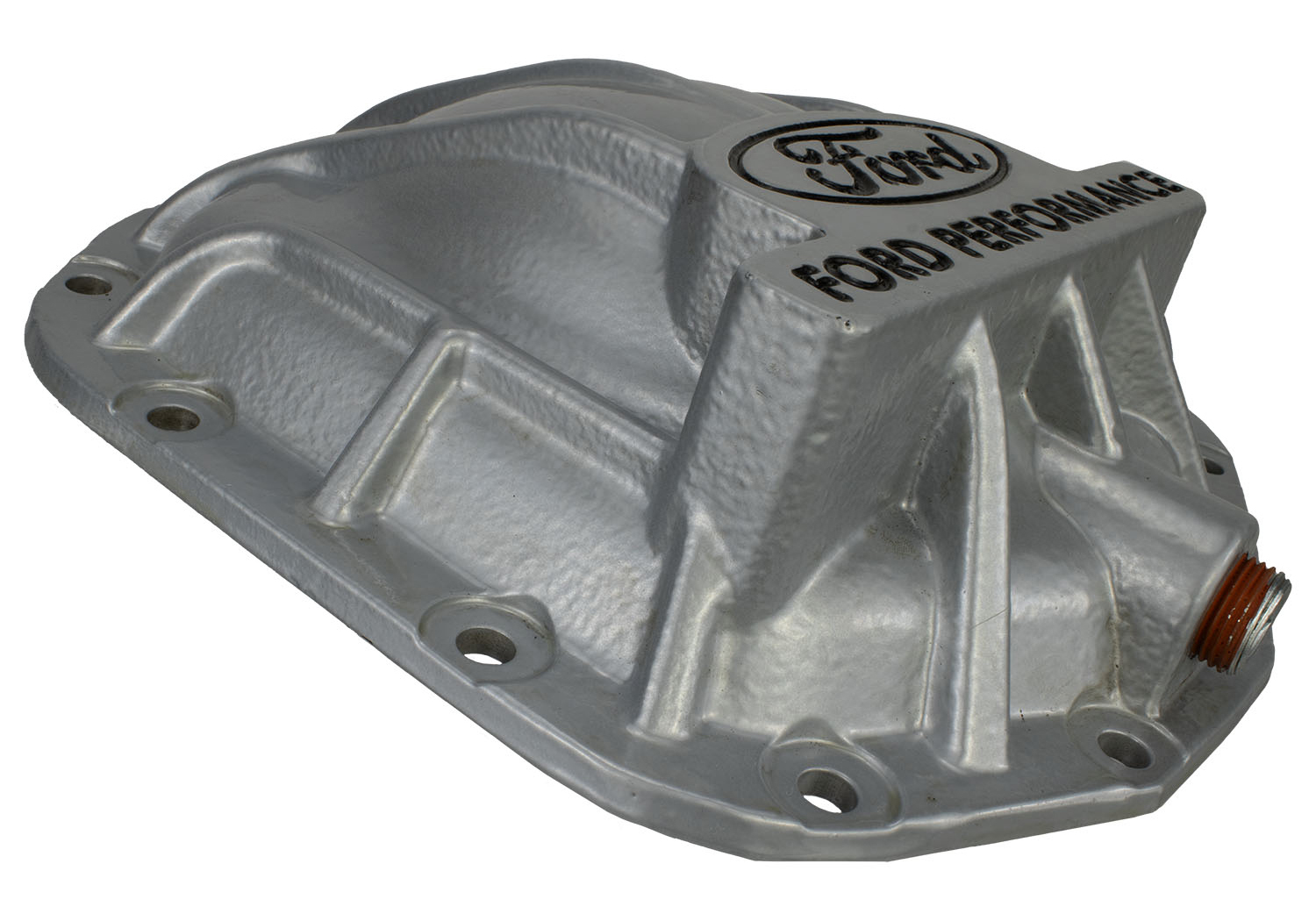

There seems to be 2 of these Ford Performance covers:
m-4033-R for Rangers
m-4033-BR for Broncos (the pic SHOWS a drain plug!)
Whats the difference? I thought the axels were the same?
I came here to ask this same question. I was planning on using Ford Pass Points - but, the Ranger cover is out of stock. The main reason I’m replacing is for a drain plug (but I’m also learning that I likely have one on the housing since mine is 2020).
That being said - the Bronco version is cheaper and they are running 25% off sale….
I have the ARB on my Bronco. Assumed all the M220 covers are interchangeable.
redone17
Jul 27, 2023
216
290
Cold Spring, NY
2021 Bronco Black Diamond, 2020 Ford Ranger Lariat
Looks like they updated the description on the Bronco version and sold out/discontinued the previous Ranger version. It would be nice if they updated this on the Accessories site too.
From the Ford Performance site:
Protect and upgrade the look of your Bronco rear axle with the Ford Performance Parts heavy duty differential cover.
  • Fits 2021-2024 Bronco
  • Fits 2019-2023 Ranger
  • Rugged cast iron construction
  • Stylish Ford Performance branding
  • Durable powdercoat finish
  • Includes new fasteners and gasket
***DOES NOT FIT Bronco Raptor***
https://performanceparts.ford.com/part/M-4033-BR

This M-4033-BR cover shows a drain plug! Check out the pictures…there is a bottom view picture that clearly shows a drain plug. Can someone confirm?
redone17
Jul 27, 2023
216
290
Cold Spring, NY
Yes, the Bronco version has a drain plug. I can’t comment on the discontinued Ranger version.
