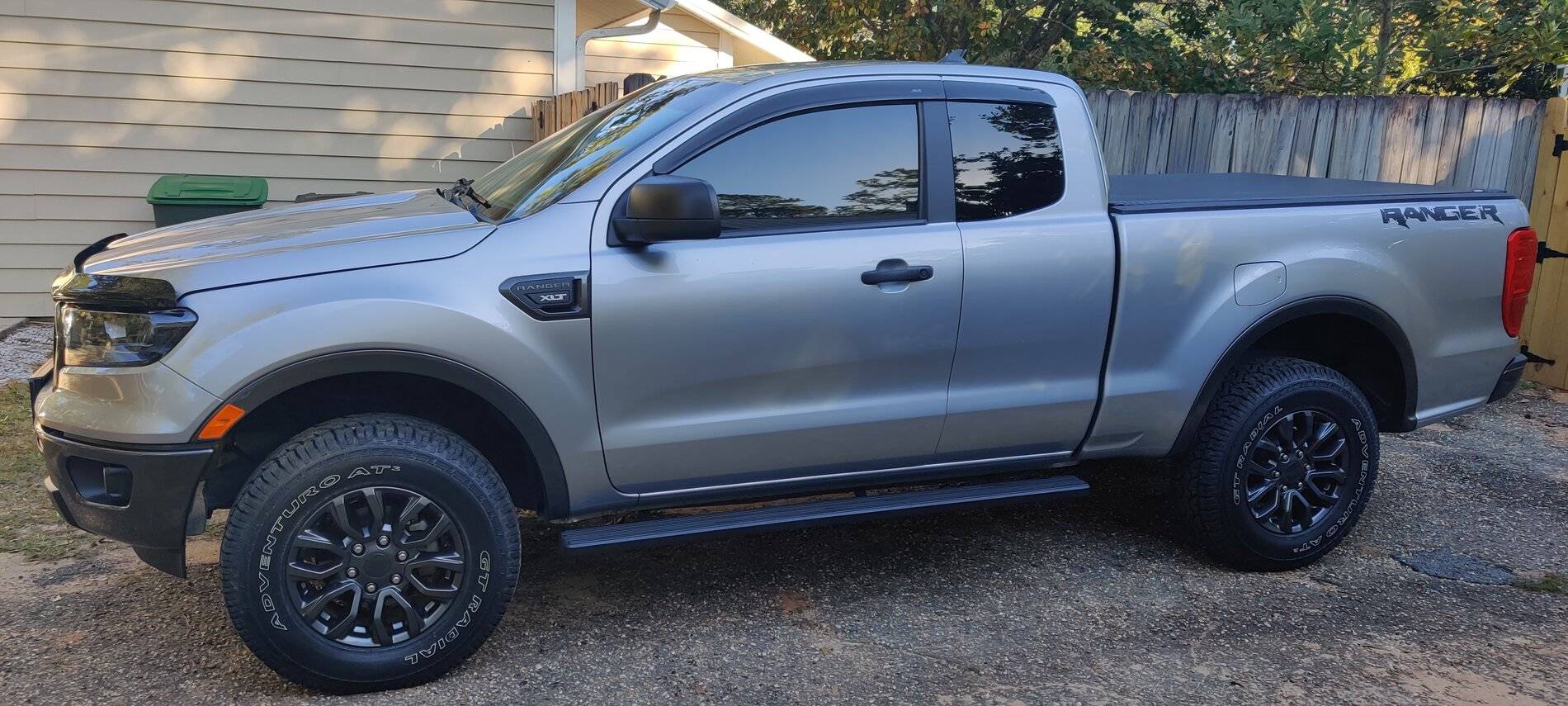

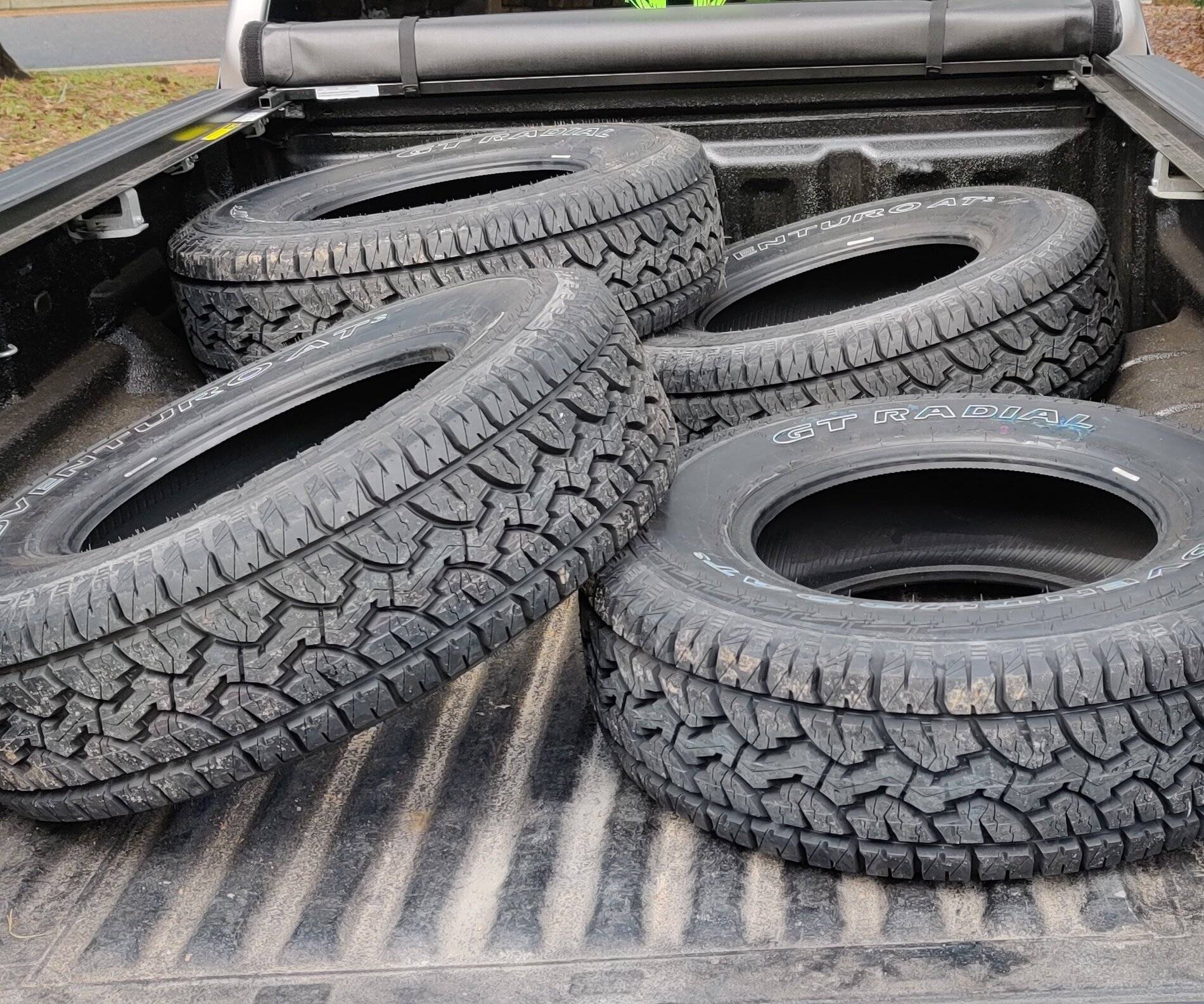

I put a 2.5" level kit on mine and I went with GT Radial Adventuro AT3 LT 265 70R17. I'll probably get spacers, still on the fence about it. Very comfortable, sturdy tire. They're not as wide as I wanted, hence the thought of spacers, but they're exactly what I wanted them to be.
