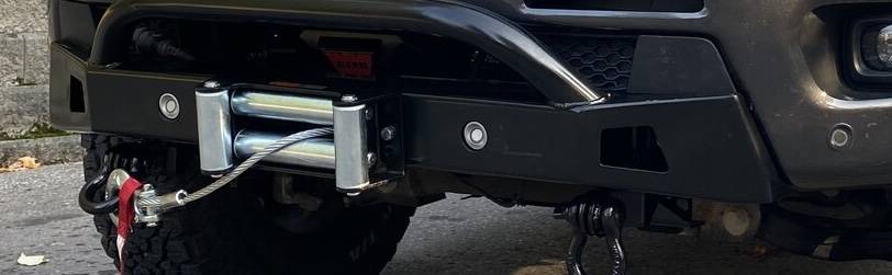

So I finally got around to installing the Shrockworks bumper I got with the new winch. I installed everything back, still need to find a good way to strap up the harness wince cutting the lower metal tabs from my OEM bumper, but after wiring the winch and getting the front sensors plugged back in with the retainers (it’s not loose by any means) my front sensors are going crazy every time I stop or go slowly enough for them to start detecting. Is this something that will fix itself after driving around long enough or something that needs to be re calibrated?

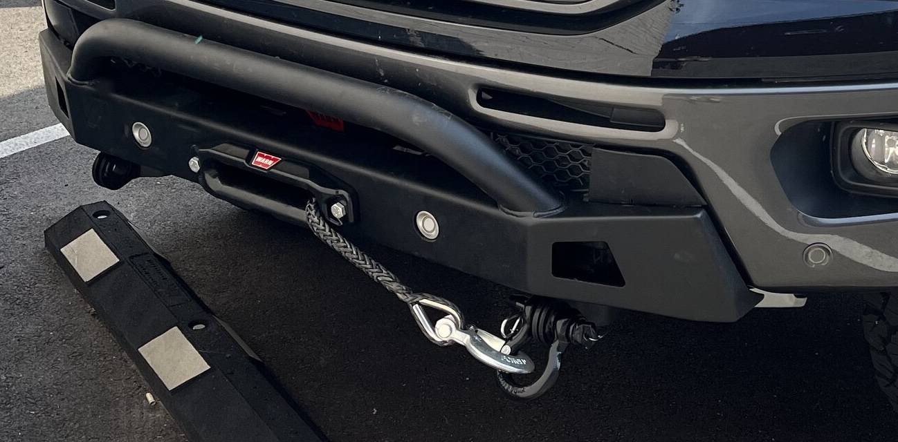

If you have your winch cable running down to the shackle, maybe it’s being detected by the sensor…???
Or if your fairlead sticks out quite far, maybe it’s being detected…???
Have any pictures of your setup? Posting a few might help folks get you the answer you’re looking for.

*fixed* found the error. I appreciate the help guys. I had not done the winch pre tensioning and the hook was swinging around when I would stop. I pulled the hook against the fairlead but not too tight so i can actually pull the cable out later without being bound up. Thanks for all the feedback

you have one of these coveted winch plates too? I ended up taking the front chin off to cut off the bull bar and re weld it with more angle so I can put soft shackles across it. Found it to be too close to the bumper and was hitting my license plate also. Angling it out fixed both my problems. Its nice to know a welder sometimes.
