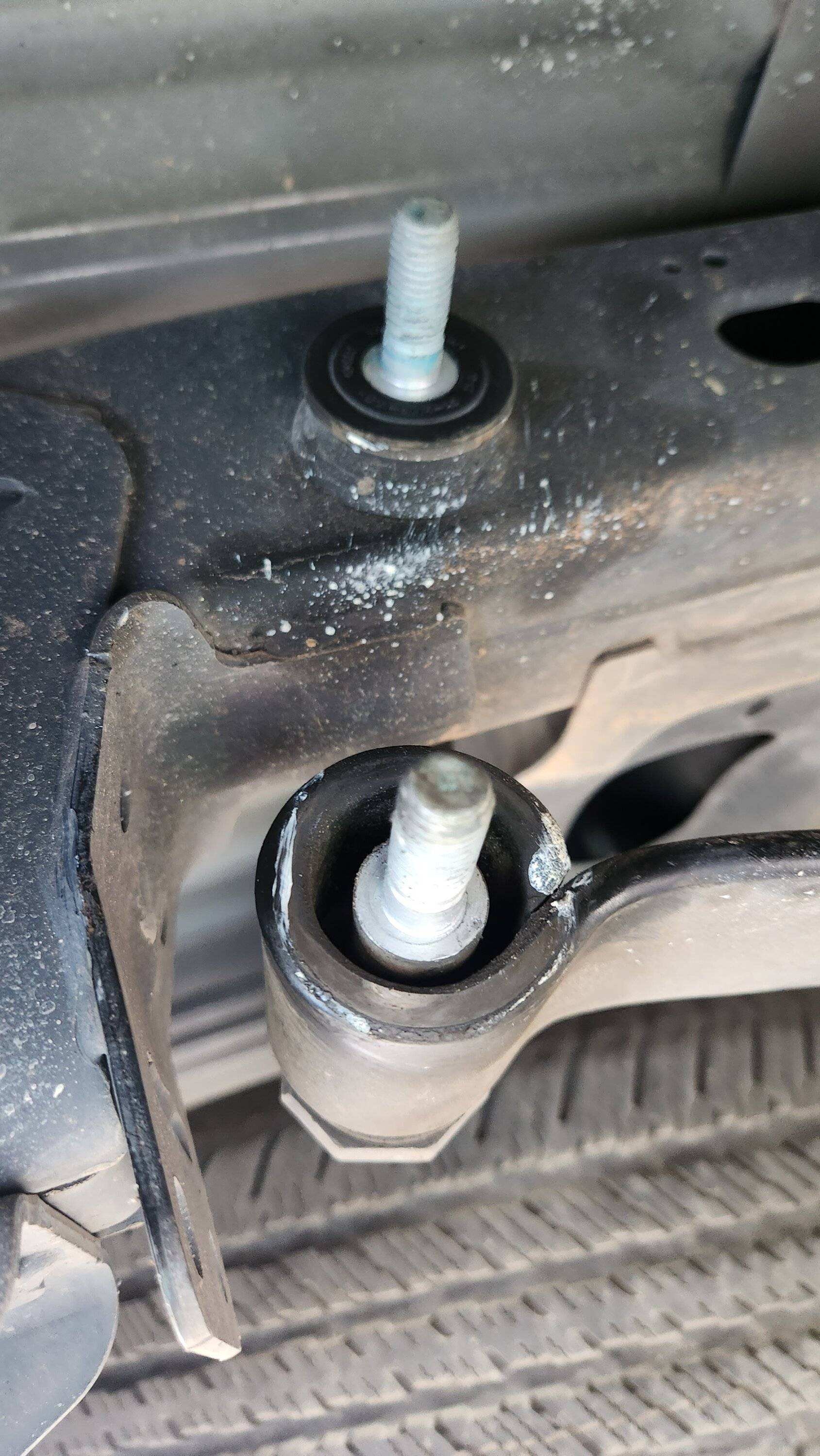

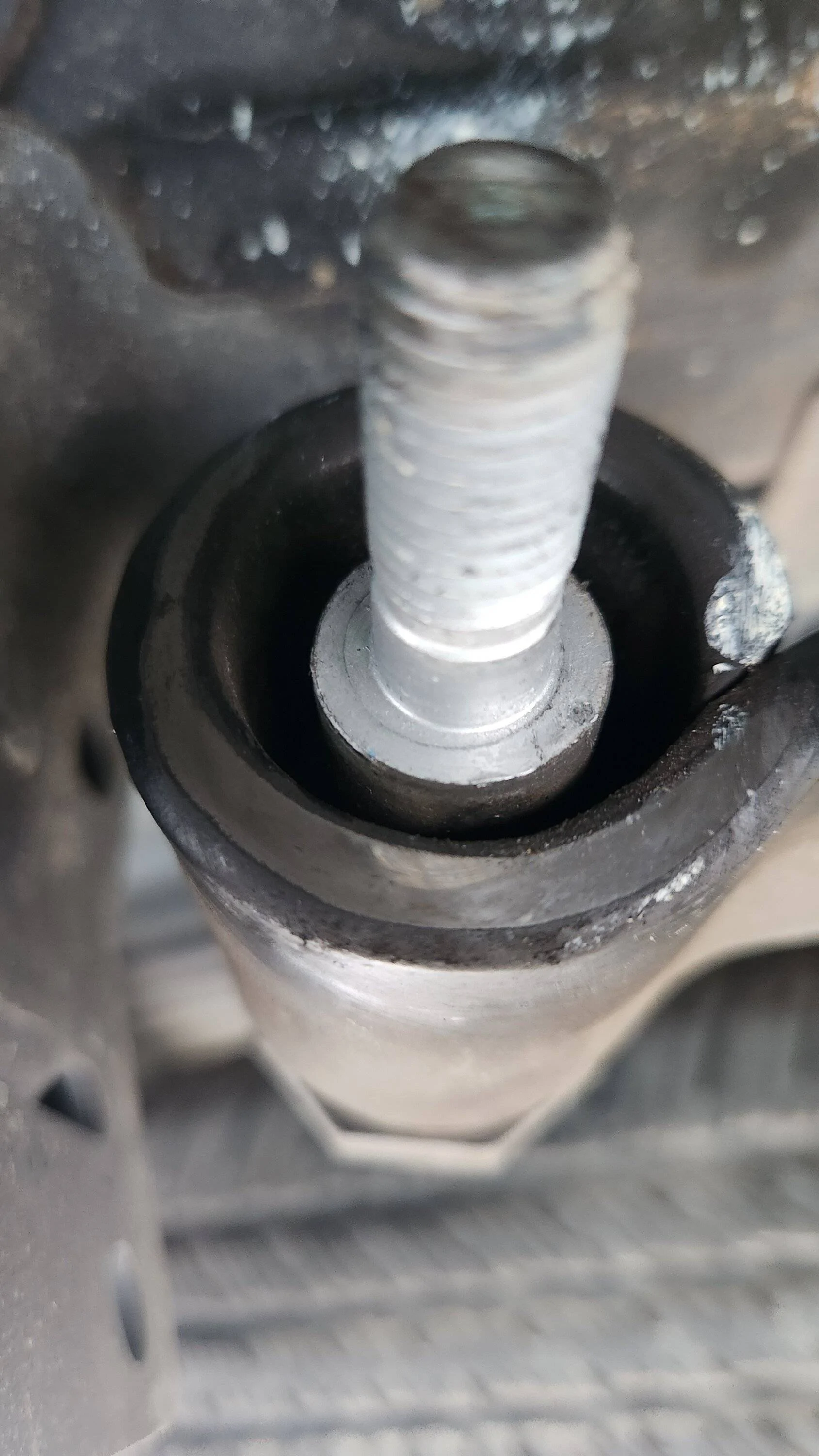

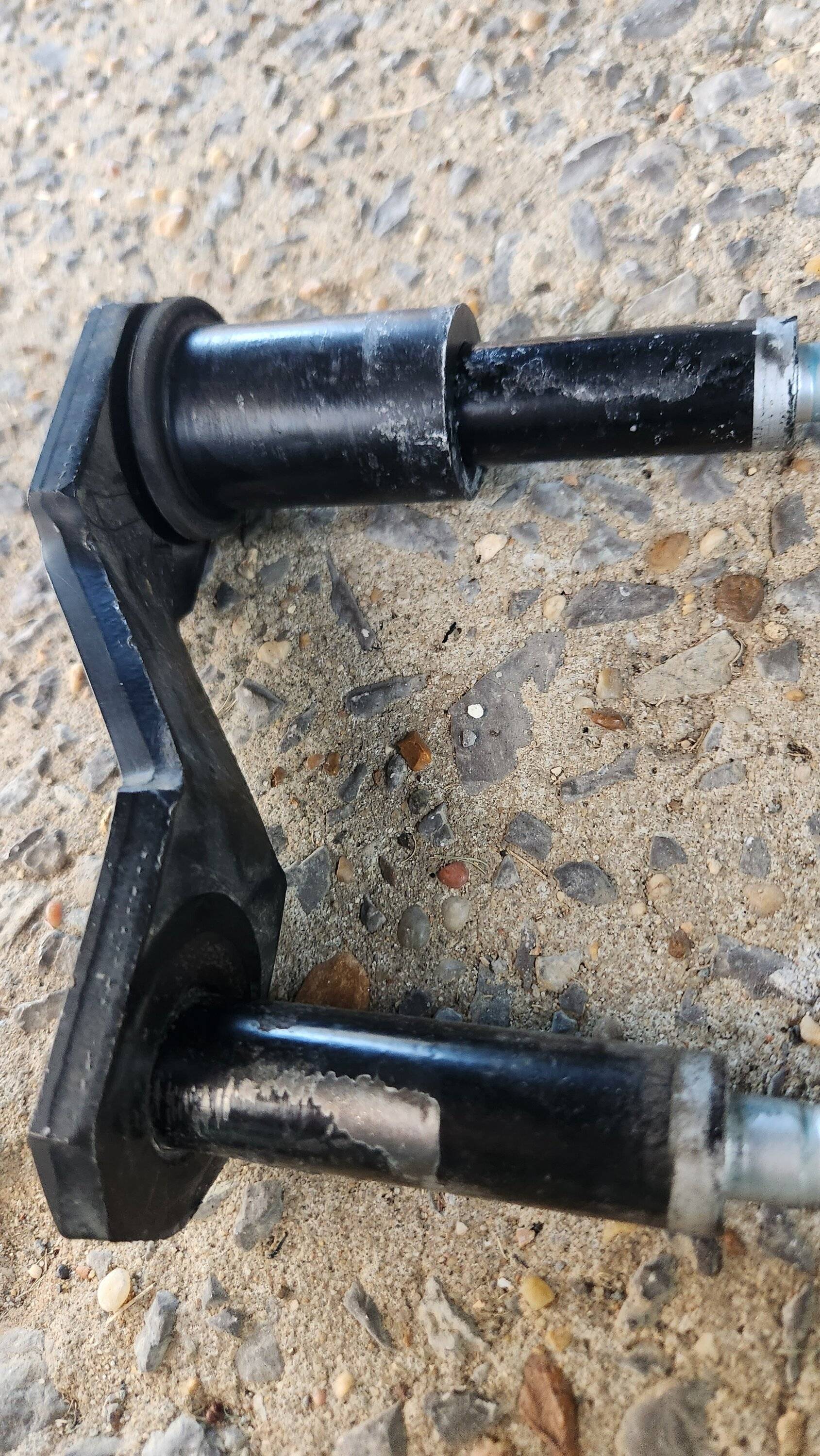

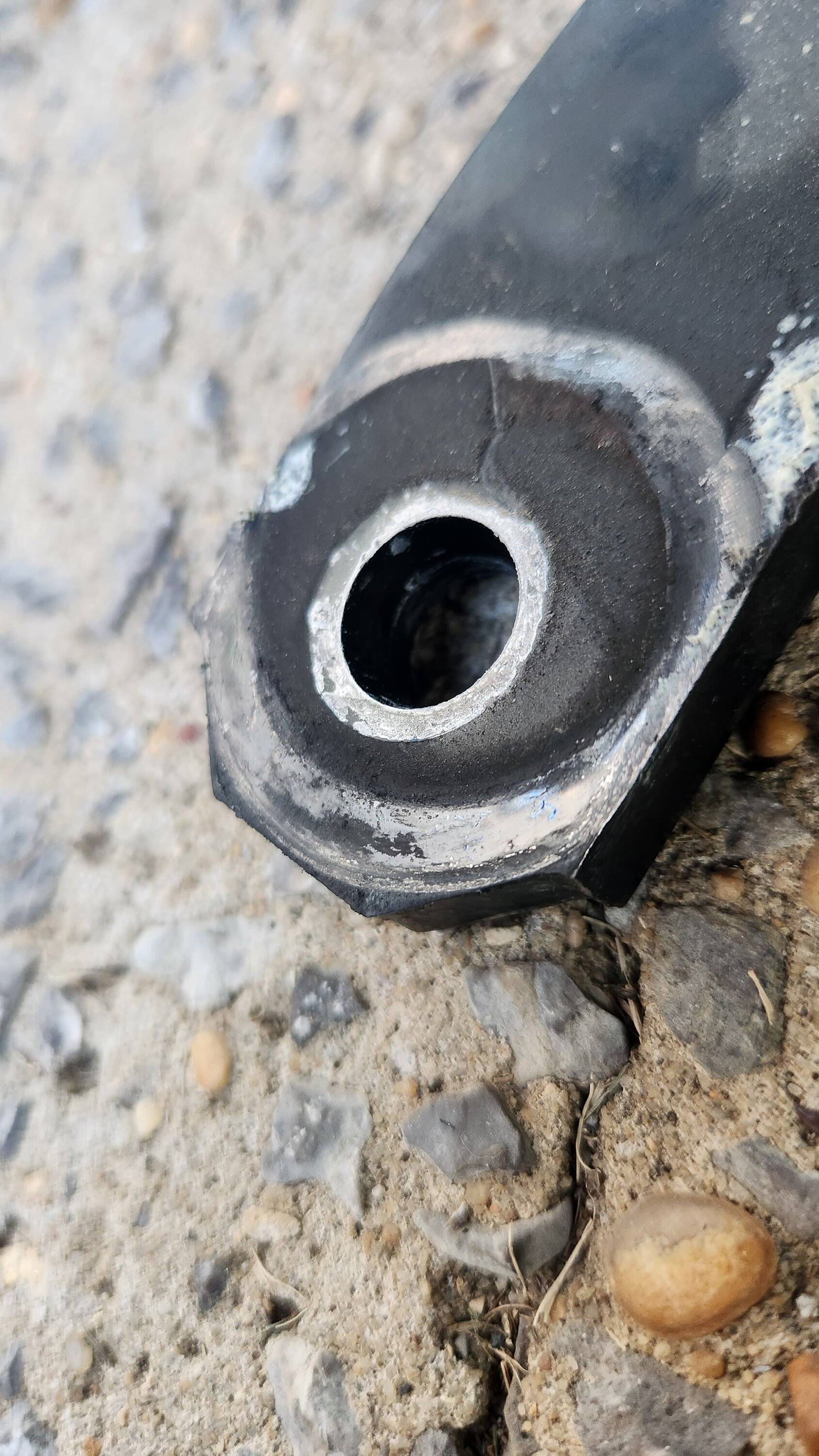

Got the Dobinsons set of bushings in.
Took the shackle off and Ford Assembly 100% didn't put one in from factory on day 1. Metal is dang near a mirror finish on the spring and shackle where it was rubbing for the last year and a half.
Also, unfortunately I'd have to disagree with Phil on this one. None of the bushings are pressed, they are all split bushings, so there's no way this wasn't anyone but the Ford Line's fault. Can't even get the shackle on and off the frame without those bushing popping out.
The Dobinsons urethane bushings definitely look and feel to be better quality than the OEM rubber. Only had time to do the one problem set tonight. Will get the other bushings in at a later date.
