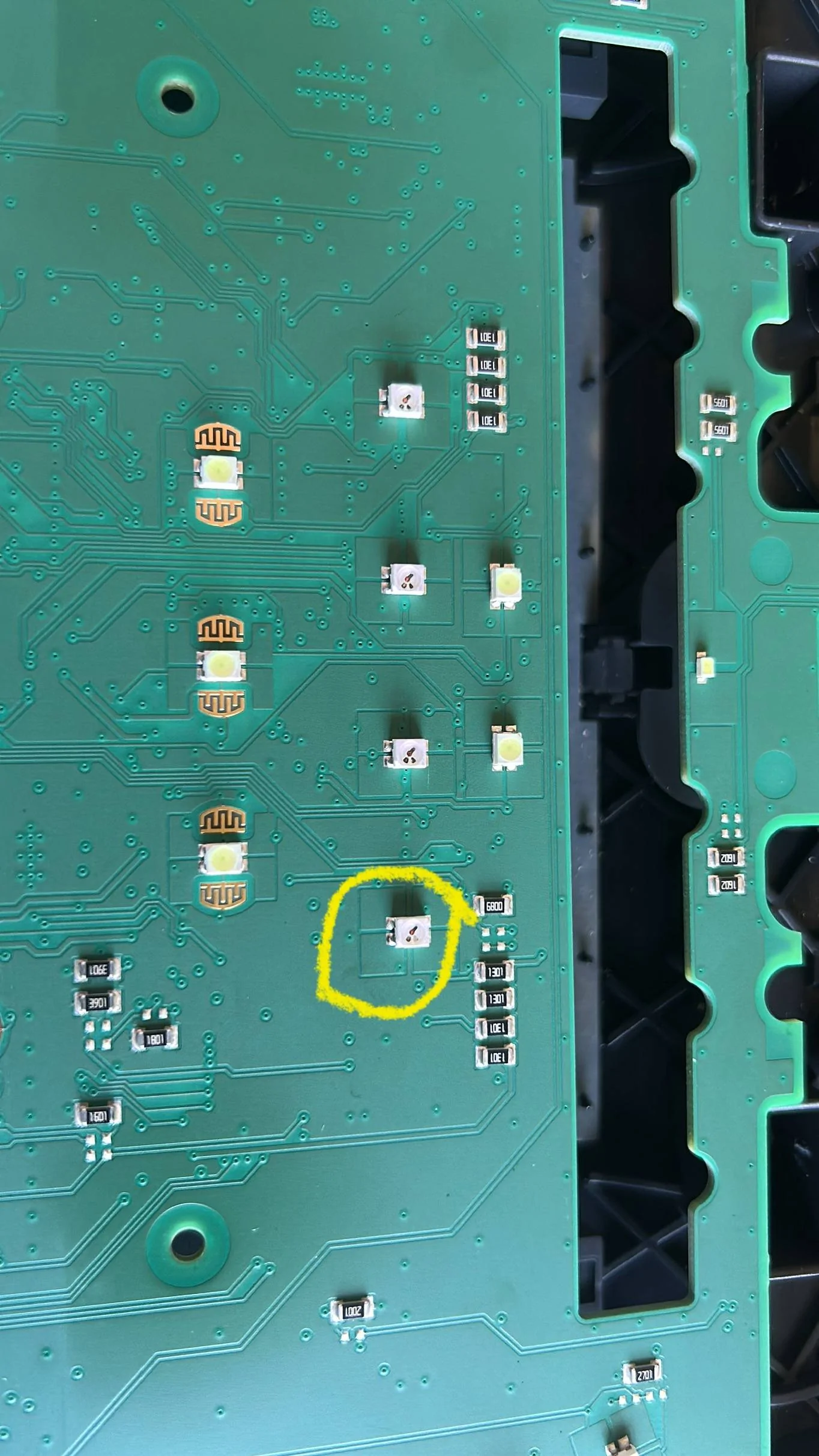

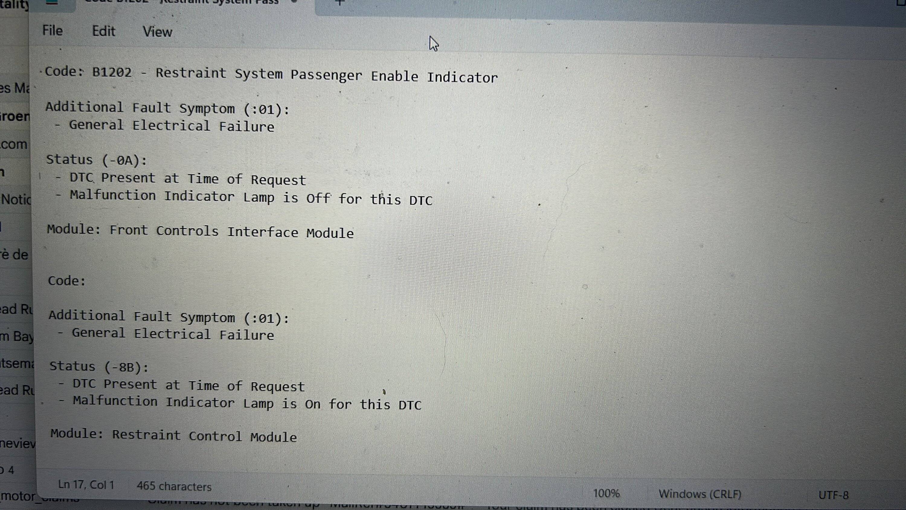

Good day, I recently got an airbag light on my cluster. I managed to get access to Forscan and got the error code for B1202 "Restraint Passenger Enable Indicator".

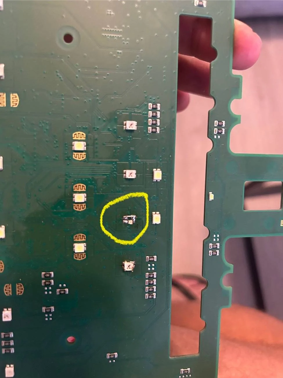

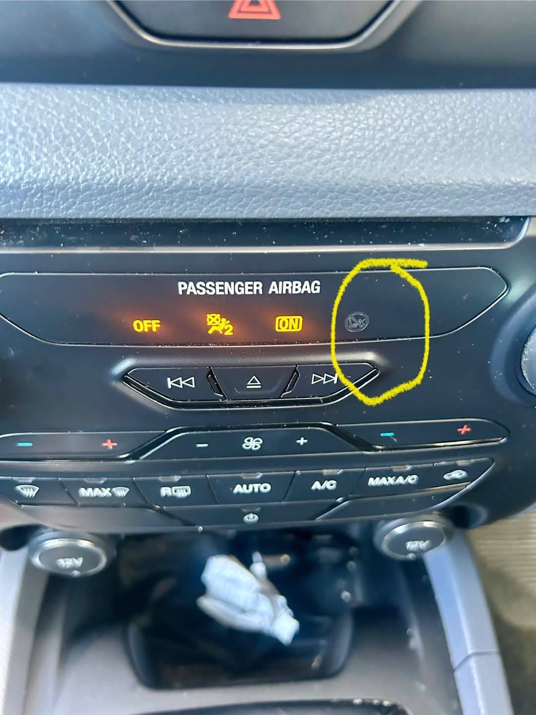

I noticed on my FCIM panel display my 4th LED which shows baby seat occupancy was not coming on as i turn my ignition on which it usually did for self test. I proceeded to remove the FCIM and removed the PC board. I had all 4 LED tested (Diode test) for the passenger restraint system and technician confirmed the 4th LED was not working. He said if I can source the LED he can change for me. Does anyone know where I can procure this LED, it's a surface mount LED with 4 Legs, amber in color. Please see below pic with LED circled.
